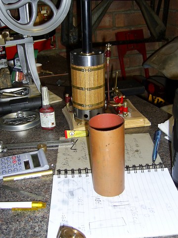

A wee update and not a lot to show mainly due to the rather cold temps in my shop
The frames have been hard soldered up
The two uprights and spacer come mount are riveted together as Iv found in the past if it can move when hard soldering it will
The 1/4 block for the ports is now 5/16 as my stock was undersize for the 1/4 40 thread a shallow 5/16 grove helped also hold this in place when soldering it up
The mains have been made to 1/4 dia and phos bronze bushes fitted
The cylinder pivot was made to 3/16 and again a bronze bush pressed into the upright
When machining these holes after hard soldering the port face was given a light skim without disturbing the setting the idea been that this way the crank and cylinder pivot all should be at 90 degrees to the port face and may save having to give mamod sized fits to the pivot and big end
The other reason to fit bushes is that when they wear they are easily replaced
The crank will be next and should have been made today but my one and only 5ba tap dropped behind the mill into the abise and I had to move the mill to recover it
The ports will be drilled using a simple jig as it takes out the guesswork

Hi all, just a little update
Ellies engine is now finished and she is a very sweet runner.
The porting was drilled using the jig shown to the left in the pick and all holes are to 2.4 mm dia. I started at 2mm and kept increasing them until I had the engine running the way I wanted it to, 2.4mm leaves 0.1mm either side of the holes at TDC and BDC.Thanks to Tony Bird for the info as I was going to leave them at 2.2mm
I found the piston at TDC covers most of the cylinders port so reduced the length by 1mm
As you can see she now has a Cracker type cylinder as Iv found this to be long lasting on engines in the past
