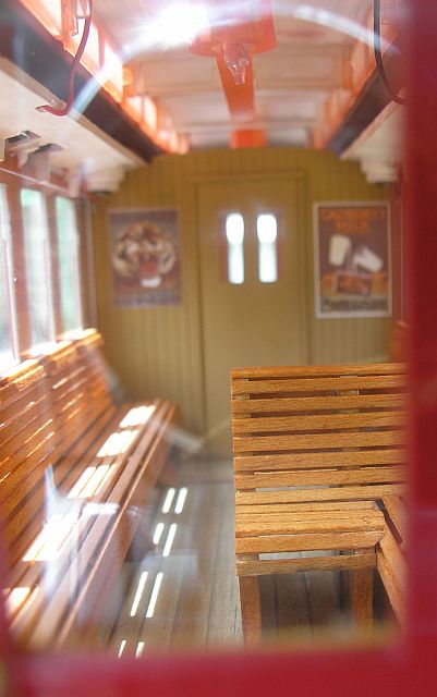

Re: Skarloey Railway dabbling
Post by LNR » Thu Nov 09, 2017 12:15 am
Hi,
On my first coach, wishing to represent battened seats, I glued down separate battens and getting them all with the same gap was fiddly to say the least.
Ritg 117A.jpg (39.14 KiB) Viewed 14459 times
After that I made a solid seat moulding of timber and heavily scribed the battens, then rubbed it with a dark colour then sanded the tops. Result equally spaced battens, parallel gaps, and through the windows you can't tell the difference.
Just a thought.
