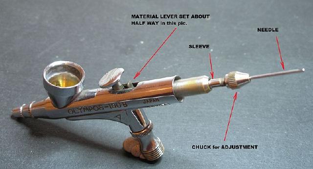

Bit hard without pics. of the workings, but I have the original Professional Olympos which some say the Iwata is a copy of.
If you unscrew the rear cover there will be a tiny knurled chuck with the rear end of the needle stem protruding from it. If the chuck is undone or slipping that is what controls the material, it is also the method by which the amount of material is controlled. This assumes that yours is push down for air and pull back for material ie double action.
I can follow with further tips, but need you to confirm that yours is of similar operation.

OK I've checked the Iwata parts list for the Neo and it has similar parts.
So using the pic. of my Olympos you will see the small lever behind the operating button, this controls the amount of material(paint in this case) allowed into the air stream. If the lever is held to the back of the button (right forward) that is maximum material, conversely if the lever flops right back with no resistance then that is zero material.
The setting is achieved by slackening the chuck, pushing the needle all the way forward and TIGHTENING the chuck. At this setting you would have full material. To cut back material, undo the chuck, and while holding the needle all the way forward, pull the operating button say half way back, hold, and TIGHTEN chuck in this position. You would then have half material setting.
In this position you won't feel any resistance on the operating button until it comes back far enough to hit the material lever. Back here is good for weathering by pulling on full air, then just adding tiny amounts of paint.
Now I'm not saying this may fix your problem, but one other thing to mention, these are pretty accurate pieces of equipment designed for precision use, the orifices are very small and I have found that especially using matt paint, too high a pressure tends to dry the paint at the jet and so block it immediately.. I use very low pressure generally 10 psi, very occasionally 15, but never any more. It also keeps overspray in check.
Sorry this is so long winded, hope it is of some help.

I just worked on the airbrush after returning home from work. Basically, I loosened the chuck and removed the needle, cleaned and locked it up and tried to spray with water. It worked very well. Initially, I slightly pulled the needle out abit and sprayed in that setting; it sprayed well and I saw some droplets of water since I think the needle didn't go all the way. But in that condition, I guess small residues were pushed out from the orifice. Then, I pushed the needle all the way up, locked it up and loosened the chuck abit. Then, I noted that the airbrush worked normally. I tested to confirm with water alone and then using Testors paint; everything works perfectly. Thanks very much for teaching me the mechanism how airbrush works. I will continue to learn the process.

Glad your getting results but I'm a little confused,
The chuck must be locked to the needle at all times, and the needle as far forward as it goes. The chuck locks the sleeve(in my pic.) to a position on the needle. Were it to slip or not be tightened up, the lever and sleeve would merely slide along the needle and not release any paint.locked it up and loosened the chuck abit.
