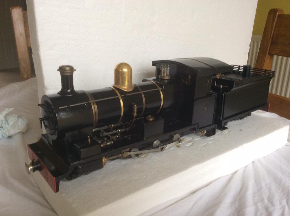

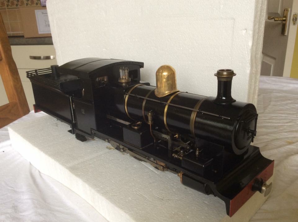

I recently bought the second of these locos and can agree about the quality of workmanship, however mine is missing a few details compared to this one. A feature mine still has though is working single eccentric valve gear for each cylinder operated by a reverser lever in the cab, it doesn't have an axle driven pump. It has what appears to be an electronic water level warning alarm which I'm somewhat sceptical of. It's manual control at present but I will have r/c fitted and possibly have the alarm replaced by a gauge glass at the same time and when it's running reliably have it repainted.

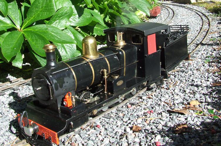

My Gwalior has been in the wars. I decided to use it to test the new track. Everything started OK but then the front bogie de-railed. Then four days work to sort out the consequences.. I do not know how but the derail destroyed the valve timing and I could not reset it. There was just too much slop in the rather Heath Robinson valve gear. So the 1/16 wire eccentric rod and the ball joints were scrapped and replacements made much more in keeping with the prototype. I will post pictures tommorow. One odd thing , if the valves were timed to crack open at the limits of the piston stroke as I normally do, she would not run well. Talking to her previous owner and some experimenting found that swiss watch running in both directions was only achieved with the valves cracking open at the moment of the piston direction changing. Should you ever want to get into the works the brass lubricators on the valve chests unscrew. I hope you have better luck than me. I removed the valve chest covers without problem but found on re-assembly that the retaining bolts had stripped out their threads to a greater or lesser extent. Luckily I had a 9BA tap and die and the right sized hex so that was sorted out. Adjusting the round slide valve was easy. Very nicely designed. I do think that the inlet ports (2 small holes) instead of a rectangular port are undersized. However since it runs well and is powerful who am I to say. Thanks again for re-uniting the engines. I wonder if this was one of the locos they made 3 of ???

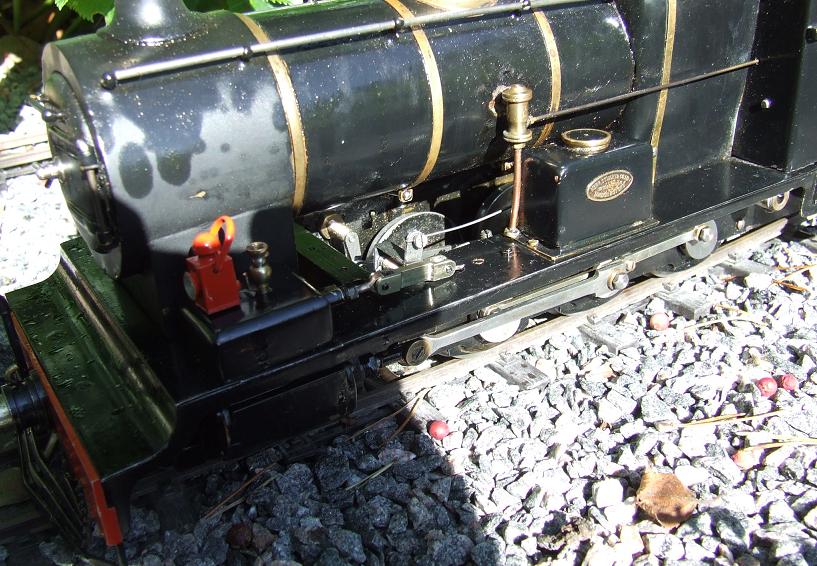

Hi, As promised a couple of photos of the re-built valve gear on the Gwalior loco.
The eccentric sheaves had there 1/16 wire "rods" removed and new rods were milled from steel and half relieved to allow a good joint onto the existing sheaves. The drive was then taken through the frames, the outboard crank required a slot being cut and filed in the foot plate. The drive was taken to the valve rod by a link. THe link was milled from 3/16" NS bar that I had to hand.
It is a little overscale but does copy what was on the prototype. The valve rod had to be reworked. The ball cup end was removed and a bush silver soldered on instead. This was thinned down after soldering to be an easy fit into the new forked link. Assembly was with roll pins.

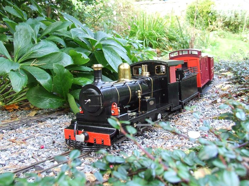

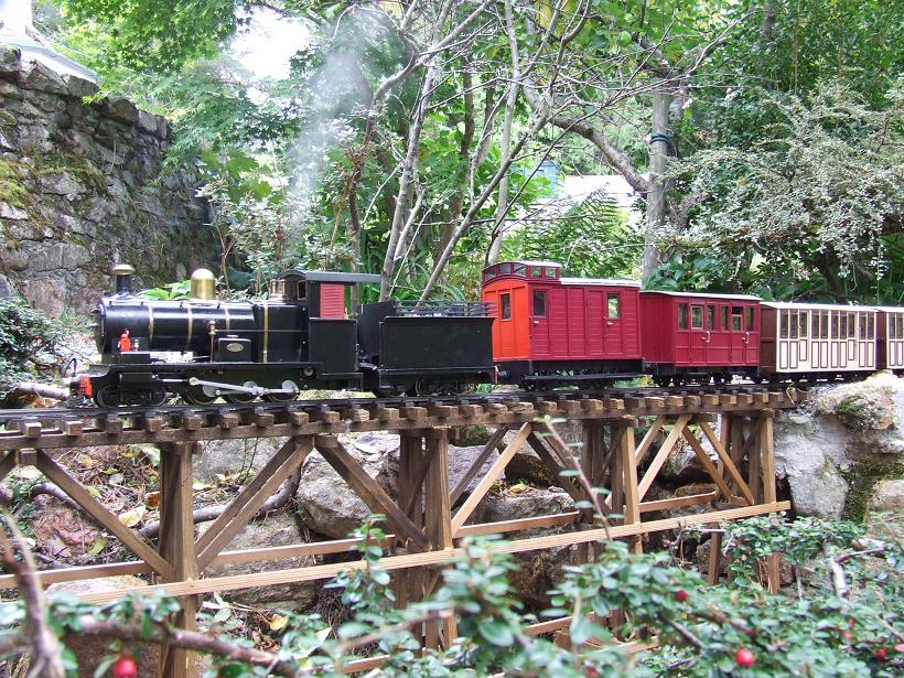

Hi, since the last post the Gwalior 4-6-0 has been totally rebuilt at the front end. During the steaming session pictured above the loco did not behave well for long there was still too much blow by and this got worse. It got so bad that more steam was blowing by than the boiler could generate. So being a fool I thought that it was the valves. For the upteenth time valve covers came off and the valves were inspected ( seemed 0k). The valve faces examined using engineers blue (not so good). In the tight space of the valve chest they were carefully scraped flat That took about five hours! (wasted time as it turned out). Put it back together and tried it on the air line - still a bad blow by! Clearly I was missing something.
It was time to pack it in, goindoor have a whisky and bed. Sleeping on things is supposed to help and it worked. Next morning it was into the workshop and disconnect the con rods. Slowly rotating the driving wheels showed a problem at once. The left piston went back and forth without much power and the right piston did not move. So out with the tools. What was revealed was on the right side, the piston rod was badly pitted and the black nitrile? ring was cracked in 3 places and brittle. The Left side the ring looked OK but was no longer flexible.
So new piston rods, new packing and new red silicon rings. All done and dusted in 3 hours. The loco is TRANSFORMED. Powerful, slow running, NO blow by ,good chuff and so economical in steam that today the gas lasted 70 minutes not 25! The loco was used today to open the re-built Deeside Railway (private opening) A full public opening is in the offing.
All the photos in the post just taken. In one I think you can see the plume from the cosmetic whistle. The railway looks a bit raw but nature will soon soften the setting again.
Workwright

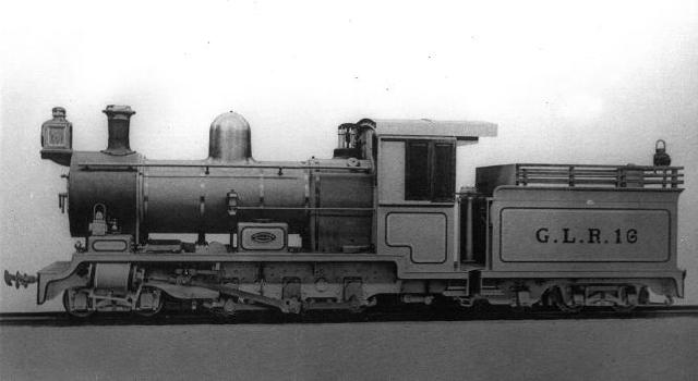

There is one in particular that he has owned for many years that had long taken my fancy. This 4-6-0 tender locomotive was constructed in 1909 by Kerr, Stuart in Stoke-on-Trent for the Gwalior Light Railway - no 16. Maharaja Madhav Roa II decided that the development of his province was hindered by the lack of good transport. Being an Anglophile he had followed with interest the development of the rail system in India and so naturally he chose British engineers and the Kerr, Stuart Co in particular to supply him with a system. At its peak, the system had well over 300 km track. To make construction cheap and speedy, it followed the trend of the 1890s for such railways to be built to narrow gauge. The gauge chosen was 2' but the length of the railway demanded large tender locomotives. The construction, therefore of the line plus all the rolling stock must have been an interesting challenge for the Kerr, Stuart designers. Their solution, in GLR no 16, is a very elegant and purposeful-looking engine.
[/img]
Does any one have more pics of the prototype loco and or the works drawings, works, there are features of this loco I wish to include in my freelance first time build. The Tender is especially appealing to me.
