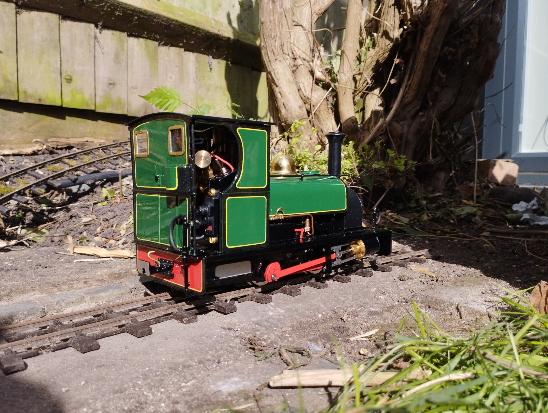

Hello all!
Apologies for the further prolonged absence - life's been busy. It's also been good - the garden room, the coming of which brought about the end of the (WH)WHR's previous incarnation is now in place, decorated and fully kitted-out, and is proving transformative. With lots of shelves and a dedicated workbench, I (more or less!) know where tools and materials are and can leave work out between sessions, making everything more efficient, effective AND enjoyable.
The first 16mm project undertaken was to get Lilla lined, with the whole thing, from making the templates for the yellow line, to adding the black edging, only taking about three days - lightening fast work for me! Not perfect, of course, but I'm pleased with the result - especially the buffer beams!

Lovely job with the lining Andrew, and welcome back, you have been missed!
I look forward to learning your lining technique too.
- Posts: 7874
Welcome back Andrew. Good to see plans are being made. Love the lining. Looks pretty good to me.
- Posts: 1868
Very professional lining job on Lilla Andrew, and welcome back.

Your lining looks superb, Andrew. I'm with Philipy - spill the beans on how you did it!

Hi all,
Thanks for the warm welcome back - and I'm glad you like Lilla!
My lining's done with an Easi-liner pen, which comes with four nibs, from 0.25 to 1mm.
I've read quite a bit, and tried various ways of doing it, but I think I've arrived at my preferred technique.
Although for simple jobs, straight lines made by following a ruler would be OK, for Lilla I started by making a template for each shape of panel:
The templates are blutacked on, which means there's a little gap between template and loco, to stop the paint bleeding underneath.
Then it was onto the yellow line - I used the 0.5 nib. Once stirred, the yellow paint was fine straight out of the tin, running smoothly through the nib. I always use gloss, having read somewhere that I should - but I've since read elsewhere about someone using matt, partly to bring down the overall glossiness of your average steam loco.
I do as much as possible with one "stroke", but bits get in the way, so it's often not possible. Where lines overlap you can often tell, but mistakes can either be wiped away for another try, or small blemishes scratched off with a cocktail stick. I found that more difficult on the Regner, where I'd painted the base colour myself with a rattle can, not nearly as hardwearing as, say, RH's hardy finish.
As you can see the yellow's far from perfect BUT, because of the edging, any mistakes on the outside of the yellow line will be covered up.
I didn't take a photo of the next bit, but I used a ruler to run a 0.75mm black line along the outside of the straight bits of the yellow lining. For curved edges and corners, I painted freehand with a fine brush, which was surprisingly OK. Again, mistakes can be rectified by wiping and starting over - I'd left it 24 hours to make sure the yellow was fully dry and so wouldn't be lifted. The black was a little thick, so I thinned it with lighter fluid, seemed Ok after that, but I found it's best to do it a panel at a time, rather than draw all the black lines then go back and infill the rest of the edging - that way you're always working with a wet edge.
On this test go, you can see both where the black was a little thick, and where I let bits dry too much before revisiting - visible brush marks/lines:
I think that's about it... I've got the house to myself tomorrow, so might stick it in the oven on the lowest heat to "bake" the lines on - I'm guessing the servos etc are designed to take heat to should be OK???
Hope that's helpful,
PS I 'm trying to learn the to find a balance between trying again when I know I can do better, and accepting imperfection when I can't. Actually, that could apply to life generally, not just lining little steam engines!

Fantastic work and interesting to see the process. The end result is most impressive.
A recent 'discovery' I've made is Museum sticky gel tabs https://amzn.eu/d/1ml1iyr. The clear ones are obviously almost invisible, great for example, for holding figures in place, either temporarily or permanently but also they would evenly space your templates. They are easily removed and don't leave any residue, which can't always be said for Blu tack, especially when used for a lengthy period.
As for baking your loco complete - not sure what temps servos will tolerate. Presumably they would be okay at around 50°C?

Clever stuff, Andrew. With obstacles such as pipework already fitted it must be more difficult maintaining a consistent angle, but a little touching-up soon solves that. Overall a great success.

That's the problem, r/c servos etc. are designed for model aircraft use with plenty of cold air rushing past, not for steam heated garden dragons.....Andrew wrote: Tue May 06, 2025 1:39 pm I've got the house to myself tomorrow, so might stick it in the oven on the lowest heat to "bake" the lines on - I'm guessing the servos etc are designed to take heat to should be OK???
Metal servo gears are heat resistant, but I'd be very wary of heating electronics and batteries are definitely heat sensitive. Consumer electronic devices seem to be rated for a max temp in the low 40 degC range, where the manual has anything listed.
Just sit the loco on a shelf for a week or so and admire the results of your handy work.
ps. Largely because I'm impatient, I cure enamel paint in an oven at <80 deg C, but I dismantle the model to paint it and only the metal parts go in the oven.
Have you tried the pinstripe tape for curves that the car scene uses for their styling. They achieve some amazing results with it. I used it myself for my 3D tender model I made for my R/H “Billy”.
