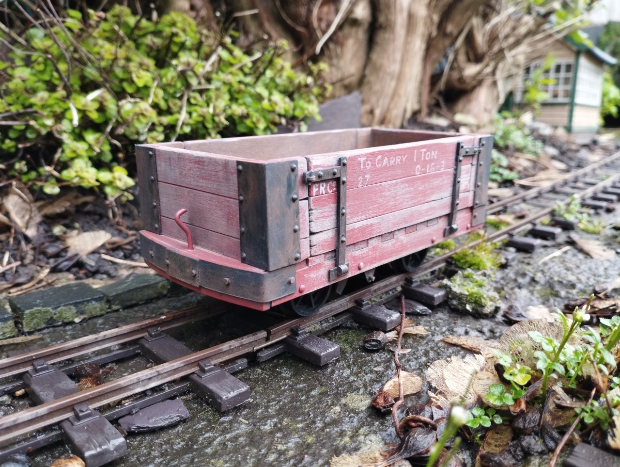

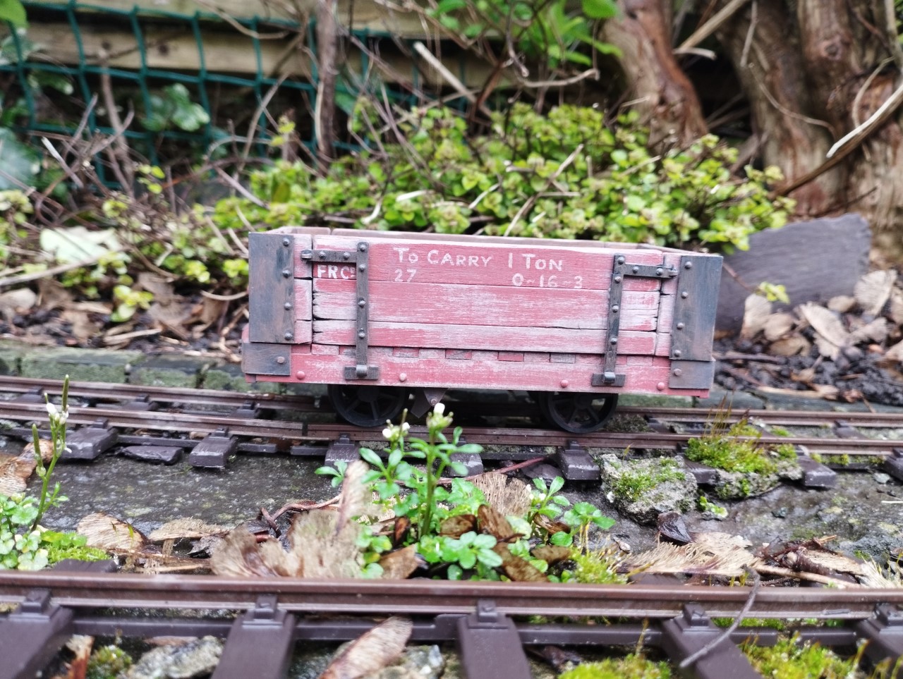

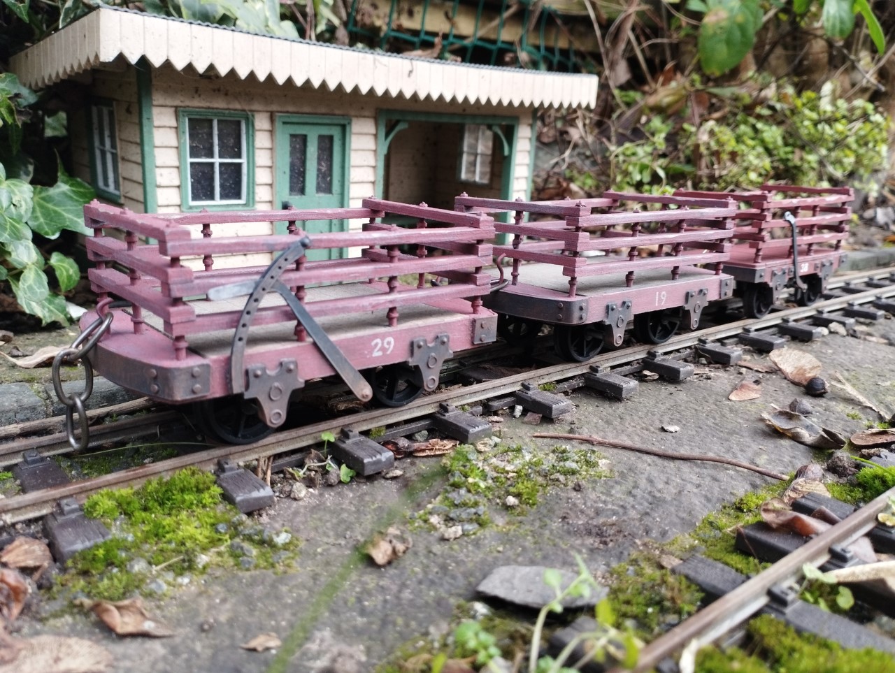

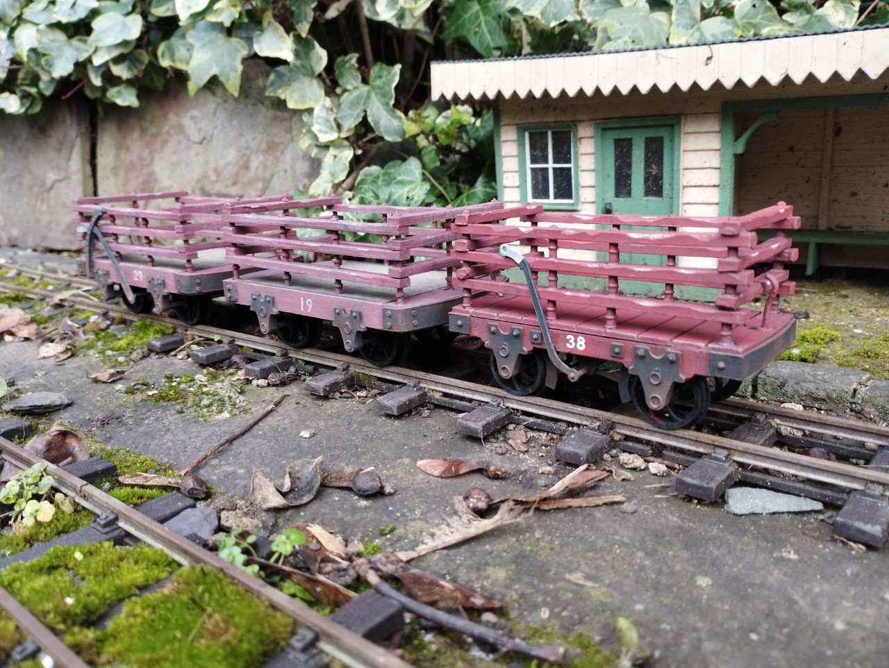

Last week saw me complete the latest project, the two NWNGR/WHR slate wagons bashed from Lineside Hut kits, and the re-Ffestification of the Binnie kit that was previously representing that type of wagon. And here they are:
Slate wagons 1.jpg (365.45 KiB) Viewed 25400 times
Slate wagons 2.jpg (352.72 KiB) Viewed 25400 times
Slate wagons 3.jpg (417.83 KiB) Viewed 25400 times
I ought to get back to my carriage projects really, but I find building small wagons awfully distracting, and I could do with a few more WHR ones to make up an authentic train...

They all look great Andrew, particularly No. 38 showing years of hard work.

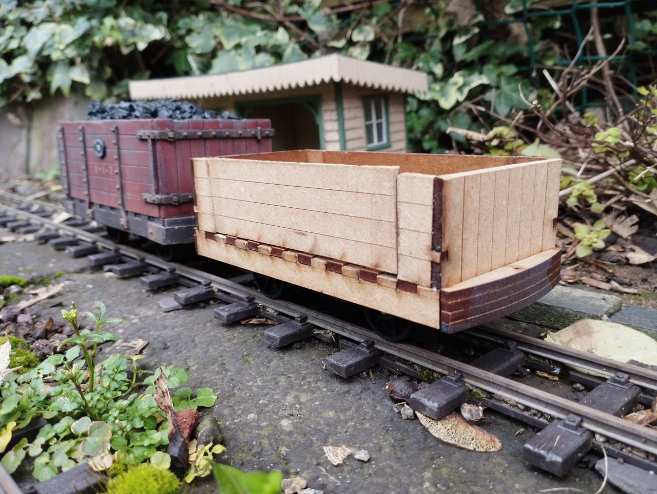

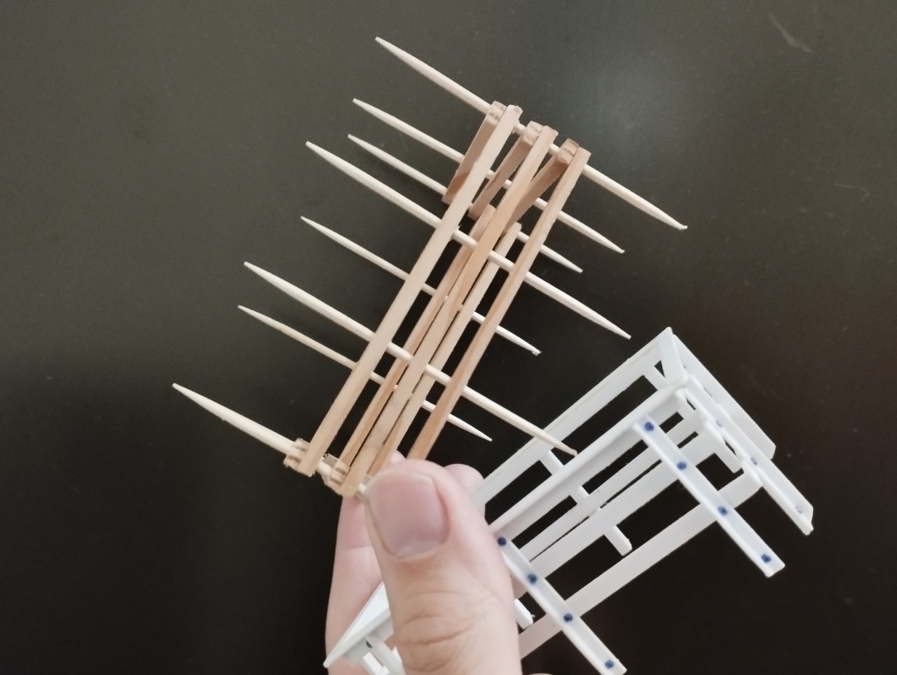

More slate wagons underway here, this time on modified Phil Sharples flat wagon kits.
One will have a plastic strip representation of an iron body, using the jig I created for a similar wagon a while ago, and the other will be another all wooden one. Based on the few photos and relatively small amount of information about WHR/NWNGR slate wagons (of which there seemed to be a surprising variety) , both will have dummy "W" iron type axleguards rather than the Ffestiniog or pedestal sort. So far I've modified the chassis and built the bodies:
More slate wagons 2.jpg (161.29 KiB) Viewed 25154 times

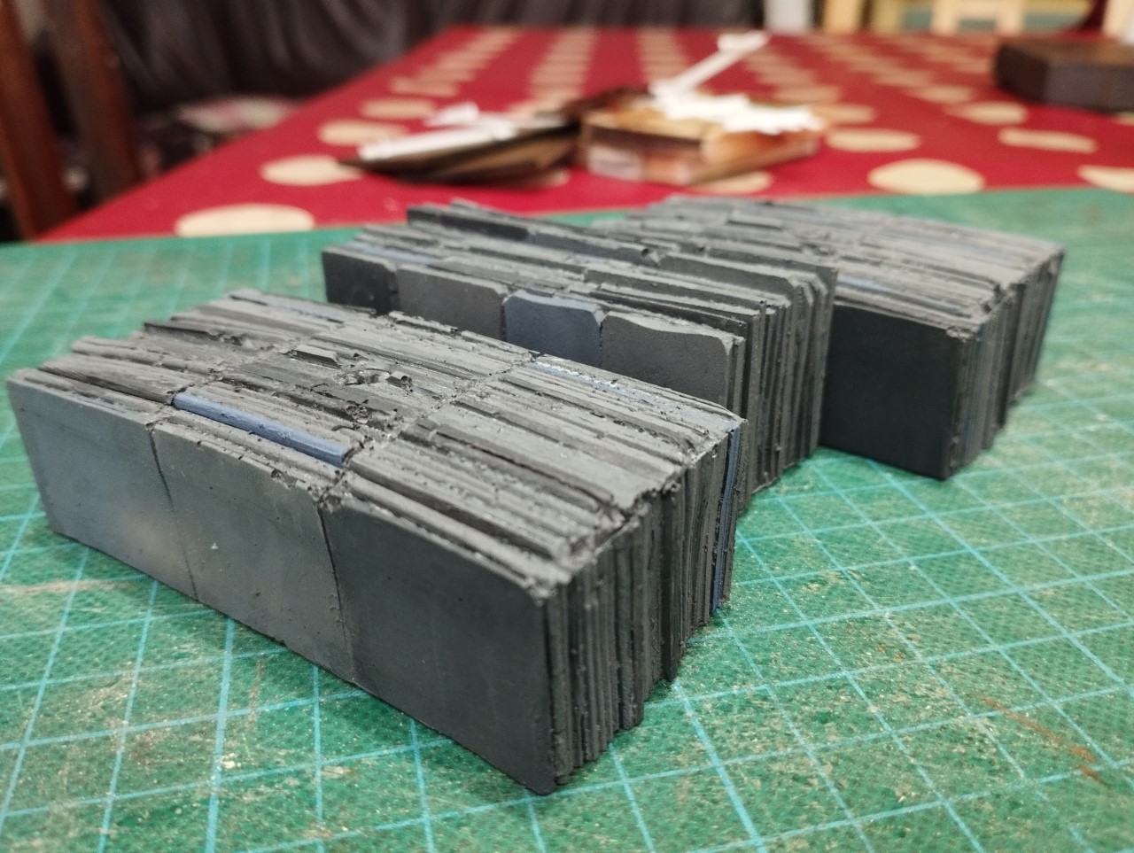

I've also been experimenting with slate loads. I decided that life was a little short to make them, so purchased three sizes of Lineside Hut ones to experiment with modifying them (ie a little "cut and shut") to fit my WHR wagons. I'm pretty pleased with how they came out and will purchase some more in due course. If you look closely you can see the steel screws in the top to allow wagons to be loaded and unloaded with my fancy magnet on a stick device...
Slate load.jpg (288.37 KiB) Viewed 25154 times
I'm hoping to get some time to begin painting the new wagons at the weekend, and to start work on the axleguards, maybe...

Nice slate loads Andrew. :thumbright:
The Jig looks brilliant and it seems to make the job of making the wagons a lot faster and easier.

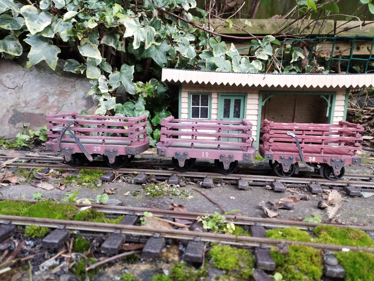

Another slate wagon update, I'm afraid - what else do you expect, when the Welsh Highland had about 100 of 'em, and the Ffestiniog over a thousand?! Actually, I think I'm only going to build a few more after these ones, but that's for another time...
For now, here are the latest two:

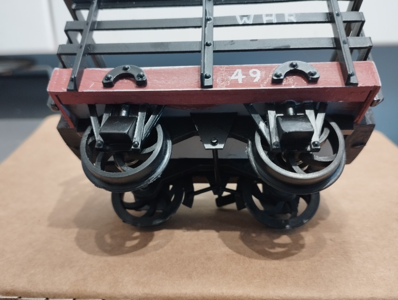

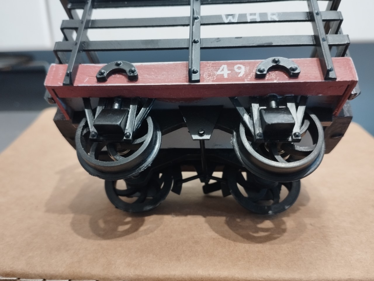

Slate wagons Feb 23.jpg (351.33 KiB) Viewed 24820 times

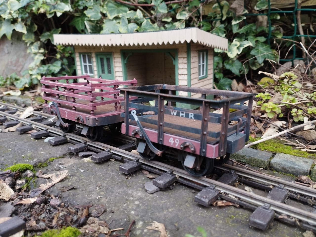

They're based on some grainy and rather unclear photos of original WHR wagons which had "W iron" axleguards, and those horseshoe-shaped bits of strapping (anyone know the name of those?!). Otherwise, they're similar to the ones I've already made.
I couldn't find any suitable axleguards, so I made them from plasticard and wedge-shaped bits of Lego - they're an approximation at best! The "horseshoes" are just nylon washers cut in half.
Slate wagons W Irons.jpg (182.54 KiB) Viewed 24820 times

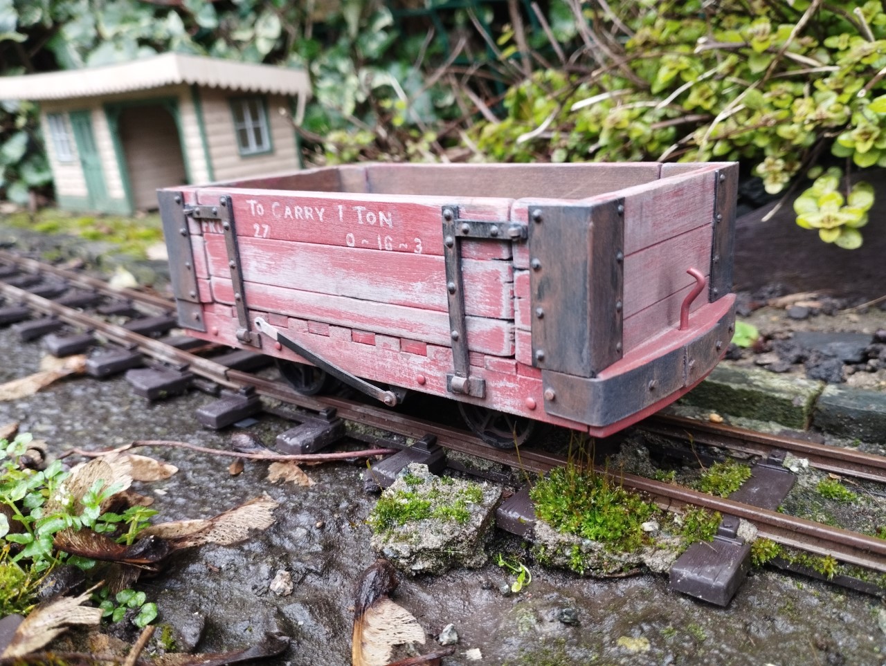

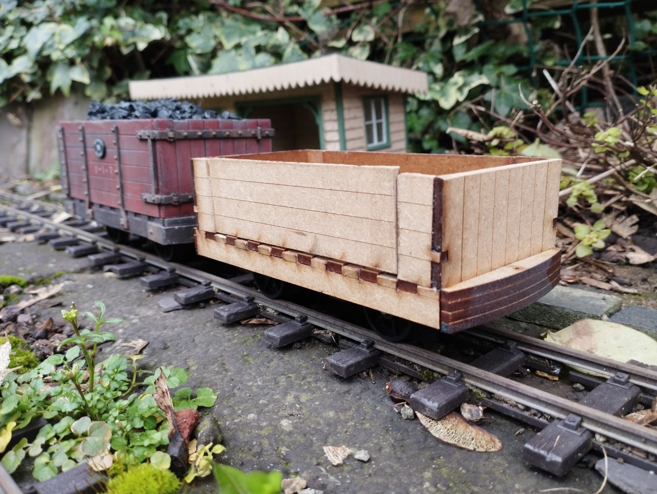

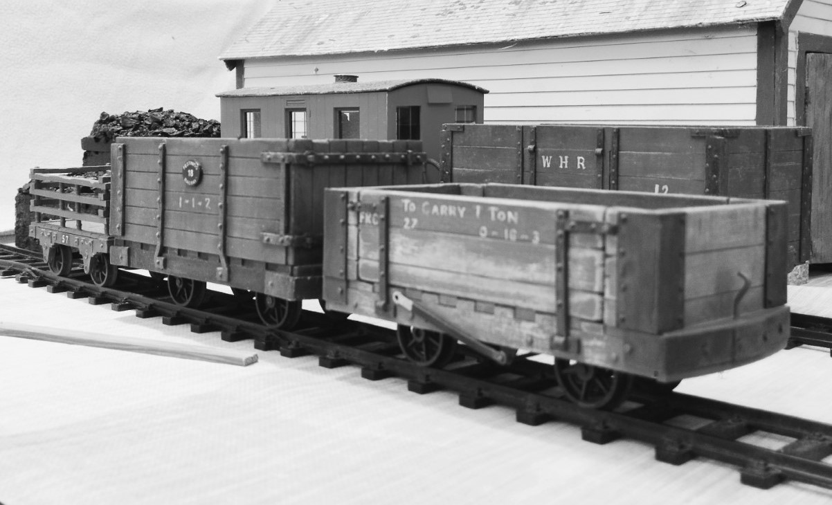

I was planning to return to carriages, but then came across a picture of an intriguing little dropside wagon, Ffestiniog No 27, which you can see here: http://217.34.233.120:8086/index.php?a= ... 5679046704. It's the only image of this that I've seen, and I don't know of any drawings, but happily it stands next to an early coal wagon, which looks pretty much the same size, other than the height. Even more happily, I was given a Phil Sharples kit for one of those for my birthday last month, so I got to work, by simply cutting off the top two planks:
Oyster Wagon A.jpg (332.85 KiB) Viewed 24820 times
I also cut the dropside door out - I don't intend to make it opening, just thought it might look more realistic. I hindsight, I'm not sure it was a great idea, it'll make the whole wagon weaker, and MDF doesn't really like being messed about with, but we'll see...
Intriguingly, the iBase caption refers to this as the "oyster wagon". Some quick research has revealed that there was indeed a trade in oysters from Porthmadog - that seems to have been principally by sea to Liverpool, but I guess some maybe went by rail, being shipped from port to main line via the FR? It appears that oysters were shipped in ice-filled barrels - if those needed to be kept upright, I suppose a dropside wagon would have made it easier?
Or, is it like the "beer wagon", in that there's a photo of it somewhere in which it just happens to be carrying such a load, rather than being designed specifically for the purpose? Does anyone know more?!

I like them Andrew. Very nicely weathered too :salute:

In what was record time for me, the "oyster wagon" is now complete:
Oyster wagon finished A.jpg (378.75 KiB) Viewed 24321 times
Oyster wagon finished B.jpg (400.24 KiB) Viewed 24321 times
Oyster wagon finished C.jpg (374.6 KiB) Viewed 24321 times
I couldn't resist trying to recreate the photo which inspired it (http://217.34.233.120:8086/index.php?a= ... TjNZw/1011):
Oyster wagon finished D.jpg (180.09 KiB) Viewed 24321 times
I think the recreation possibly suggests that the completed wagon is about a scale foot/18" longer than it should be, but that might just be the angle - I should have moved a degree or five to the left to get my recreation spot on, I think, which would have foreshortened the wagons a little...
I've made a barrel load to go inside it, will give a test run at some point...

You're getting really good at this Andrew. The wear and tear to the planking is very nice, and subtle weathering is particularly good.
Posts: 6066
Re: (WH)WHR Rolling Stock
Post by philipy » Mon Feb 20, 2023 11:58 am
Andrew wrote: Mon Feb 20, 2023 11:24 am
I think you are being too hard on yourself. trying to guess dimensions from angled photos without any real reference points is almost impossible. Looking at the side-on coloured photo of your model, if 16 - 24mm was taken off the length it would be far too short, IMO, and the model looks good and believable to me ( weathering is nice as well :D )
