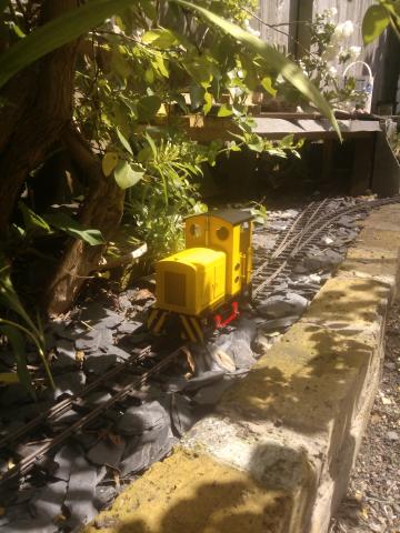

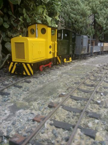

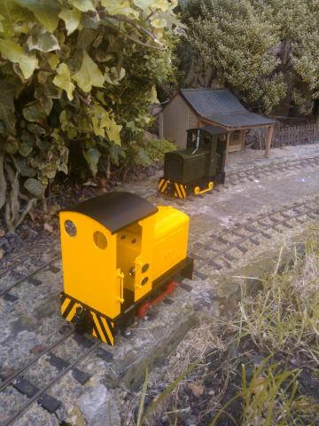

Nice to meet you too Andrew, here's my pics from the meeting:
Double Trouble! ;)
Overall it was a great railway, it's certainly inspired me somewhat!
Dan
Post by Andrew » Mon Jun 09, 2014 7:45 pm
Nice photos - I especially like the yellow paint of your LJ catching the sun in the first one. I've just spent a very happy half-hour shunting in the garden, it's a lovely little loco...

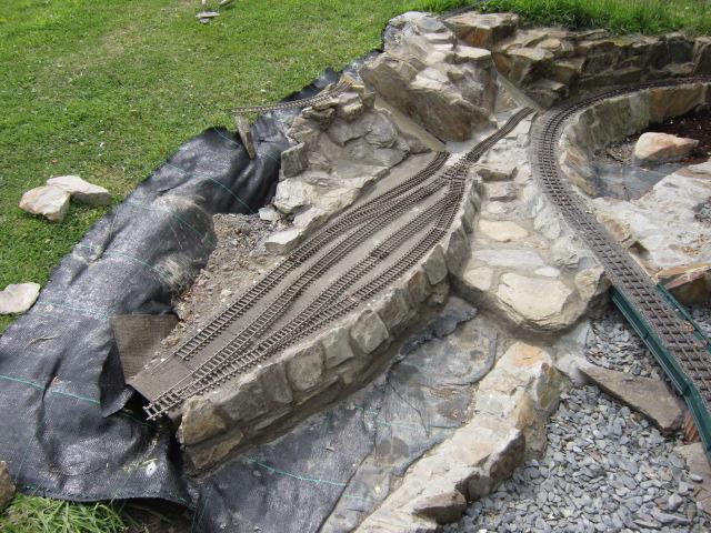

After a brief phase of testing my "completed" line I promptly dug up part of it and recommenced building works. I'd found that although the completed line seems to have lots of potential I wasn't going to realise it while the bottom terminus was a temporarily laid single line with a short siding.
I've been gradually fixing concrete blocks ("reclaimed" from assorted dodgy alleys and wasteland in the neighbourhood) into place behind the little wall I built last year to form a solid trackbed. That's now extended beyond the wall and into the undergrowth:
I've started laying track and hope to have the station area finished this month. I'm using a quicker method of trackbed construction than I've used previously, laying the blocks onto a bed of Postfix rather than a pre-cast foundation. That's speeding things up, but there seem to be plenty of other calls on my time to distract me from railway construction...
Post by Soar Valley Light » Sun Jul 06, 2014 9:51 pm
HI Andrew,
That's looking very nice. There is some carefully laid out geometry there. Do you have any sort of level control when you are laying your blocks?
The postmix idea is a good 'un. I dare say ready mix mortar may do a similar job. How does the cost of post mix stack up against the cost of sand, cement and gravel? There has to be an allowance for the convenience of post mix of course - so much cleaner and tidier.
Do you put any sort of sub-base down to stand the post mix on?
Apologies for all the questions but the construction plans for the Soar Valley Light are now approaching the detailed planning stage.
Post by Andrew » Sun Jul 06, 2014 10:36 pm
Soar Valley Light:102436 wrote:HI Andrew,
Hello!
The track geometry looks better from that angle than from others! We shall see how test-running goes...
By level-control do you mean something more complex than a spirit level? If you do I'm afraid the answer's no - other than to compensate for minor dips and bumps by careful ballasting...
The stuff I'm using is Postfix, on special offer at £3.60 per bag in Wickes at the moment. Still more expensive than sand and cement, but yes, much more convenient - especially in a small garden where concrete must be mixed in small batches on a board on the lawn or patio.
For this section I'm not using a concrete sub-base/foundation, which is both keeping the cost down and speeding things up - I just can't go through yet another summer without some decent running! So far so good - all the rest of the "masonry" sections of line use a "foundation plus blocks/bricks" approach, but it did feel a little like overkill and I was beginning to suspect that life's just too short. We shall see in due course. About both trackbed construction and one's allotted lifespan...
I hope that's vaguely useful...
Post by Andrew » Mon Jul 07, 2014 4:36 pm
Forgot to say, the blocks are sitting on a bed of Postfix, and the soil at the bottom of the trench has been covered with rubble and trodden down firmly...
I cut some blocks to size for the headshunt last night and will try to make further progress this evening if the whether will allow me to...
Post by Soar Valley Light » Mon Jul 07, 2014 10:18 pm
Hi Andrew,
Thanks for the info. When I passed Bristol early this evening (I've been down to the South Devon Railway today) the weather was decidedly un-conducive to outside work of any sort! I hope it improved enough for you to do some work later.
A spirit level is a perfectly adequate means of level control, especially in combination with a long straight edge of some sort. It's also cheap and easy to use single handed!
When you are working in a confined area with a need to keep mess to a minimum pre-mix has to be an important consideration. It's also worth a bob or two extra!
When you say you aren't using a foundation for this section does that mean they are going down straight onto the earth or are you using postmix under them straight onto the formation? I understand what you mean about overkill. Over engineering is better than under engineering but only to a point! I look forward to hearing you you get on. for when the time comes for me to begin construction
This is all useful information for when the time comes for me to begin construction.

Post by Andrew » Tue Jul 08, 2014 8:54 pm
Soar Valley Light:102465 wrote: When you say you aren't using a foundation for this section does that mean they are going down straight onto the earth or are you using postmix under them straight onto the formation?
Hi Andrew - yes, the latter. The earth, and some rubble, is compacted underneath, and then a bed of postmix poured (dry) and leveled on top. The block goes down, adjustments are made, more postmix goes down the sides, and then it all gets a watering.
And yes, the weather did clear up, thanks! Feel free to drop by to play trains next time you're passing through Bristol!
