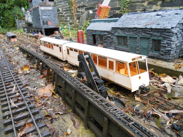

Worth looking into, thanks. Would need to be either pivoted outboard of the buffer beams, or mounted on the bogies.Narrow Minded:68021 wrote:How about Bachmann knuckle couplings Richard?
They wouldn't look too unprototypical, would close the gap a bit and wouldn't foul the gangways when uncoupling like the chopper hooks might.

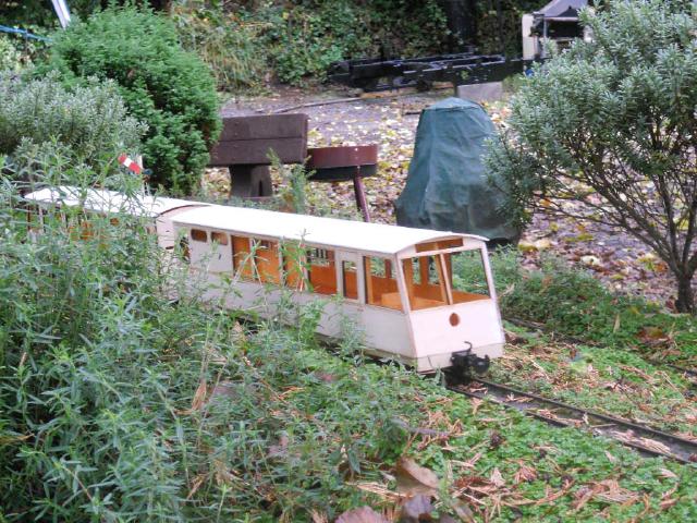

The railcar (all 3 cars) managed a couple of laps of Dave Watkins' line on Saturday. Sorry, forgot to take any photos but it still looks as before!
Subsequent adjustment of the motor bogie pivot should help things along a bit, we had one or two issues negotiating Dave's double slip which I think were due to lack of fore-and-aft rocking on the motor bogie. Plus extra weight needed in the 2 trailer cars, and over the front bogie of the motor car.

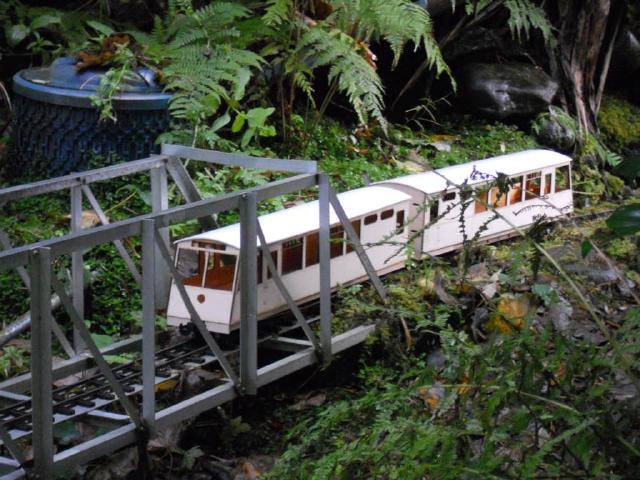

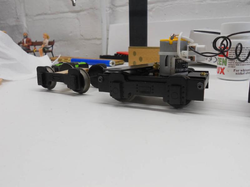

Time for a bit of an update on the railcar. As Victor Isle found, it is still rather incomplete, but works...
After the trip to Dave Watkins' open day, the motor car has had plenty of extra weight added and now weighs in at just under 3lb.

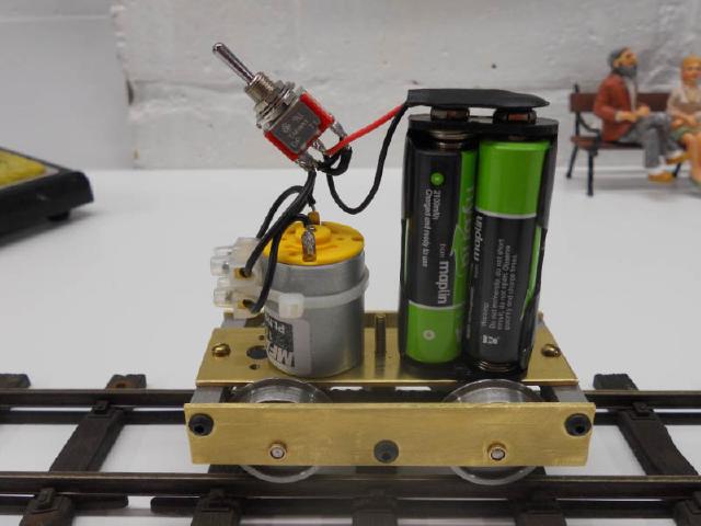

The motor bogie was never quite happy (worm wheel poorly drilled out to suit the axle), and was also rather low geared. So a replacement worm wheel giving 18:1 rather than 30:1 gearing was substituted, with a great reduction in noise and a substantial increase in speed.
Experimental weighting of the trailer cars suggested that really we could do with a second motor bogie... fortunately the driving trailer was built with this possibility in mind (a removable floor section in the guard's compartment) so I just need to measure up and copy the existing bogie.
This of course necessitates power from the speed controller to the 2nd motor, so an extra 2 wires the length of the train. So today I have ordered another couple of servo extension leads, and hacked the necessary holes in the carriage ends. Best to get this done before painting commences, even though connecting up the 2nd motor bogie can wait.
Still need to experiment some more about gangway connections. Thinking of something more basic, perhaps in the style of the FfR and WHR ones.

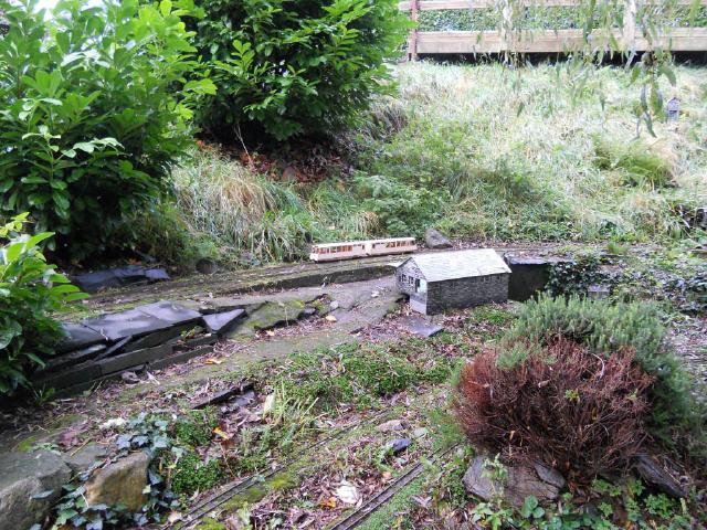

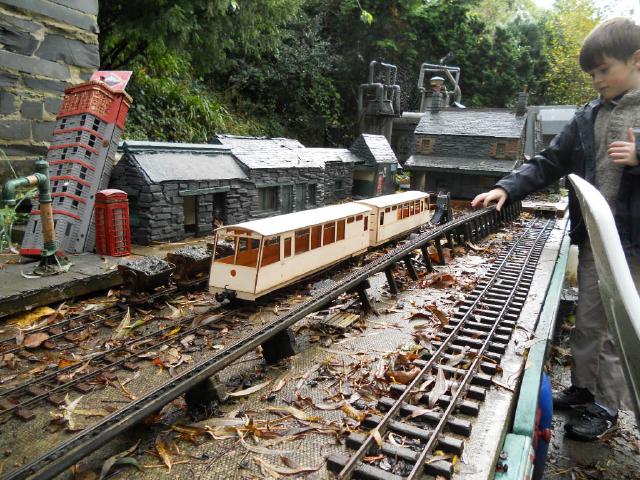

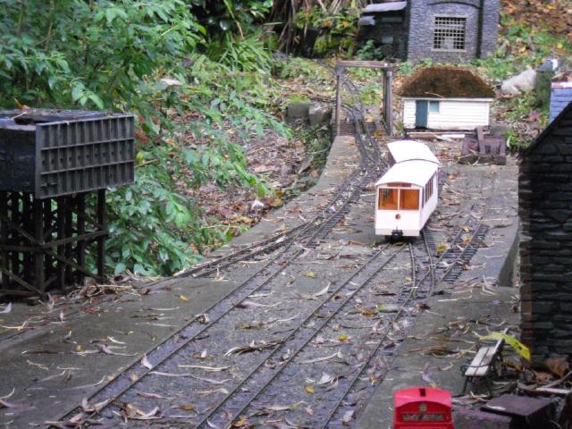

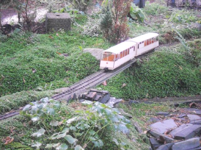

A half term trip to Wales provided the motivation to look the railcar out; on Monday it did around 10 circuits of Llechfan's upper circuit (in 2-car mode) and acquitted itself rather well (better than chez Watkins). 3-car operation awaits completion of the second power bogie.
A few photos and then a short video...

The 2nd power bogie came together yesterday - working better than the original, which may come in for a little fettling...
