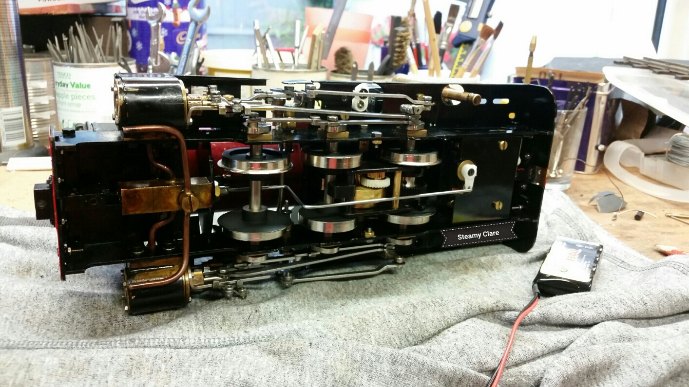

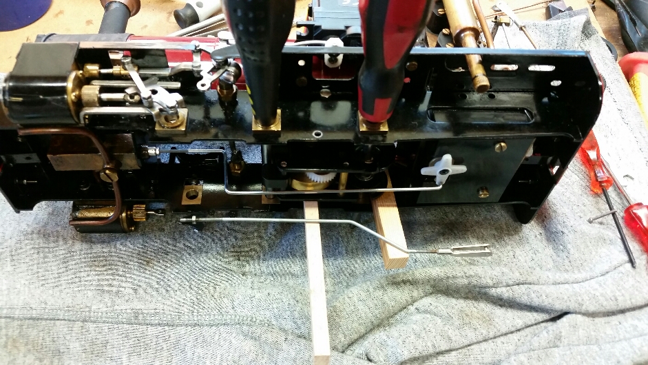

So I finally have a SSP slomo! It was a hard choice between fitting this to my Riverdale Amy or my first loco purchase my Roundhouse Silver Lady but as a gas loco is quicker to get running the SL got the vote.
The SL has a servo that operates the 'simulated drain cocks' which is a slide valve that directs the exhaust up the chimney or through piping under the cylinders. The RH factory servo rod occupied the space where the slomo needed to be fitted so a new one was made.
Mock up rod made from electrical wire:
2017-07-21 21.22.23.jpg (492.31 KiB) Viewed 12008 times
Finished item with original rod pictured:
2017-07-21 21.21.30.jpg (477.38 KiB) Viewed 12008 times
I need to paint the new wheels before fitting as the original insulated wheels cannot be used with a slomo when you run 32mm gauge.

New wheels drying, nearly time to steam her up!

It all fits rather well...
