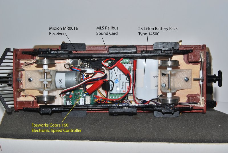

Well the electronics are now in an tested, hopefully a short video to follow on my indoor test track (due to poor weather), a tight fit :
Due to perspective it does look like some of the wires touch the wheels etc, but I assure you they don't (but only just) :)

My I ask why you chose to use a separate ESC rather than one of the Deltangs with it built into the receiver?

philipy wrote: Thu May 13, 2021 1:31 pm Looking good Jimmy.
Unfortunately, they're no longer in production, and extremely hard to find, anymore.
Consequently, I'll be using the same Rx and ESC combo as Jimmy, in some coming projects; they appear very simple to set up.
Philip, apologies I missed your question, but Aaron has answered it correctly, also with the Deltang there can be some fiddly soldering, one false slip and it is £60.00 gone, these are pre-wired, and plug and socket.
