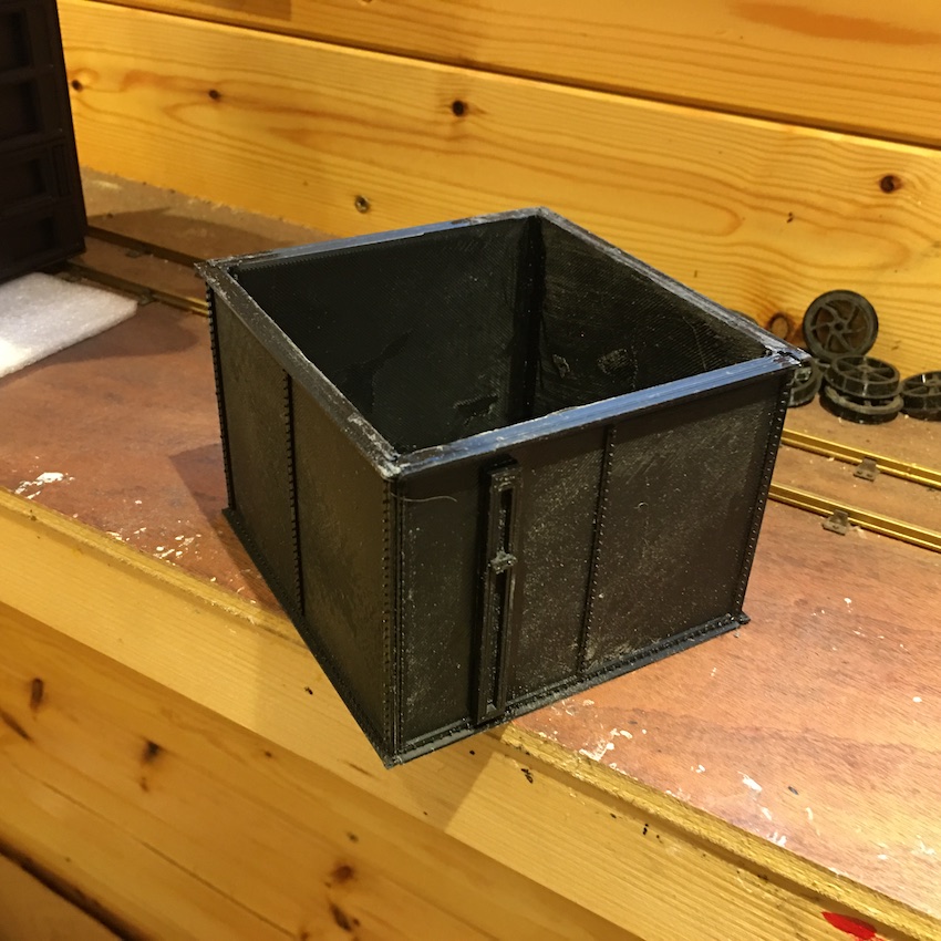

And the tank printed out. Each side took 3 hours to print, and the bottom 4 hours. It is watertight:

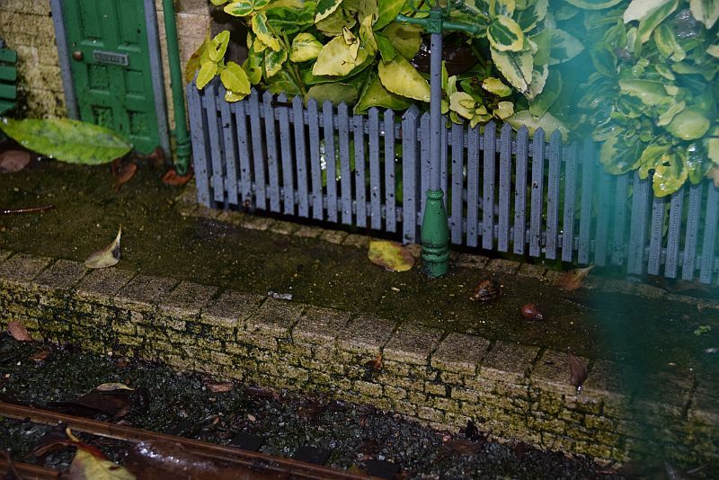

This is what it looked like when it first went outside:
...and this morning after a couple of years permanently outside and 24 hours continuous rain:
One of the first things I ever drew and printed was stone platform facing ( see https://gardenrails.org/viewtopic.php?f ... ng#p126127 ). The bright orange PLA came with the printer but was tamed by a couple of coats of 'Cotswold stone" effect dollshouse paint.Trevor Thompson wrote: Fri Oct 02, 2020 10:28 pm The plinth is printing out - and each side takes 4 hours. It will be tomorrow evening before it is completed. I am planning to add the stone detail using one of those stencils, and grey floor tile grout.

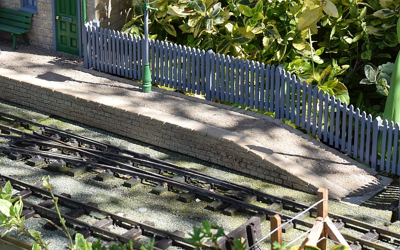

Looks great - presumably a coat of paint helps with durability.

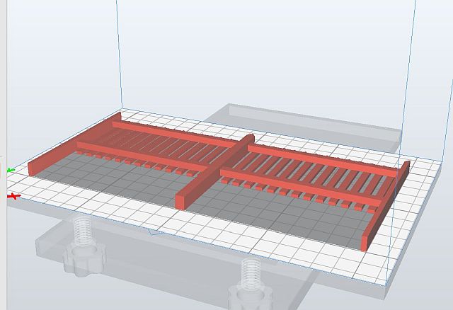

A couple of questions. Did you need supports for the picket fencing or were the spaces between palings spanned OK by the printer? Are the parts on Thingiverse, by any chance?
- Posts: 6069
Re: 3 D Printing 16mm models
Rik,

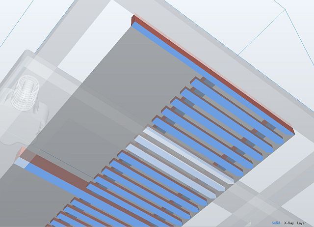

I printed the fence modules 2 together and face down without support. The posts are actually halved so they that just glue side by side subsequently.
In Cura, from the top:
In Cura, from the bottom:

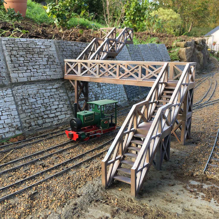

Just catching up on this thread. So much inspiration here, having seen some of Trevor's models close up I was already eying a 3D printer as something to learn for a winter project (as if I need an additional one!) No doubt about it, I'm going to have to do it!
4415 looks fantastic Trevor, I love it.
The bridge is extraordinarily impressive - 1.3kg, how long did that take to print? It looks just the part, the modifications to take pedestrians up higher than the Tan-y-Bwlch prototype are very much of a piece!

Thanks Simon, How long to print? - about a week almost non stop. Each of the floor sections took just over 4 hours, and most of the side pieces 3 and a bit hours. The stair cases were quicker as the sides were printed as separate lengths and the treads as individual treads. The sides incorporate slots to locate the treads.SimonWood wrote: Sat Oct 03, 2020 6:17 pm Just catching up on this thread. So much inspiration here, having seen some of Trevor's models close up I was already eying a 3D printer as something to learn for a winter project (as if I need an additional one!) No doubt about it, I'm going to have to do it!
