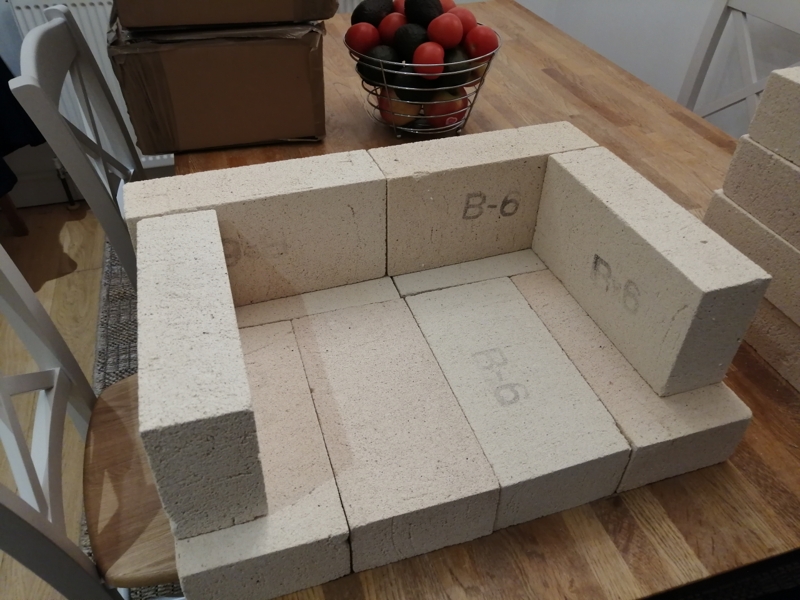

I am finding silver soldering and any work that requires heating up easier now due to the use of insulating fire bricks which repel heat back into the part you are working on:
I cannot recommend purchasing these types of bricks enough for soldering work!
Re: 5" gauge 0-6-0 'Sweet Pea'
Posted: Sat Feb 22, 2020 7:49 pm
.... and no doubt, your wife recommends their use on kitchen tables!
Posted: Sat Feb 22, 2020 8:14 pm
by tom_tom_go
Peter Butler wrote: Sat Feb 22, 2020 7:49 pm .... and no doubt, your wife recommends their use on kitchen tables!
I did demonstrate to her how well they insulate heat on the dining table, beats soldering in the workshop in this horrible weather with the constant wind and rain!
