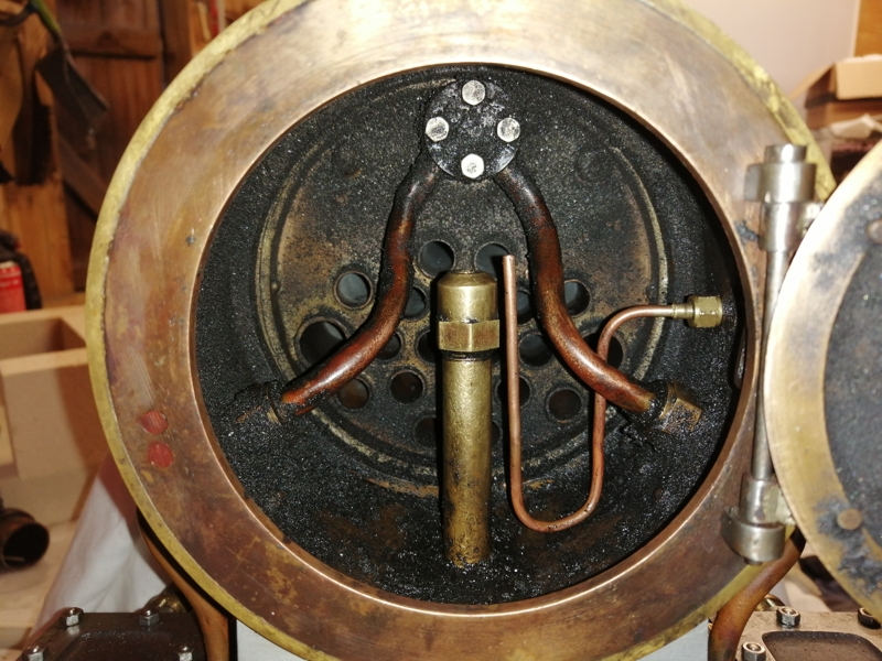

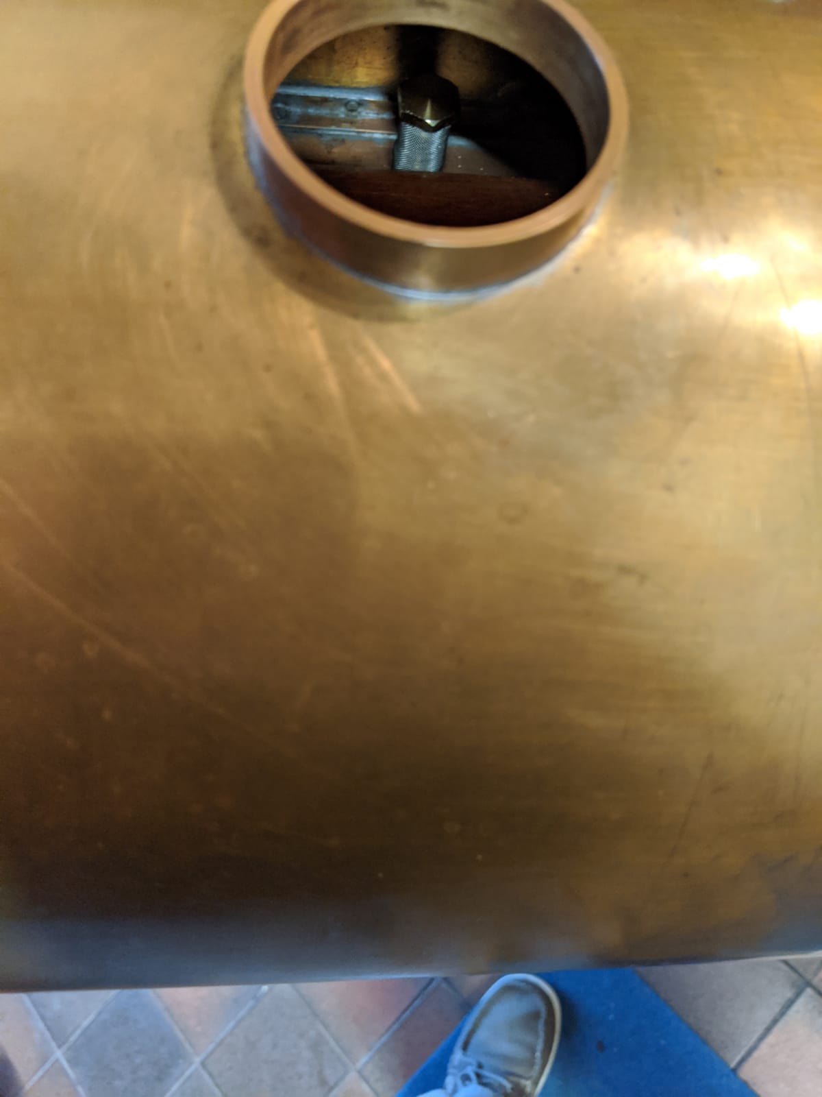

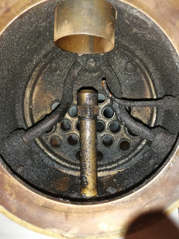

While I am waiting for the saddle tank and chimney to return I have started on some other projects on the loco.
As Running at my ME club requires the use of a spark arrestor when pulling passenger services I have started to think about how to install such a device that is not an ugly looking mesh cover on top of the chimney that dampens the chuff.
My first idea was to fit stainless steel mesh inside the firebox to block any deposits going down the fire tubes (bake bean can tin used as a template before cutting up expensive stainless steel mesh):
I got the idea from looking into full size steam locos that use a 'brick arch' (one of the joys of larger scale steam is you learn about stuff like this), however, it was pointed out to me by those more in the know that the mesh would be subject to extreme heat and likely to block easily.
After some more Internet searching I found pictures of mesh cones inside smokeboxes. Here is the smokebox of my loco (note the chimney pipe is just a piece of similar sized steel tube, it is not fixed in place hence why it is not straight):
The steel mesh cone would need to be able to slip over the blower pipe (on the right in the picture above) but also fit the outside of the chimney.
Here is my first attempt:
It is a bit crude and held together with steel wire (mesh is difficult to shape unlike the paper mockup ones I made!)
The blower pipe is not in the ideal place for fitting a cone over the blast pipe so I have decided to remake this and make a better cone.
Only way to learn is to have a go and improve...

Re: 5" gauge 0-6-0 'Sweet Pea'

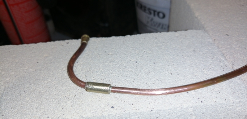

As I did not want to buy new pipe or nipples for the blower (some days you just want to get stuff done and not wait for parts) I made a brass sleeve from some brass rod I had in the bits box for the existing pipe and then silver soldered on additional copper pipe:
Oops, what did I forgot to do? Yep, I forgot to add the union nut and while I tried to file down the brass sleeve on the belt sander I spilt the pipe making the whole piece useless.
My second attempt also failed as I used a piece of larger diameter copper pipe as a sleeve but during soldering must of soldered the passageway as it was blocked even when connected to the airline!
After walking away from it all for a while I had another go but this time I salvaged the nipple from the original blower pipe (cut and drilled it out) and made a new pipe from scratch, success!
Blower pipe on test:
I am finding silver soldering and any work that requires heating up easier now due to the use of insulating fire bricks which repel heat back into the part you are working on:
I cannot recommend purchasing these types of bricks enough for soldering work!

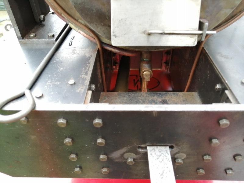

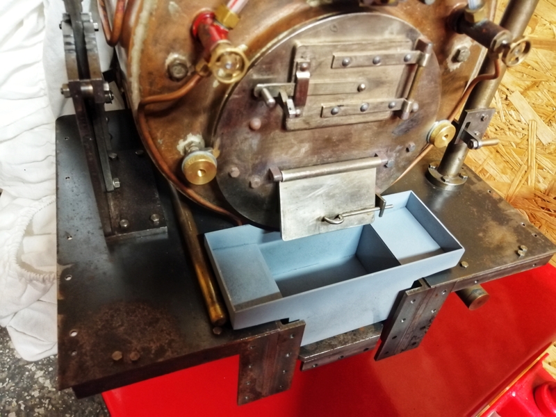

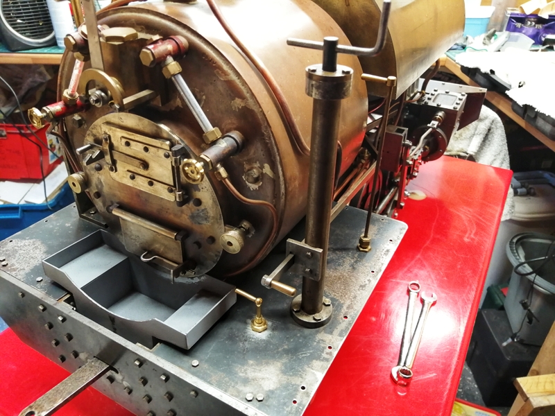

Another project is dealing with ash collection while the loco is in steam.
I bought this laser cut steel box from Blackgates Engineering a while back and it is meant to fit the 'Sweet Pea' chassis, however, as the rear bracket for the coupling bar and buffer beam was installed higher than in the drawings you cannot remove the firebox with the steel box in position as it would knock against it:
The solution I decided on that did not disturb the chassis setup was to cut an identical semicircle on the other side of the steel box so that the firebox could slide out:
When I find a suitable narrow gauge style coupling that can be bolted to the buffer beam I will buy and fit it so the steel box can be little lower in the slot in the chassis and not sit on top of the coupling bar as can be seen in the last picture.
The box will be stripped of the grey primer used to protect it from rusting and then chemically blackened.

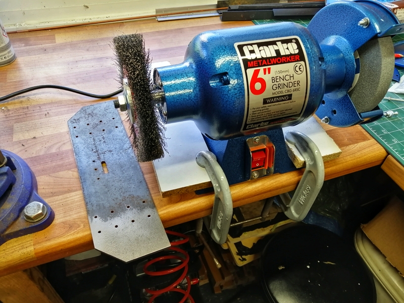

I bought a new bench grinder late last year, however, I only got it out the box this weekend to try it out!
You can see how effective the metal wire wheel I have fitted is at making a start of cleaning up one of the buffer beams of the tender.
I can get on now with getting the tender chassis cleaned up and put back together.

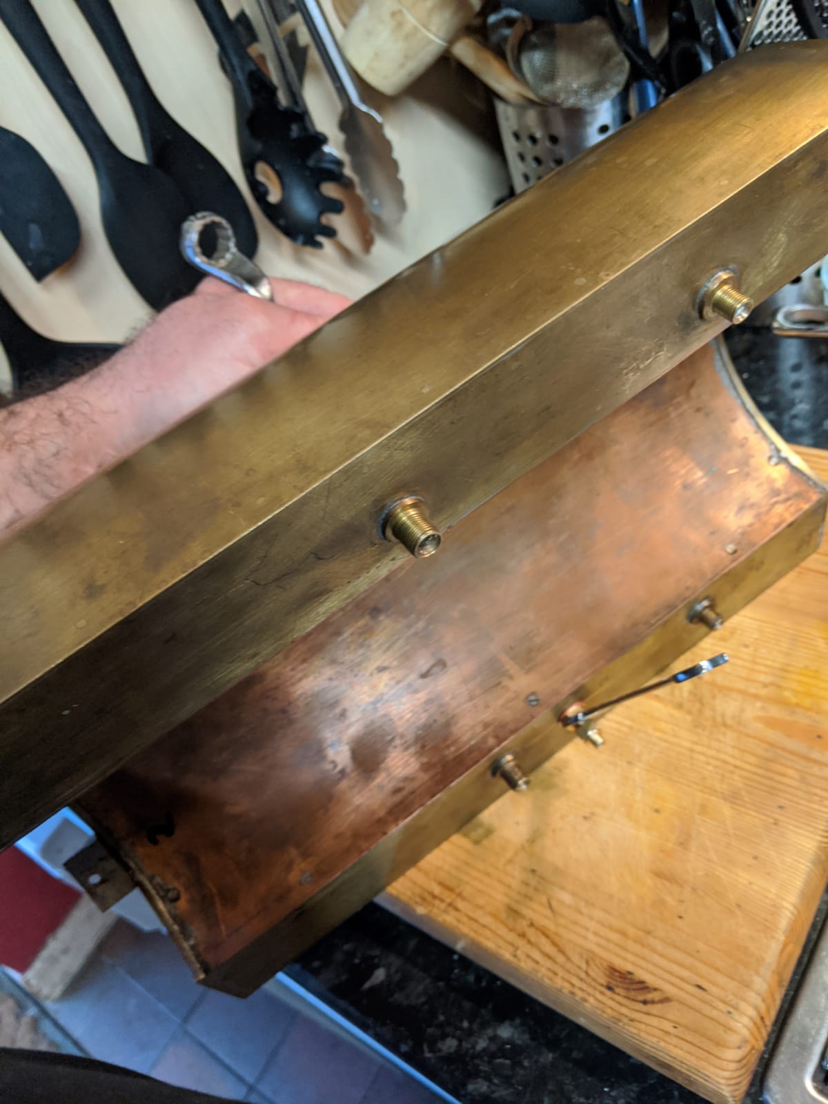

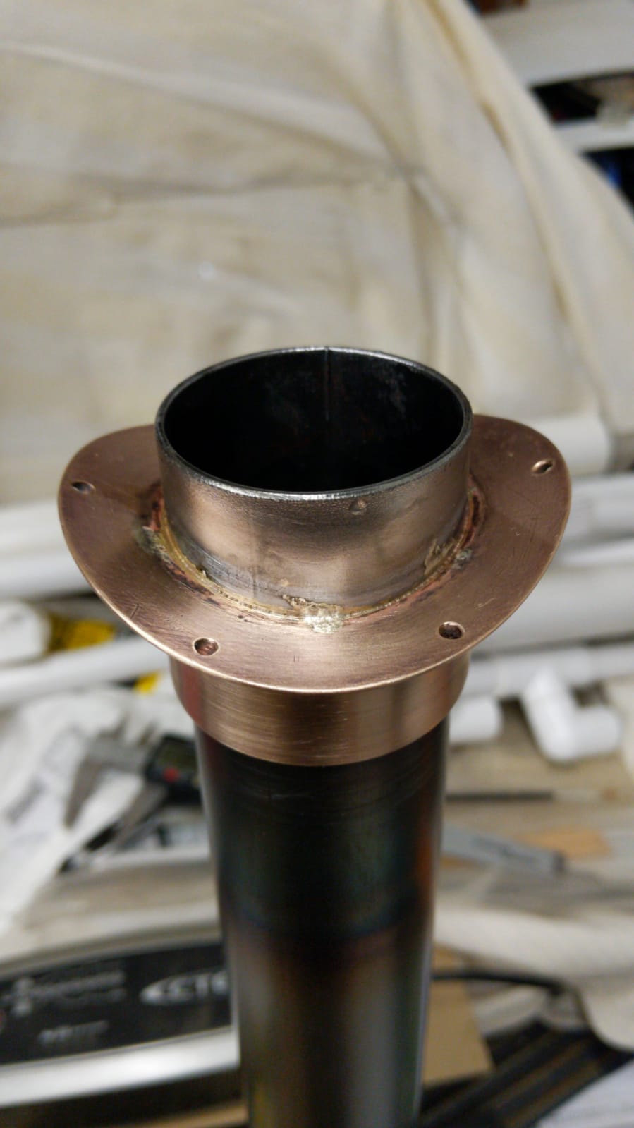

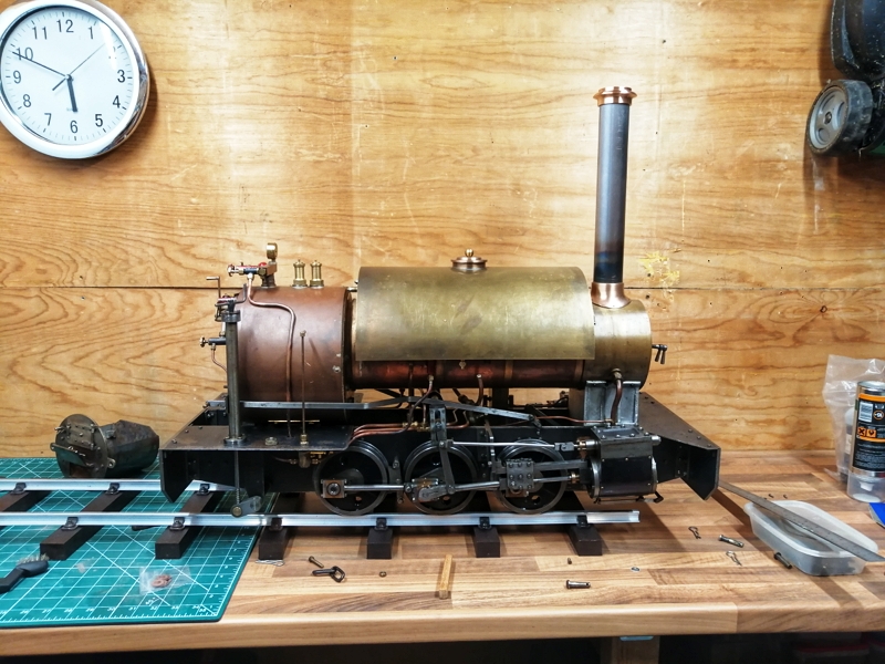

I should be getting my larger chimney back tomorrow along with the saddle tank with the new water connection fitted (here are some photos from my friend who has done the work):
Now this is a narrow gauge chimney!
Chimney base brazed on:

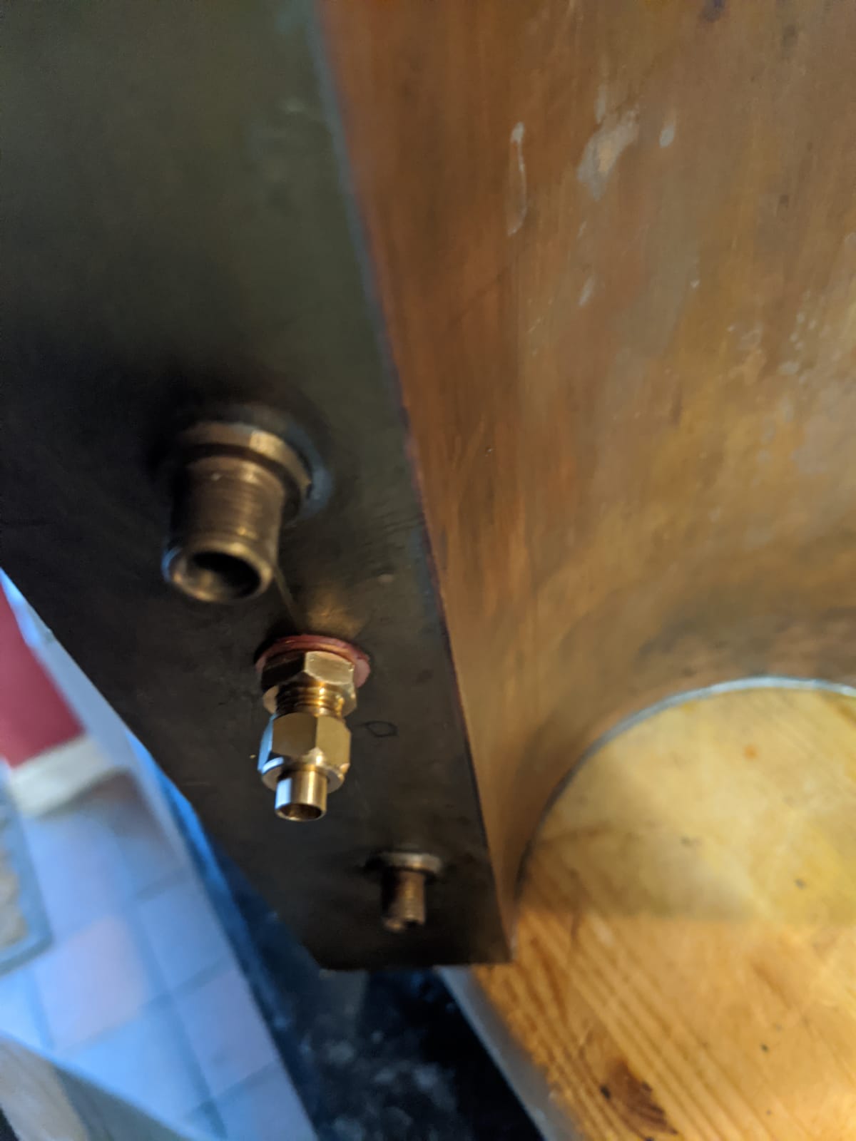

New connection for the injector water feed fitted to the saddle tank:
Fitting the connection:
You can see the new water filter for the injector water feed in the saddle tank:

Re: 5" gauge 0-6-0 Sweet Pea
I did a quick trial fit of the chimney and saddle tank this evening:
Now I can get back on with finishing the injector install and having a trial run before the club track opens up to the public at the end of March.
