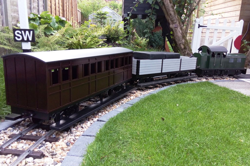

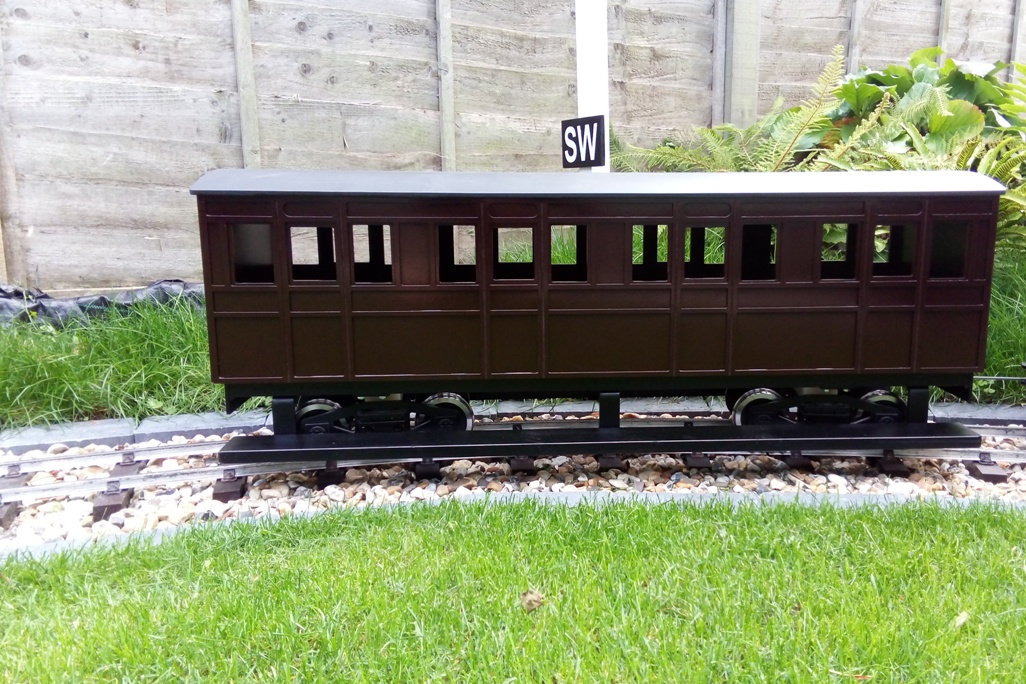

As if the new point wasn't enough excitement, I got my new carriage and have had a chance to test it with and without passengers.
Here is is with loco and driving truck/open wagon.
It needs the trim painting and logo, 1st and 3rd class lettering and a few other embellishments. I'm going for GWR livery.

Re: The Circle Line
Oooh! that looks nice. GWR livery will suit it. I may have to stop following this thread or I will not be able to resist 5inch gauge.

Re: The Circle Line
Nice coach there. Looks the part.
