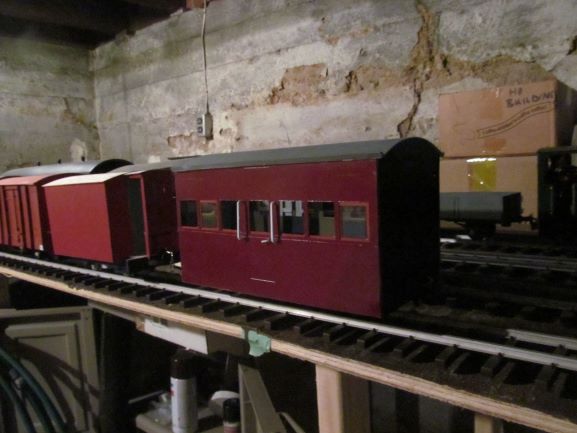

I bought myself a bit of time on the carriage project by building another closed wagon, which turned out to be roughly the same size and design as the previous one, but I made the (non-functional) door mechanism a little differently. One thing I learned years ago about strings of identical wagons is that, unless they have just come out of the works as new builds, there are always tiny little differences between them. This is especially true of narrow gauge railways where there seemed to be a migrating pool of bits used to keep less decrepit vehicles operational.

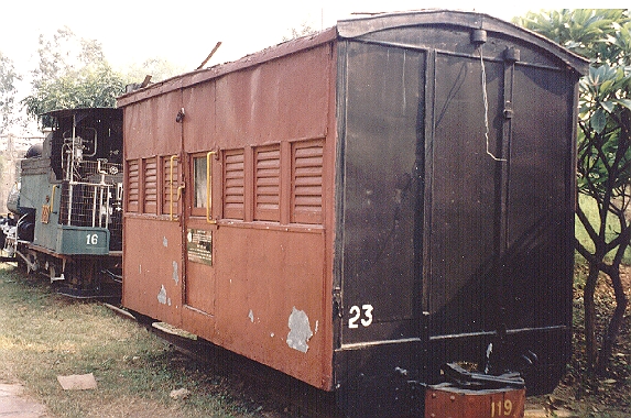

The carriage project has re-emerged thanks to encountering the above photograph of DHR No.119 built Tindharia 1902, and retired in 1968. I will add a picture credit when I rediscover the photographer's name. It looks as though the last time it was repanelled it got plywood, galvy sheet, or aluminium sheet put on rather than renewing it the old fashioned way. CIE did much the same thing with some of its NG stock, so I am going to go with the flow and do the flush sides - they are easier to model anyway.
I think my version may be a tadge bigger the original, as mine is a scale 13'6", which is about 7/8th of an inch longer than the wagons. I am also going for drop lights (non-functional in this case) rather than sunshades. I have started on the wooden frame, drew out the sides on Bristol board, and raided the Binnie bits box for W irons and wheels. The underframe is separate in this case so I can go ahead and paint it before fitting it to the vehicle, rather than leaving the running gear until last. Photos when I get a bit further on.
Peter in VA
Peter in VA

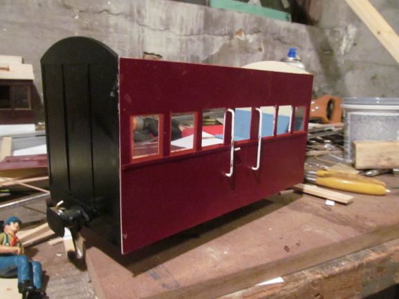

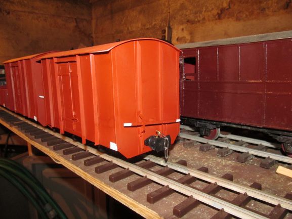

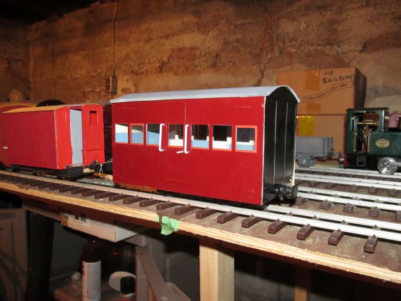

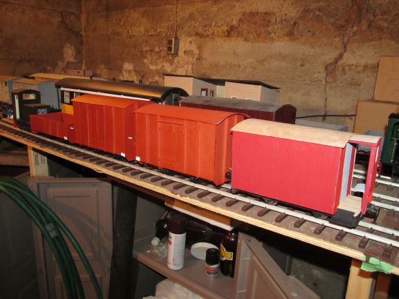

The wagons have received a few improvements. Dummy handbrake gear has been fitted, and the location marked for the benefit of shunters and brakemen by the strategic use of white paint.

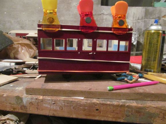

The main project at the moment is a four-wheel third based on a DHR vehicle originally built in 1902. Here is a three quarter view of the half completed carriage. The handrails and door handles are just lengths of cut to length and bent to shape (or vice versa) and painted before being glued into small holes drilled in the Bristol board structure.

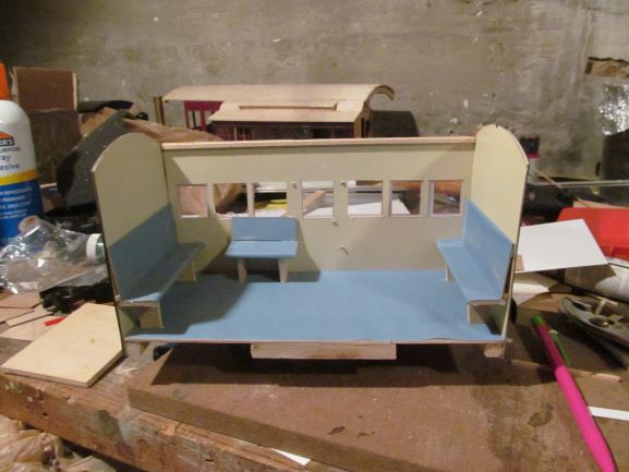

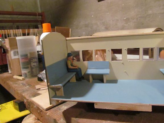

For once I am actually getting on with the interior... The 'lino' and the seat covers are shelf paper scrounged off the Missus.
So how do the passengers fit? The figure is a bit small being LGB, but there is enough room there that a proper 5/8th scale person would fit. Having established that it is time to glue t'other side on. The three clips are holding the top rail in position whilst it dries. The rubber bands are holding the side on whilst it dries. This side will have short handrails thanks to the floating pool of bits theory of narrow gauge railway maintenance - or the lack of it!
Flash photo as a bonus. Not that great a shot, as it washes out the colour, but it gives you an idea of what it looks like on the rails. Bit of touch up work needed with the paint. White lines are an occupational hazard when one used Bristol Board. A felt marker or a steady hand with the paint brush will fix that.
That's it for now!

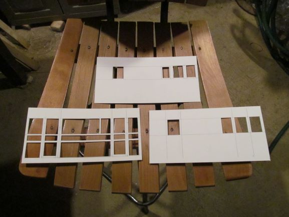

Mail/Guard's Van

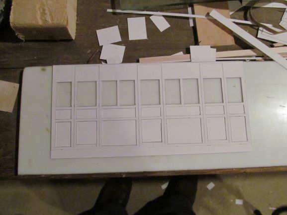

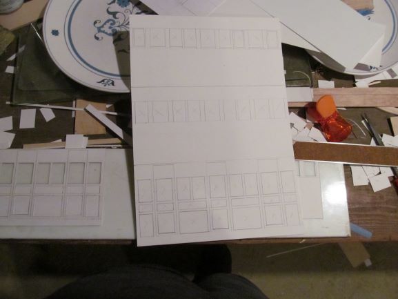

This one is another mésalliance between a KSR prototype and one from the DHR. As usual the body is Bristol board, and as the interior is relatively hidden I decided just three layers - panelling, and then two laminations for the body itself.
Here we have the three layer. Drop light layer (top); outer layer (bottom right) and panelling (bottom left). Ready for painting between services on Sunday, and lamination on Monday. When finished the side should look like this, but in brown and cream, with a red panel for the TPO end's post box. The ends have already been laminated as they are a simple paint job - black on the outside and cream on the inside. Guard's end, with its lookout windows shown. The third saloon now has its roof seen from the short rails side... Here is a flash pic of the same vehicle... I do need to touch up those white lines, but that is a five minute job for when I do not have time for anything more serious.
And I forgot to include a piccy of the dummy brake gear on the vans when I mentioned that a couple of posts back, so here we go... After the mail van a couple of more wagons will be in order, then another carriage. Then I really need to get some track laid!
That's it for now.
Peter in Va

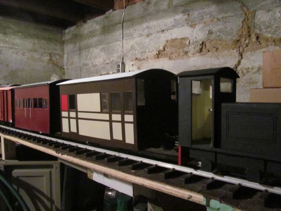

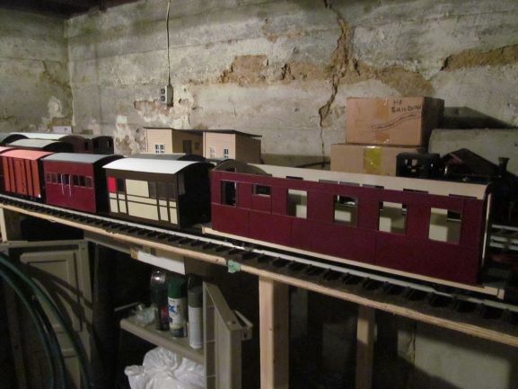

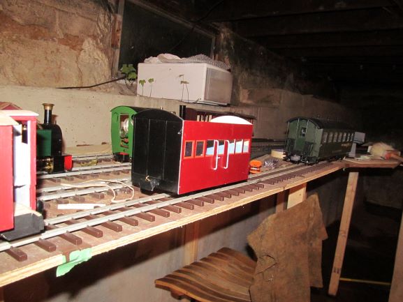

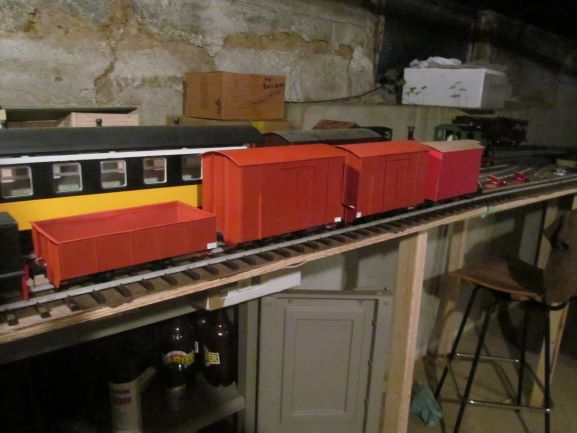

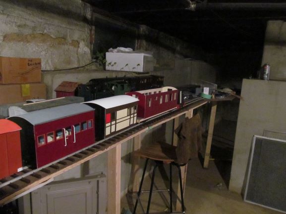

I have been able to get down in the basement again the last couple of days and seem to have got quite a bit more done without really trying.

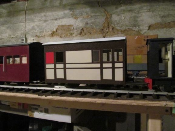

I am a long way on with the van with the partition between the mail and guard's compartments in position, and the roof rolled. Lots of little finishing jobs at this stage - handrails, roof stretchers, maybe a basic interior, and of course, the essential letter flap. Here is a three-quarter view showing the guard's end windows. The Kalka-Simla influence is winning at the moment, so it will also need some brake pipes when I can cobble some up.
Third Class Coach
This vehicles dimensions were guestimated off some 1903/4 photos of the KSR, so it is only intended to look the part. Stage 1 is to draw out the needed parts on 100lb Bristol board. Three laminations here - panelling, body, and then droplights. Then the cutting out begins. In this case the panels and the main body have been laminated early on, as following KSR practice the body is going to be cream without the panelling being picked out in brown, though the window shades will be brown. I cut the windows and panelling before dividing the sheet into the three layers as that seems to make it easier for me to line things up. The SAS Coach
The SAS-SAR Sachsen Wagonfabrik coach is being worked on again. Size wise it does not overwhelm the DHR/KSR four wheelers, though weight-wise it may end up marshalled towards the front of the train as it is plywood not Bristol board. Here is the FET's passenger stock. DHR saloon as running in the 1950s; hybrid DHR/KSR mail and guard van; and the SAS coach. And here is a view from the other direction.
Work Outside...
has begun. I suppose I ought to start a separate thread for that, but the surveyors were out with a spirit level and blocks of wood getting some preliminary gradients today. It seems that 1 in 33 will do the trick, so things may well end up more KSR than DHR.
That's all for now!
2-1
Peter in Va
