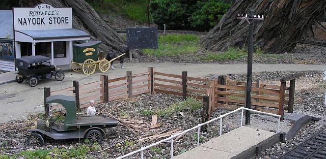

Post by LNR » Mon Sep 26, 2016 8:28 am
Well, Nayook has been ringing to the sound of a squaring axe and an adze, as a local fencing contractor set about constructing the new stockyards.
Rain stopped play, but there was time to check that all was correct and to railway clearance standards.
The contractor has promised to return as soon as possible and complete the job, a brown paper bag was seen to be passed rather slyly to him by a Shire Rep. no doubt something about specifications (wink, wink.)
Post by Soar Valley Light » Mon Sep 26, 2016 7:00 pm
Outstanding shots Grant. I looked more than once at the second shot to be sure it wasn't a 12" to the foot shot!
Posts: 7982
Post by ge_rik » Wed Sep 28, 2016 7:42 am
As ever, Grant, I am envious of the realism your railway creates.

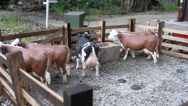

Post by LNR » Wed Sep 28, 2016 8:58 am
Thanks Andrew and Rik.
Fencing completed today, gate swung, water trough in, Shire man happy.
A few cattle were given a drink, they seem to approve of facilities.
Posts: 5713
Post by Peter Butler » Wed Sep 28, 2016 1:39 pm
Excellent again Grant... the 'girls' look very comfortable in there and have left their mark!

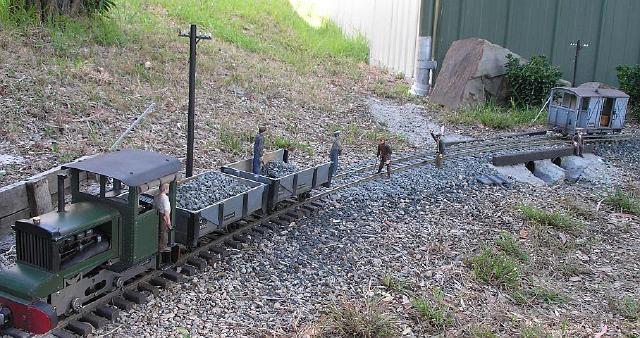

Post by LNR » Wed Nov 02, 2016 2:33 am
The Blackbirds always conspire to keep the Per-way gang in work.
The gang replacing ballast at the Warringine Creek culvert.
Post by tom_tom_go » Wed Nov 02, 2016 7:28 am
Is that some sort of motor mule on a RH Katie chassis?
Posts: 5713
Post by Peter Butler » Wed Nov 02, 2016 10:13 am
Whatever it is made of it looks just right and if you blank out the shed in the background, the scene is so real.
Posts: 1888
Post by LNR » Wed Nov 02, 2016 10:44 am
Thanks Peter, Tom the loco is a home build on a Katie chassis. I took inspiration from the Baldwin petrol mechanicals (Moelwyn) and Fowlers.
I particularly wanted an open engine area if possible, so the battery size determined the sloping box. Unfortunately It's so restrictive I've given up on NiMH and it has been running with a Lipo. More voltage and lasts as long as a tank of fuel probably.
Post by tom_tom_go » Wed Nov 02, 2016 10:53 am
Thanks for the info Grant, looks great.
What motor/gearing is it running? I am looking to buy/build something that has good slow running for shunting.

Great model - you've done such a good job - I thought it was Moelwyn when i first saw it - so thumbs up there!
Posts: 1888
Post by LNR » Wed Nov 02, 2016 11:53 am
The Loco has a 540 size motor(with a flux ring) and drives a belt reduction to a grease packed worm reduction box axle mounted. All home made. It pulls very strongly, only limited by it's weight. Can be quite fast too. It's used very frequently and is built to last.
