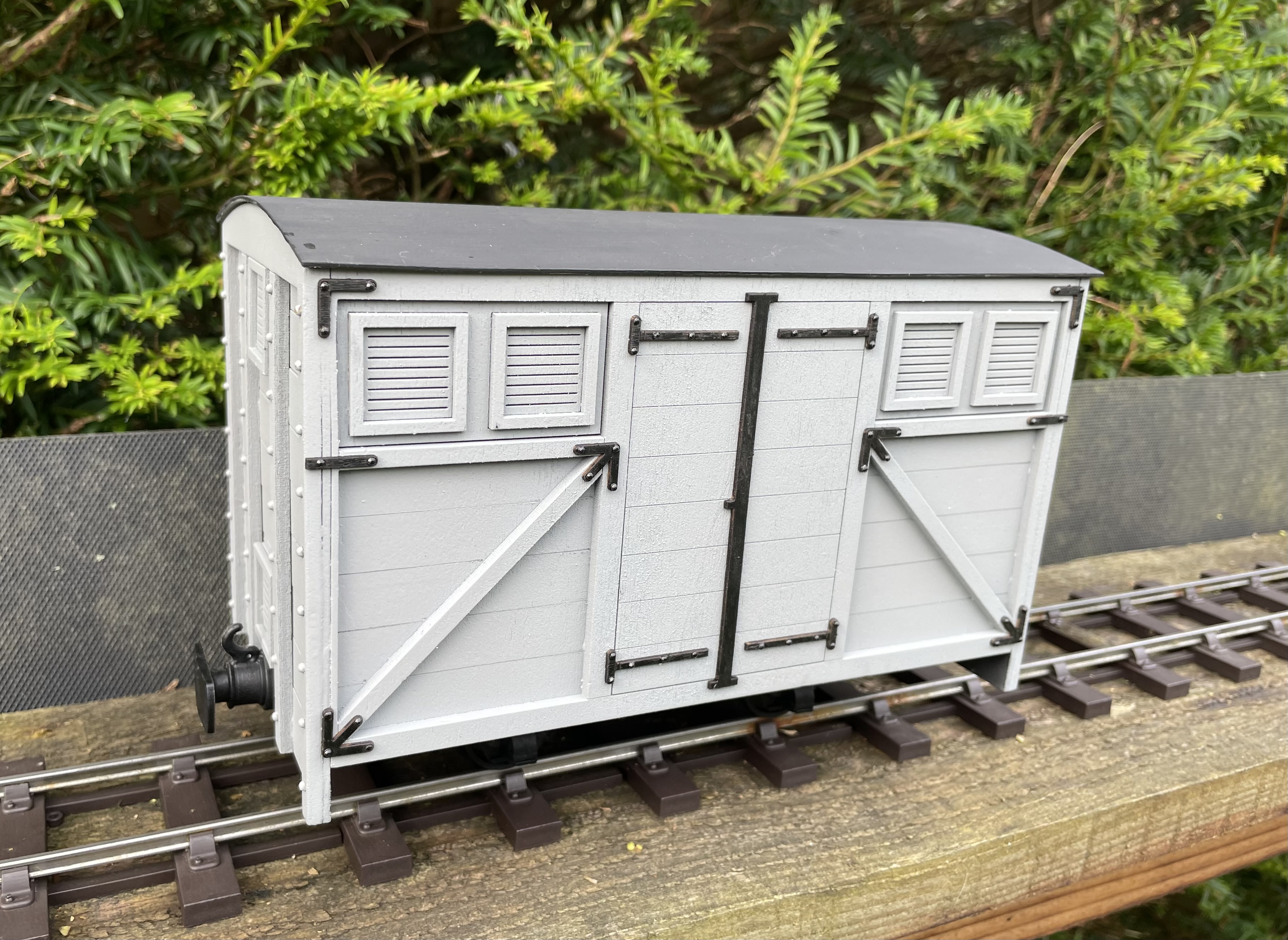

Earlier in this thread and in a separate one (viewtopic.php?t=15186) I reported the distortion that happened to a Woodleigh Engineering WLLR when I ran it on a day that was too warm and sunny.
Joe sent me replacements for the wagons I had bought and in the recent spell of wet weather I finally got around to making them up.
I have incorporated a pair of pieces of acrylic sheet in the hope of keeping the body in shape:-
I hope these will not appear too obvious when the doors are open.

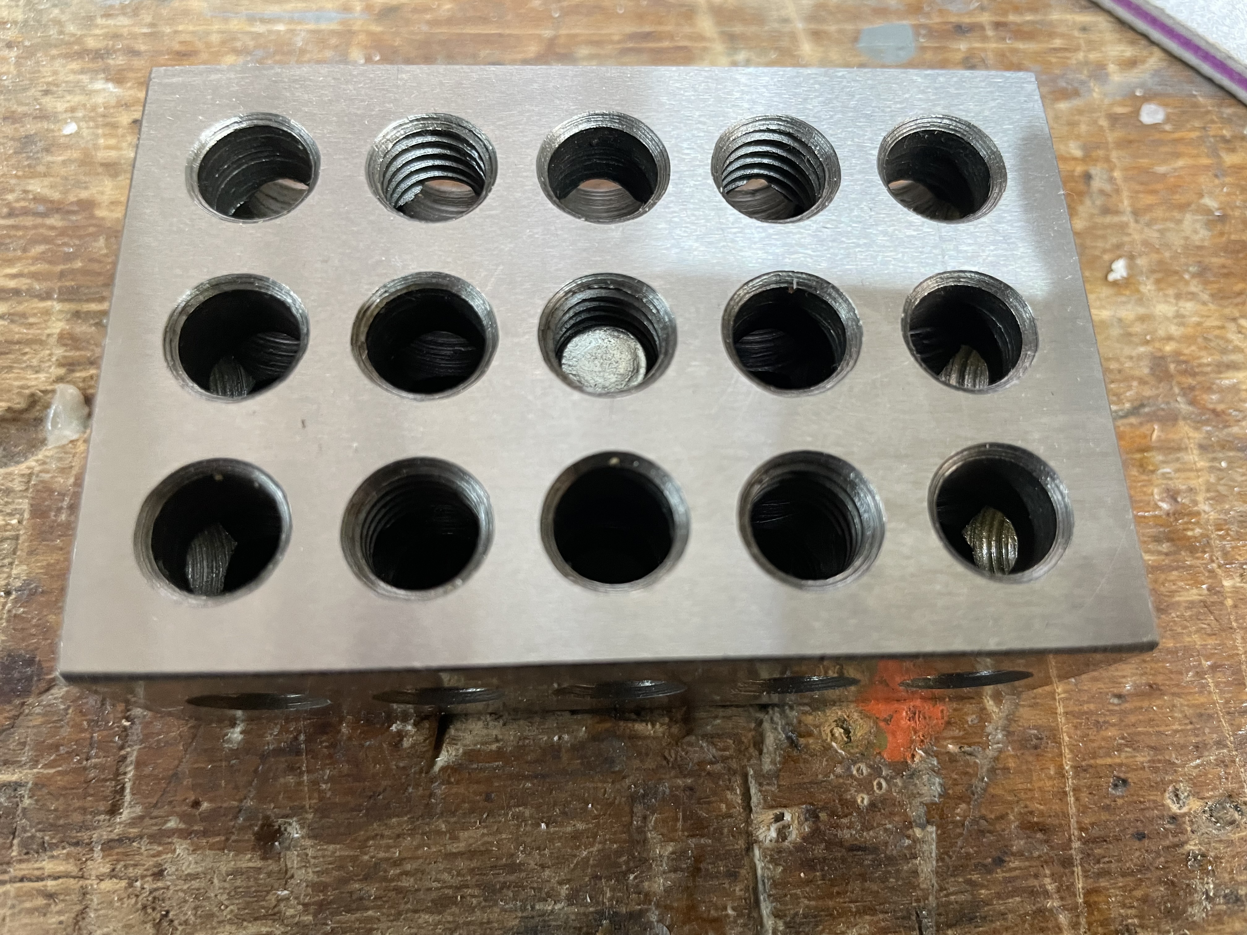

it's two 1-2-3 blocks between the acrylic pieces which are held by a couple of tiny magnets!

by GTB
philipy wrote: Tue Sep 09, 2025 2:58 pm Me too... I'd never heard of them before either
Originally designed for setting up, or holding, workpieces in metal working. eg milling machines.
Like v-blocks and parallels, they come in pairs and a choice of sizes.
Not something you need to use often, but when you need them, nothing else will do the job.

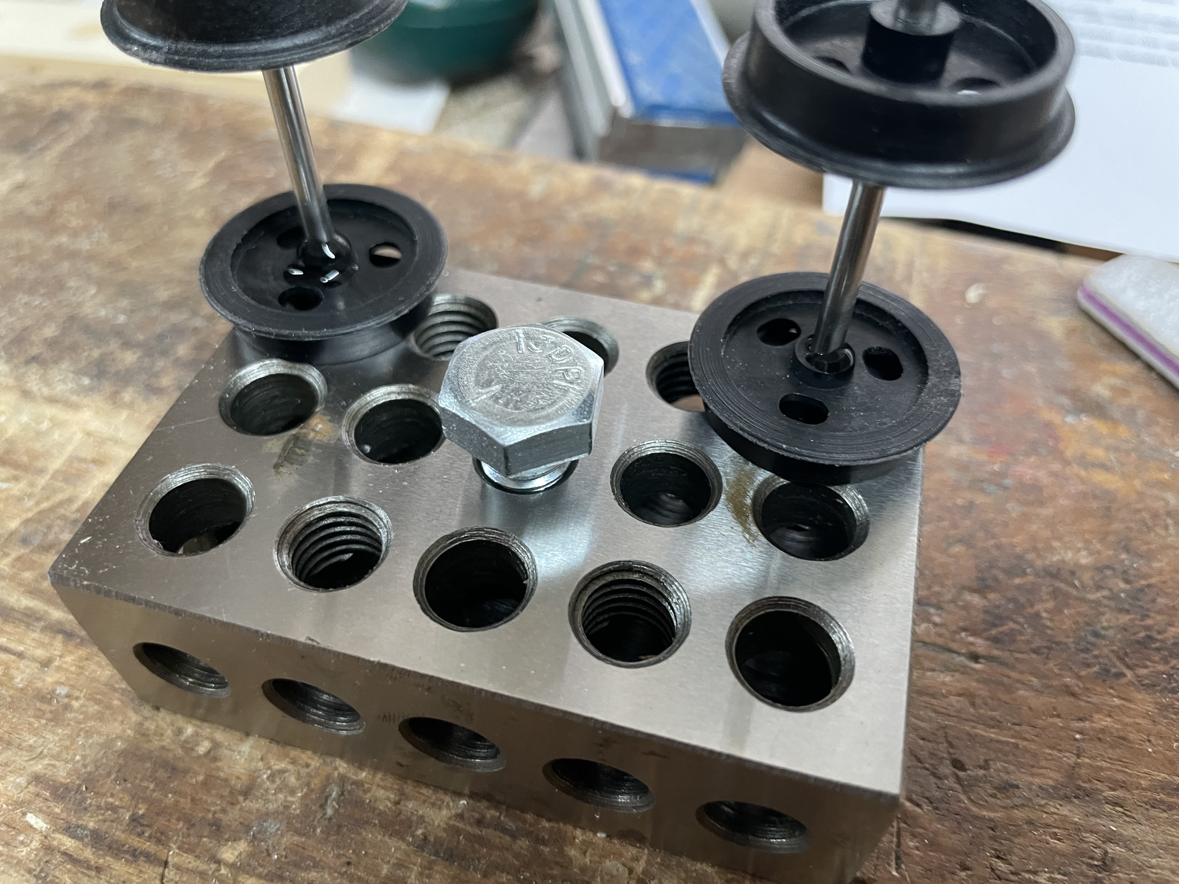

In a recent post I showed a way of setting the end length of axles. I'd thought one of these blocks with a suitable bolt would be ideal, but could not find a suitable bolt. Then yesterday going to Cardigan for shopping I realised I knew a place where you can buy all types of fixings, hardware etc, with the result that Ibought one bolt the right size.
The block sits over an end stop hole in the bench to accommodate the head of the bolt. Measurement and calculation gets to what depth the hole should be, it's then very easy to set the axle ends to the correct length for the desired back to back
The block is also a useful stand to hold the wheelset whilst glue dries holding the wheel in place. Invert and repeat.
