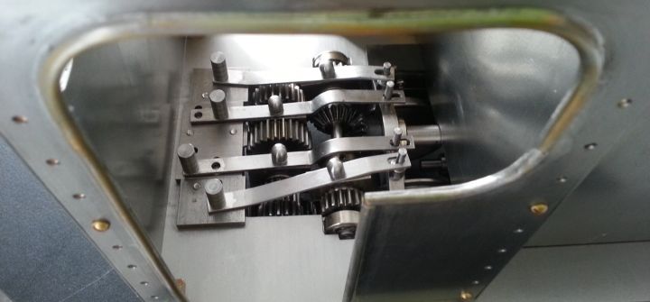

I've been sorting out the gear lever arrangement. Here's a view through the cab door way.
The pins on the ends locate the levers in the right position. The knobs in the middle are for fingers to push/pull the levers. The two outer levers are forward (nearest), and reverse. Each lever has an in-gear position and a out-of-gear position. The two inner levers are for the different ratios. First - Neutral - Third, and Neutral - Second.
In the picture the loco is in First gear, but not in either Forward or Reverse. This way the loco can be pushed along

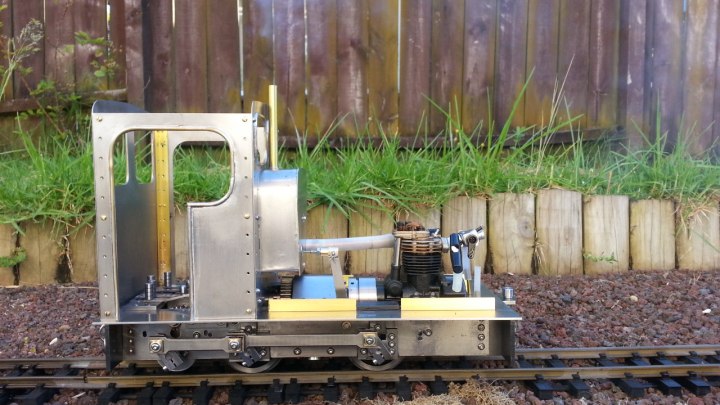

Had a great run yesterday. The run was to test the huge new muffler / silencer box attached to the cab firewall. There's so much expansion, that the exhaust gasses are quite cold exiting the exhaust stack. The muffler is very effective, there's little exhaust noise. However, there's a lot of mechanical noise from the motor itself, and there's a ringing noise from the muffler as it flexes, I'll put a stay in the middle to stop it.
The video was taken shortly after starting, I was draining off the oil until the good stuff started coming through, then reconnected a tube to the primary gearbox. I topped-up the fuel tank three times with the engine running. I felt like the run was about an hour. The loco went up and down the short section of track in all three gears, third is really rather rapid!
I measured some temperatures during the run with my eBay IR handheld thermometer:
I got cylinder head temperatures of 150 - 190 deg. C (300 - 370 deg. F).
And, the muffler box itself was only 70 deg. C (160 deg. F), which is lucky as it's only soft-soldered.
The motor wouldn't start with the exhaust stack fitted, so I replaced it once running. It's a slide-fit in the muffler

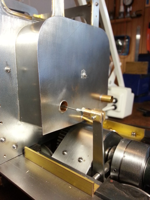

During the Christmas holidays I finalised the clutch mechanism. There is now a lever in the cab. The control rod passes through the silencer!
Here is a short video of the operation.

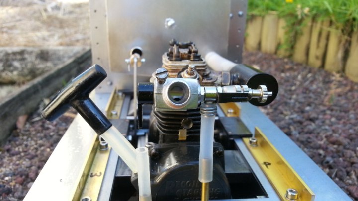

A great run yesterday evening up and down a short section of the railway line. For the first time I could stand back and watch the loco run with the clutch held in position. With the head-on sunshine the exhaust smoke looked great and voluminous. The loco was run in 2nd gear all the way, a scale 10 mph.
The engine was run without the rocker cover so I could see what was going on. I'm giving the rocker gear a squirt of fuel, to oil it before each run now.
Someone on the above aircraft forum was not believing that 5000 rpm was still an idling speed, but, it is for R/C car engines. Here is the throttle position with the engine actually running, it won't run any slower.
During the run.
1:30 video of the run once up and down the line at 10 mph

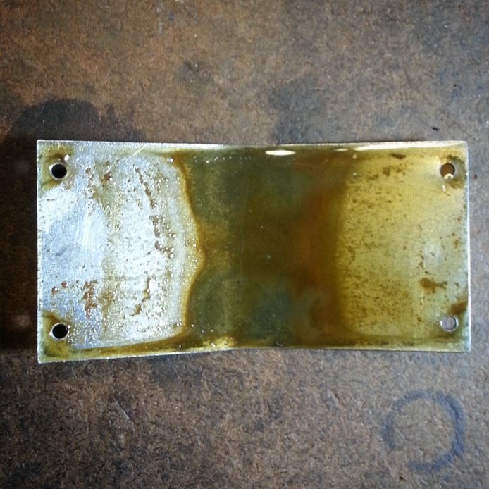

I'm starting to think about painting the loco. Last week I test painted the exhaust stack with automotive spray paint intended for painting engine blocks. I "stoved" it in the oven for one hour at 115 deg C, then left it to cool overnight. Before and after that I had been baking it in the summer sun all day. I ran the loco this morning to test the paint, it survived ok. With my arrangement mainly water-like droplets come out of the exhaust. I think I'll apply some sort of wax to the horizontal surfaces where these droplets strike

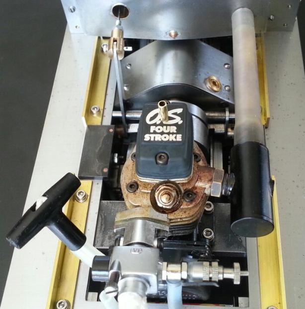

Here is the spring loaded clutch lever mechanism, and the new exhaust drain pipe. The pipe passes by the rear axle and central drive shaft and drops the oil and condensate onto the track sleepers.

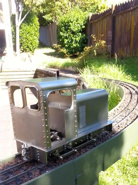

The loco will soon be at the painting stage.
Today I cut-out the ventilation opening on the side of the loco, and have soldered a stainless steel mesh grille over it. I was going to cut one on either side, but perhaps an asymmetric look isn't so bad. This way is more discreet as it isn't so easy to see inside.

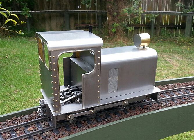

As I'm waiting for the cooling fan. I decided to add a headlight to the loco. This light was made from the lens, reflector, and bulb assembly of a small torch (flashlight). I'm fond of brass, so I'm thinking of keeping it polished. The back plate is steel, and that can be painted.
It's surprising how long it took to make. The outer shell is 0.5mm brass sheet and had to be annealed and rolled around a former. Then it had to be wired closed and then silver brazed. The 1.2mm brass end pieces had to be cut-out, then they were soft soldered to a chucking piece, then turned to size to fit the outer shell. They were then silver brazed one at a time into the shell and turned on the lathe. The ends were drilled and bored for the reflector and lens.
This is a large light. It officially fell off a much larger NZR locomotive, and was pressed into service.
