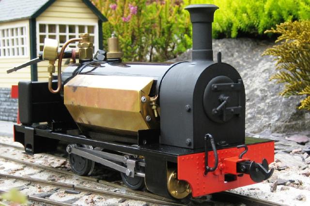

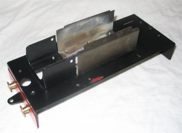

The original Mamod SL combustion chamber was tack/spot welded together, and slide onto the chassis frames and was held by 2 screws & nuts to the cab front. This is Doug's PPS Janet combustion chamber (the Janet has no cab front so it just slides on top of the chassis frames).
The Roundhouse combustion chamber is riveted together.
The Mamod William was a straight wall riveted to the chassis.
What you can see is the old Mamod & Roundhouse use a thinner metal than the William one (my Mark II has a thinner metal than the William but it is still thicker than the old Mamod style). So that thicker metal riveted to the chassis is soaking up a fair bit of the heat output from the burner.

Looking at the William you can see the way combustion chamber is attached to the chassis its acting as a huge heat sink.
Just a few simple improvements might make all the difference, for example simple washers between the chassis and chamber wall where its riveted would create a small air gap and cut down the direct heat flow.
