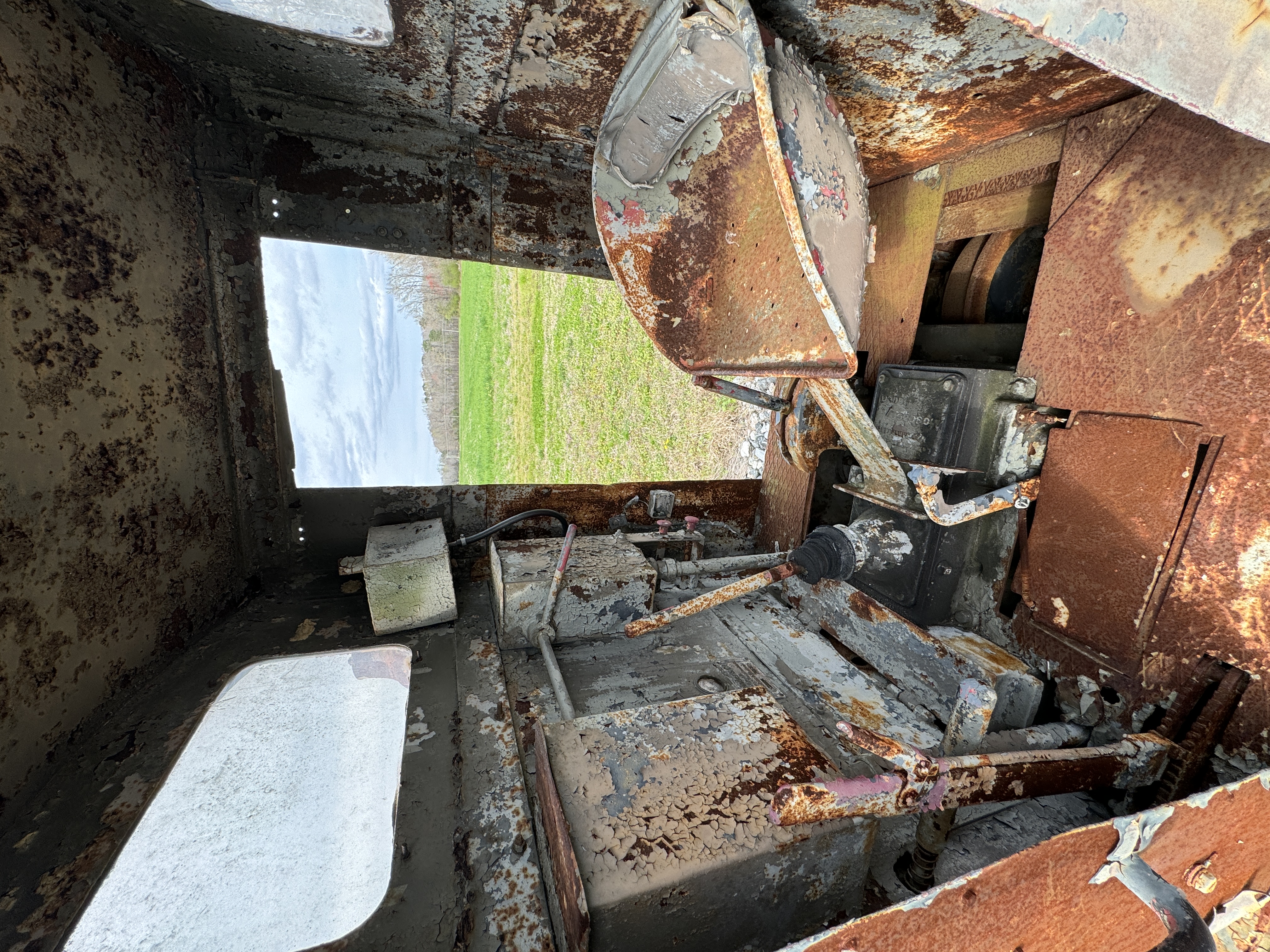

Back earlier in the month I said that I'd had no reponse from the museum re dimensions, but that was very unfair, I did get a very helpful response which promptly went straight in my junk folder and I've only found by accident this morning! I have of course apologised to them for not acknowledging it.philipy wrote: Wed Mar 13, 2024 12:43 pm I'm fairly happy with the overall proportions, but I've been a bit bothered about the actual dimensions and I've juggled them around several times. I even tried to make contact with the museum to ask, but there has been no response at all, which was a bit disappointing. Anyway I think I've settled on the final version ( till next time!).
I'm actually quite chuffed with my scaling of the original photo because, allowing for the inch measurements he sent, converting to mm and then scaling to 16mil:
The overall buffer beam width should be 64mm and I've got it at 63mm,
The door height should be 67.5 and mine is 68.5.
The door width is a bit out - it should be 26.75 and I have it at 30mm.
Overall, I think that isn't too bad.
However, he also sent me a couple of pictures, which I hadn't asked for, and one is a better view of the inside of the cab and I can see where the extra 3.25 on the door width is. The seat appears to be actually fixed to the back wall of the cab, whereas I have it about 3mm clear. Also, because the seat is fixed to the back wall, there doesn't seem to be any sign of the two back legs that I thought I could see on the original pictures! I'm too far along now to make any changes just for those little details, unfortunately, but it won't affect the overall appearnce too much.
The poor loco has been sadly neglected since the museum received it and is in a terrible state now, which is a shame. He said it was never properly primed last time it was painted and has just been left exposed to the sea air.

Wow. That is a sorry spectacle. You did amazingly well on those dimensions, Philip. My model is more of a compromise as I had to make it fit the HGLW chassis and cab.

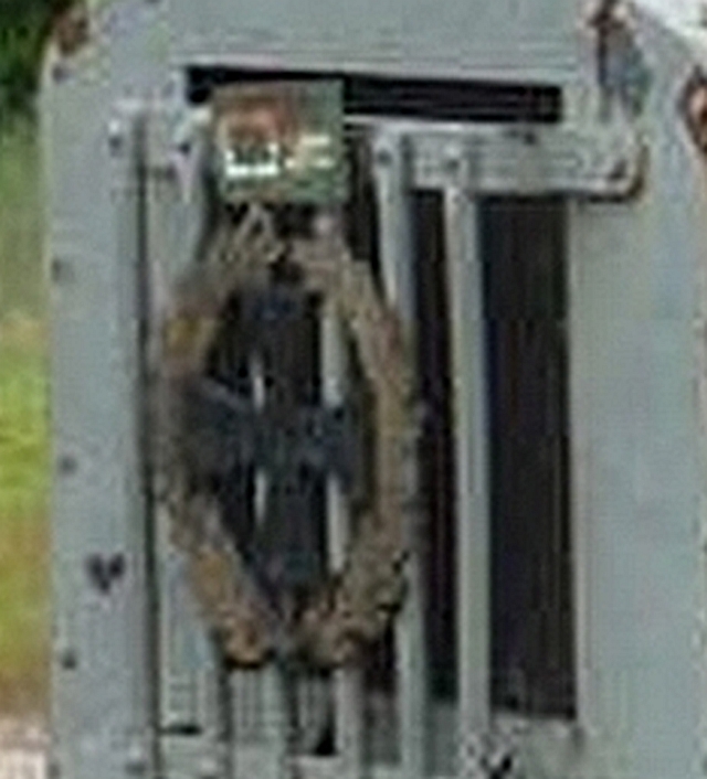

Next, a question for anyone who knows or wants to guess. The front of the loco is clearly wearing and an 'iron cross' surrounded by a wreath of leaves, and above it is a small rectangle which looks to have a picture/photo on it.
Any offers as to what it is? I'm tempted to think that it is a memorial of some sort, but it seems a very odd place to put a memorial.

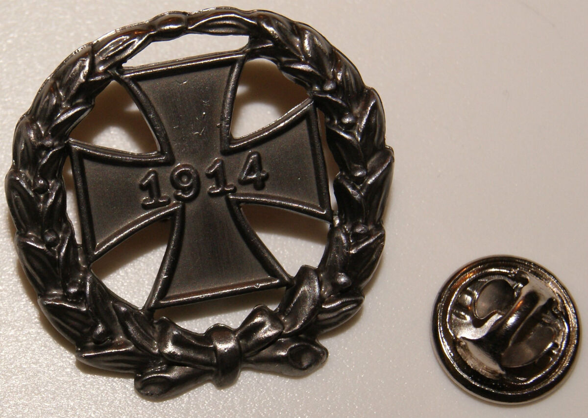

Looks like this, maybe? I've not found the significance of the oak leaf wreath

I'd not seen that specific pic, but there are loads of variations on the theme. It's the little plaque and apparent picture that puzzle me. TBH, I don't really want to put it on unless there is a good reason to, and I suspect that this is maybe referring to a wartime death somehow associated with this particular loco - a "Hero of the Reich" type thingy?

It's an iron cross and a laurel wreath, so it might be a memorial or a symbol of the locomotive's use. Searching "Eisernes Kreuz im Kranz" yielded similar results:
https://www.akpool.de/ansichtskarten/27 ... ichenkranz
Also, https://www.alamy.com/war-memorial-of-t ... 70378.html
Most wreathed iron crosses I've seen are either oak or half oak and half laurel, so it's interesting that the one on the loco is all laurel. The oak is a symbol of strength and longevity and closely connected with Germany.
As for the plaque above it, my best guess is a number plate unrelated to the cross and wreath. They don't seem connected at all in the clearer photo, and here's another Gmeinder with a number plate mounted in that location:

I've seen them with 1914 on as well.
Unless somebody can advise differently, I think I'm going to forget about it. I can't believe it was a standard fitting!

I don't think it was standard, and may be considered as a step too far, in authenticity?
I think I would leave it off.

I've seen a lot of Gmeinders at this point and only this one has it... Unless you're attempting to recreate this particular display, leaving it off seems appropriate.philipy wrote: Thu Mar 28, 2024 9:04 am Thanks Drew.

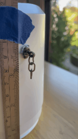

One of the things I've avoided till now is the question of the couplings. Obviously on the original photo there is a curve fronted bar and what appears to be a chain fixed to an eyebolt, but detail is difficult to see. The new 'rusty' pic is clearer and, by looking at the train behind, it seems fairly clear that they have link & pin couplings, so it looks as though a 3-link coupling but without a pin on the loco, is the answer.
Next point is that the loco coupling is lower than my standard coupling height. I did have thoughts of burying magnets in the front of the bar, but they will be about 10mm lower than the rest of my stock, so forget that one! So for now, I've printed and glued on the bars and turned my thoughts to the couplings. As an experiment, I tried completely printing the whole thing as one item, and to my amazement it actually works.
So, this is printed complete, no joins
I can't see it being strong enough for pulling a full train, but it's an interesting excercise.

Wow, that chain is impressive! Resin printed? I knew a guy who carved wooden chains like that out of a single block.

I have some printed coupling chain links from Jerry Irwin and can confirm their strength....philipy wrote: Sat Mar 30, 2024 1:10 pm Iron Cross & Wreath...gone, from the to-do list!
One of the things I've avoided till now is the question of the couplings. . As an experiment, I tried completely printing the whole thing as one item, and to my amazement it actually works.![]()
So, this is printed complete, no joins![]()
