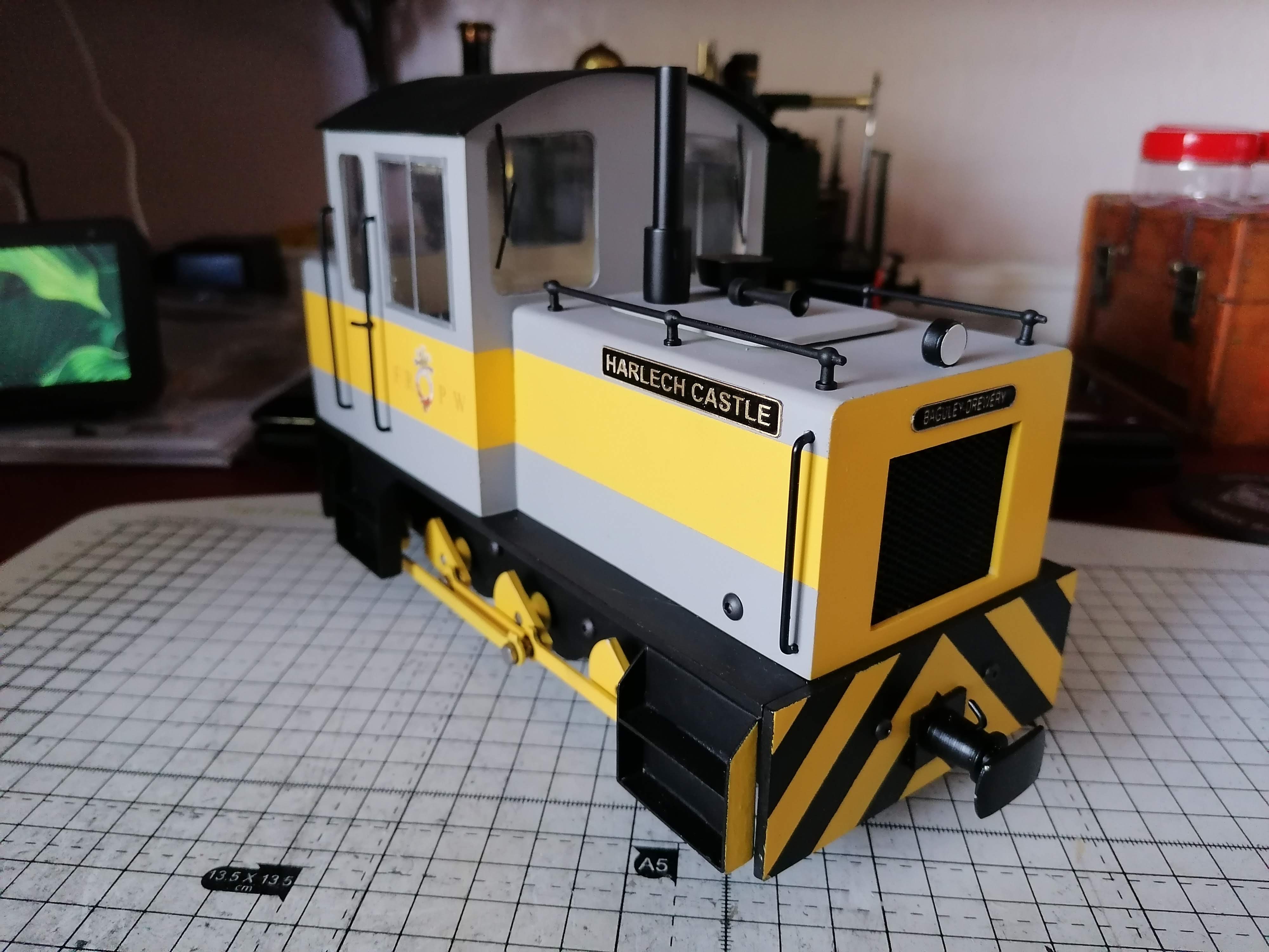

I made a very similar extension for an MFA 918 motor for a Castle Harlech I did back in 2020. I made the shaft on the lathe in brass with a grub screw to hold it to the motor and made an idler bearing holder for it to run through. Unfortunately no pictures of the underneath I made and sold the loco for a good friend (who is no longer with us). :( No idea what the family are doing with all his stock as he had a house full (biggest collection I have seen) but I am sure it will turn up for sale somewhere at some point as they have no interest in any of it.
This was it, the chassis was full metal including some rather fiddly brass steps and the body was all plasticard.

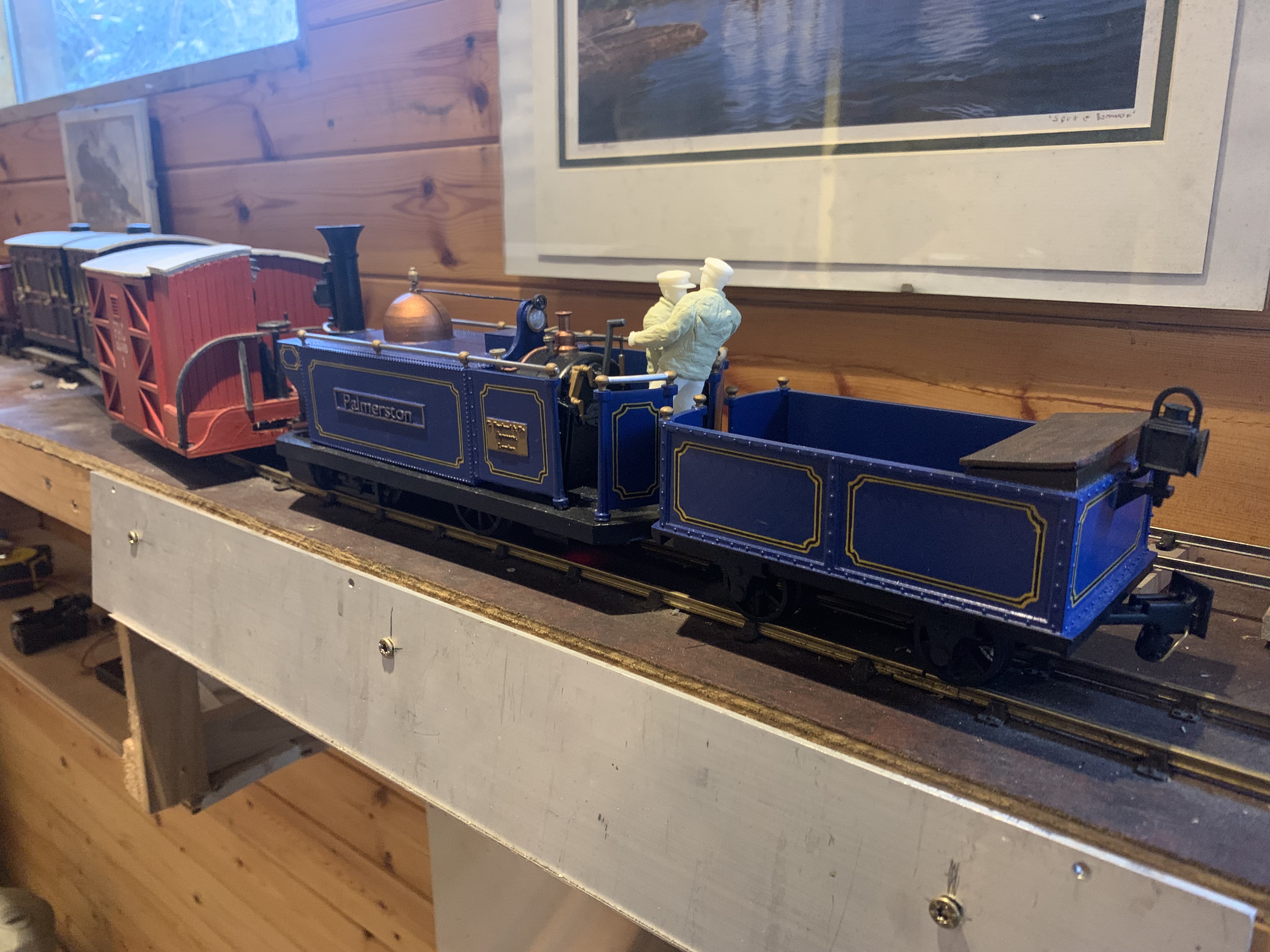

This is almost a finished locomotive now so I thought it was worth another photo and some video. So the photo first:
The painting is finished apart from the "No 4" which goes above the makers plate, and the Prince of Wales' feathers over the name. The crew are created using "Make Human" "Sketchup" and "Blender". The caps were created in sketchup, and added to the figures heads in Blender. The clothes that are available in MakeHuman are very limited so for the first time I have added jackets by wrapping "Milliput" epoxy putty around them. Not that easy to do (certainly easier with "FIMO" modelling clay) so I'm not entirely satisfied with that. However the locomotive works:
Video of it can be found by following the link:
https://www.dropbox.com/scl/fi/04rrtprw ... mgo90&dl=0
It is running on my workshop test track pulling and pushing a long rake of goods wagons (and a couple of coaches). I think that has enough power to haul a sensible load up my railway.

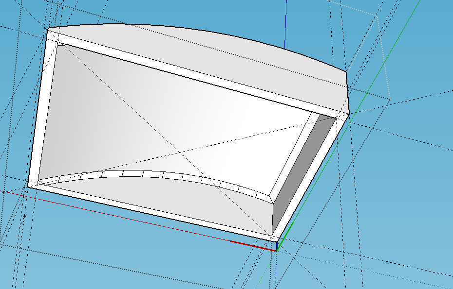

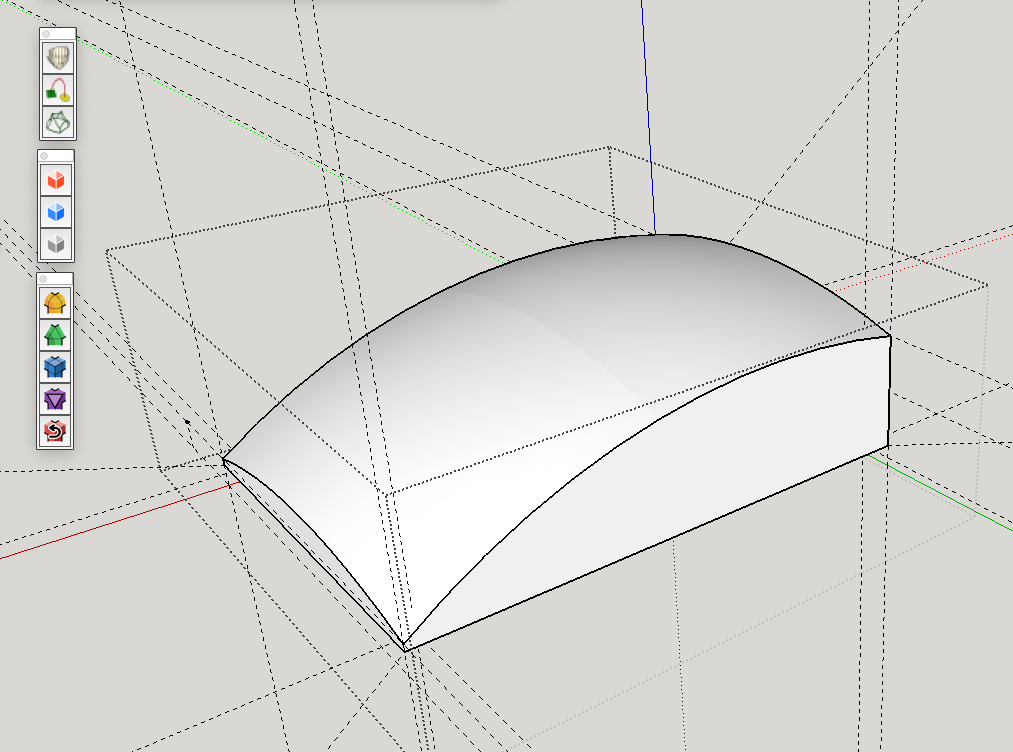

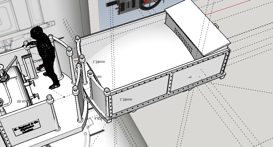

I have just installed the tools which Philip suggested using for adding fillets around the bases of chimneys, and I have realised that they allow me to make a "pile of coal" to go in a tender - which actually looks something like a pile of coal. In this case it in intended to hide a sound card (eventually). The idea is to glue real coal to the top of the insert.
This is how it looks in the tender:
Screenshot 2024-11-01 at 10.22.51.png (179.08 KiB) Viewed 31561 times
The load itself:
Screenshot 2024-11-01 at 10.24.01.png (135.77 KiB) Viewed 31561 times
Note that the top of each side is a curve. Those on the sides are the same but front and back are different curves. That at the front is flatter.
Note that there are 3 new menues at the left of the screen which are associated with the new tools. The third one down in the top set generates a curved surface using the 4 curved edges as a guide.

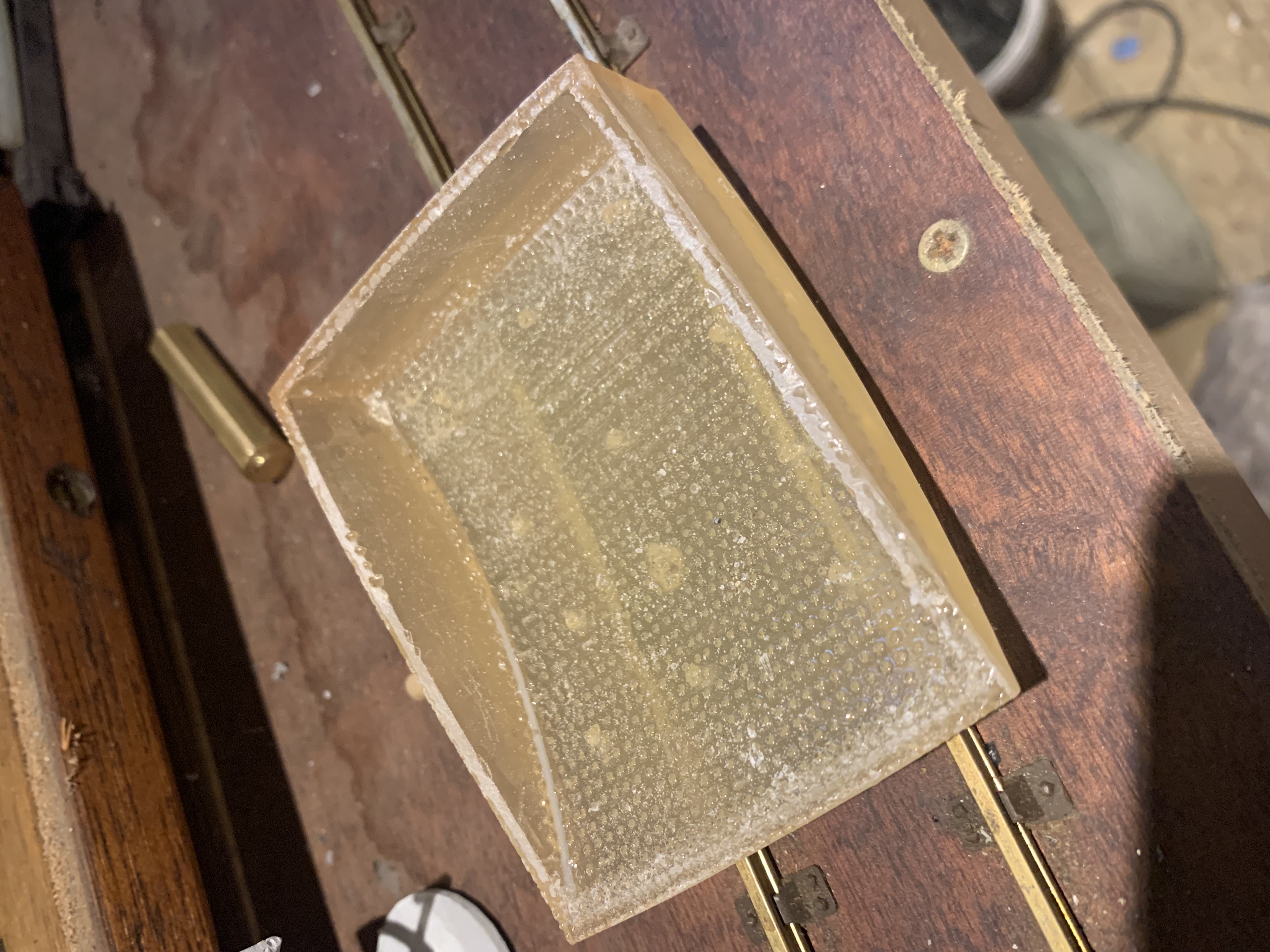

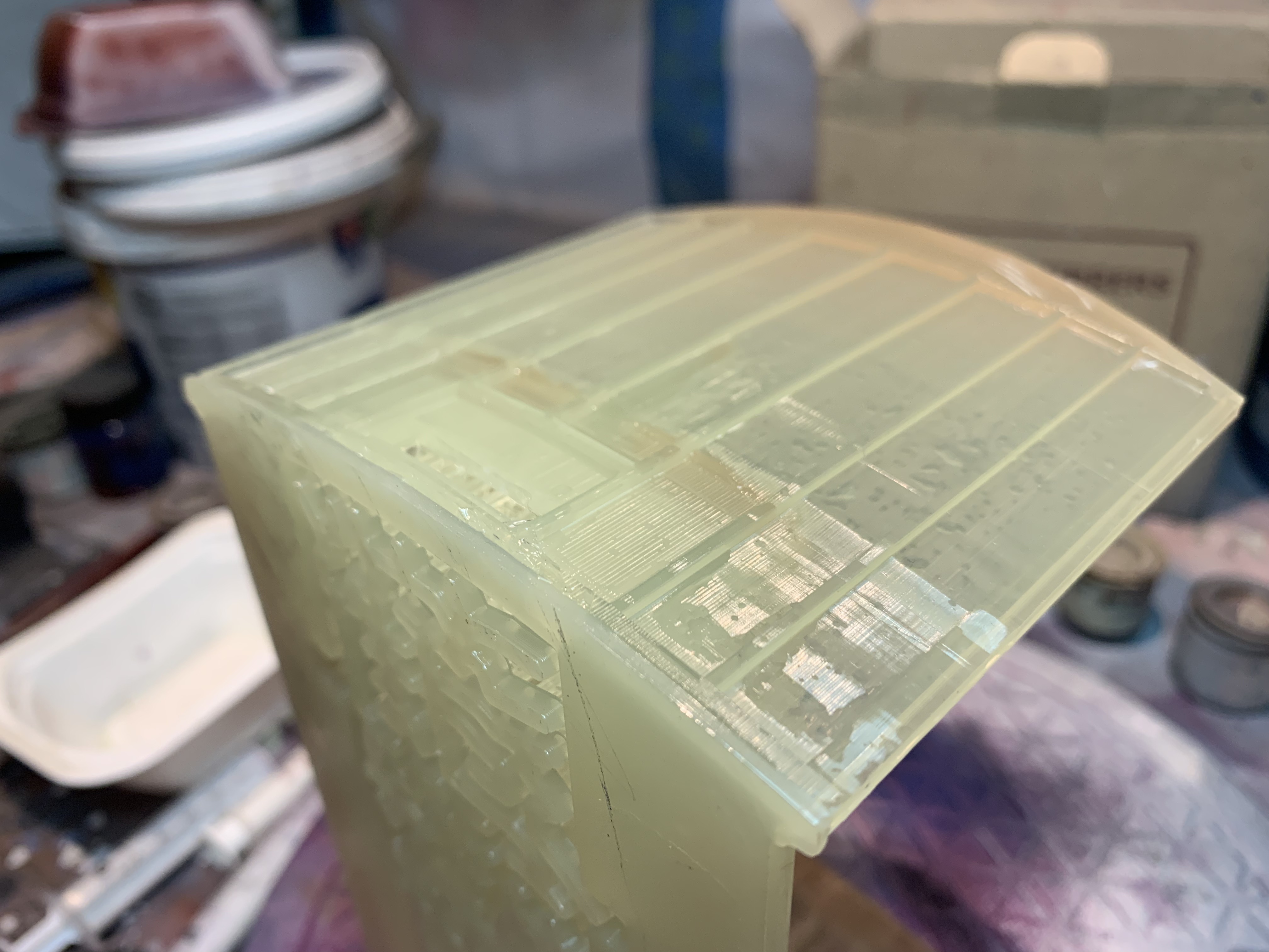

Before I went off to Croatia for 2 months I had been investigating distortion in resin printed components. One of the thing I found was that changes in material thickness caused problems - and I had found distortion on the surface of some prints where internally the material thickness changed. So the suggested solution was a fillet inside to minimise the abrupt change in thickness. So I have added a fillet inside all the way around - as an experiment. Note that it isn't a proper fillet but just a 45 degree straight "fillet". I can't get sketchup to add a proper fillet along a curved edge - or at least I haven't worked out how to do it yet!
Screenshot 2024-11-01 at 10.24.24.png (58.82 KiB) Viewed 31561 times
I have set it up to print flat on the bed - I will let you know how it works when its printed.

Trevor Thompson wrote: Fri Nov 01, 2024 10:45 am Note that it isn't a proper fillet but just a 45 degree straight "fillet". I can't get sketchup to add a proper fillet along a curved edge - or at least I haven't worked out how to do it yet!
This is definitely a job for the standard "Follow me" tool. I know you don't like it, from past discussions, but what I would do is:
1) Take the basic drawing or specific part of the drawing, copy and save it on a blank sheet and scale it up 10x using the measure tool.
2) At some convenient point draw a curve of the shape of the fillet you want, against an edge, and add two right angled line to produce an infilled triangle with one curved edge.
3) Select the edge of the drawing that you want to follow and make very sure that you have every tiny section selected in blue ( using the Weld plugin can help)
4) Hit FollowMe and the fillet should just zoom round the line to the end.
Now, sometimes you get holes on corners which is usually because the curve is too tight. The simple answer is to scale the drawing up by another factor of 10. Occasionally you get a message about it not being a valid ;ath, which may be a tiny segment not selected or occasionally two lines at a junction are a pixel or two out of being contiguous.
5) Once you have the fillet in place, simply rescale the whole thing back down by the scale-up factor you used before and copy and paste it back into your main drawing.

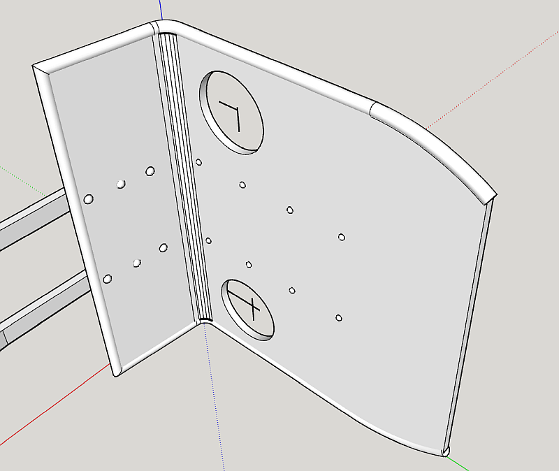

Not a fillet as such ( a inverted fillet if there is such a thing?!) but I've just drawn the cab sheets for the F & B 0-4-2 which have a rolled edge, using the same principle. Basically the cab sheets were drawn as normal with square edges, then scaled up 10x then a small 5mm ( 0.5mm x 10) radius circle drawn across one bottom end of the edge, select the whole thing round to the other end, hit FollowMe and it did it all in one go, including the inward curved bottom edges and the top corners and also both mitred top edge corners. Then scale it back down again.

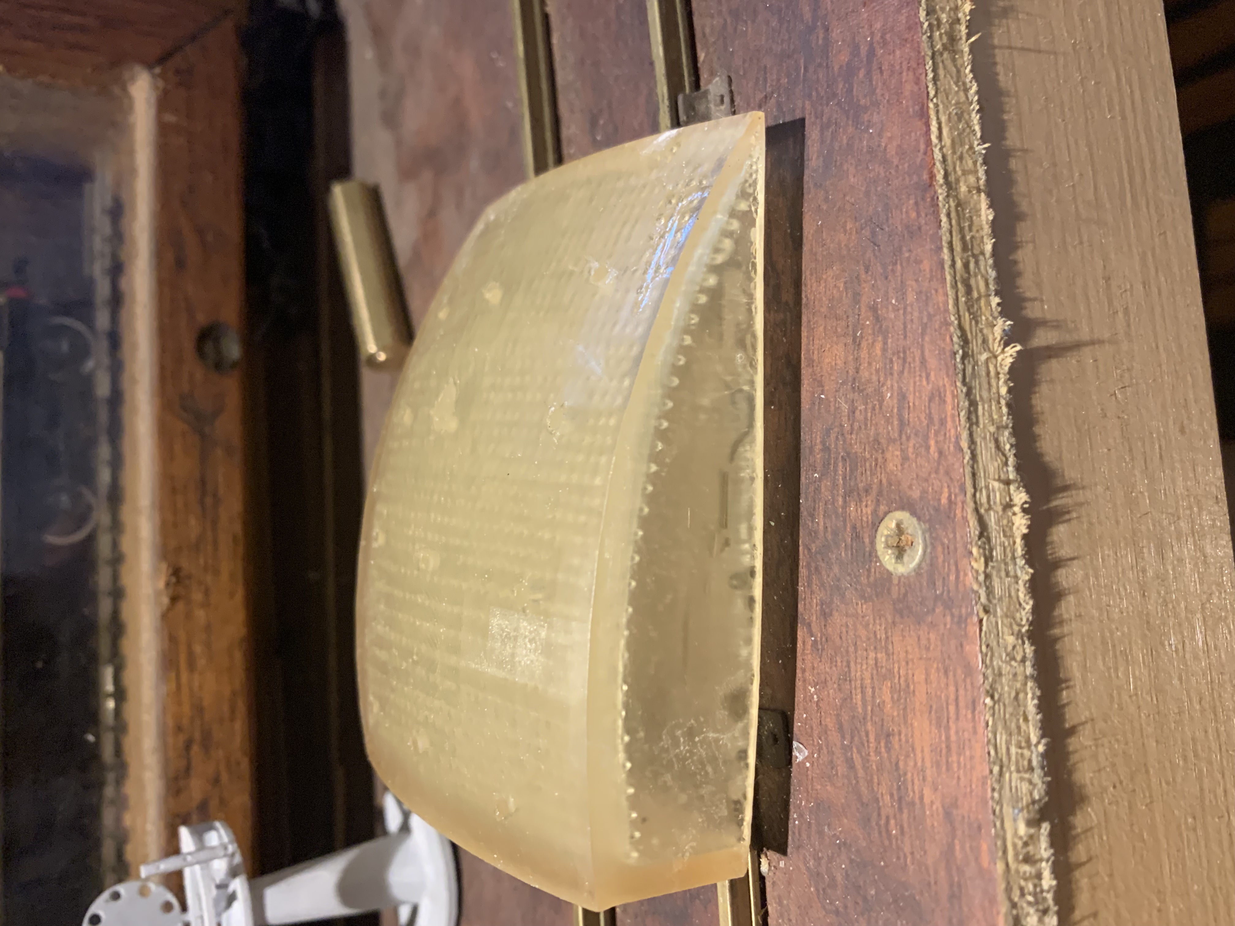

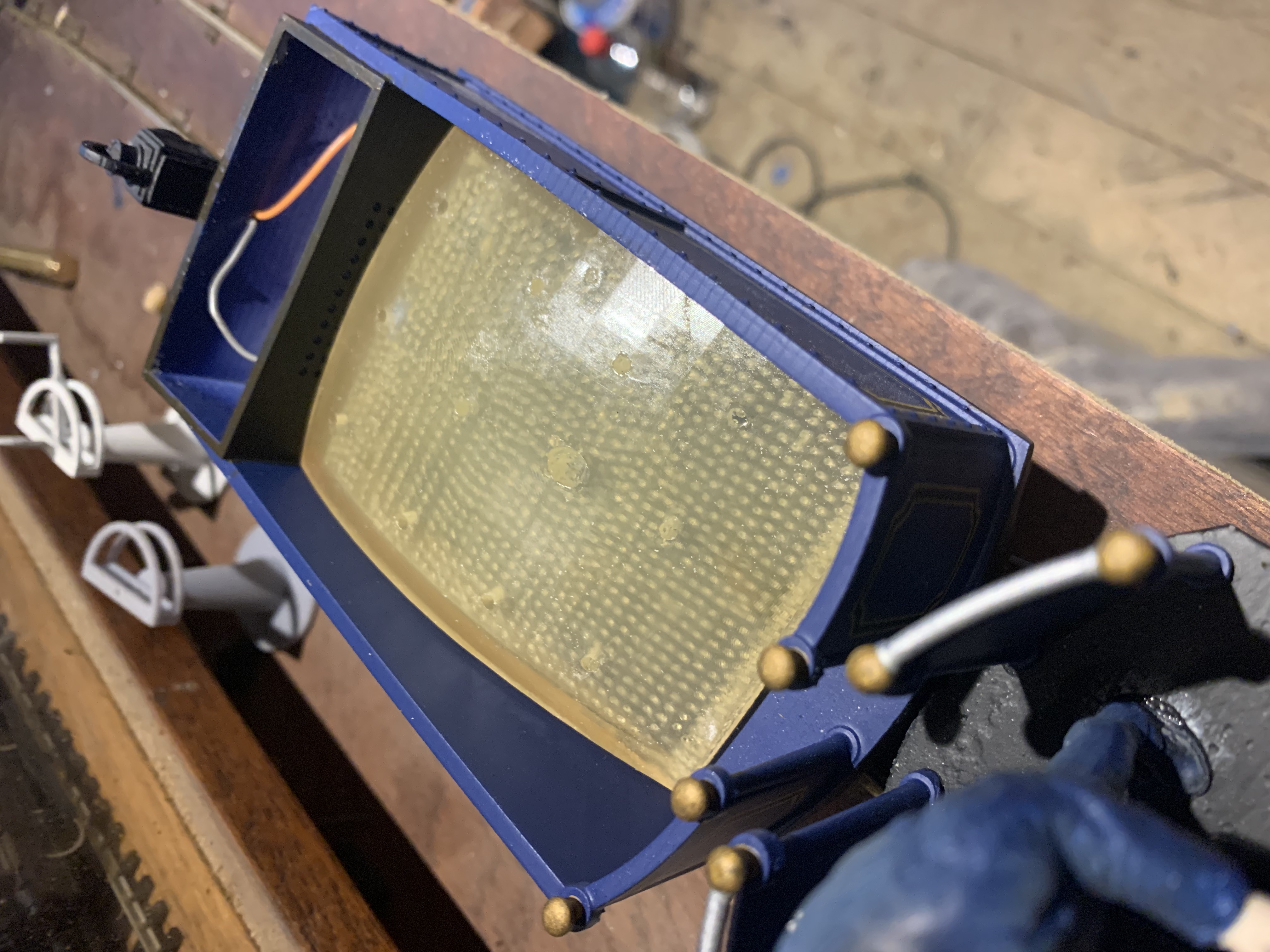

The coal insert has printed successfully first time.
From the side:
I think that the fillet has totally prevented the distortion at the change in cross section.
From underneath:
and finally in place:
It is a snug sliding fit. It won't need anything to hold it in place.

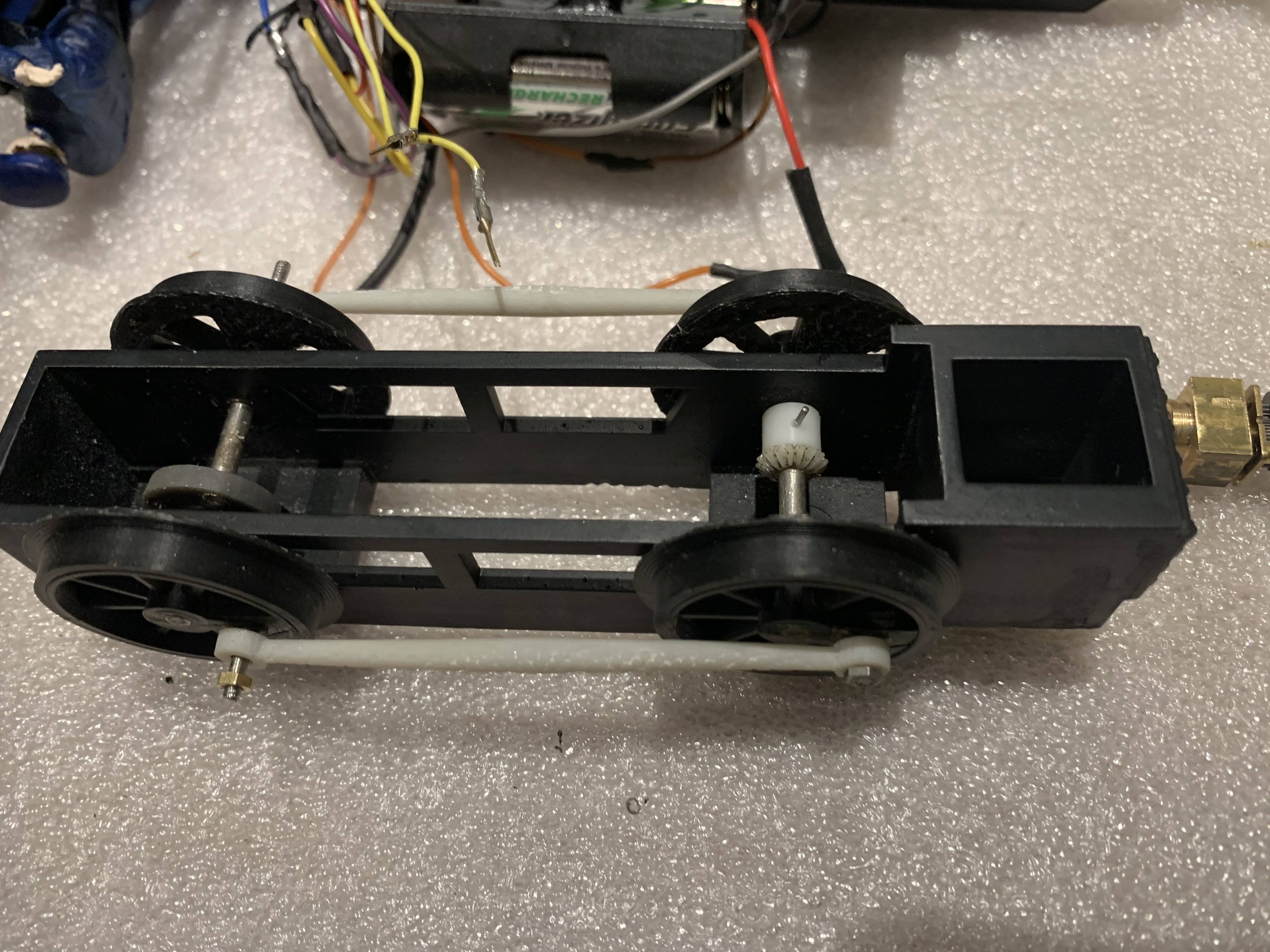

Some parts of the loco have not worked out so well. However I tried I couldn't get the interference fit between them and the axles right, either it was too tight and broke the boss of the wheel, or so slack it wouldn't stop rotating on the axle. So I made new wheels on the filament printer. These are much better, reaming 3mm provides a perfect fit on an axle which actually measures as 3.06 mm diameter. A really good fit which needing pressing on using the lathe as a press. It was a bit tricky to get the quartering right but I was just able to move one wheel on its axle. Of course all of this messing about meant that I broke one of the coupling rods. So I remade them, making them slightly chunkier in the hope of increasing the strength. I used the resin printer, and the same "abs like" resin as before - which is slightly flexible. I was able to press the brass bushes taken from the old coupling rods without breaking them. It has to be the slight flexibility which made this possible without splitting the bosses. The result:
The next problem was that the bevel gear spins on the axle. So to solve that I drilled through the gear and axle with a 1mm cobalt drill and fitted a clock makers taper pin - which you can see in the photo.

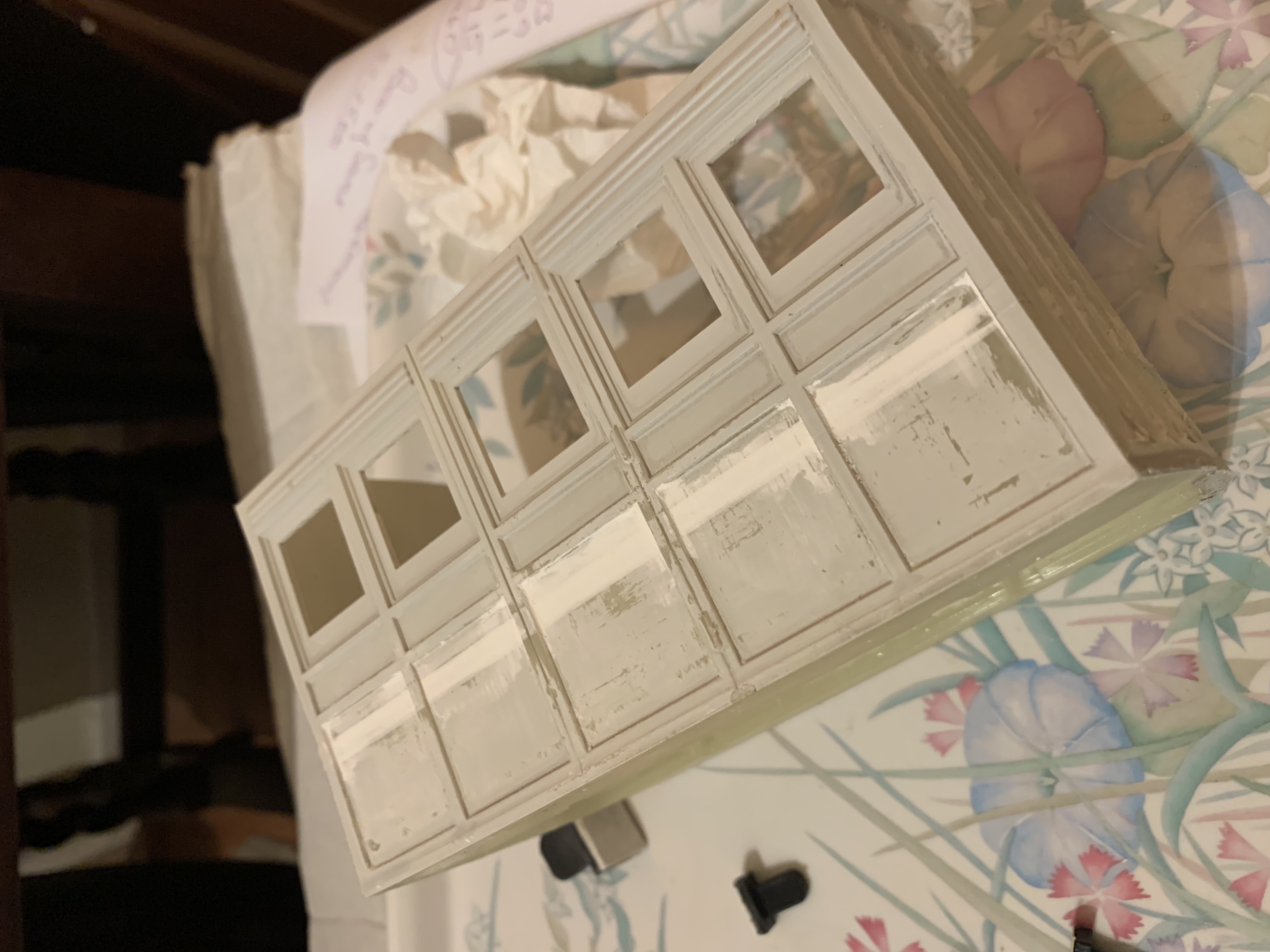

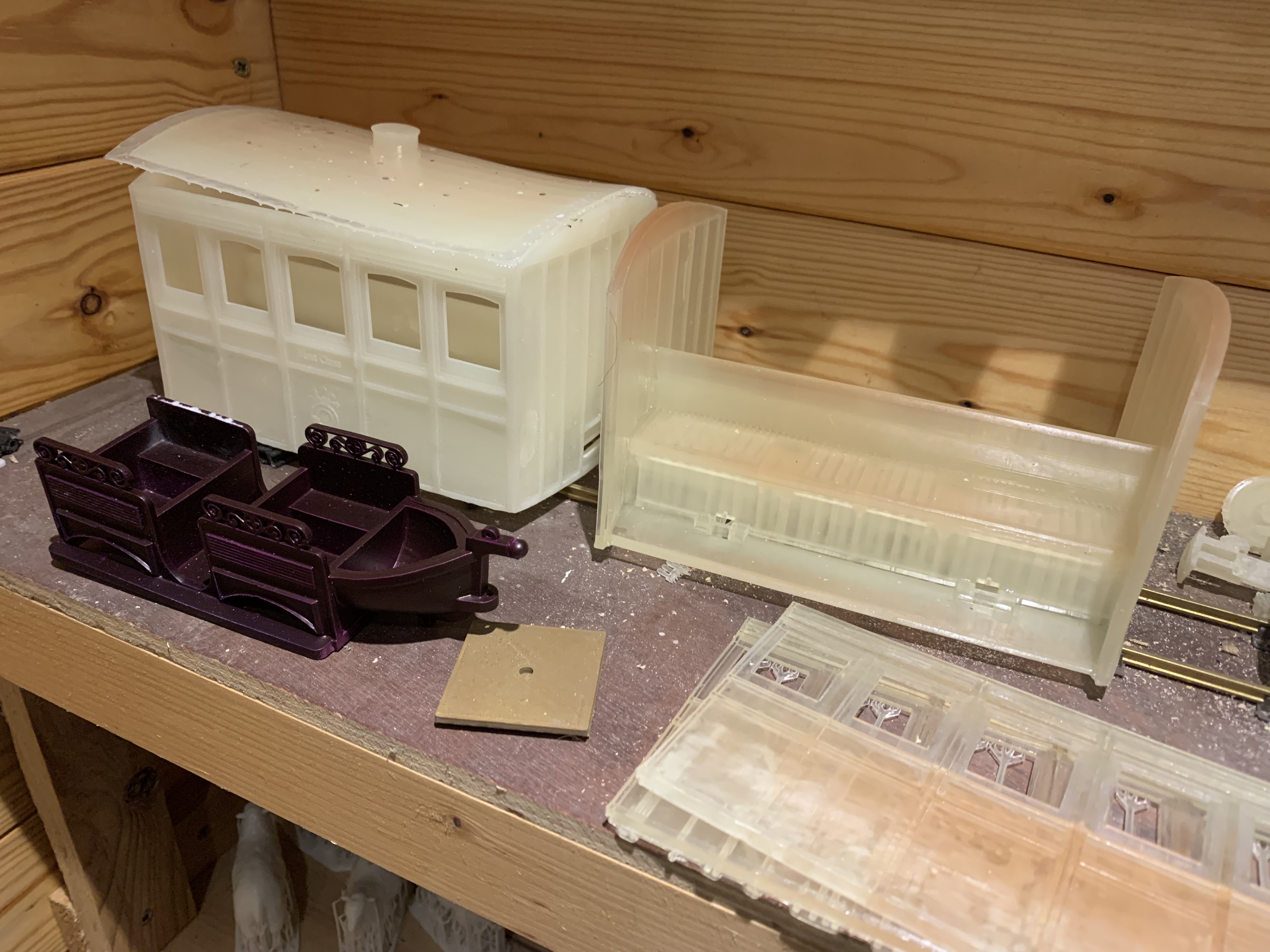

Following on from "Palmerston" as a first attempt to produce a model from a few major components - as in a body complete - I have been attempting to make a rake of Birmingham 4 wheel coaches to go behind it. While I have succeeded in resin printing the whole body of a first class Birmingham coach as a single piece there has been some distortion:
For example the left hand body in the photo was printed with the bottom at 30 degrees to the base. That resulted in the floor of the coach being slightly bent up at the ends. Not so much that it is unusable - but not as perfect as I wanted.
There is also a second body for "Spooners Boat" in the photo - and that printed perfectly. After 3 months there has been some distortion where the front and back have risen slightly. However when it is fixed to its brass chassis it will be pulled back into shape and held that way. Also one handrail is missing - I dropped it and it broke - slightly brittle resin - a replacement is in the printer.
The resin printed roof is not a success. It has warped badly. I will make a printed frame and fit plastic sheet onto the framework to make the roofs. Or filament print them!
The second photo shows what happened when I printed it flat on the baseplate. Each corner lifted slightly, but the main issue was that at the level where the seat bottoms stop the change in thickness generated a ridge all the way around the coach, along both sides, and both ends. You can see where I have filled it with "Perfect Plastic Putty", and sanded it:
Less perfect than the first attempt but at least by filling and sanding I can recover it.
I then tried to make the coach body in three parts, ends and base including seating, and 2 sides separately. Again flat on the bed. The photo shows some distortion on the ends if I have caught the light correctly:
Again recoverable with filler. The 2 sides have printed (at 15 degrees to the bed with the bottom closest, and parallel to the bed) pretty perfectly. So that should be a first, a second and a third class coach. The fourth coach and the brake van are already made.
So I am not sure about this approach - it costs a lot in resin for each failure, and my results are not perfect. I suspect much depends on the choice of resin ( and I haven't found the best for this purpose yet). I am not at the point where I can be certain of the result the first time I attempt to print it. I can (near enough) with the filament printer - even in ABS.
Oh and I have discovered a new type of filament "ASA", which has better properties than ABS and seems easier to print with. More of that in due course.
