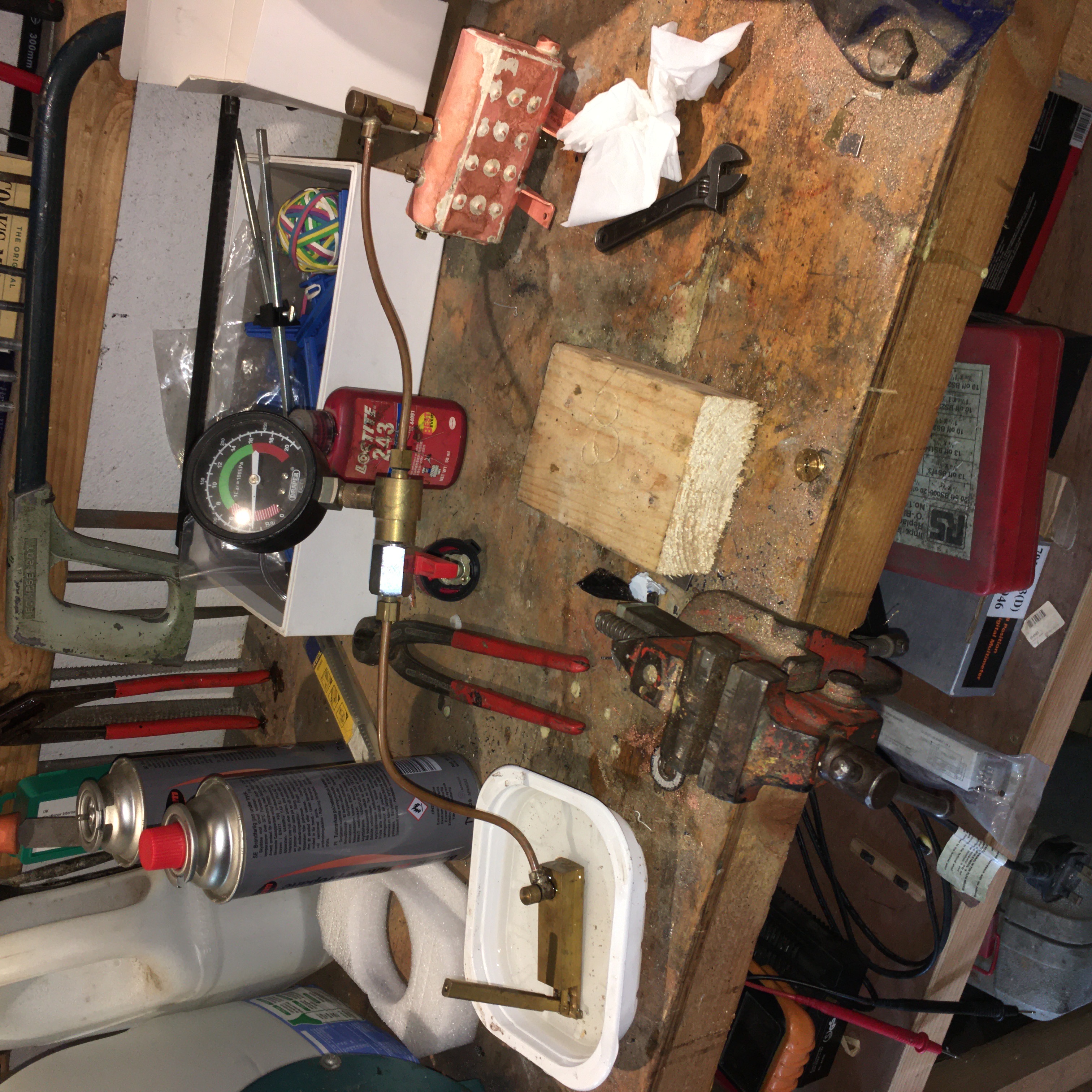

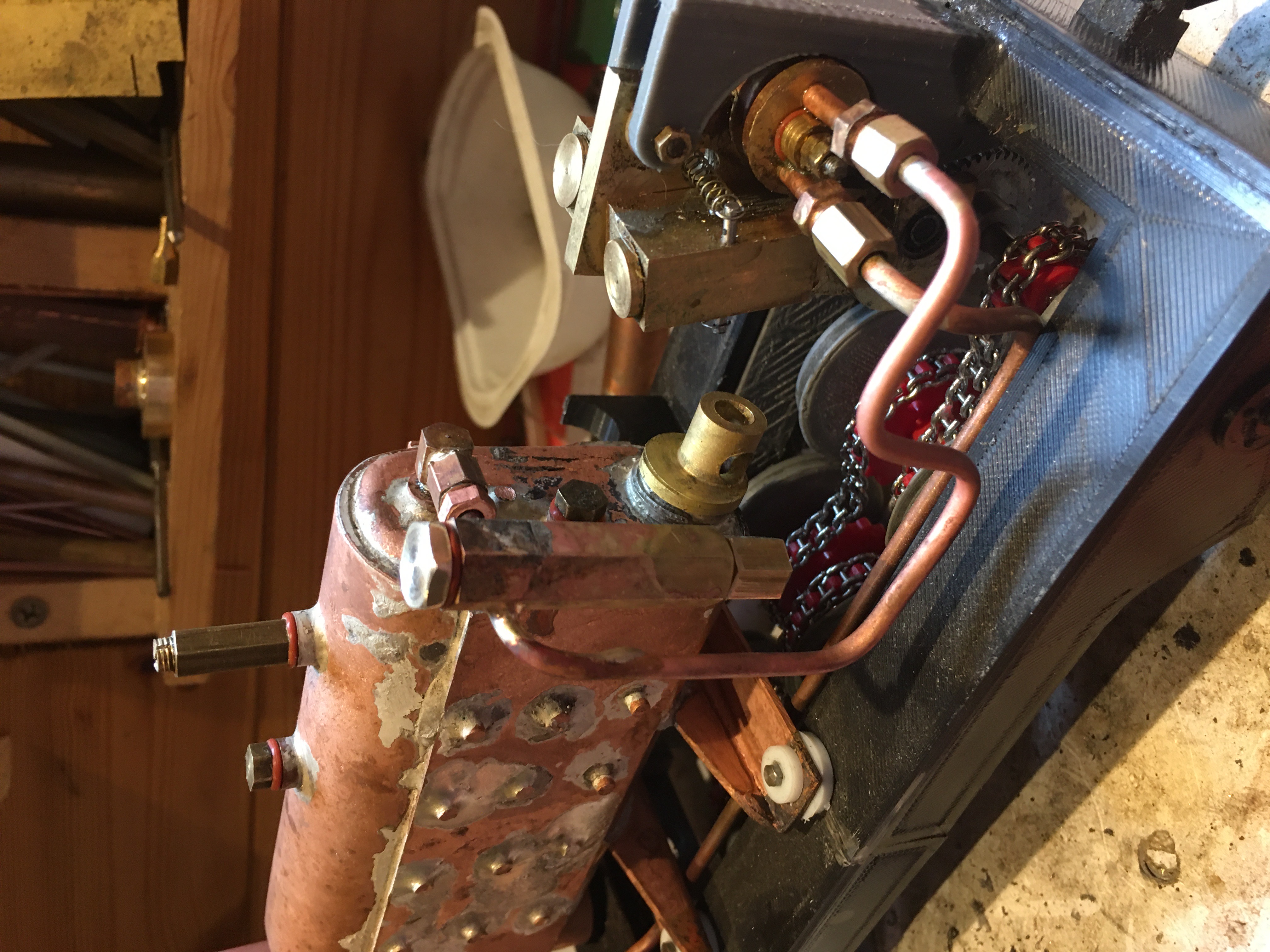

I have checked that the boiler is fit to use. This is my arrangement for checking it:
I am studiously avoiding the word "test" because it isn't an official test. The pressure gauge is not calibrated - and you can't do it yourself. But a tiny boiler like this doesn't need an official test (in the UK anyway).
So I have filled the boiler with water blocked off all the bushes except one and fitted the rig to the boiler. Pump it up to 5 bar in this case and shut the valve to isolate the pump from the piping (to avoid the slight leakage back through the pump).
The first time I did it was disappointing - a drip from one stay and a jet from another. So it was all dismantled and drained before re-soldering the offending stays.
The second attempt was much better. It retained 4.5 bar (about 75psi ish) for 5 minutes, with slight leakage from the thread connecting the pipework to the boiler.
I think that will work fine on 30psi - which is what I intend to run it at. (I don't think its fair to expect a steam motor with a simple reverser like this has to cope with more than 25 to 30 psi.

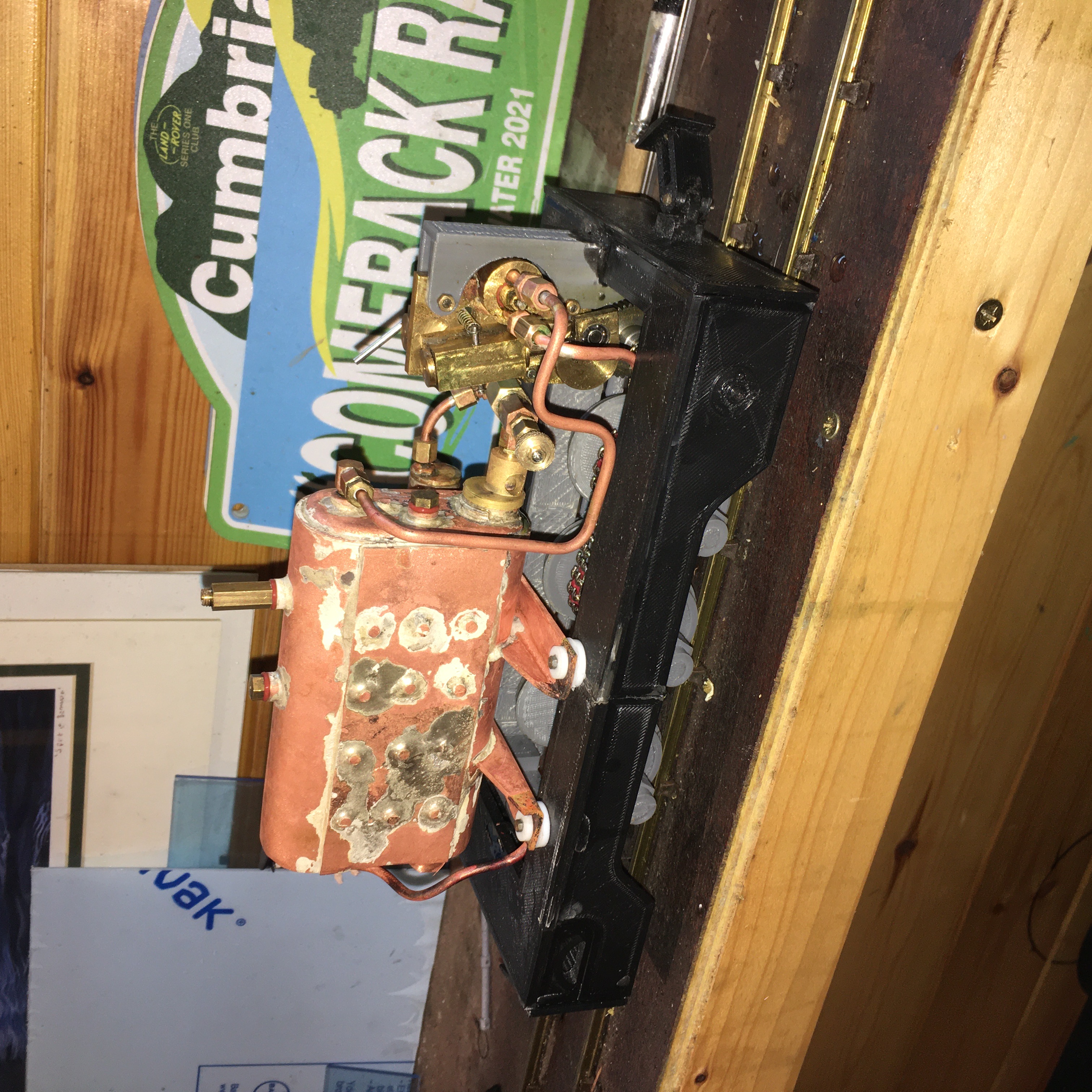

So the boiler is mounted into its final place on the footplate:
The top hat bushes sit under the boiler, and simple PTFE washers sit on top, and 8BA bolts hold it down. I can modify the drawings for the footplate later - but I just held the boiler in place with superglue while I drilled 1.8mm holes through the bushes. The superglue held for the first two holes, so I tapped the footplate 8BA and put the first two bolts in before drilling the last holes.
So I suppose it is boiler fittings and pipework next.
It feels like it is quite close to seeing steam!

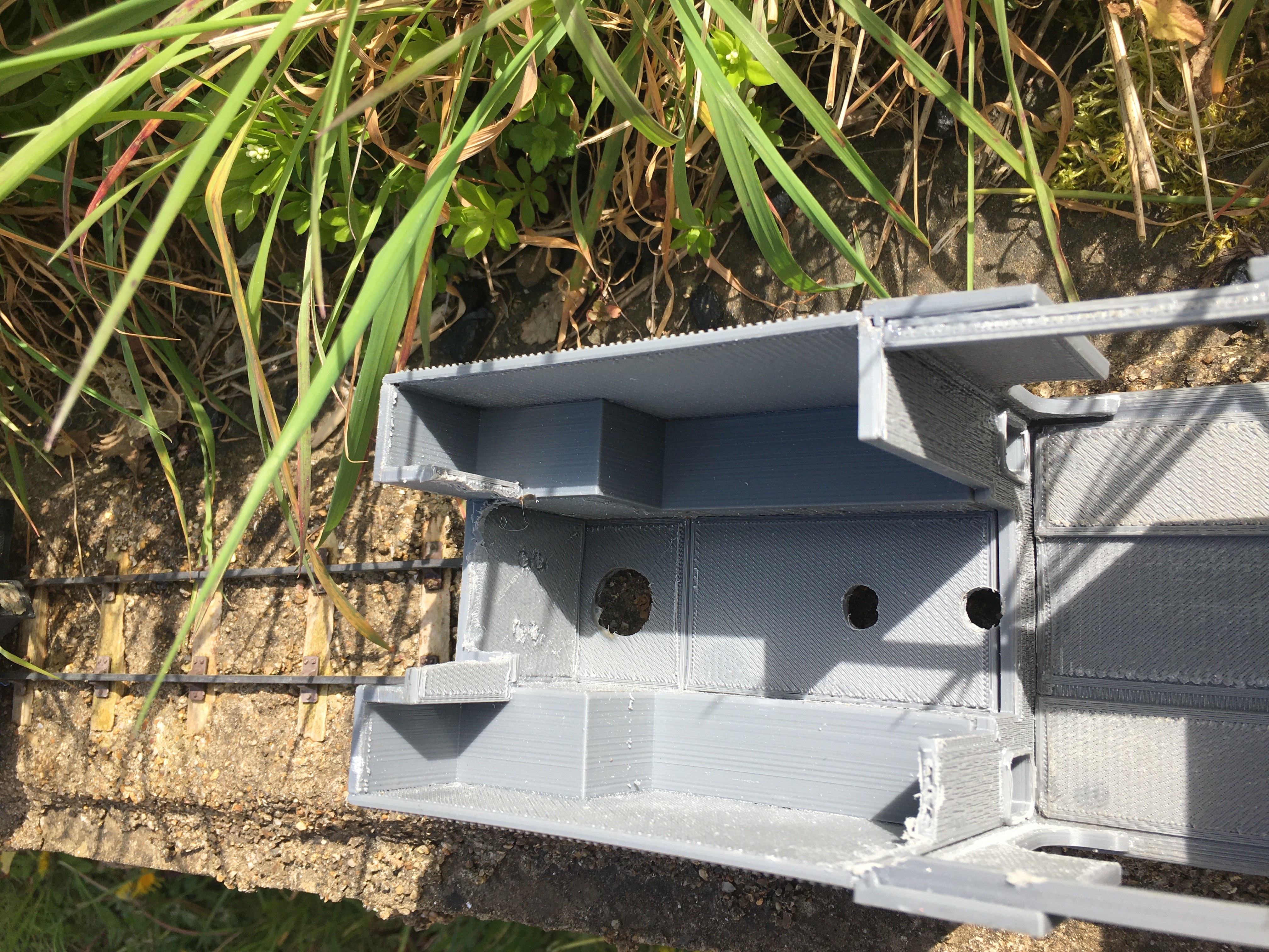

I will add the bodywork files to the 3 D printing files shortly. I can't say they won't need modifying, but they would allow someone to make a battery driven version of the loco.

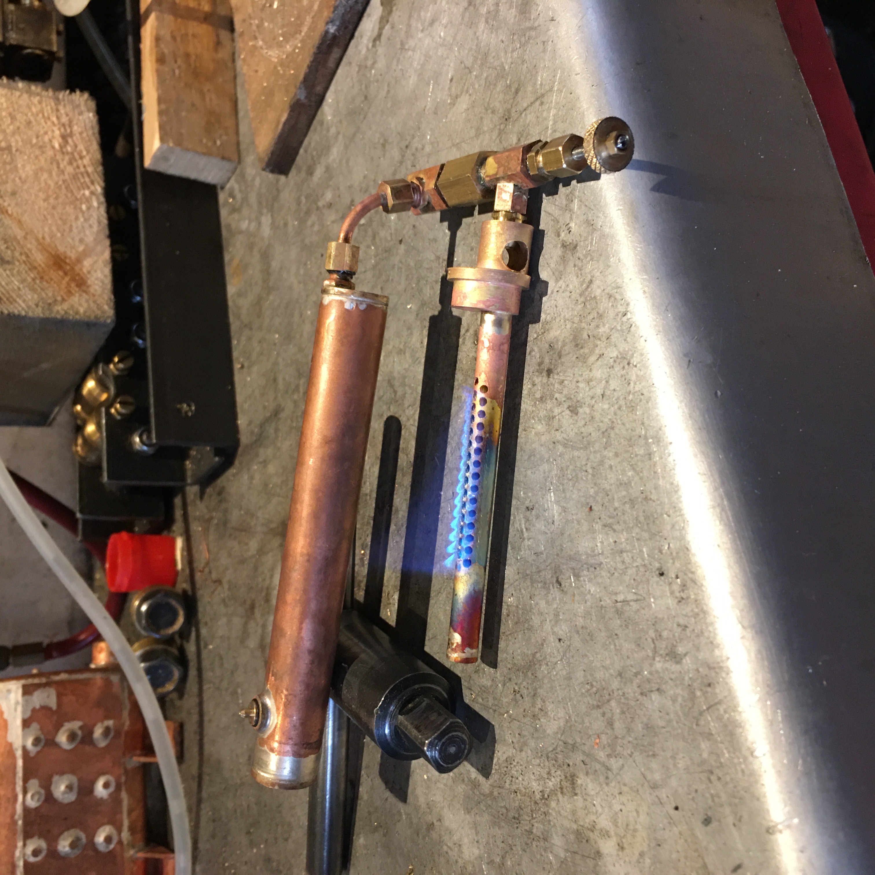

I have made the tank, control valve and burner:
It is a modification of the drawing for "Brick" from the 16mm Association website.
It works fine in the open. Nice flame pattern and blue flames. However inserted into the 12.7mm tube in the boiler and it doesn't work. The flame goes out, or it acts like a flame thrower! Tony Bird did say that he thought it was too small a tube - and of course he was right. So a bit of an adjustment. I used a stepped cutter to open out the tube, basically cutting it free at each end of the boiler and removed it. I have a 15mm diameter tube ready to silver solder into place.
So some adjustments to carry out - and this time I am sure the burner will work in place. We know 15mm tube works.

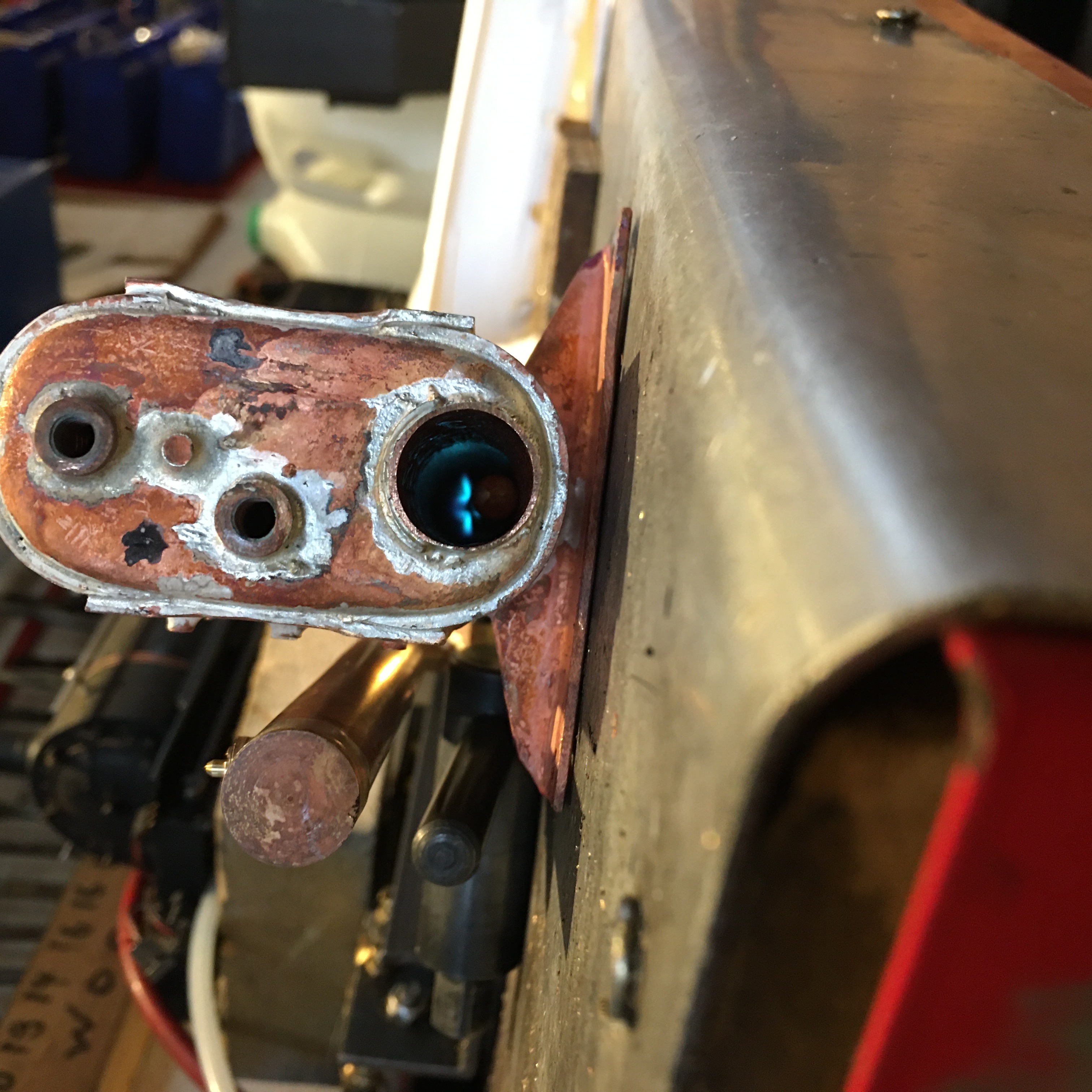

Progress again.
Modified burner control and:
Modified burner lit outside the boiler:
And you can just see the flames inside the boiler burner tube:
I can see on looking at this again that I put the burner into the wrong end of the boiler. It doesn't make any difference it was just a test - but you might wonder why there were bushes in the front of the boiler!
So that is a success. I will draw up the components and add them to the thread when I have it all working. On to the boiler fittings.

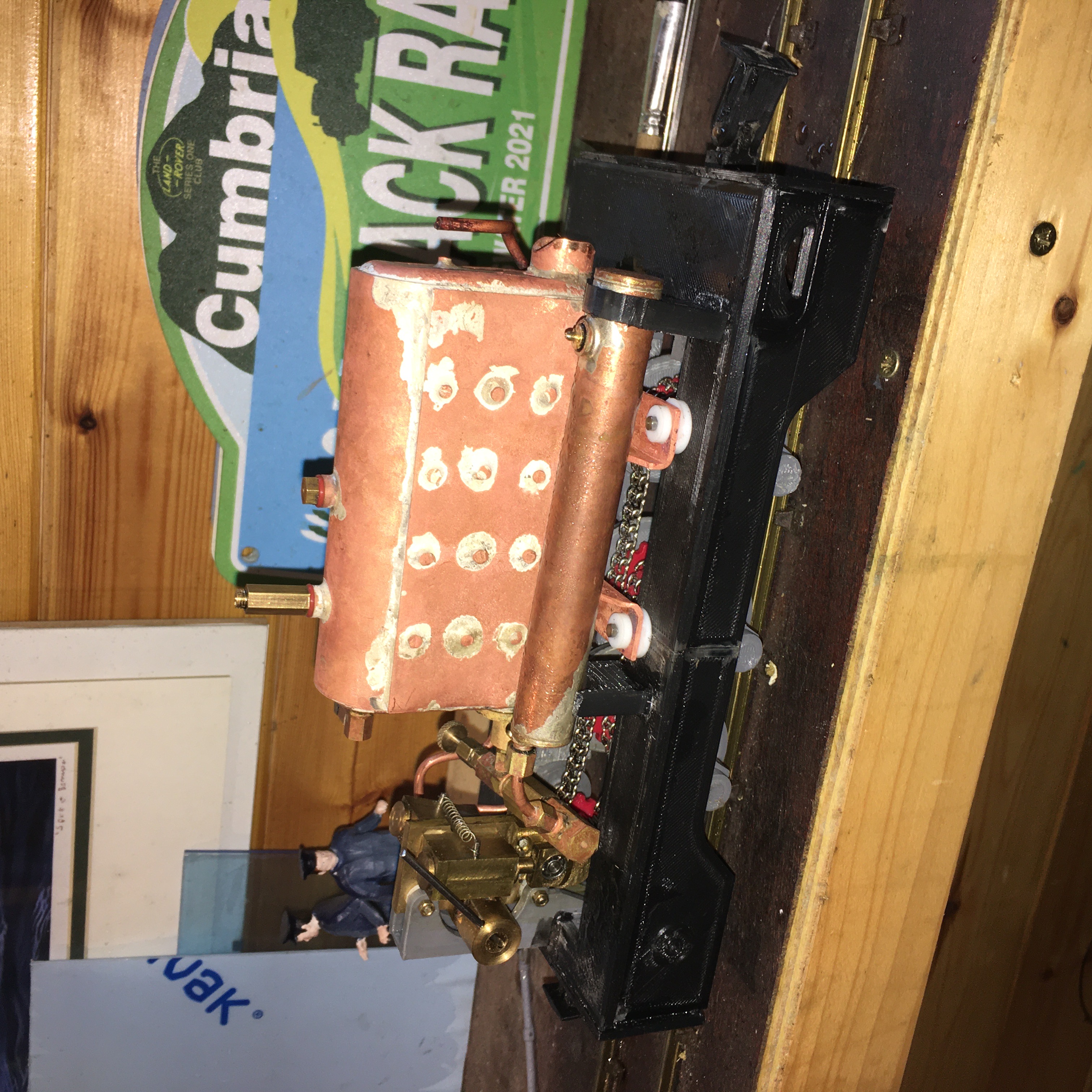

I am now at the stage of giving 4420 its first test under steam.
Firstly to show you the progress so far:
You can see that I have the gas valve control wheel in a place where it should be accessible from the cab doorway. There is a copper pipe connected between the steam takeoff ( no regulator) and the steam motor. Also a pipe from the steam exit on the motor to the front of the boiler. Boiler fittings at the moment consist of a safety valve, two blanking plugs and a steam takeoff. In due course the blanking plugs will be replaced by a filler valve and a water level sensor. The sensor will feed be used to drive LEDs - as per my other steam locos.
and from the other side:
On this side you can see the way the gas tank sits alongside the boiler. At the rear end there is a half support under the tank, and at the front a full support. Initially I glued the front support into place, but I have made a modified arrangement which will allow it to be bolted into place. The burner is removable - its just easier to take burner and tank off in one piece to clear a jet. That means that I can clean a jet without disturbing gas fittings and risking creating a gas leak.
and finally looking down on the cab area:
It is a bit cluttered - but it has developed as it went along. Note that at the moment there is no displacement lubricator. There is no smokebox - or its equivalent which will in this case be a sort of "T" piece directing the burner exhaust up and down. I have not fitted the body on - and it will need modifying to get it to fit. So first things first - lets get it working.
So here is a link to a short video of it running on my workshop test track;
https://www.dropbox.com/s/05of7zdn3vo8d ... 2.MOV?dl=0
Not exactly running properly yet - but I still have a big grin on my face!
There is a significant steam leak from the pipe where it goes into the steam motor. And the steam motor is letting steam out all over the place. That will be partly due to the lack of lubrication. So I am not really getting steam up properly certainly little evidence of steam around the safety valve which I have set to 30psi. I may yet fit a regulator - but I think there is an advantage in not having one on a simple locomotive like this.

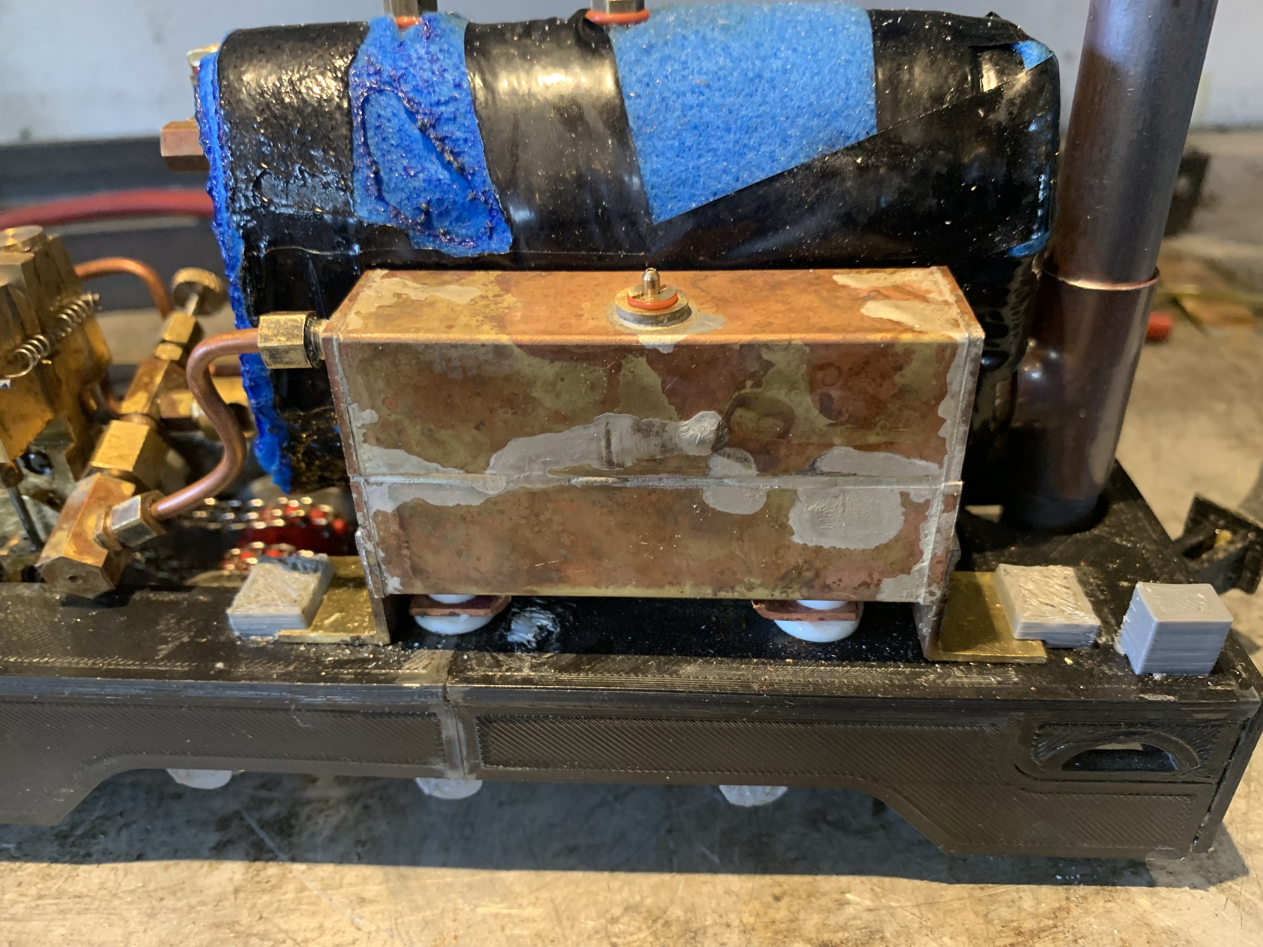

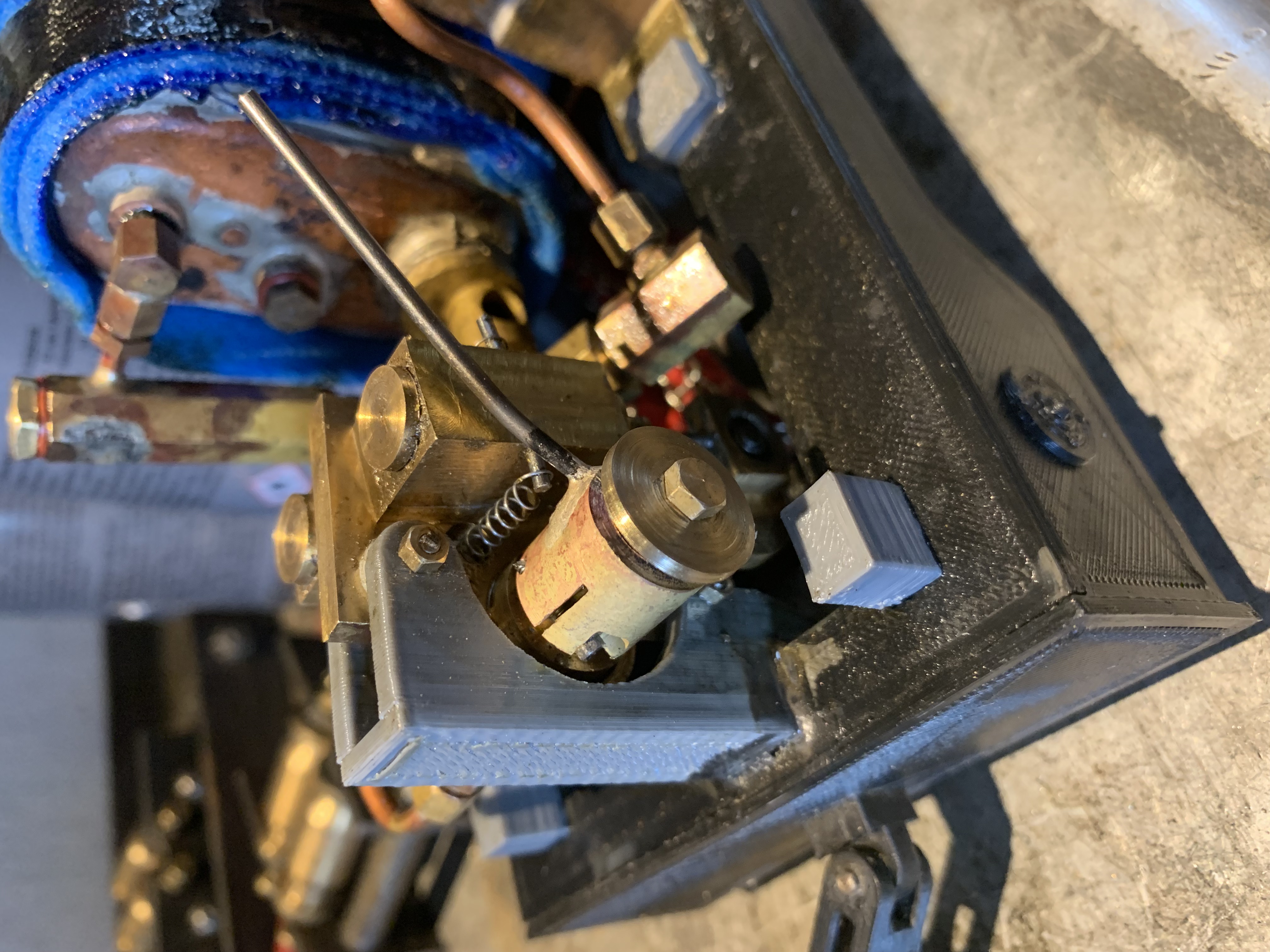

I have been making progress on this project. Perhaps its worth admitting that I have carried out a successful steam trial outside with the body in place. That will be revealed shortly!
Firstly I have addressed the issues I found when I first steamed it.
I have made and fitted a displacement lubricator:
A simple arrangement based on the one in the drawings for "Brick".
I have created a "smokebox" or at least a functional equivalent:
and finally the boiler has 2 layers of wool felt wrapped around it. It is just held in place with insulating tape:
On to the next post.

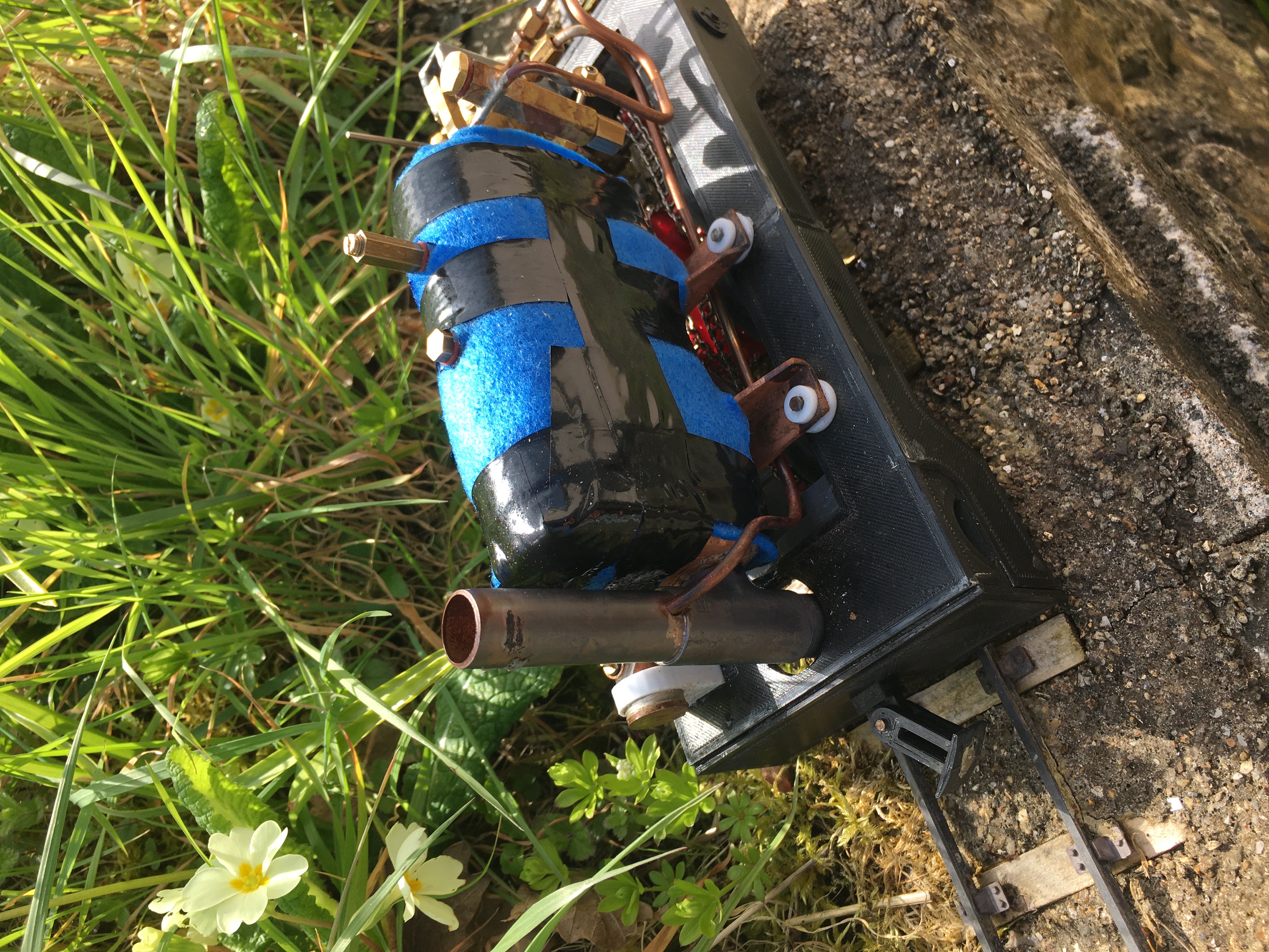

I have had it in the garden and the result is in this short video which can be viewed via the following link :
https://www.dropbox.com/s/k8iszgsgwymct ... y.mp4?dl=0
Remember that this is an experiment. So this isn't a final finished loco - its just part way through the project. The first question we all want to know is how did the plastic bodywork cope with the heat. Here is a photo of the inside of the body so you can see for yourself:
So the answer to that question is that the body was only affected where it was touching the exhaust. The rest of it was totally unaffected particularly relevant in the cab area where there was a certain amount of steam escaping. I am reassured that the concept will work. You will see that I have been butchering the inside in various places with a Dremel to clear the various components.
So what were the next set of issues which came out of the test:
Firstly more detail of areas where it got too hot. The "smokebox" consists of a 15mm copper pipe "T" piece, with a length of 15mm copper pipe extending upwards. I used a hole cutter to make a hole in the footplate underneath it. Crude but I am experimenting. When I lit the burner the flame didn't move to the burner correctly - it went down out of the bottom of the "T" piece - charring the paper covering on the bench before I smelled it. Adding a short length of pipe on the bottom leg of the "T" stopped that. Of course the front buffer beam was damaged by the flame playing on it. With the pipe on the lower end that has not reoccured. I suspect the boiler is not quite square on the footplate - because the "chimney" isn't quite central in the hole in the bodywork, and that has resulted in the exhaust pipe touching the edge of the hole it passes through. I can correct that. I will make a turned "chimney" with a smaller diameter perhaps tapered to fit into the top leg of the "T" piece. The "T" piece was only "bonded" to the flue tube in the boiler with lock tight bearing retainer. That requires over 300 degrees to make it let go and it certainly hasn't fallen off so far!
When you look at the video you may notice that the body isn't quite down on the footplate. There is a gap os 1 or 2 mm in some places. Also it isn't sitting on the footplate squarely. So some components need moving slightly. The steam supply pipe, for example, could do with being bent to clear the cab side. The gas filler is probably touching the bodywork as well. I want to make rectangular blocks to bond to the footplate so that the body just drops over the blocks which will hold the bodywork in line with the footplate. I want the body to just sit there held only by friction.
The wool insulation works on the boiler itself. Wool is naturally fire retardant. However any insulation on the "smokebox" would have to be the type used on coal fired locos - totally fireproof. It might be better to do that to avoid accidental damage.
You might notice in the video that the loco seems to crab sideways - and it would not go forwards over the point without derailing. The back to back on the front axle was far too small. That is the problem with bonding the wheels to the axles. The superglue doesn't always hold. I find that making them a tight fit doesn't always work either!
Aesthetics. I will move the boiler back a couple of millimetres so that the safety valve is inside the cab. At the moment it is EXACTLY in the middle of the spectacle plate. When all of these things are finalised I can take dimensions from where things like the exhaust and water filler actually go through the bodywork so that I can make a finished version of the body - and paint it.
Performance. You can see that the loco is running at a suitably slow speed - and I have had it pulling a couple of wagons on the flat. The limiting factor is boiler pressure - it's nowhere near blowing off the safety valve. I have not fitted a pressure gauge but I think it is operating at about 10psi. I always have difficulty getting these simple reciprocating engines leak free - particularly the reversing block. I am sure it will get better as it runs in.

It is a while since I have worked on this, but I have made significant progress over the last week or so. Rather than explain how I have modified it first, I will share the outcome so you can see the result - and then I can explain what has made the difference, and what has yet to be improved. The video of 4420 running on the Railway in the Valley of the Mill:
https://www.dropbox.com/scl/fi/sys0bgjc ... z6cfs&dl=0
Perhaps it is worth noting that the train it is coupled onto is heavier than it looks. The two coal wagons are full of coal - real coal - and are actually heavy.
- Posts: 1212
- Location: South West Wales
Re: Kerr Stewart 4420 - Live steam and 3D printing

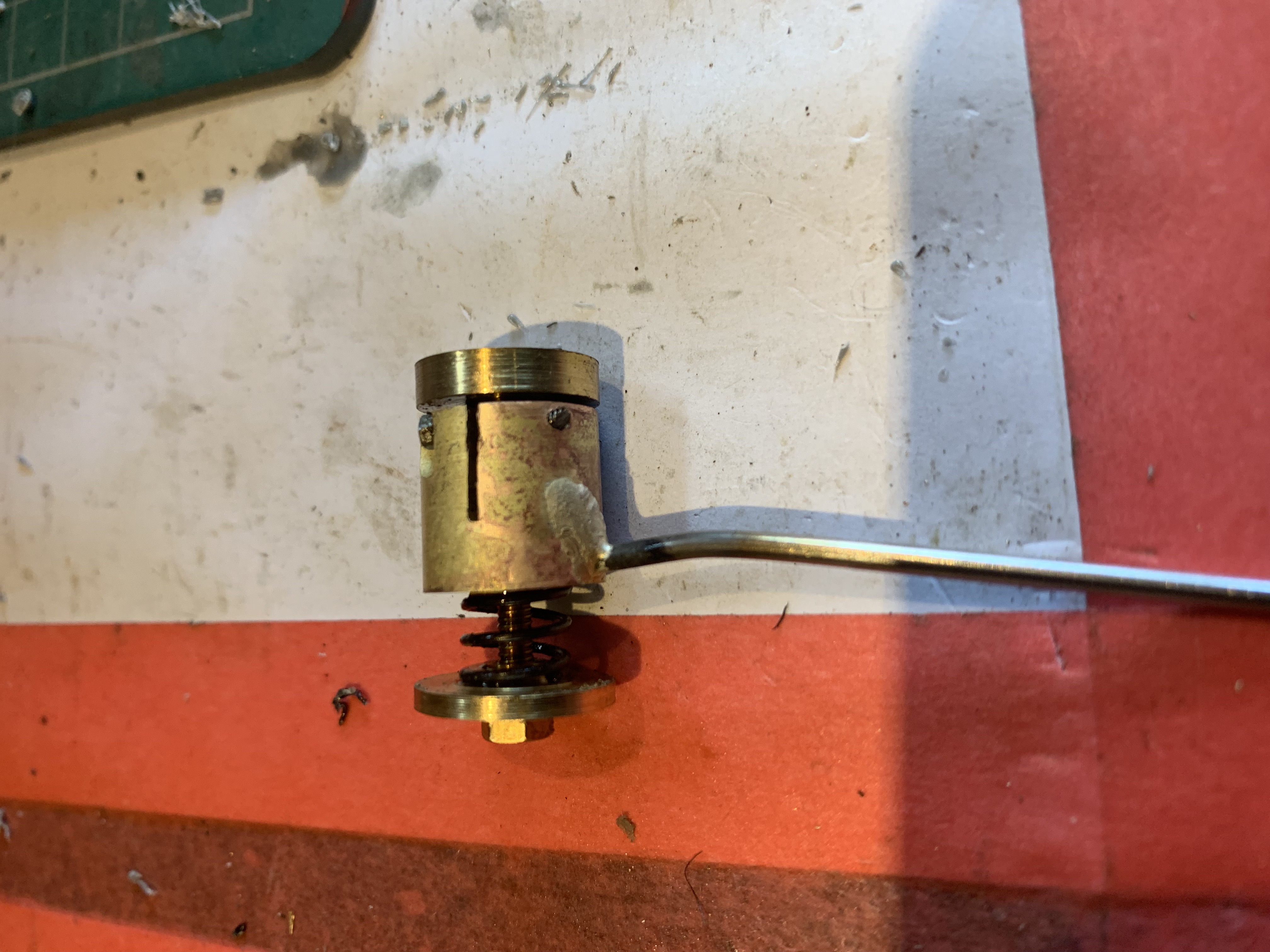

So what have I changed since it was last videoed on the track?
Firstly I have "fettled" the steam motor. One piston was a bit stiff in its cylinder, the cranks were hitting one of the bearings on the layshaft, and actually hitting the layshaft at the bottom of their motion. It is running more smoothly now. The reverser was leaking steam - which had the effect of limiting the steam pressure in the boiler. So I have changed the spring holding it onto the port face:
Originally the spring (an O ring) was on the back face interfering with the steam pipes. I have tapped out the hole in the centre of the port face 6BA, and drilled a clearance hole right through the reverser block. I made a washer to hold the spring and cleaned up the hollow mounting disk which holds the lever. So when assembled a much stiffer spring significantly increased the force stopping the steam escaping. When assembled:
The gas tank I had made wasn't really big enough, so I started again and made one from two lengths of square section hollow brass. Run time is much improved:
You can see that there are two outward facing brackets on the bottom ends of the tank. They slide under the plastic brackets (there is a cut out in the bottom to each bracket). That holds the tank firmly yet allow it to be removed easily by sliding it sideways. That works well - I will use that idea again! In the photo you will see one error I made. The "o" ring on the gas filler valve sits on the surface of the gas filler bush. I really should have counterbored the bush when I made it so that the "O" ring is supported on the outside and it can't be forced out by the gas pressure. I was reluctant to un-solder the bush to modify it with the risk of ruining it in the process, so I counterbored it VERRY CAREFULLY in the milling machine. Thankfully that worked OK.

So I am much more satisfied with the way that is working, however there is room for further improvement. I noticed as I was recording the video that oil and steam was escaping from the lubricator cap - so I will have to look at why, perhaps it wasn't screwed down properly?
While the reverser is sealing well and the boiler is able to generate more steam pressure, there is still steam swirling around the cab. You can see it in the video at times - and no sign of steam from the chimney even though it was fairly cool outside that day. I will try stronger springs on the cylinders to see if that reduces the steam escaping.
At the end of the video the loco was struggling to move both up and down the hill. Note that the bridge and the track beyond it has a slope of 1 in 60 - so it should have struggled up hill and raced off downhill which it clearly does not do. I tried opening the gas valve slightly but that made no difference - so I think it was running out of water. So lots of gas and probably running low on water so I now need a filler valve and the water level sensor.
I have been running on the track a few times now with the body in place - and broadly speaking the body is withstanding the heat well. The only signs of melting are near the "smokebox", firstly where it passes through the footplate and secondly where the other end passes through the top of the body. It doesn't to it all the time - its just when I get impatient and increase the gas flow - and probably its low on water and the extra heat goes into the smokebox rather than the water.
I am going to make a different "smokebox" to reduce the diameter of the top and bottom pipes - increasing the clearance between hot metal and plastic.
At least the body as it is is just a prototype. In due course it can be remade.

I have made a number of minor modifications to the boiler and steam system.
Firstly I have found and removed all the minor steam leaks in the fittings. I have fitted a pressure gauge, a filler valve, and a "gauge cock".
In case you haven't come across the gauge cock before - it is a valve or "cock" which Sits at the minimum water level on the front of the boiler. It has a narrow pipe running off to one side. when it is opened either steam or water will come out of the end of the pipe- depending on whether the water is higher or lower than the cock. Prince and all of the Ffestiniog early engines all had one gauge glass and a pair of gauge cocks when new. Photos in the next post.
Last Monday Phil videoed it running it on the line. A link to the video is here:
https://www.dropbox.com/scl/fi/4ok3w9in ... dlzzs&dl=0
My conclusion is that it is running much better. It completed the assent from the bottom terminus to the top terminus with ease. In the video you can see it climbing the 1:50 firmly. It is running light but so determinedly that it would cope with a reasonable load of train behind it. The run ended when I tried torun it back to the bottom of the track - because the chains fell off!
I am satisfied that it is a going concern and I have given much thought as to how to finish it off. I did wonder about remaking it in metal, with a proper brass body - not because the plastic construction doesn't work but because I thought it deserved to be a "proper" model.
Simon reminded me that that would really defeat the object of the exercise.
So thinking again, I have reservations about the chain drive - because it is difficult to tension the chains correctly unless the axles can be moved further apart, or closer together, as in the prototype. So I have a set of gears to replace the chains, using lay shafts between each axle - so that the wheels still go the same way. More on that later.
The biggest issue with heat and the plastic is around the firebox. The boiler and steam motor do not over heat the plastic. So photos of the heat damage:
You can see a black and distorted area at the front of the body - which is close to the smokebox.
You can see that the bottom of the buffer beam is distorted.
If I am honest I have been opening the gas valve too far - until the point where I can see the flame if I look down the chimney. Mondays run was the first time that I resisted the temptation, and it ran well holding steam pressure with a much lower flame. So that is part of the problem. However it is still possible for me to over open it again.
Now a photo of the current smokebox, which sits closer to the boiler than the original built around a pipe fitting:
You will see that it extends below the footplate - (all boilers with a single tube and a poker burner have open bottomed smokeboxes).
Today I saw a ceramic burner designed to fit instead of a poker burner on a steam loco builders forum post. I didn't realise it was possible!
One of the advantages was a much cooler smokebox. So I think we go back towards a plastic loco - but I think a steel footplate will have some benefits - if only to use magnets to hold the body in position.
More to follow.
