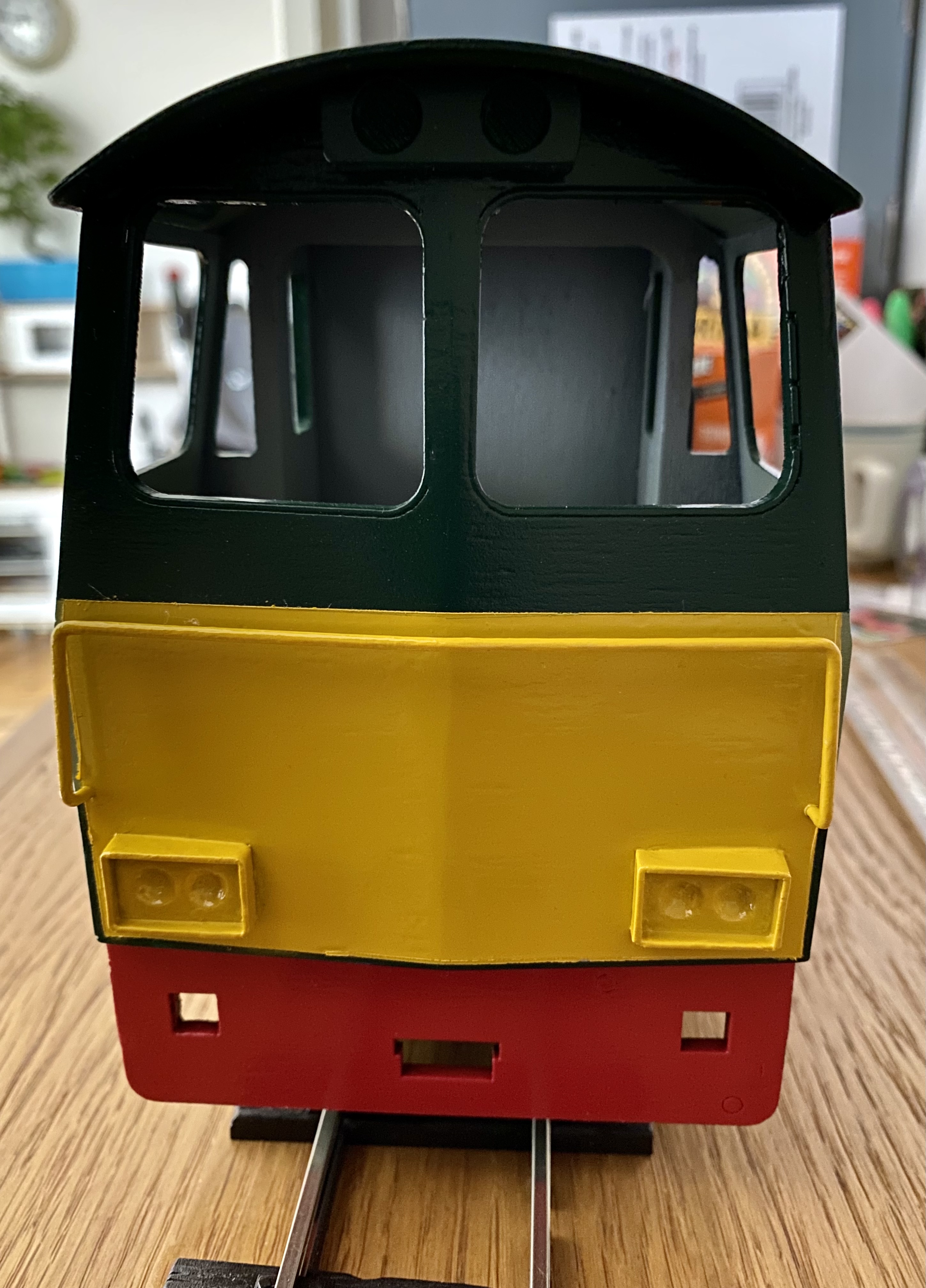

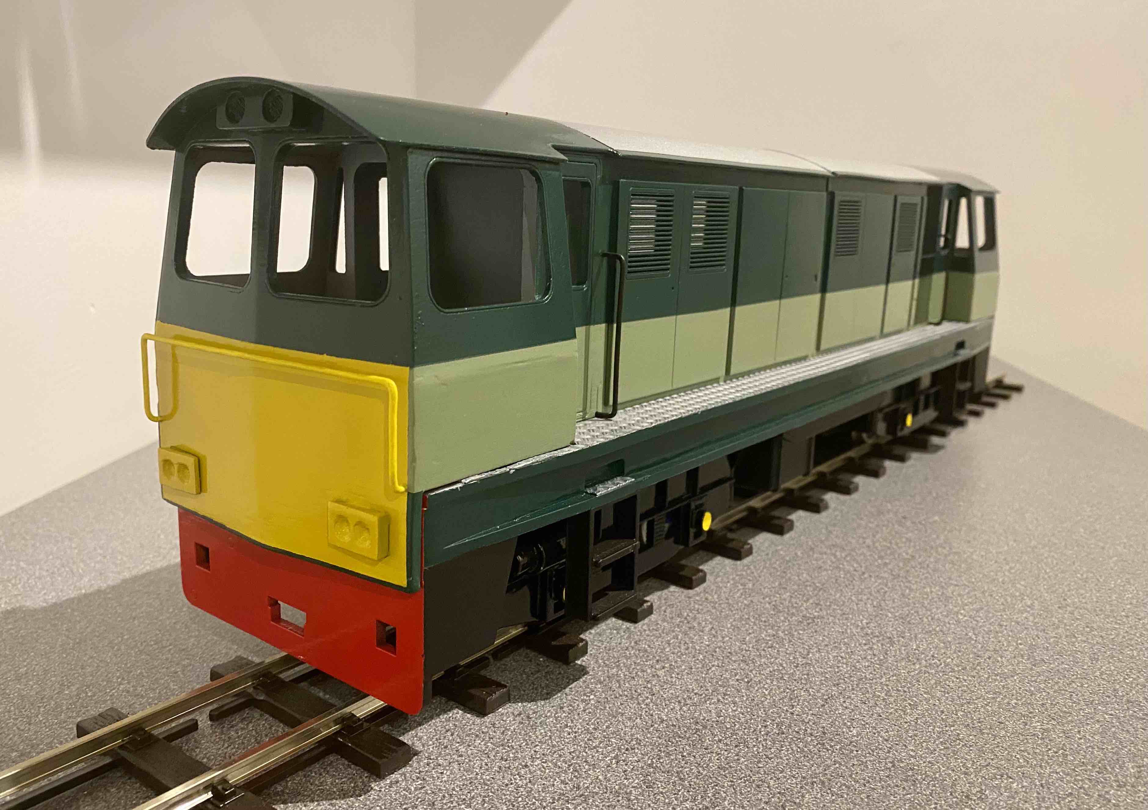

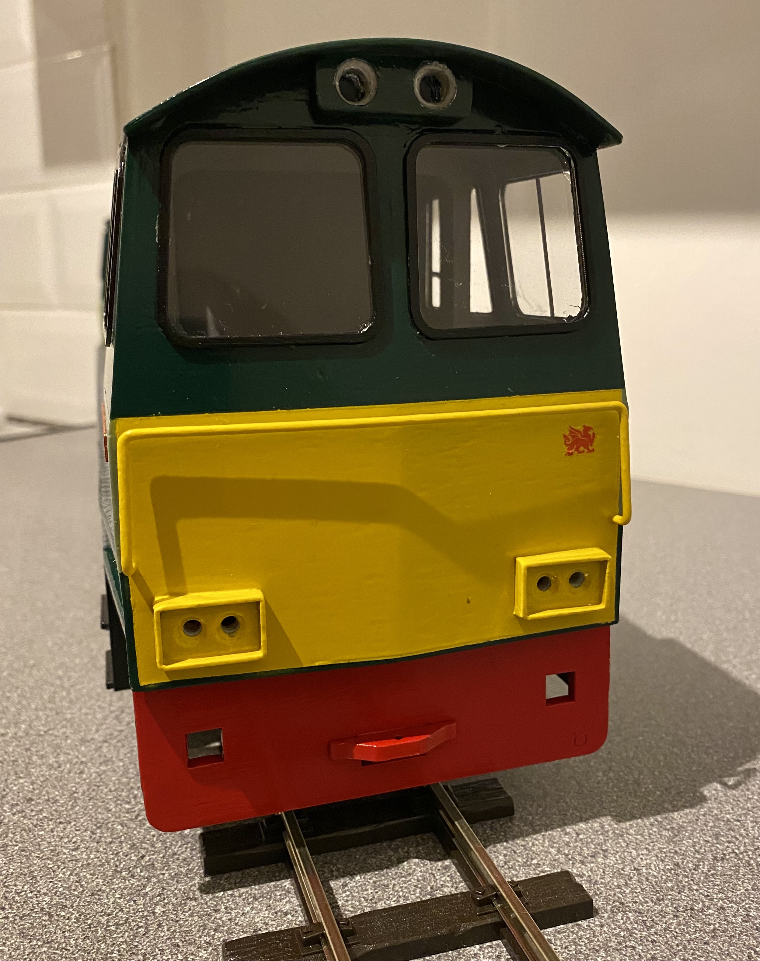

A few more photos to show current progress. I'm not happy with how the front 'yellow' lights are looking but have a plan to tidy them up. Everything else is looking good though I think! Does anyone have any suggestions for what to use for vacuum pipes?
Re: Yatton Models - Vale of Ffestiniog
Posted: Mon Jun 21, 2021 1:51 pm
by Tingewickmax
Vacuum pipes - Both following methods involve electrical shrink wrap. Either obtain a compression spring of the right diameter (soap pumps are a good source), cut to length and insert bent brass rod for shape and locating, then shrink the wrap over the spring.....or,,,,, use suitably sized long chipboard screw, bend to shape and cut to length (removing as much of the shank and tapered end as possible. again encapsulate in shrink wrap, of appropriate size, and heat.
You can also buy a length of tension spring material, 3 mm OD should do it, available from model engineer suppliers and Ebay. Cut to length add some brass rod/wood dowel in the ends to locate to buffer beam. Dean Goods do some nice high resolution 3D printed items, for L&B stock, about the right size, although you would have to remove the stand pipes. Resurgam and Bowaters may sell you the items they use. Max
Edit - I have just noticed the "vacuum" pipe on this loco looks like a plain silver hose in some shots, not the usual ribbed type. so a bit of 3 mm neoprene tube painted up should do. Then again.........It appears to have been fitted with both types.

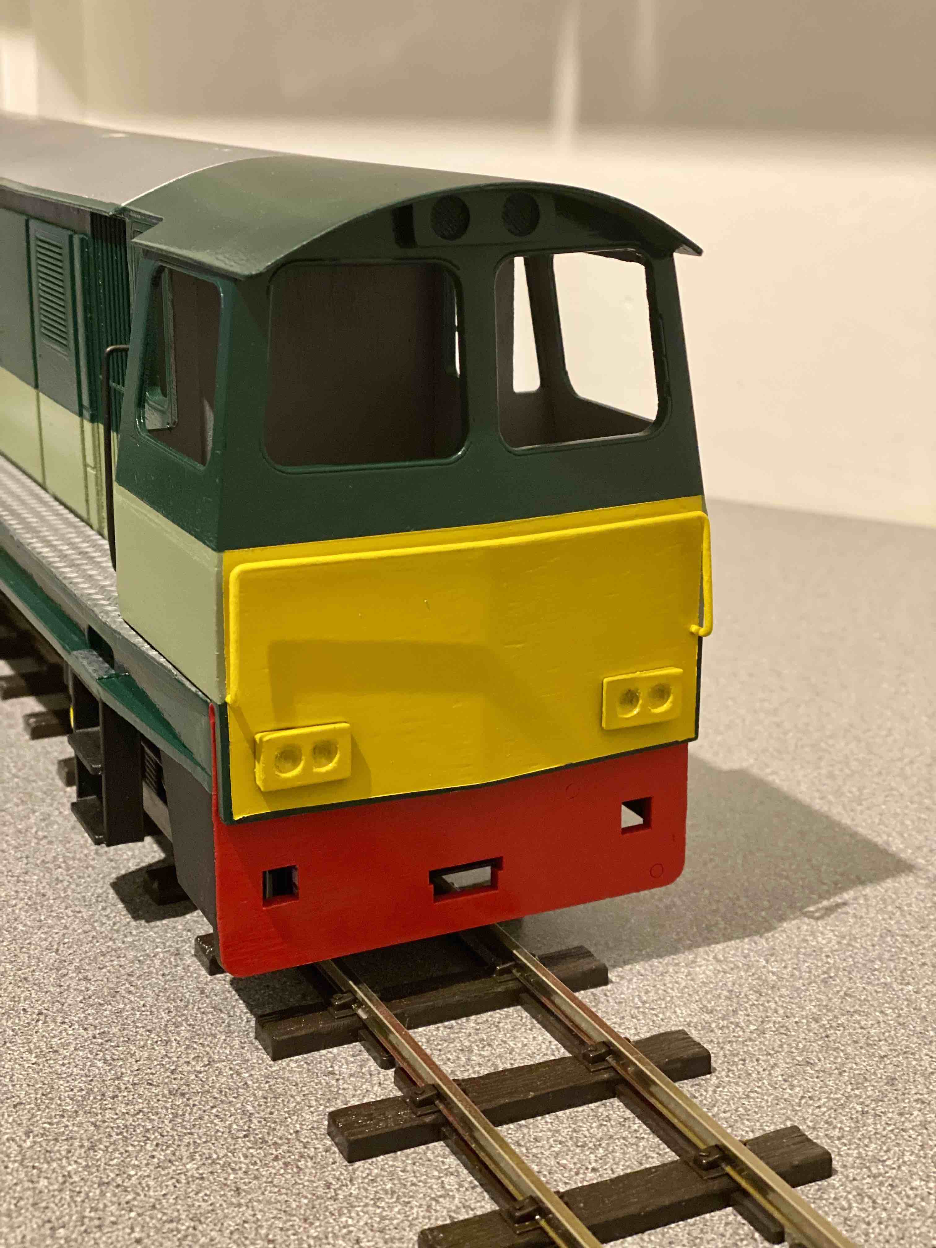

I wrapped the front light fittings with some plasticard. Once I’ve drilled out the holes for the LEDs I might give it one last coat of yellow.
Posted: Tue Jun 22, 2021 9:07 pm
by Lonsdaler
That's really improved the light mounts George. The yellow looks 'solid' enough in the picture. Does it need another coat? Good stuff. Looking forward to the inaugural run.

by Jimmyb
Yes that really sets the light off nicely.

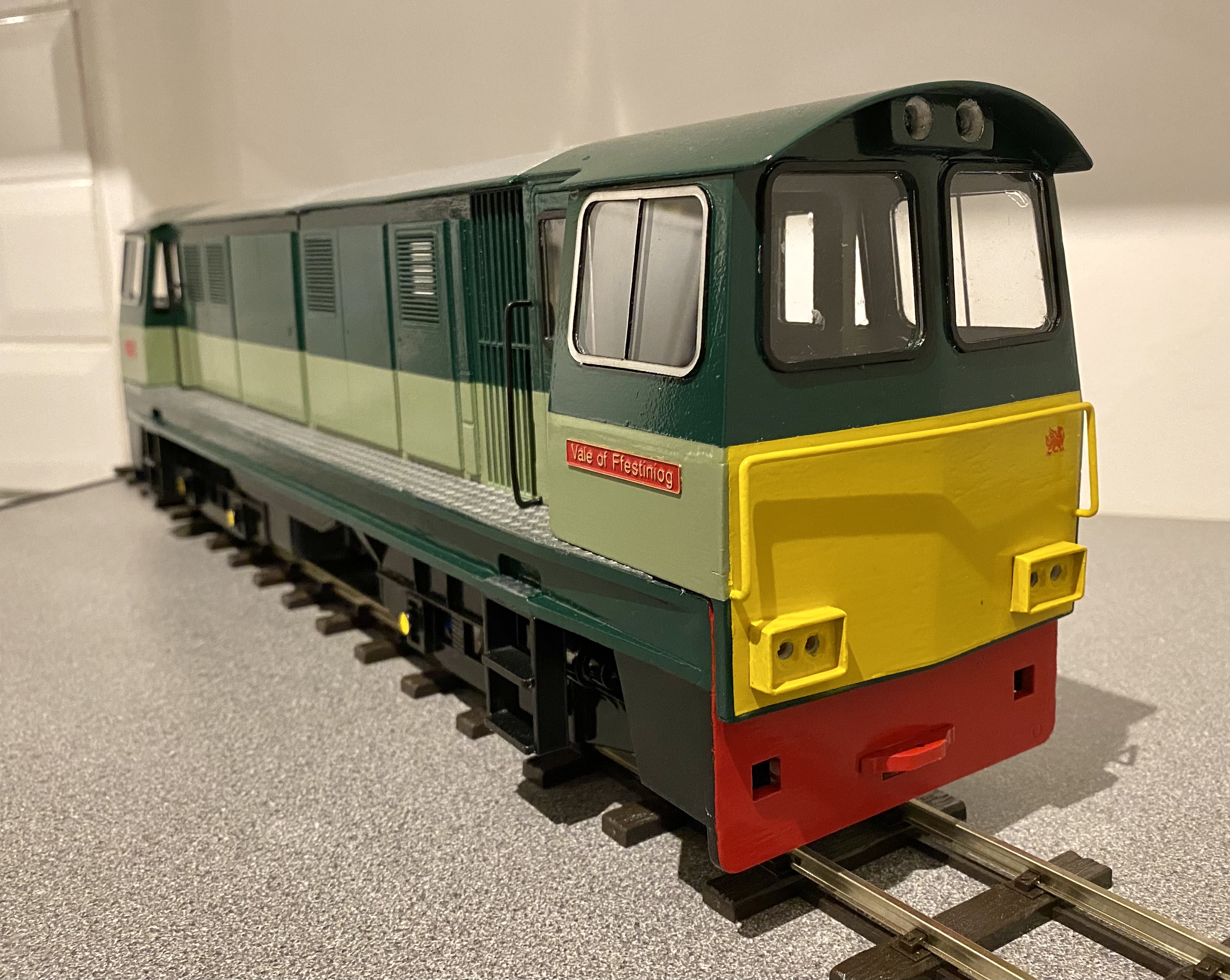

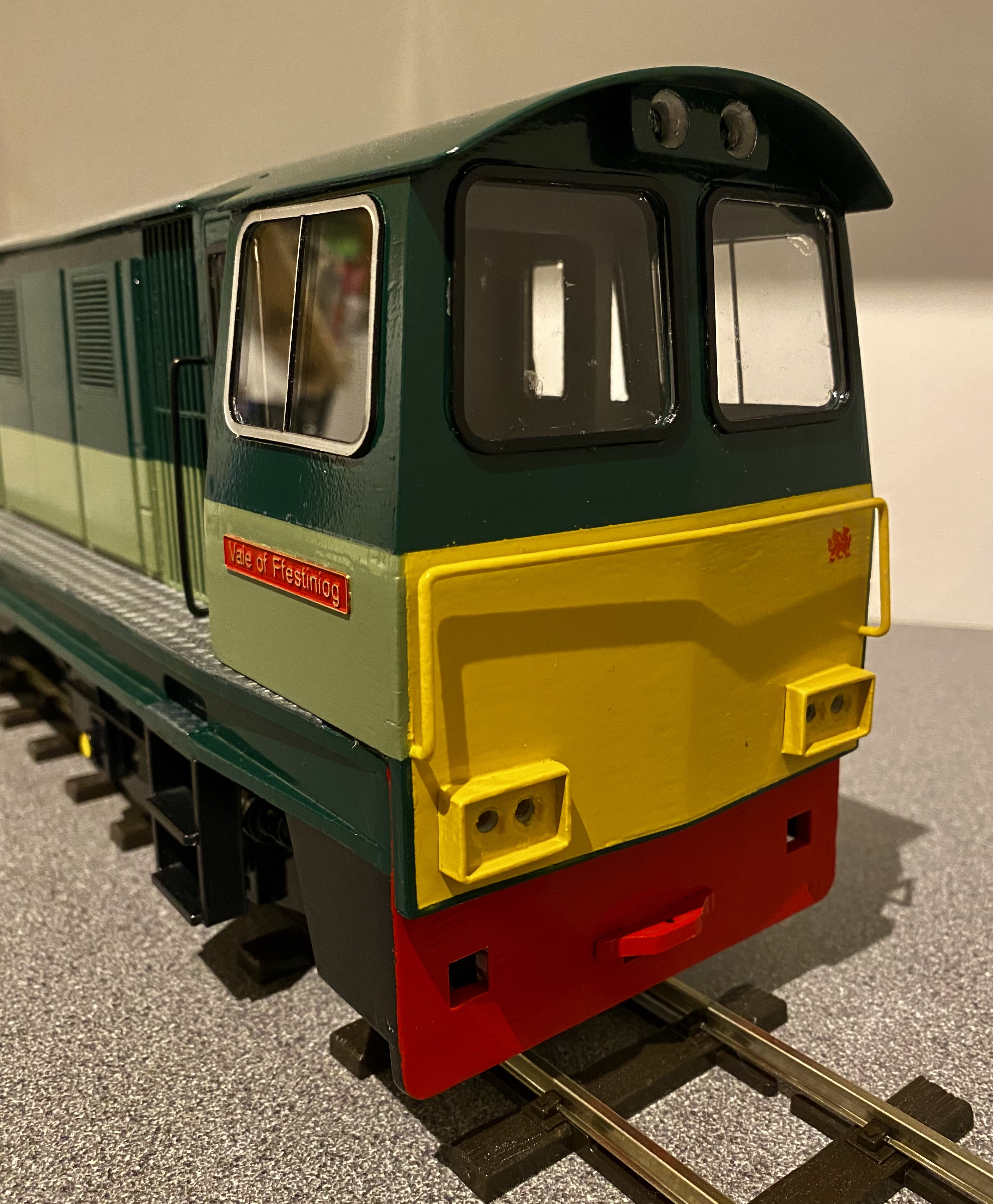

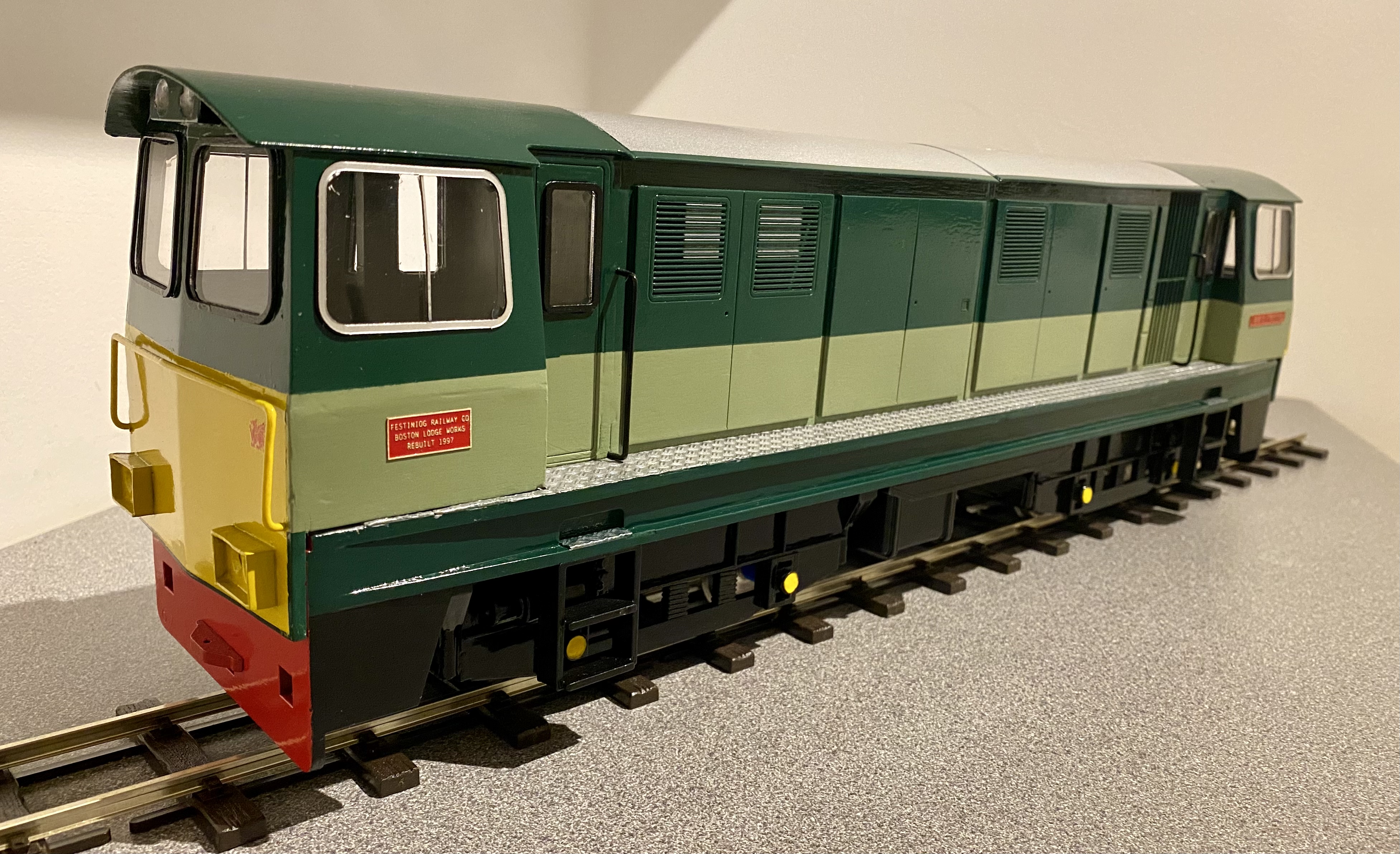

It’s been a while since I posted - life has the unfortunate habit of getting in the way of things you’d rather be spending time on!
The model is now atheistically complete bar fitting of some Brandbright vacuum pipes. When I got to fitting the window frames I realised one set, the aluminium ones, were missing from the kit. Peter was very quick to send out some replacements so great service there. The plates are from light railway stores - they took four months or so to arrive but I’m pretty happy with the quality. https://www.lightrailwaystores.co.uk/pr ... 423?_pos=1

Now that does look smart!
Posted: Mon Aug 23, 2021 11:09 am
by Jimmyb
Looking very good, indeed.
Posted: Mon Aug 23, 2021 11:40 am
I had initial doubts about this kit but you have transformed it into a thing of beauty.. congratulations.
