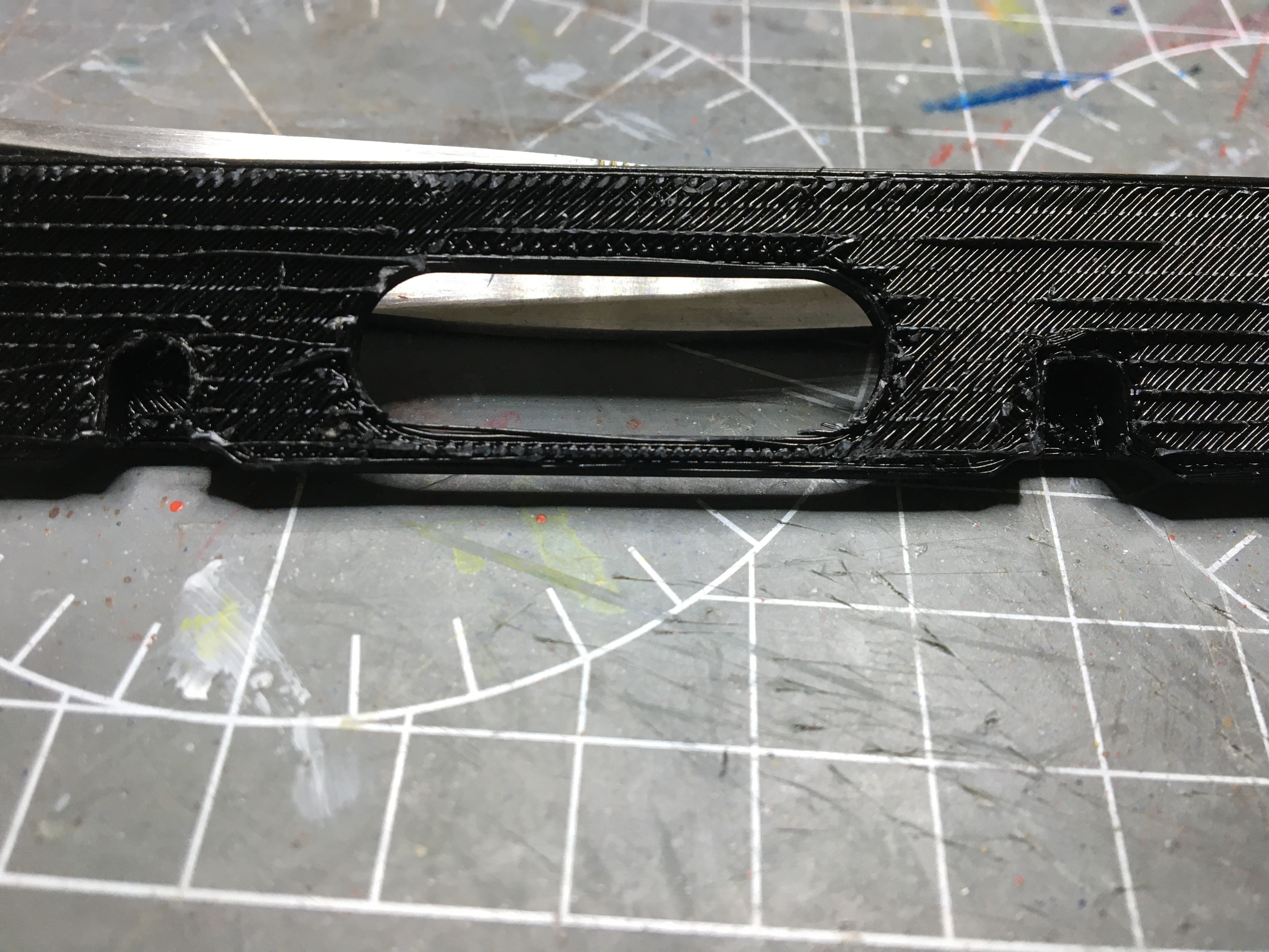

I have just printed one of the Diesel files, the frame. The same one has you have I think, but I am confused a little bit. The frame should have the springs with them showing the smaller spring at the bottom don't they. If that's correct, which I am certain it is, how do you keep the axle in the frame...
- D2A9E41D-36A6-44A1-967A-7DB8DB2A0711.jpeg (3.1 MiB) Viewed 9953 times
- 51688D9C-C391-47F6-B8C1-2E2C1D885DF8.jpeg (2.28 MiB) Viewed 9953 times
The photos are not very clear sorry and I haven't clean it up yet. I printed this flat before you posted about doing all yours upright. And I have got Flashforge black filament now.
I am being stupid I know, but the axles would fall out if I put this on the track ..
Yes, same one as me, i.e. the clarionut remix. I haven't built it yet, so I can only go on what the instructions say (and those are from the arockStone original, in which the frames are further apart, but I assume they still apply). I think the frames are dummies so the axleboxes aren't actually designed to keep the axles in the frame, instead there is an internal frame (#3 in the instructions). Seems like you're going to get ahead of me in building this so let me know if I've got that right!

SimonWood wrote: Thu Feb 04, 2021 12:20 pm
Exactly right Simon. If you build it for 32mm be careful about the frame positions/spacers and the buffer beam. I got it wrong and spaced them for 45mm!
