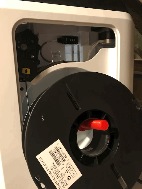

pandsrowe wrote: Sun Dec 27, 2020 2:27 pm Is it not practicable to wind filament from a larger spool onto the Flashforge reel, or is it not worth the bother?
I also like the idea of the door being shut on the filament - makes the whole thing seem properly organised. I spent the first 9 months of using one of these transferring filament to the smaller reels. I have stopped bothering - I am using it so much that its more fuss to transfer it than to just use an adapter. Otherwise it doesn't seem to make any difference. The hole through to the printer with the door off isn't very big by the way.
SimonWood
Posts: 814
Re: Adventures with a Flashforge
Post by SimonWood » Mon Dec 28, 2020 9:58 pm
Trevor Thompson wrote: Mon Dec 28, 2020 9:15 pm The hole through to the printer with the door off isn't very big by the way.
This is a good point. It's the bit with the light shining through in the top right of this photo:

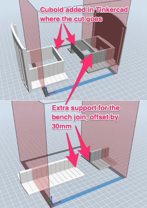

I've come up against the bed size restriction a few times. It's not a big problem - for example with Rik's short wheelbase van I had to cut both sides, but I just chose a suitably simple place to disguise the join - and because I printed in ABS it welded back together nicely.
I've been printing the Thingiverse bug boxes and there are more parts there that need cutting, the join needs to be good because it affects structural strength, and since I'm now printing in PLA I'm having to do it with superglue (ugh). Since there are variations on these I'm reprinting the same part(s) several times, and improving my cut-n-shut technique as I go: specifically I have modified the files slightly in Tinkercad to increase the surface area of the joint, which is very easy to do. Hopefully this picture explains it a bit better:
I've positioned a new cuboid and then sliced right through it, greatly increasing the surface in contact when I glue the parts together. I've also chosen to cut the frame and the bench in different places, so that each one strengthens the point where the other is joined. Again, to increase the surfaces contact at the join in the bench, I added a strut across the frame immediately below it. I think I'll start a separate thread for my builds of the bug boxes - there are several variations on these I've now got in progress...

I did these in Tinkercad which lets you import an STL file, it then treats it like any other shape, in this case I'm just very simply combining with additional cuboids but you can also use 'hole' shapes to chop bits out or whatever you like, really!

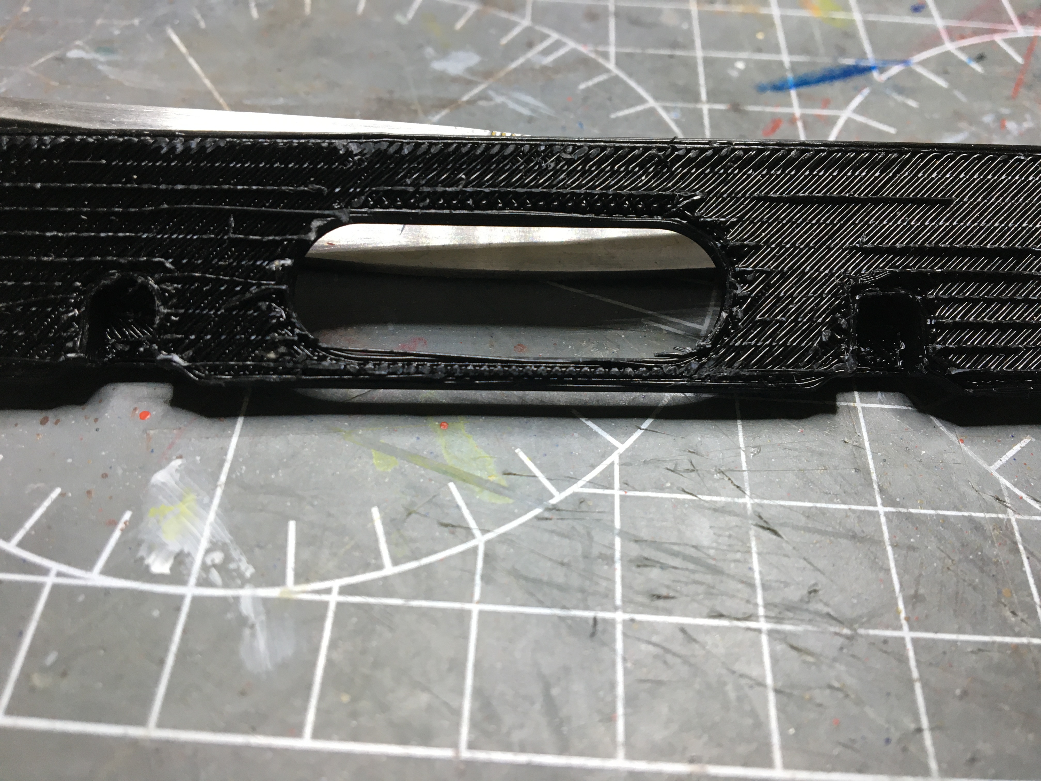

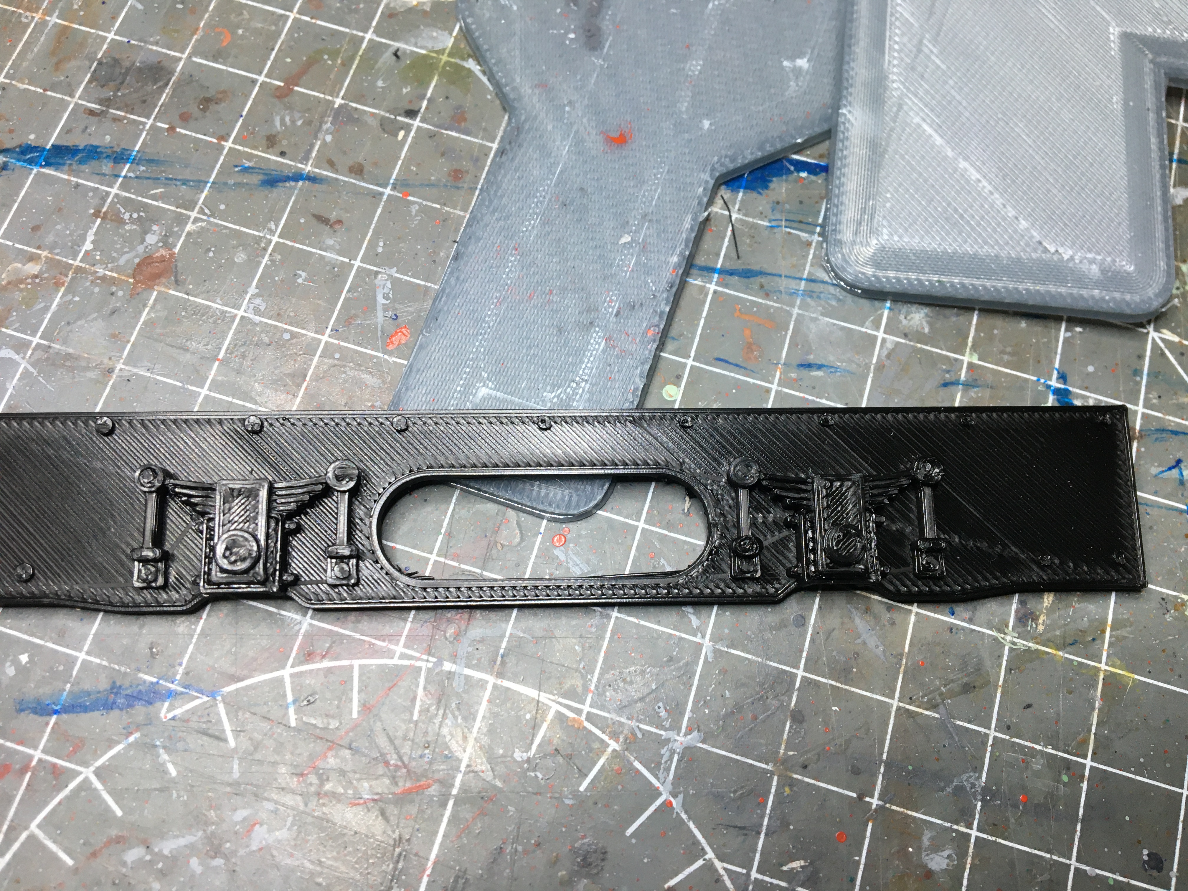

I have just printed one of the Diesel files, the frame. The same one has you have I think, but I am confused a little bit. The frame should have the springs with them showing the smaller spring at the bottom don't they. If that's correct, which I am certain it is, how do you keep the axle in the frame...
The photos are not very clear sorry and I haven't clean it up yet. I printed this flat before you posted about doing all yours upright. And I have got Flashforge black filament now.
I am being stupid I know, but the axles would fall out if I put this on the track .. :lol: :lol: :lol:

FWLR wrote: Thu Feb 04, 2021 9:31 am I have just printed one of the Diesel files, the frame. The same one has you have I think, but I am confused a little bit. The frame should have the springs with them showing the smaller spring at the bottom don't they. If that's correct, which I am certain it is, how do you keep the axle in the frame...
Yes, same one as me, i.e. the clarionut remix. I haven't built it yet, so I can only go on what the instructions say (and those are from the arockStone original, in which the frames are further apart, but I assume they still apply). I think the frames are dummies so the axleboxes aren't actually designed to keep the axles in the frame, instead there is an internal frame (#3 in the instructions). Seems like you're going to get ahead of me in building this so let me know if I've got that right!

SimonWood wrote: Thu Feb 04, 2021 12:20 pm I think the frames are dummies so the axleboxes aren't actually designed to keep the axles in the frame, instead there is an internal frame (#3 in the instructions). Seems like you're going to get ahead of me in building this so let me know if I've got that right!
Exactly right Simon. If you build it for 32mm be careful about the frame positions/spacers and the buffer beam. I got it wrong and spaced them for 45mm!
