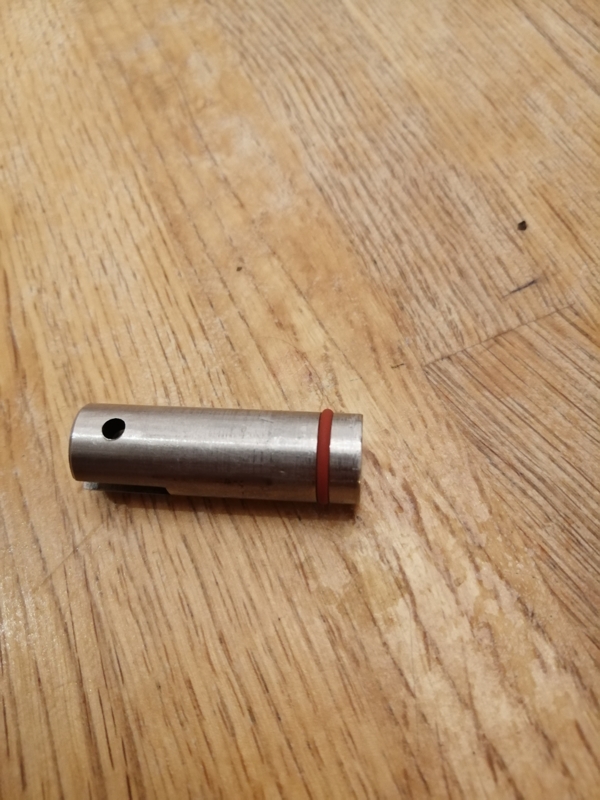

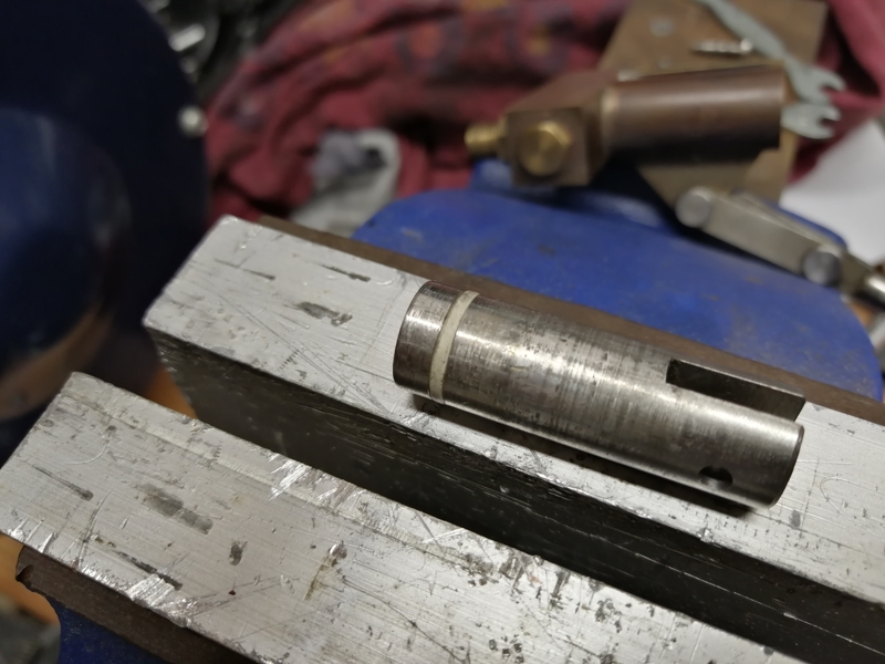

The hand pump started leaking on the last running day at the club in 2019. When I took the pump apart I found this odd looking o-ring used on the ram (possibly PTFE round section?):
When I bought the correct size silicone o-ring and fitted it you can see in this picture that it protrudes slightly out of the groove on the ram:
The groove was found to not be the dimensions as per the drawing so it was adjusted. Now, the o-ring fits properly and the hand pump works although in use is a very slow method of getting water into the boiler so I decided it was time to look into fitting an injector!

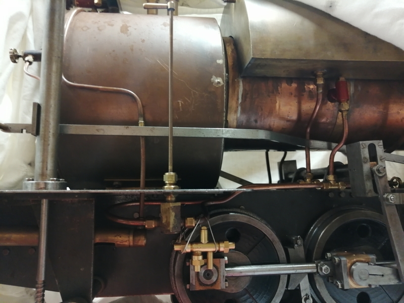

Here is a mock up of the injector in position (held in place with wire temporarily):

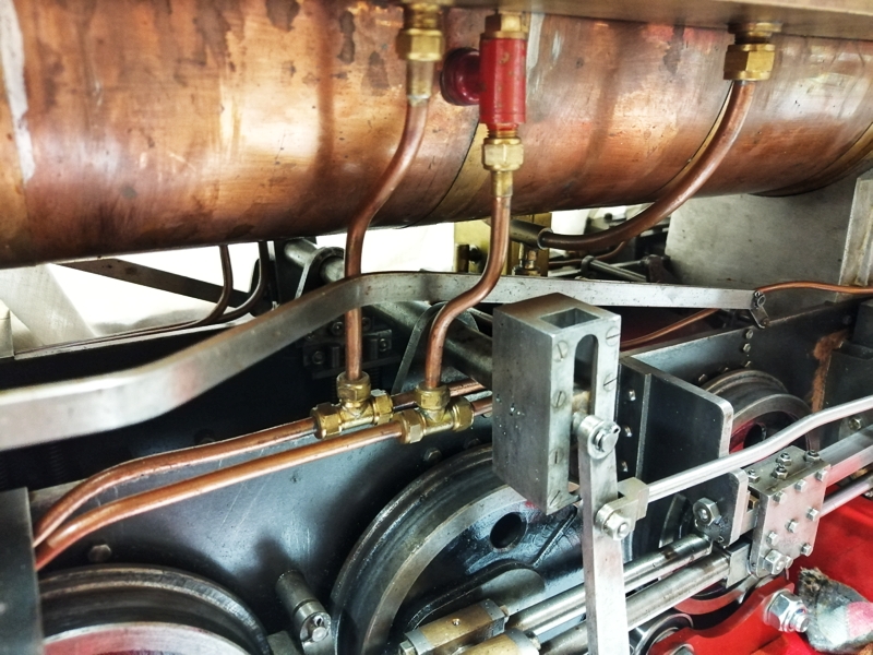

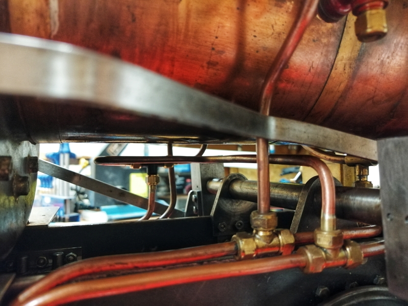

The boiler has two clack valves, one on each side of the loco. One valve feeds water from the hand pump and the other shown below from the axle pump:
The injector needs to have a dedicated feed into the boiler and as you would not normally use the hand and axle pump at the same time they can share one clack valve.
New plumbing is needed which will require silver soldering brass nipples to new pipework. Fortunately, I got experience of silver soldering when I fitted a Regner whistle to a Roundhouse Lady Anne:
https://gardenrails.org/forum/viewtopic ... 25&t=12218
First nipple soldered, not bad if I do say so myself:
This photo shows a new tee piece connecting the hand pump (lower pipe coming off the tee piece) and then the right feed connecting to the axle pump (left feed is connected to the clack valve):
New pipework off the existing tee piece that use to feed the right clack valve now connects to new tee piece to feed water into the left clack valve:
So now we have a free clack valve to use for the injector, woo!

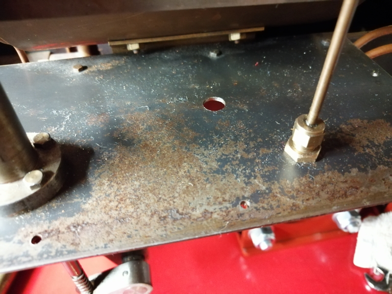

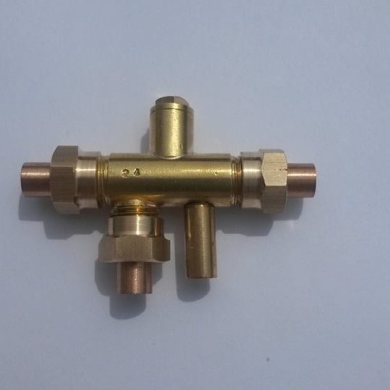

To supply the injector with controlled steam flow it needs to be connected to a valve. The turret on the boiler of the loco already had a valve and a tapped thread for an additional valve should one need to be fitted later on (currently fitted with a blanking plug).
Unfortunately, I discovered that the spare valve on the turret cannot take 3/16" pipe which is what the injector requires (I reckon the valve is for 5/32" pipe which is smaller). After working out the TPI of the thread (after learning how to work this out) I needed to purchase a valve that could take 3/16" pipe with a 5/16" x 32 TPI thread. I grew up with the metric system so just working this all out is an achievement!
Here is the new injector steam valve installed (the connection is angled at 45 degrees so the larger diameter pipe can be connected):
The hole pictured here was used for the whistle pipework that went under the footplate, however, the whistle needs to be moved to make way for the injector water valve that will be installed in its place (I want the whistle mounted on the spectacle plate anyway):
I had to enlarge the hole slightly to allow the larger union nuts to fit. I did this very slowly and with a block on the top of the hole so to not slip through with the drill and hit the boiler!
The new pipework shown goes from the new valve to the steam injector:
I have not soldered the brass nipples on the pipework yet as the injector is sitting too low to the ground, the pipe needs adjusting.

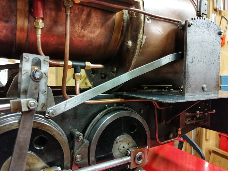

This is the latest work on installing the injector bringing the thread up to present day:
I have not soldered any of the pipework yet so this is just trial fitting.

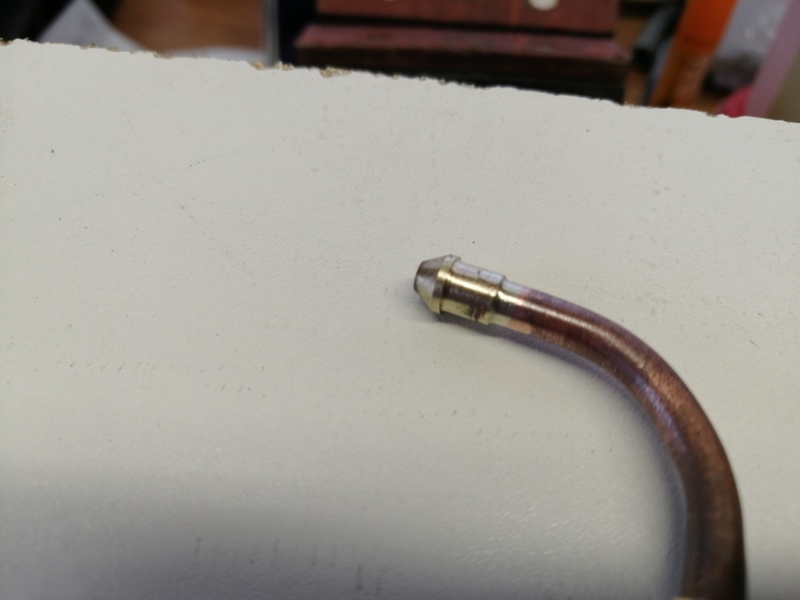

To get the water feed connected to the injector a new take off is required from the saddle tank. The water filter shown below needs to be installed inside the tank with the union fitting on the outside so that a pipe can be connected:
I am starting to get more confident with pipe bending. Although I did buy a pipe bender and pipe bending springs I have discovered that heating copper pipe over my gas hob, cooling and then heating again is a very effective way of making bends without kinks.
