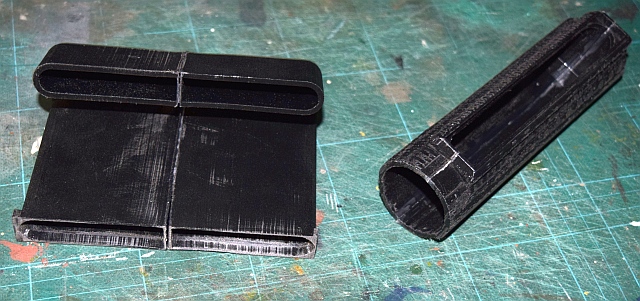

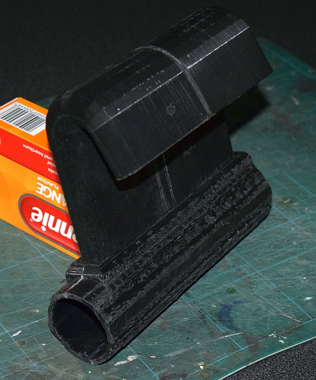

Back on track now... or should that be, up the creek? Anyway, I've now got the water input system more or less sorted. The two spout pieces took just over 10 hours each, to print, and the two halves of the manifold section took about 7hours 25mins, each.
The following pictures are before more than a rough clean up, but with the two pairs glued together to check the fit. There are some gaps but easily fillable.
Tom, you asked about glue and in the end I've actually used Floplast rather than Plasticweld, since it is more tolerant of gaps and I don't want any leaks.
The two halves of the manifold and the two spout pieces glued together:
The two sub assemblies push fitted together:

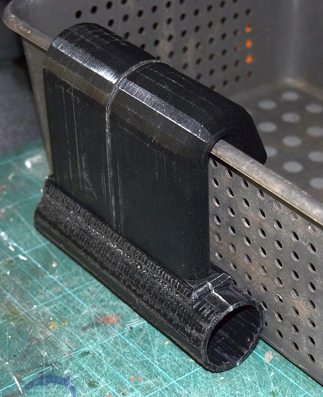

Then hanging on the edge of the tray which will form the top end of the Cuttle Brook ( one day!). I still have to make the hose attachment/bend piece, but don't anticipate too much trouble with that.
I'm currently experimenting with mortar colour to try to get a reasonable match for the stone I'm using and I haver 4 mixes drying in the garage as I write this.
The stream bed is currently full of leaves, mostly ash and elder, the apples and willow haven't really started falling yet, but nothing much to do until its all dropped.

Glad you have chosen a different glue, FloPast from what I have read sounds like it will tolerate being outside all year round.

I have to say that I am suitably impressed with the manifold. The 3D printer proving its worth for custom parts yet again.

Tom, I don't have any fears over using Plasticweld outside. It does what it's name says and welds the plastic surfaces together, so as long as the ABS is weather resistant, so would the joints be. I've been using it outside for years with no problems, but as I said Floplast is thicker and will take up any minor imperfections in the mating surfaces and that was my only reason for switching.

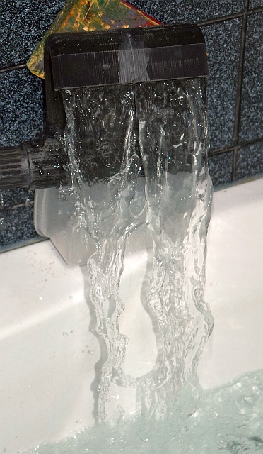

Ok, the next bit now works ( indoors in the bath!), using the pump I intend to use in the garden.

Some small progress. A few days go I managed to check and adjust the stream bed levels so today I took advantage of the nice weather to lay a temporary polythene liner and run the pump just to see it all working. As you'll see I need to adjust the top end to give myself a little more headroom, but other than that it all seems satisfactory. The plan is to remove the polythene and use it as an approximate template for the real liner, it should be a lot easier to cut it flat on the lawn rather than draped around the plants.
