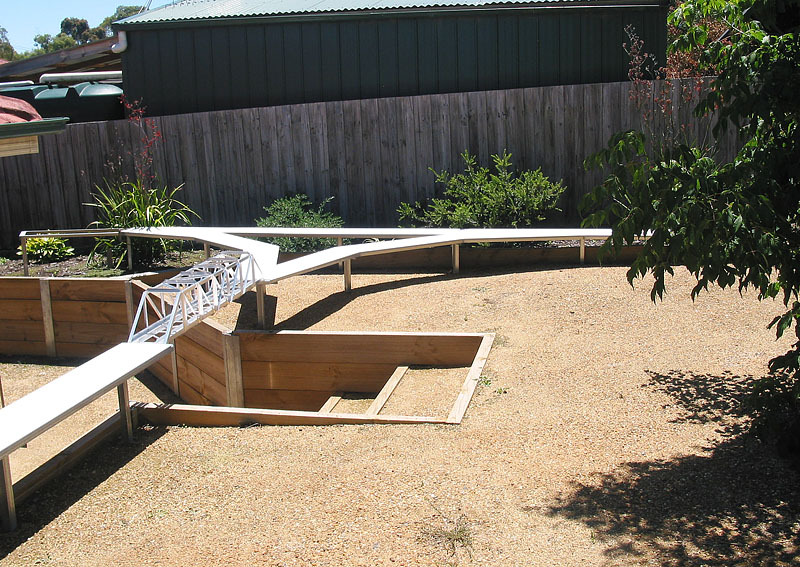

In spite of the local climate variation, fitting the decking went quickly and was completed ahead of schedule (just).
The photos were taken yesterday just after lunch. I really must figure out this materials estimating business as it came down to the wire as to whether there would be enough boards to finish it before everything in Aust. shuts down for a fortnight over Christmas and New Year.
This photo is facing north and shows the wye, bridge and small curve around to the long straight on the right. The temp was about 20degC and there wasn't a cloud in the sky..........
The next photo is facing south and shows the rest of the track.
I now have to paint the deck, which won't happen this week, then I can start laying track.

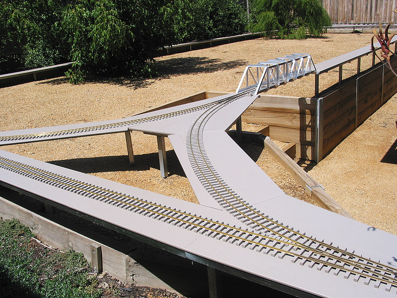

The weather cooled down for two days last week, just long enough for me to install the turnouts and track of the wye at the northern end of the track.
This pic shows the area after the wye was installed. I screwed up the track base layout for the wye and they had to be extended to keep the curves inside the board edge, which took longer than laying the track.
One of the things taking time is painting the sleepers into a weathered wood colour. Australian hardwoods are durable and don't require creosote when used for sleepers, so the dark brown colour of commercial track looks unnatural to me. If the weather is to hot or wet to work outside, I spend the time inside painting sleepers.

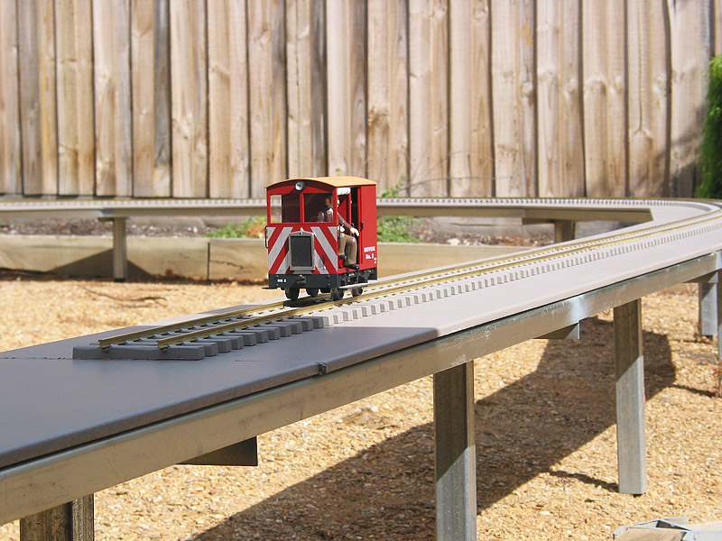

Today the weather was cool enough to lay another 20 feet of plain track and the railhead is now halfway along the back straight. As expected, the Accucraft flextrack has proved easy to lay, as it doesn't need a track bender and more or less stays where it is put until it is pinned down.
The second pic shows the Fowler PM sitting in dappled shade at the railhead in the great Pittosporum wilderness, after a test run to check for any problems in the new track.

I forgot that the turnouts were built like the protype with straight rails through the crossing. Which means they don't diverge as quickly as the nominal radius suggests and moved the curve off the centre line....... sigh!!!philipy wrote: Mon Feb 11, 2019 4:17 pm Screwing up the width of the curve is very easy to do (how do I know?).
