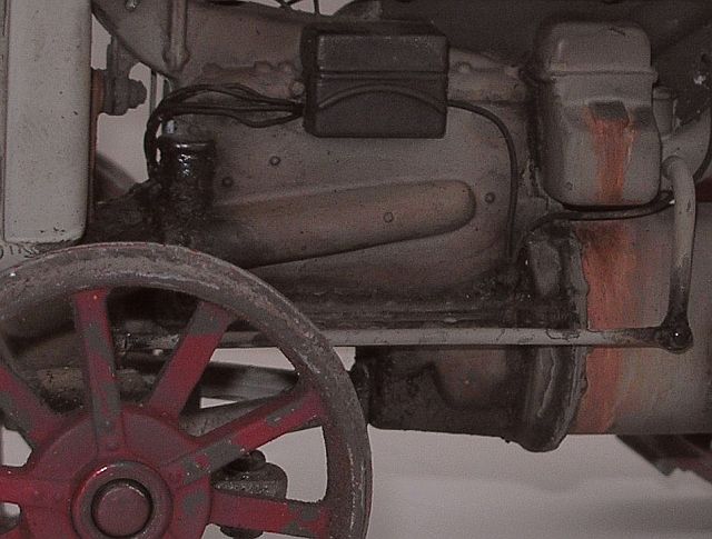

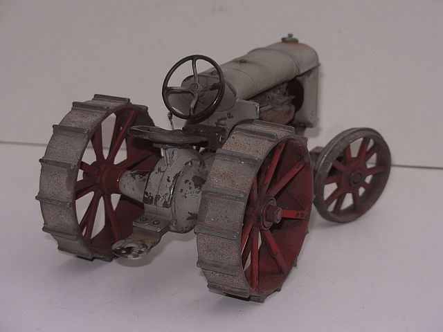

I too like polishing steel handrails, steps, running boards etc. to show constant wear, was wondering have you tried the paint and chip method using Maskol. Certainly not my idea (copied from Chuck Done on an American forum, worth looking up!) Strip the object to bare metal, apply the Maskol with a sharp tooth pick where chips and scuffing would appear, then spray or brush paint. When dry and hard, pick the Maskol off leaving a chip back to bare metal. I used it on the tractor in the pic. below. For oil and grease grime I add talcum powder to the brush, mixed with the paint and stippled to give depth. A very dark brown to almost black colour, followed by some gloss varnish to give a wet appearance as in the oil filler and steering rod ends. Grant.
Re: Finishing the unfinished
Wow Grant that is very very good. Looks just like the real thing....

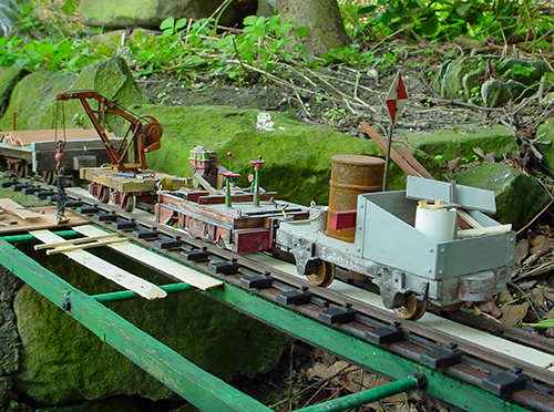

That looks good, yes Its a technique I use for heavier weathering such as the ballast hoppers (first picture this thread). I have tried the technique with an partial undercoat of βrealβ rust but this can be hit and miss. When it works it is great. Also It is no great problem if you donβt notice all the Maskol blebs as they can look convincingly like bubbling paint.

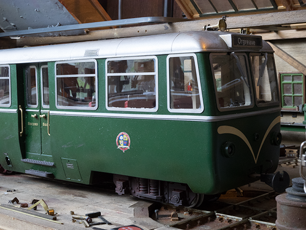

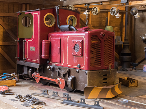

Well, there was a hiatus with another hospital admission, but there has been progress on some projects.
The railcar has been glazed and horns put on so that is pretty much finished:
The snowploughs are fitted to the diesel, No 4. Below are the re-railing bars ready for re-fitting in Spring:

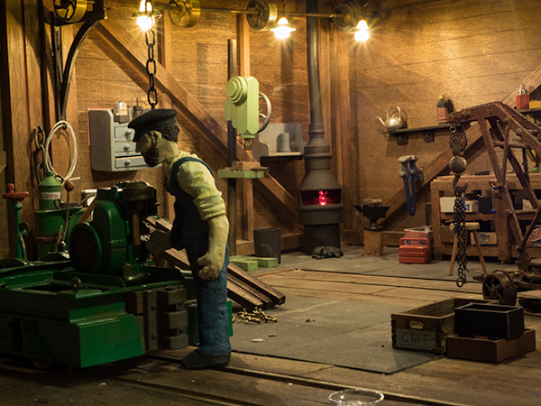

However the Lister is still under refurbishment with Dicky working late into the January evenings:

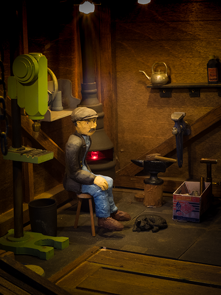

Whilst Dicky works at the cold-end of the workshop, Davey and cat snuggle by the forge to keep warm.
More in due course.

Your pics. have me scrutinizing the background in addition to the main subject, did you add the fan behind the radiator on the diesel? Love the overhead line shafting, HO wheels with the flange turned off perhaps. (be a bit of whip running anything off the centre pulleys
) Timber workshops always look very comfy with the lights on, glow of timber and all that. Excellent work and more please, as others have said.

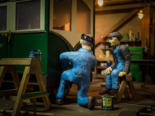

The Lister may have stalled awaiting electrics, but the workshop lads have pressed ahead with No 6 Observation Coach (aka "The Lady of the Dales").
Bob worked into the gloom of the late afternoon finishing the lining, but of course Old Davey (who hangs around the workshop) knows a better way of doing it from when he was a lad. Still it does mean he vacated his favourite place by the fire for once.
The decals and lining are done, the brasswork been fitted. All that needs doing is the lighting and fabricating the roof. Thorough testing of the Cleminson Chassis will have to follow when the weather is warmer, as I have worries about the vertical movement of the middle axle (or relative lack of it).

The fan is a cheap internal computer fan and runs when in use. The overhead line uses turned down wheels from (I think) Ron Grant. Many years ago when he was trading he sometimes included a SINGLE extra wheel in an order (!). Even when you didn't order any wheelsets. I'm not sure if it was a form of advertising of what he did. Still what can you do with three wheels which is what I acquired over time? The overhead line shafting (along with the block-and-tackle) are photographic props and in fact if you look closely (well, maybe not as I try to control stray revealing angles) you might make out that they are engineering impossibilities. But they look good in setting the scene.LNR wrote: Thu Feb 01, 2018 4:16 am Your pics. have me scrutinizing the background in addition to the main subject, did you add the fan behind the radiator on the diesel? Love the overhead line shafting, HO wheels with the flange turned off perhaps. (be a bit of whip running anything off the centre pulleys) Timber workshops always look very comfy with the lights on, glow of timber and all that. Excellent work and more please, as others have said.
I have to retrieve some photographs of the actual garden railway as I am aware that this thread is getting a little thread-bare with only three-and-a-half square feet of workshop to photograph. Still the projects have been good occupational therapy and rehab.
