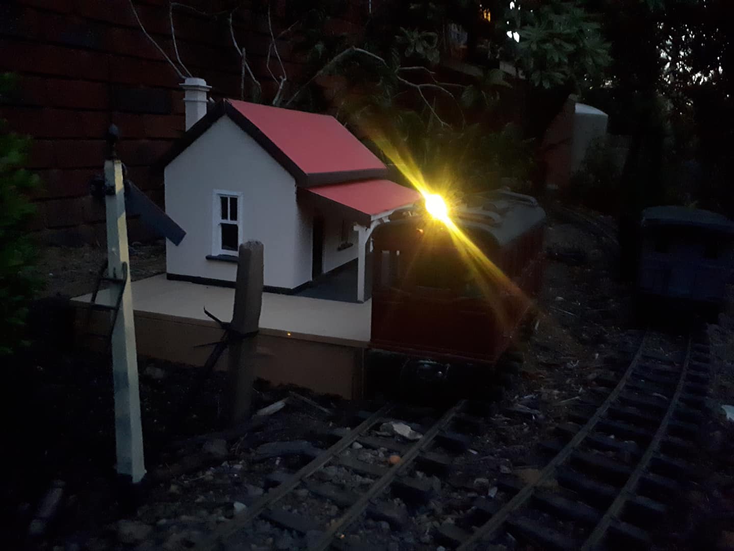

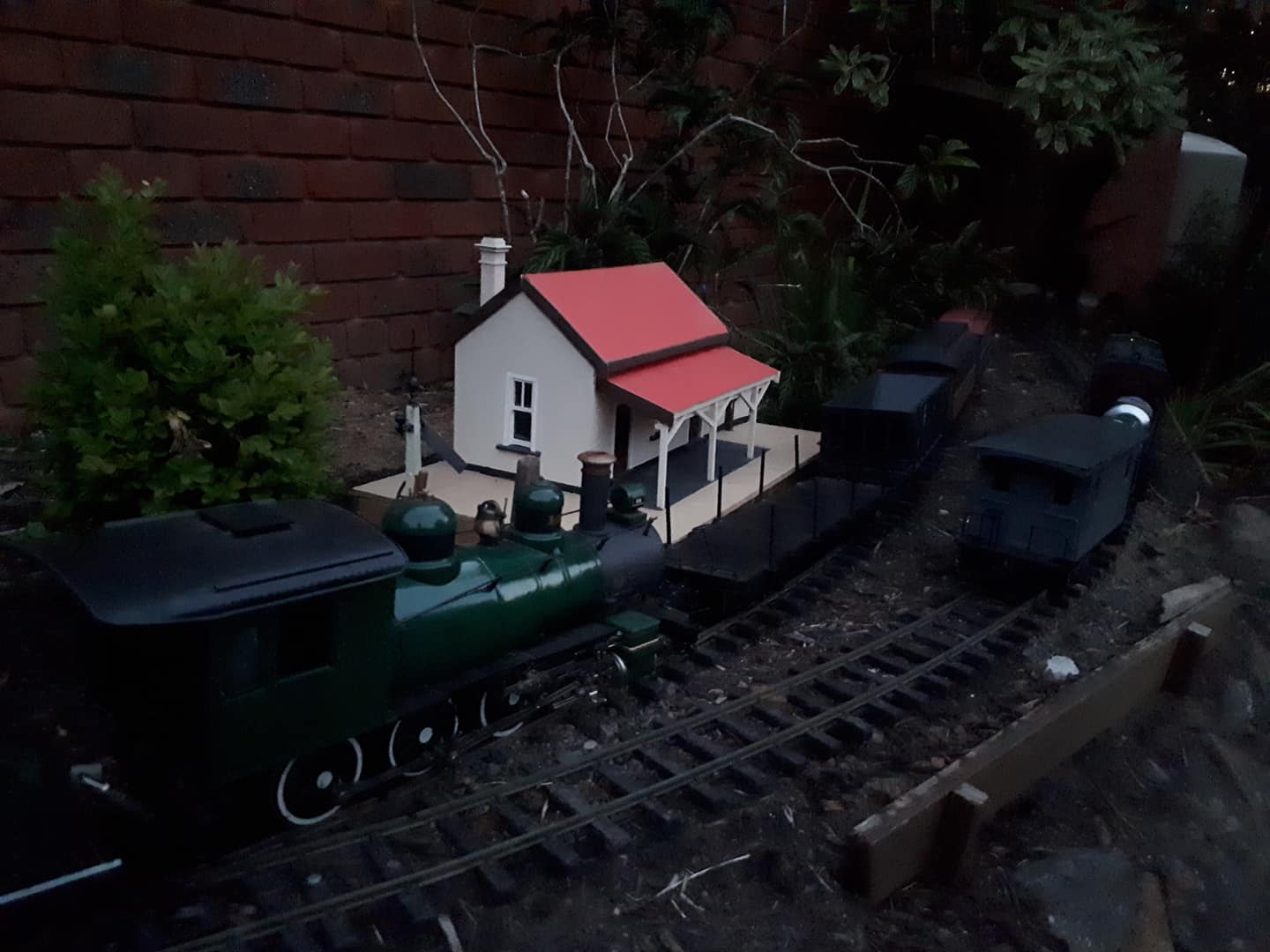

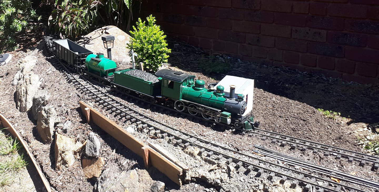

2018 has been an extremely interesting year for the railway we've gone from a small loop with a handful of track powered locos to a short but operational point to point railway with five battery powered locos and a heap of Australian locos in the pipeline. Hopefully the fair rate of progress keeps going into 2019. Ryan was interesting in having a run so he came over from the other side of town and along with Alexander and Darren at one point we had 4 trains running at once!

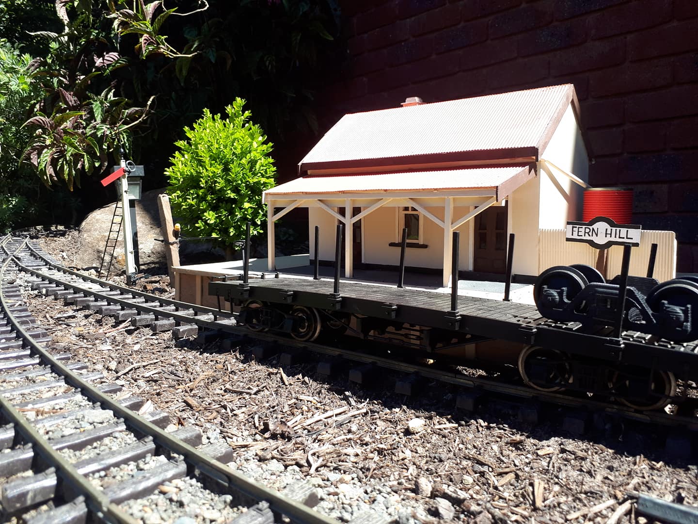

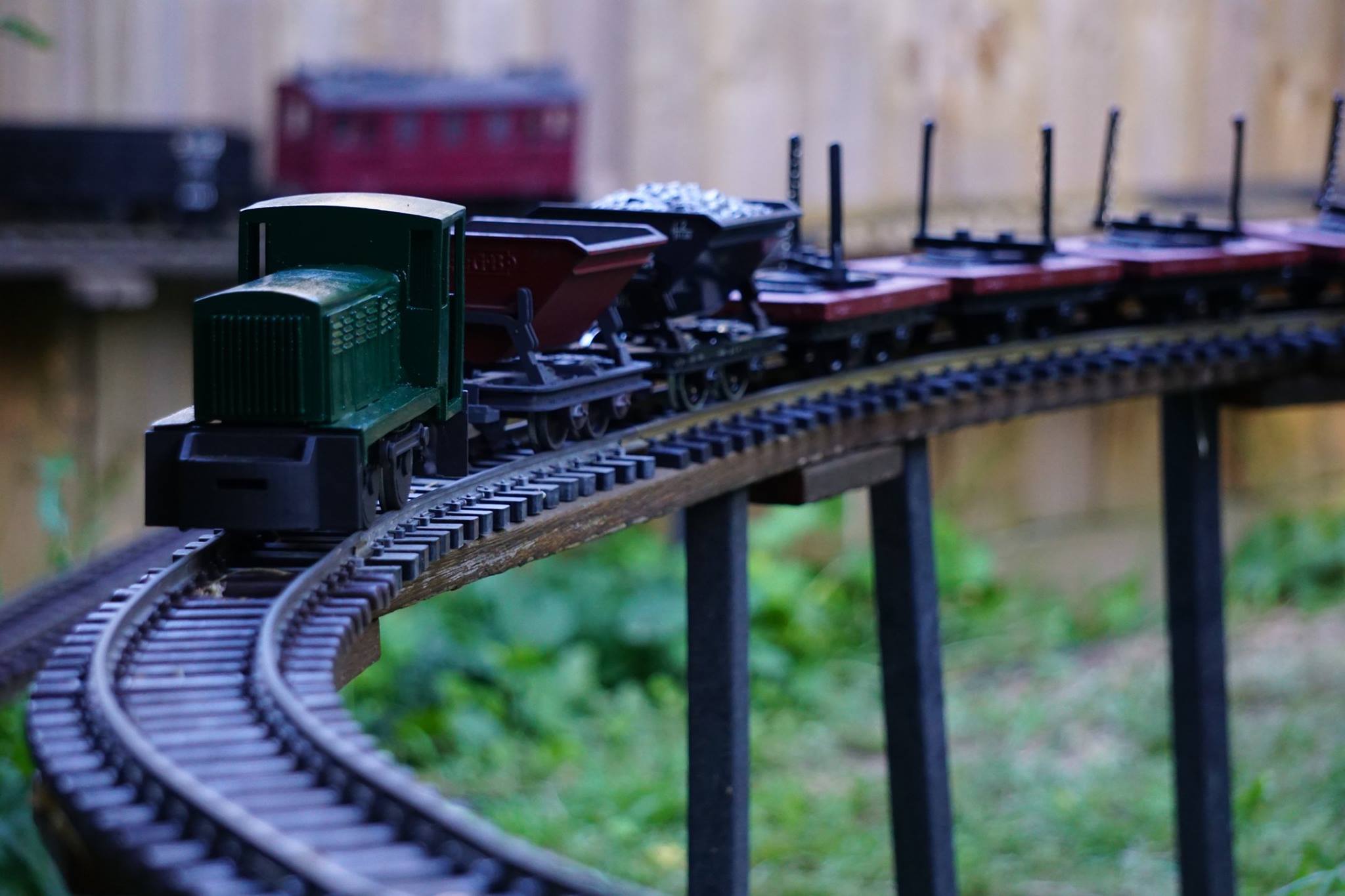

#14 Arrives at Badger creek with a long freight train. D1 Pulls an empty ore train around the mainline leg of the Wye past the NSWGR signal box. This was a model made for HO scale that i found on thingyverse by badgerbreath, The roof is aluminium BBQ trays from bunnings cut up to scale size and corrugated using a FIskars crimper. D1 and #14 depart the mine wye on their way back down the hill. all dressed up with no where to go! For some reason the signalman has put the stick "on the green" without any train present and with the points set against the road! Mine shunter A9 prepares to push back up the triangle while D1 waits in the interchange. the evening mixed leaves Badger creek D1 returns the last wagons of the day to the top of the line.
Some brilliant photos Jake of some really great looking locos.
Looking good - I love the station building. 4 trains running at once sounds good too - in theory that's just about possible' i=n my line, but I've only ever managed two, and that was pretty hairy...

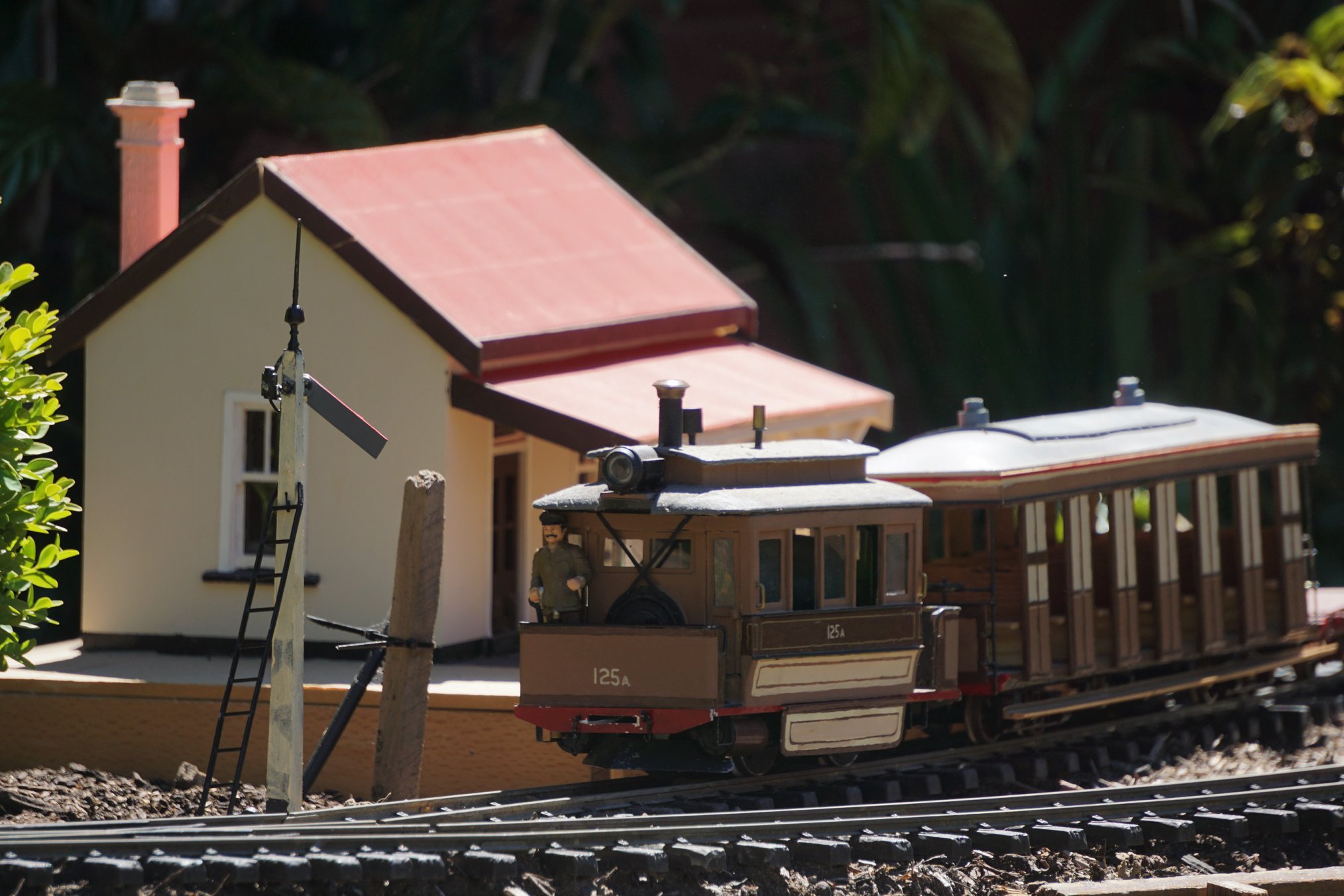

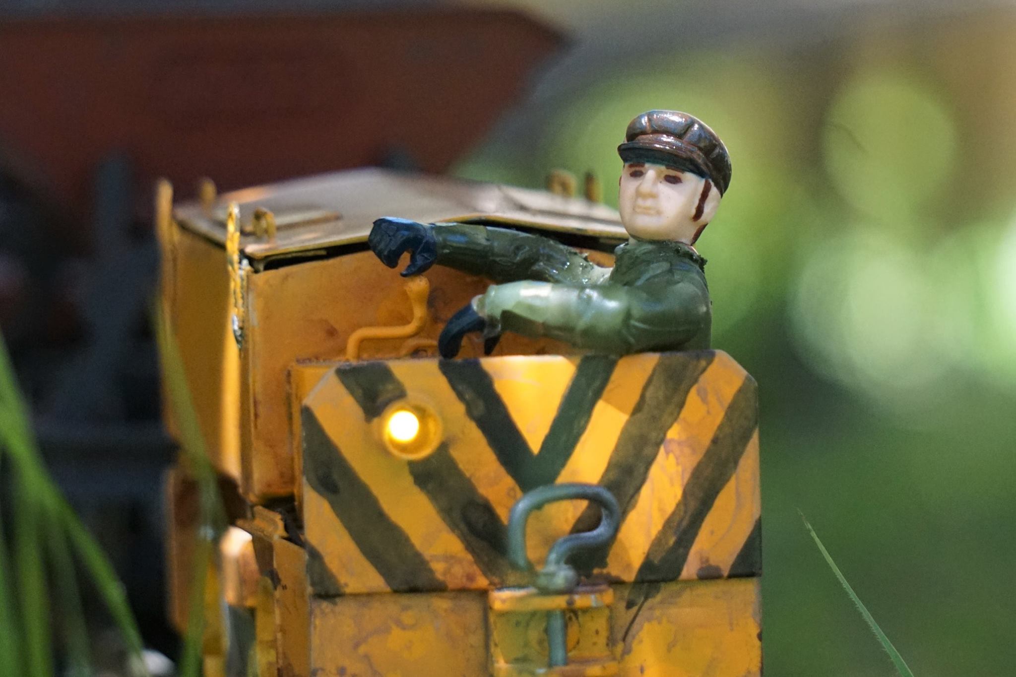

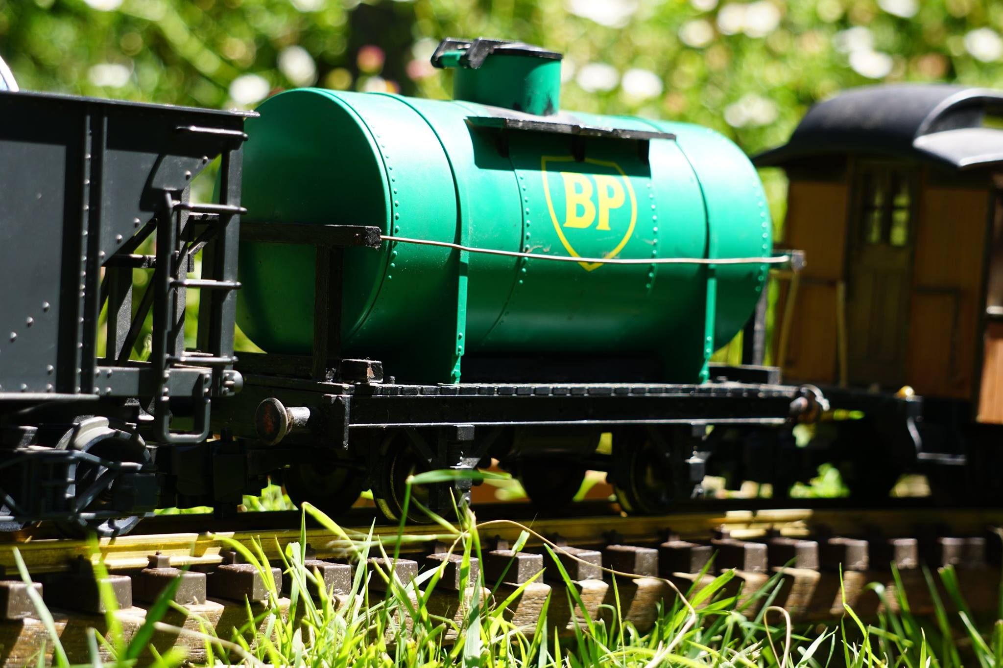

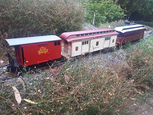

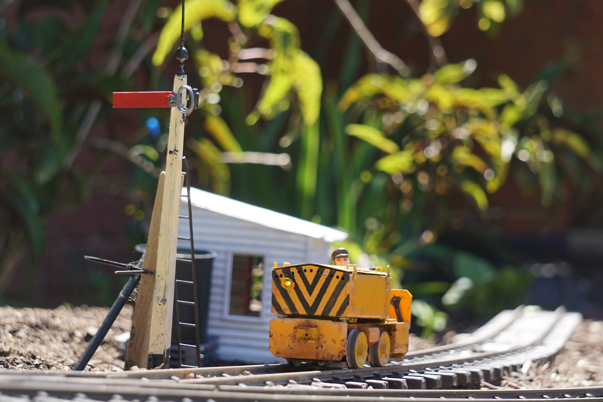

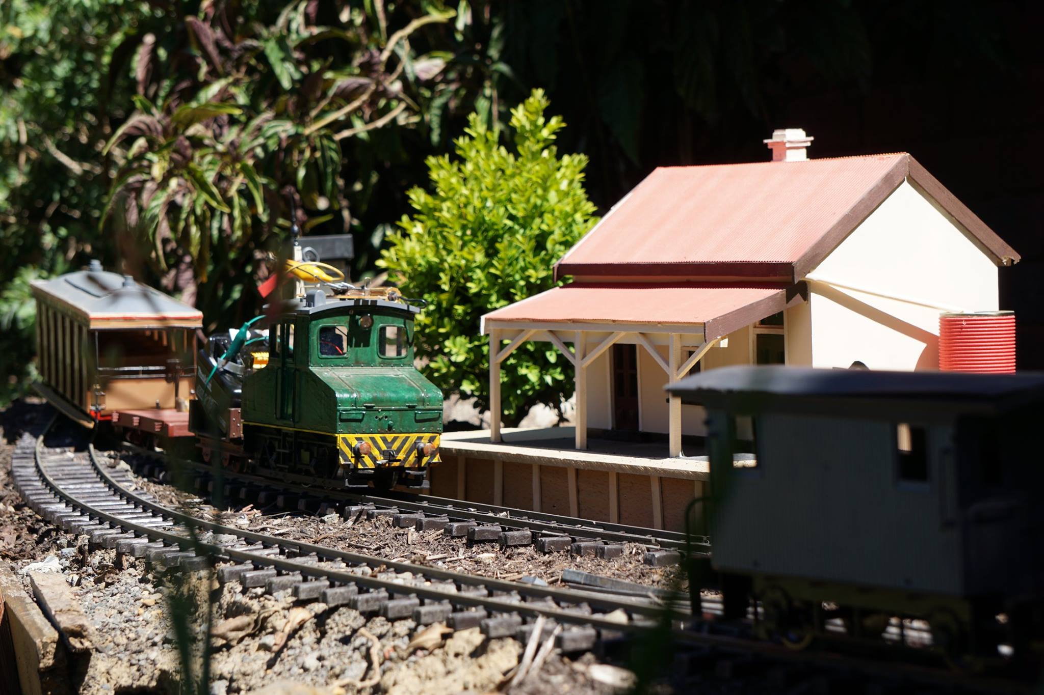

heres a few photos my father took of some of the other trains The driver of the battery electric is probably praying at this point. The twisting climb up the 1:30 is usually a fairly good test of an engines stamina. It made it to the top and somehow managed to acquire a train. Another fantastic model by Alexander this one always wins points for its portability. Steam Motor and trailer ready to depart Badger creek Under failing light the crew of the MM spur their W&W train on... Close up of the Baldwin An interesting solution to an unusual problem. the ESET's steeplecab goes for a run away from the wires.

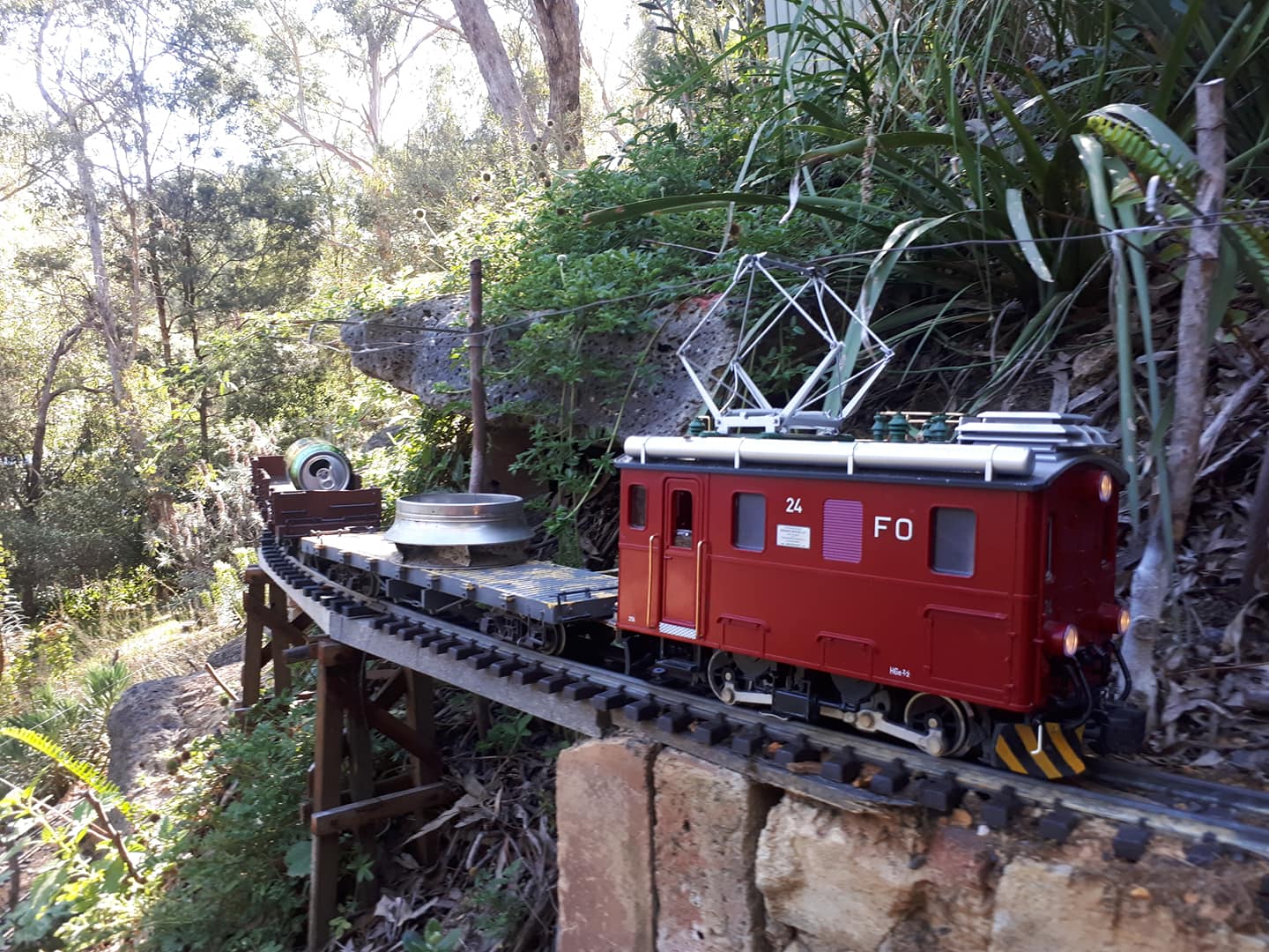

Alexanders tramway runs 32V overhead then uses a rectifier to bring it back to a clean 12v which is then fed into Deltang RC thus with a 12V+ battery and some wire to the trolly pole...

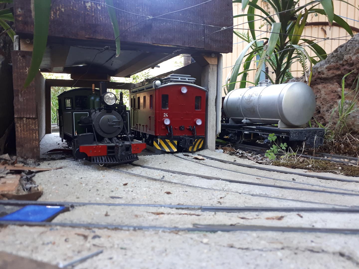

After we finished at home we took Ryan around to see the tramway. Recently returned to service boxcab FO24 is seen here taking a freight down the hill towards grasslands. Departing from Currawong back up the hill. Back in the Depot with the tramways Lyn.

What camera did he use as those shots are brilliant quality.

Fascinating power supply to the tram system.
I always wonder how people who run overhead supply maintain a good contact between the trolley pole/ pantograph and the wires.
I like the nifty little battery electric loco too.

The tramways power supply is certainly different although it seems to work impeccably, people suggested DC but that doesnt come with the cost advantage RC has plus he already had the controllers for runnning his two battery steamers. He hasnt updated it in a while (hes since tripled the length of the line!) but you can read more here https://www.gscalecentral.net/threads/e ... ay.307019/ or on the garden railways Australia group where both of us post far more regularly.

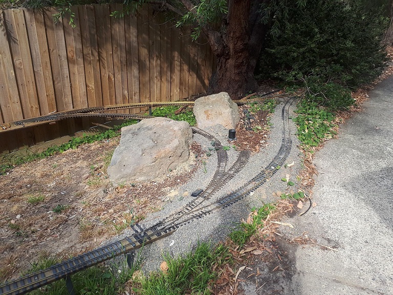

Hi all, not much has been happening here, I've ballasted the entire line, time will see how well that holds up!
Quick shot of the triangle, The new point was given to me by a friend (thanks Dan!) and once I build another set of points hopefully there'll be a two track engine shed although given the current lack of storage sidings it might stay plain for a fair while yet The last new additions to the roster for a long long time, everything else will be made as there's simply nothing else I'm interested in. The Van will recieve an end wall and a repaint to become similar to a Mt lyell railway guards van. The coach will get a trial repaint into VR red and the hideous baggage van is likely to the get the chop in the not too distant future into something slightly more local...

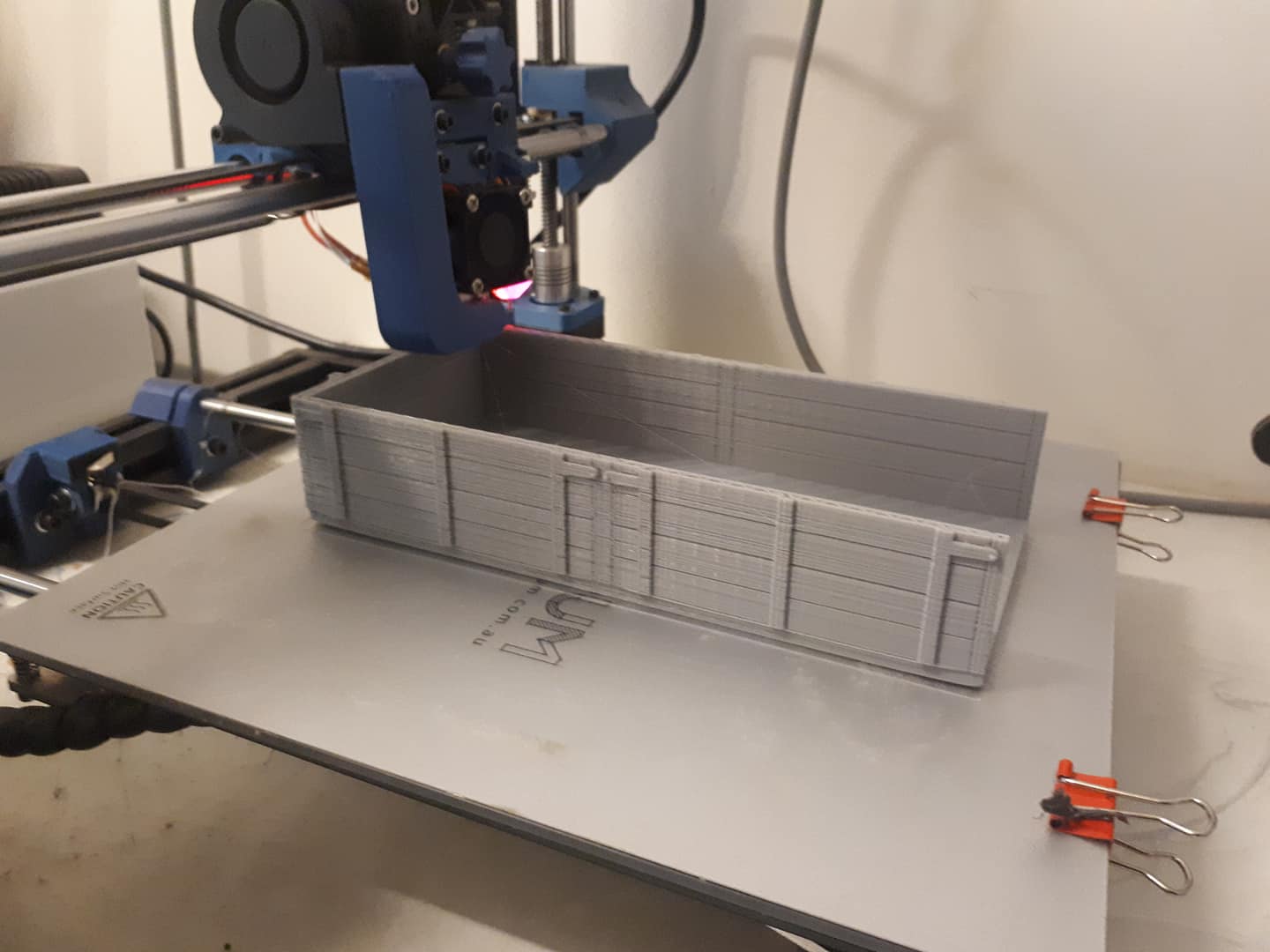

Recently a program has been underway to use some 4 wheel underframes I acquired when i purchased two live steamers off facebook, they dont look particularly fantastic in the photos but outside they look fine. After I built a few I wondered if i could adapt that same body to fit on a number of bogie underframes I had spare heres the test run. They need to be widened slightly in CAD but thats really not a big deal. Till next time

Jake, have you printed those bodies as one piece from the floor up( floor+sides & end x2)?

Cheers guys, Theyre based off a South Australian Yx wagon which i will offer as a 3d printed kit in 1:24 one day. Theres a fair bit of fine detail in the frame though and I want to get that right.
They are indeed printed as one big lot, the 4 wheelers dont have a floor. the end beams locate them in place and the flatcars. The bogie wagons were designed to be functional ore cars so they have big holes in the floor that needed to be covered. If I was ever going to print wagons for anyone else I wouldn"t do it this way. My printer isnt quite feeding right which results in rough prints which many people probably wouldnt find acceptable but theyre fine to me.

Interesting. I always find a difficulty with printing thin double sided vertical items such as wagon sides. Apart from the issue with getting crisp internal corners for overhangs such as strapping, I find that they tend to bow inwards.Tropic Blunder wrote: Sat Feb 09, 2019 10:41 am
They are indeed printed as one big lot, the 4 wheelers dont have a floor. the end beams locate them in place and the flatcars. ........If I was ever going to print wagons for anyone else I wouldn"t do it this way. My printer isnt quite feeding right which results in rough prints which many people probably wouldnt find acceptable but theyre fine to me.
