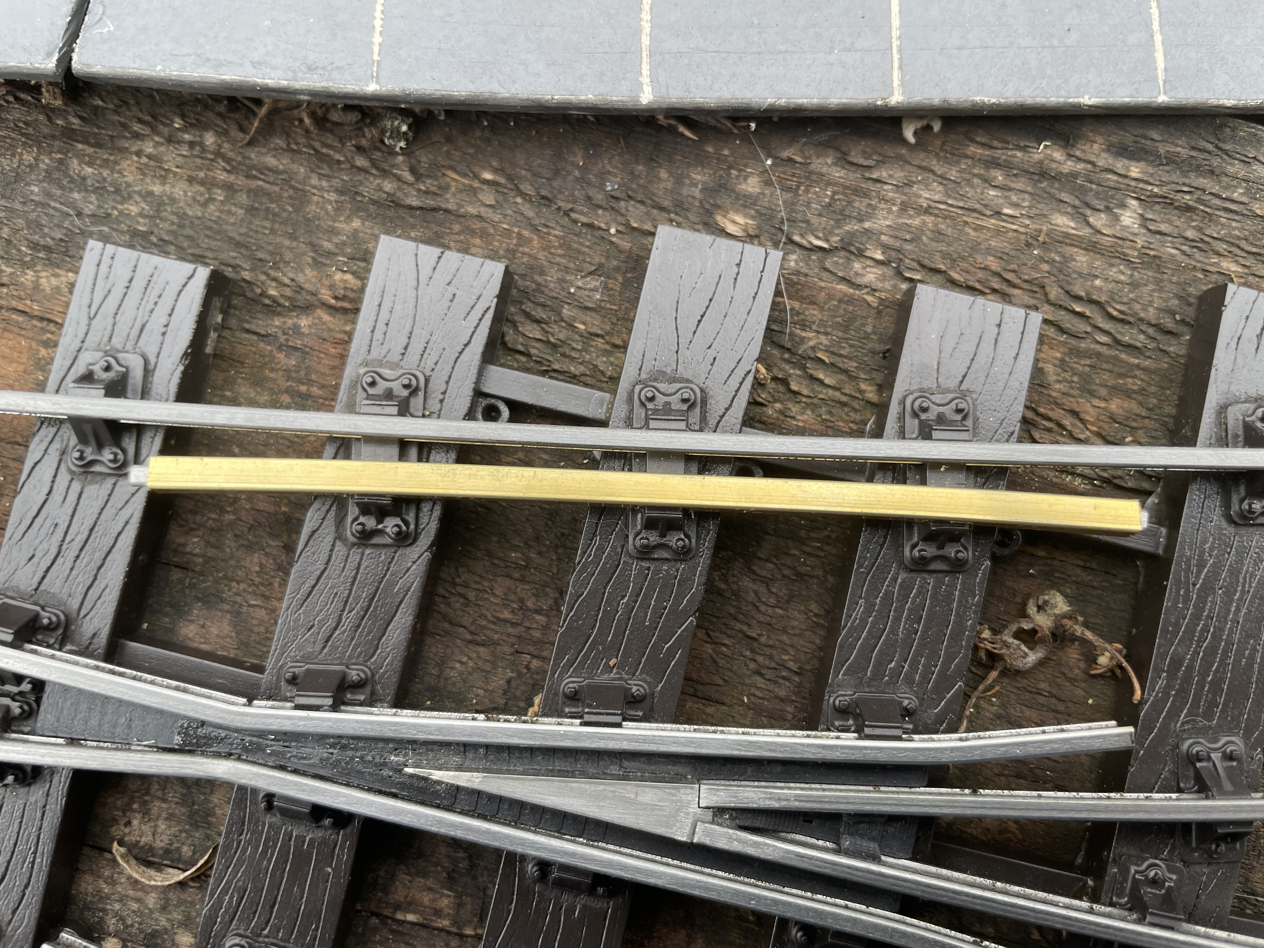

Roger, the friend who had got me the additional one, was having great difficulty with those he had bought, so late last week I visited him to have a look and see whether I could apply the same remedial action I had given mine.
We spent a lot of time with eyes at track level adjusting the tip of the frog Vee but still couldnโt get good running. Eventually we decided that the gap between the check rail opposite the Vee was too large at approximately 3.5mm, later to be confirmed that 2.5mm is recommended. A packing shim along the top edge of the check rail might be a solution. Roger found he had some brass channel of various sizes, one of which was a close fit around the rail profile, so we experimented with a length. Some slots are necessary to allow it to fit over the chairs, but it works.
Today he brought me a length and I have made the modification to my new style point:-
It may not be pretty but it improves running through the point.
A much tidier solution would be if we could persuade the manufacturer to reduce the gap.
There seems to be something different about the geometry of the newly issued point which makes the running inferior to that of the earlier version but we could not see what,

I can't see the rail gap issue being fixed - they'd have to make new moulds..
After a few months' weathering, your solution will blend right in.

Hi Phil,
I'm pretty impressed with Cliff Barkers products. I've made about a dozen turnouts using his components. Although my running has been (very!) limited I've had little trouble apart from a gauge issue at one of the crossing noses. I think it was a 1 in 10 crossing. The crossing had crept over very slightly due to some poor workmanship on my part. A fine shim behind the chair jaw of the nose chair cured it (I've assembled my crossings using chairs chopped and glued to hold the wings and vee in place). Gauge is everything at a crossing and most importantly the check gauge. Even in 12" to the foot scale this can be a problem. Full size issues normally result in excessive wear to the nose rather than derailment - but it's happened! I notice the original photo had a built up vee with separate point and splice rails soldered together (as do mine) but the newer one has a solid, one piece vee. I wonder if that could affect gauging at the nose.
I've just been and checked my turnouts and the flangeway is measuring at 3mm, using Cliffs standard check chairs; the track gauge is set at 32mm. A possible solution would be to allow the track gauge to widen by 1mm to make the check gauge right.
Gauge in turnouts in any scale can be a right faff - be thankful it's not a double slip!

Thanks Andrew,
I accept what you say about the cliff Barker track that you have used and points you have made.
I prefer the original style as, as you say, the crossing Vee is made by soldering two pieces of rail together and that end of the structure is more rigid than in the new version. Then rail profile is more prototypical than in the Peco track. I think the Peco points are more rugged. There is a price difference when buying, which may be a significant factor. Pros and cons.

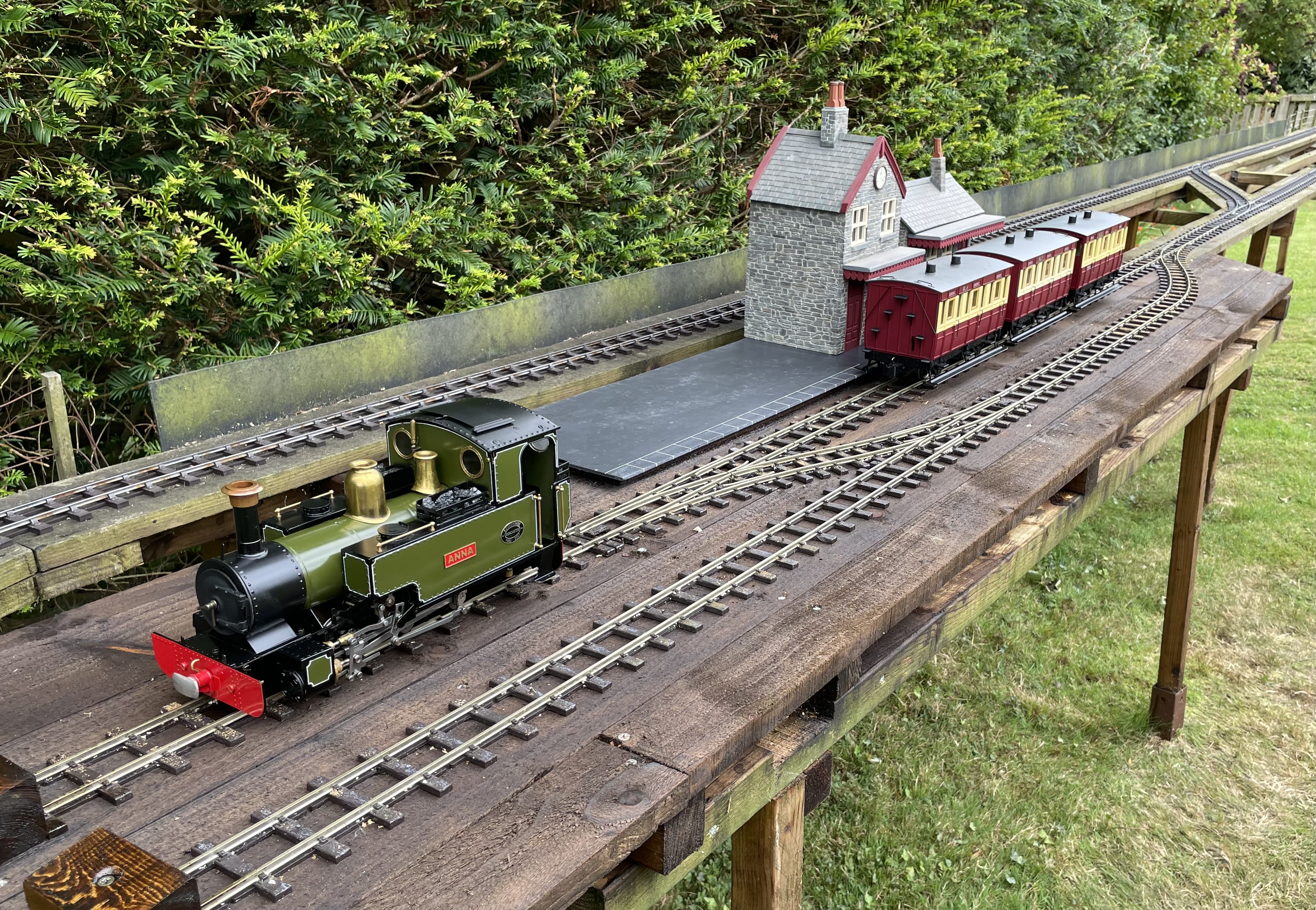

Yr Orsaf Newydd Mk2 is nearly finished. There is now plenty of room to run round three Isle of man coaches:-

- Posts: 8037
A great addition to the line, Phil.
- Posts: 1196
Very tidy solution to differing rail profiles! I never thought of soldering - but then again, half of my rail is aluminium..
And the station yard is really shaping up. Love the shade of green on "Anna".
