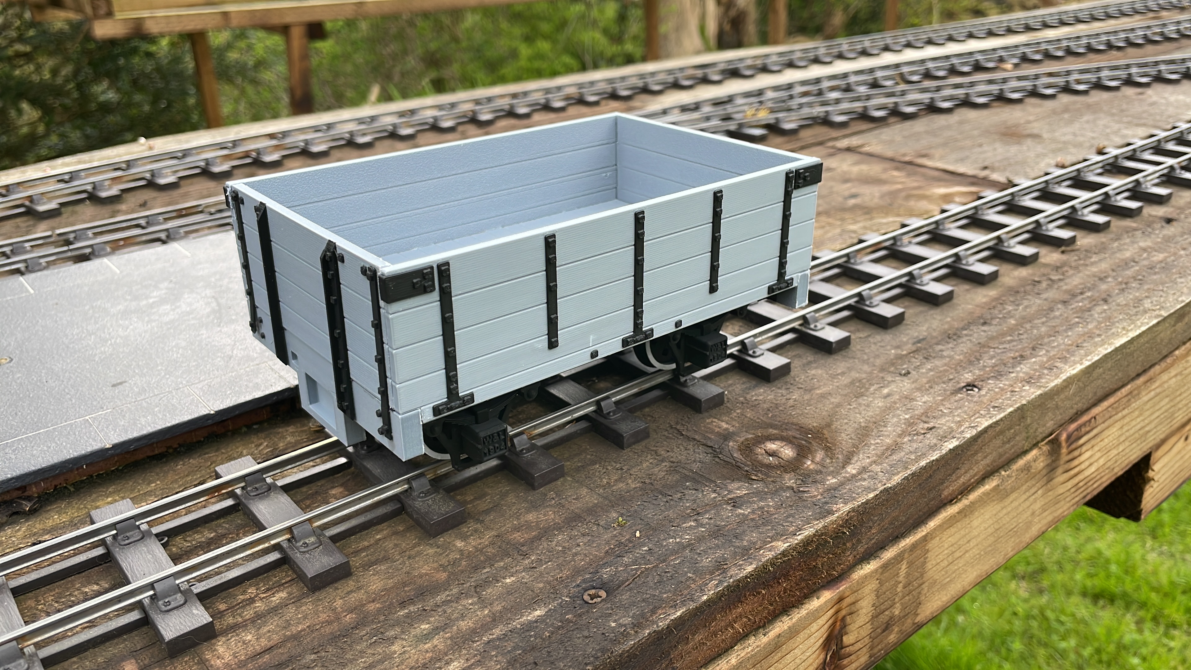

A couple of sessions working on the Woodleigh Engineering 3D printed WLLR open kit I bought last Saturday at the Stoneleigh show have got this far:-
The camera picks out little bits of 3D print 'fluff' quite cruelly.

- Posts: 6069
That's impressive Phil.
Don't worry about it, my laptop must hide them again 'cos I can't see anything?gilfachphil wrote: Thu Apr 17, 2025 5:15 pm
gilfachphil
- Posts: 455
Thanks Phil,
Because the wagon is not going to be painted, anywhere a little bit of abrasive action has been used to remove tiny edges leaves a lighter colour and different texture. Still there’s no way I could paint the ironwork as neatly as the printing process does!
It’s an interesting kit to build. A little trimming of the tabs and holes they fit into is needed as the printing process can leave tiny rims. The axle box pieces have three tabs that slide into holes in the sole bars and fit so tightly that they don’t need glue to hold them.
I think Joe, who makes them, will be at the Llanfair show in August. Fingers crossed he may have more goodies for us,

- Posts: 8037
Brake lever in front of rather than behind the drop down door bracket thingy??gilfachphil wrote: Fri Apr 18, 2025 5:35 pm The eagle eyed may spot an error where I should have read the instructions more carefully, it has now been corrected but not photographed.
Edit : Oops, now I look more closely it is behind the bracket
PS Brake lever not in its 'off' position??
gilfachphil
- Posts: 455
Rik,
that is not what I have corrected. I expected the brake lever to go higher into the off position but the four iron hangers are all the same and will not allow it to go higher as far as I can tell,

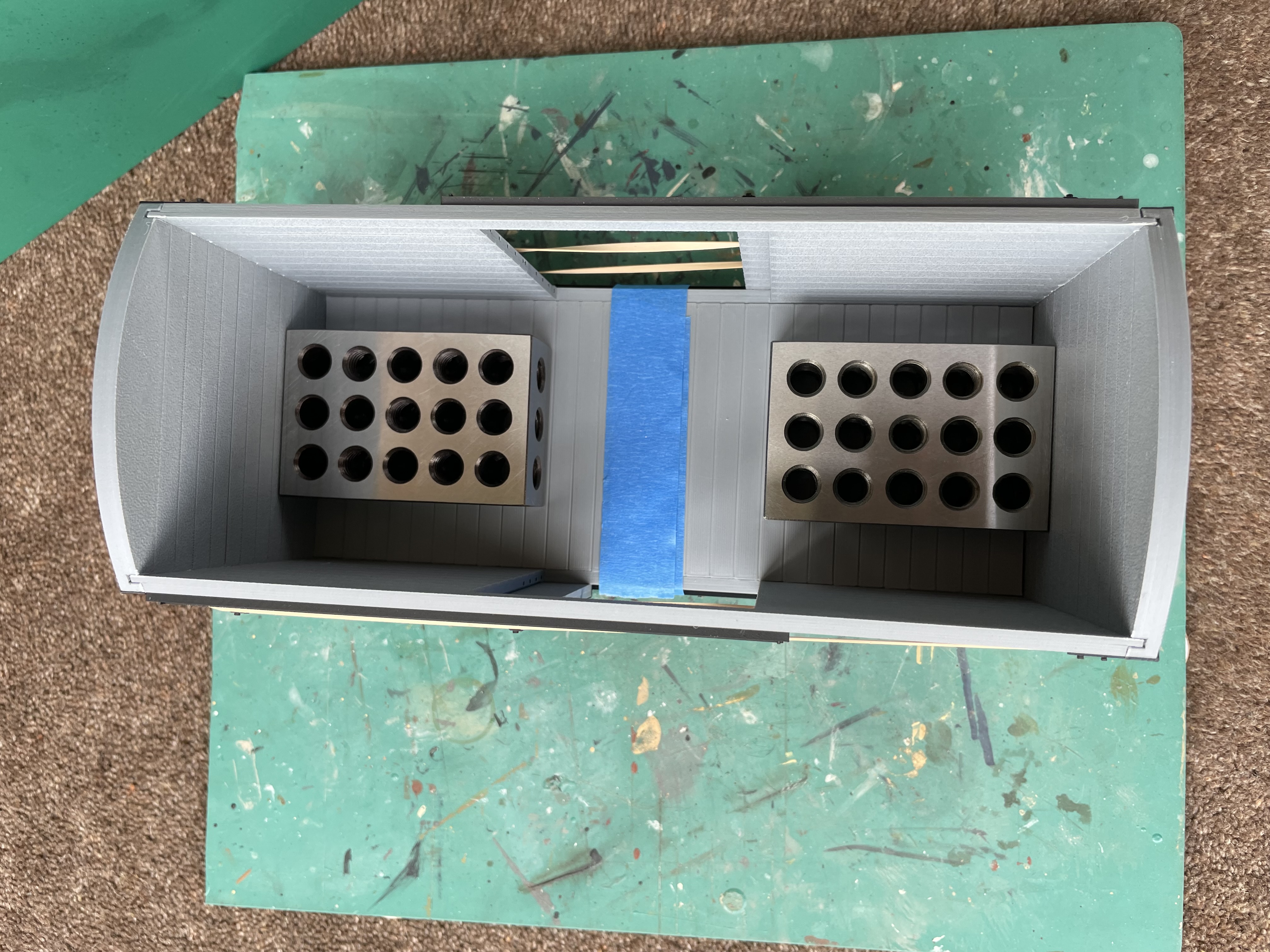

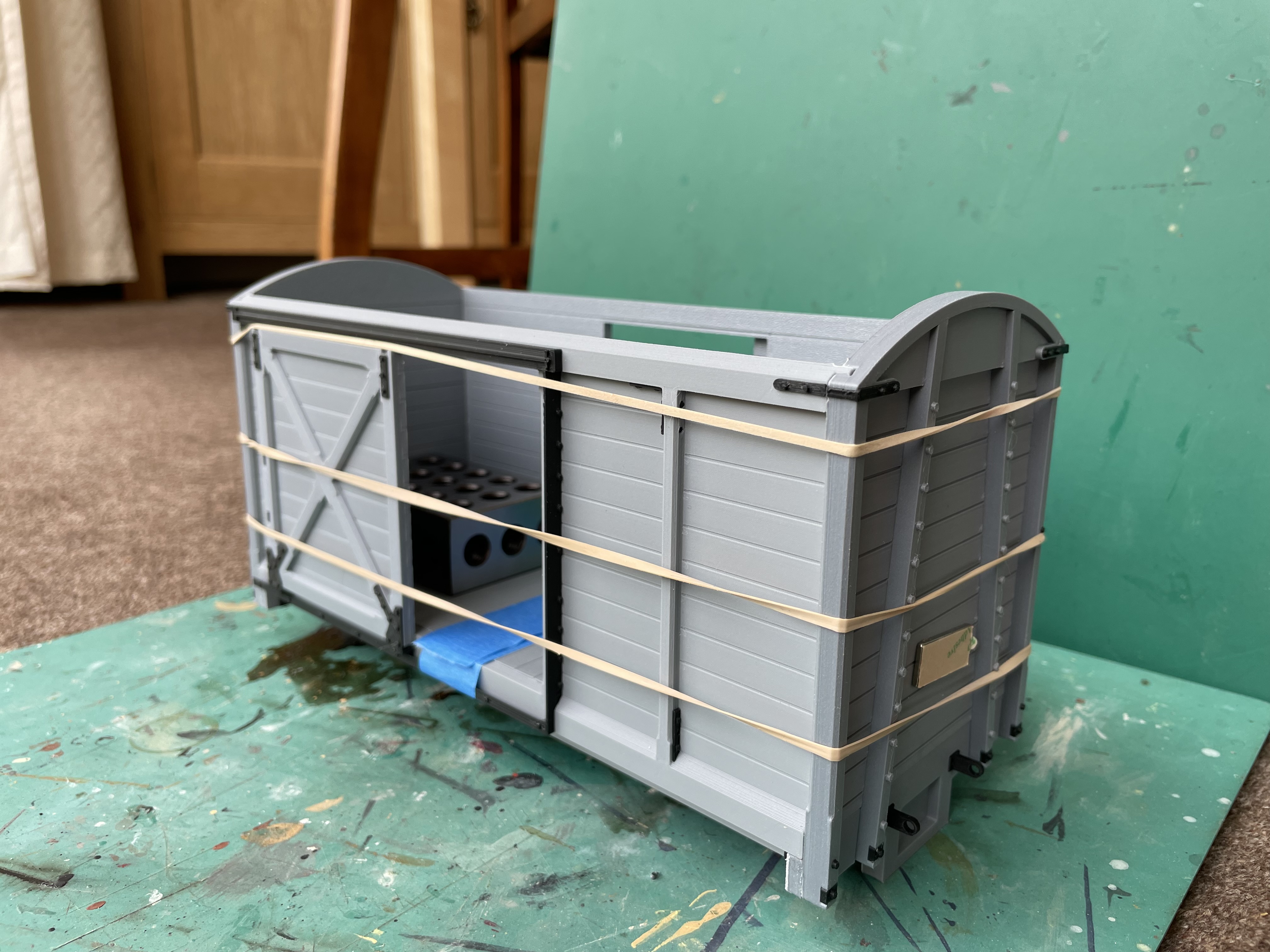

Straight on with the WLLR box van.
It's quicker building a second kit from a trader as you have worked out the methodology and a few wrinkles to make things simpler.
Ready for major gluing:-
Having made up the chassis yesterday, I prepared the side and ends today, here they are shown with rubber bands holding the corners tightly together, the blue masking tape holds the door cills against the floor. At the end can be seen a magnet which is holding to a 1-2-3 block keeping the end square. I've added the hook chain hangers at the end to the buffer beam before doing anything else with it, this is something I found difficult to do once the open wagon was assembled and had the buffer in place
The view from above:-

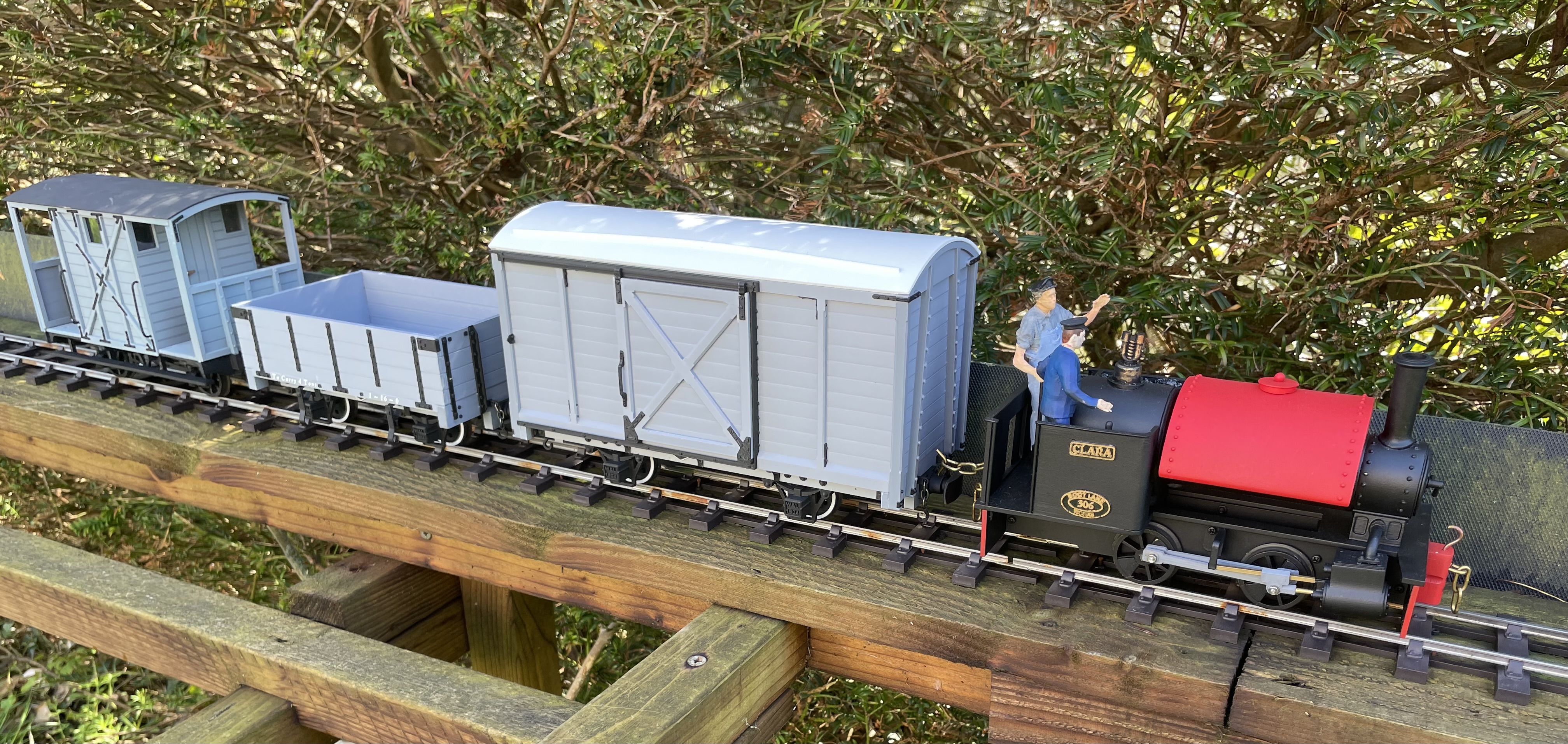

gilfachphil
- Posts: 455
and here are the two (almost) finished wagons with a 16Mills brake van behind Clara this afternoon.
The box van needs transfers, doing those on the open was enough scary stuff for one go, and the rain covers over the doorways.

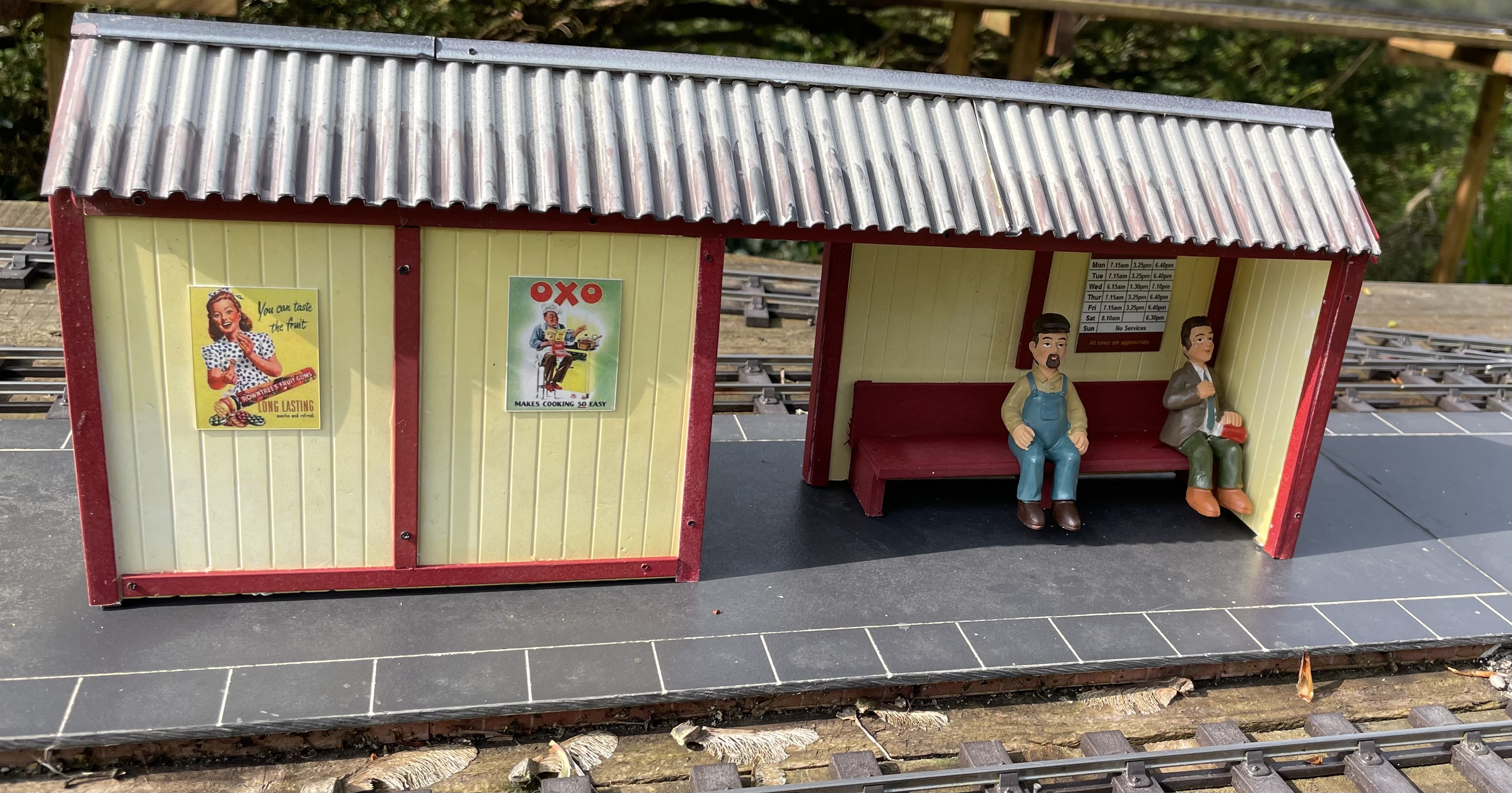

gilfachphil
- Posts: 455

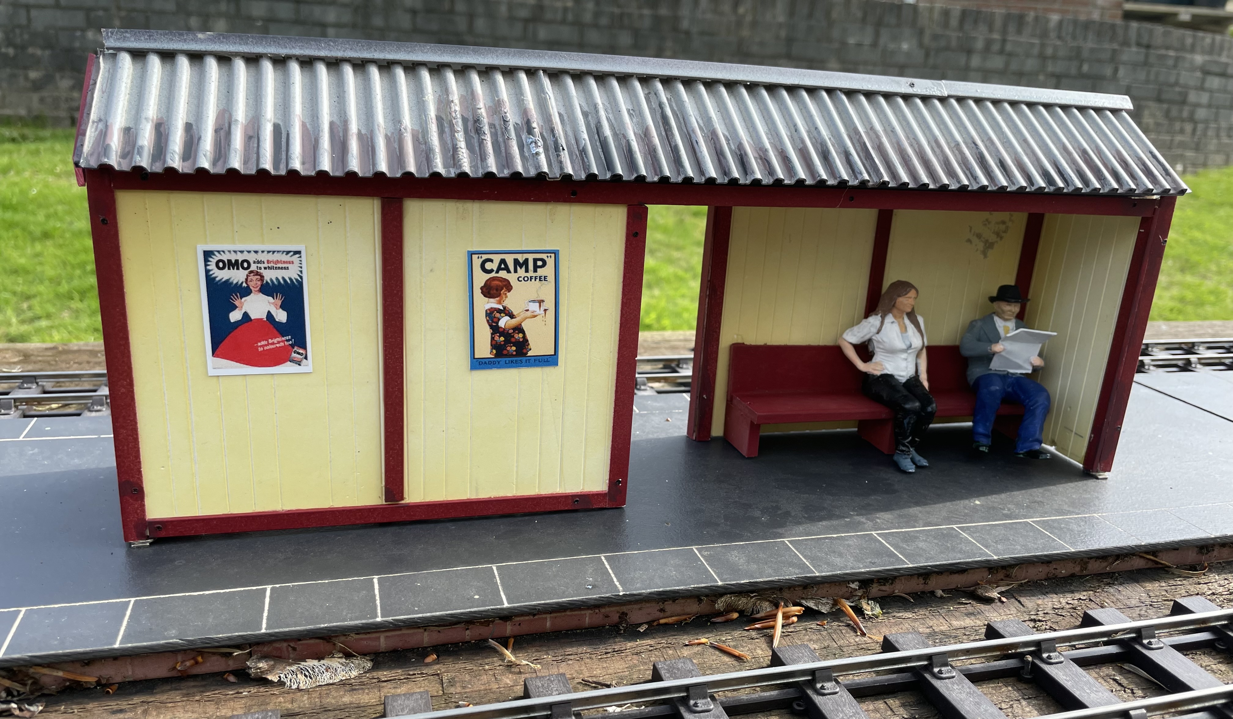

Some 16 months after being given the station building I have finally got around to adding some figures. The gent reading the paper and the lady were painted by a friend who enjoys figure painting. The two gents in the other side are bought figures that will also appear on some fellow members' railways.

- Posts: 8037
Very tasty......gilfachphil wrote: Fri Apr 25, 2025 4:00 pm Some 16 months after being given the station building I have finally got around to adding some figures. The gent reading the paper and the lady were painted by a friend who enjoys figure painting. The two gents in the other side are bought figures that will also appear on some fellow members' railways.
Looks great Phil. Surprising what a couple of extras can bring together a build.
- Posts: 1196
Looks good!
Is it to live outside permanently?
gilfachphil
- Posts: 455
No Aaron,
it’s placed in position when the railway is open for traffic. I doubt it is weatherproof and anyway is quite light and easily moved by the wind.
It is very special to me as a friend made it as a Christmas gift following a visit so has to be cared for,

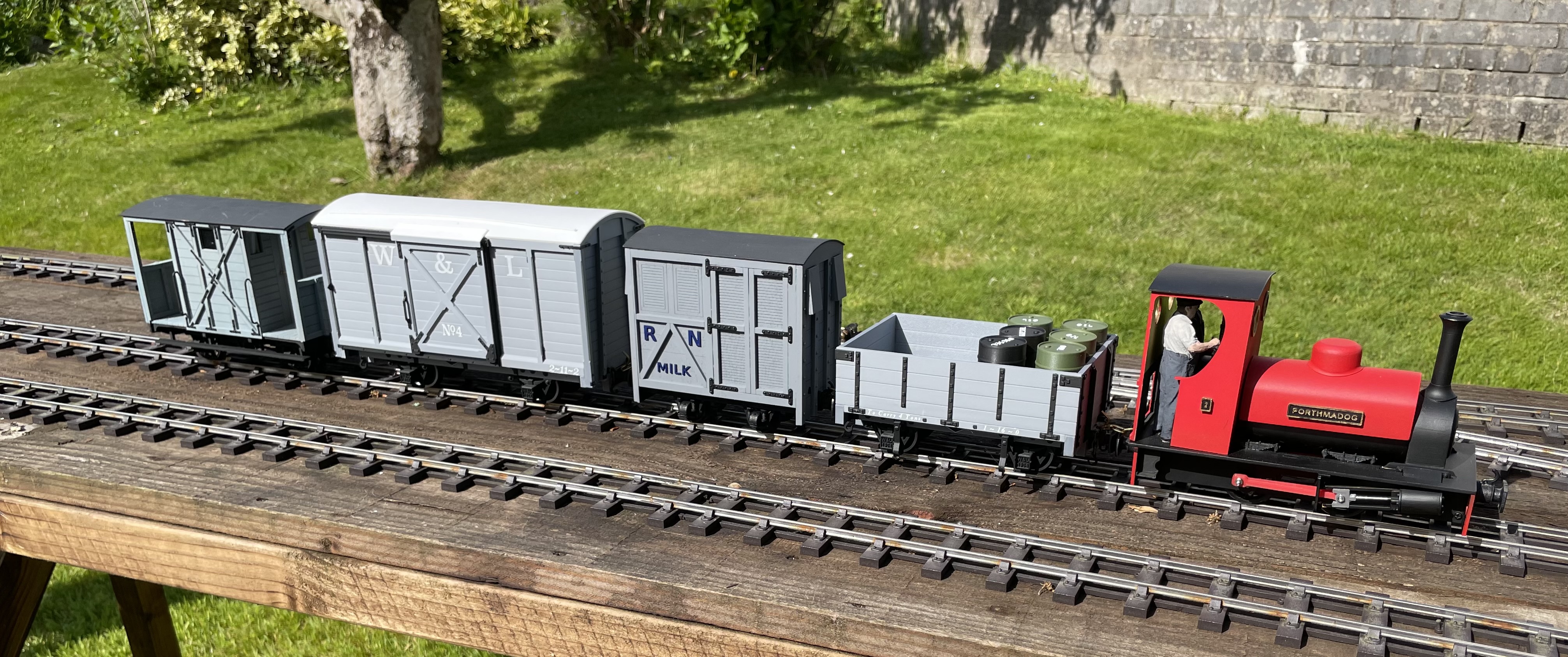

gilfachphil
- Posts: 455
The WLLR box van had its transfers and rain covers fitted. It and the open then had a coat of matt sealant which is recommended for the 3D printed plastic for protection from UV. I also did the barrels I got from Woodleigh. A short running session this afternoon behind Porthmadog allowed a photo:-
