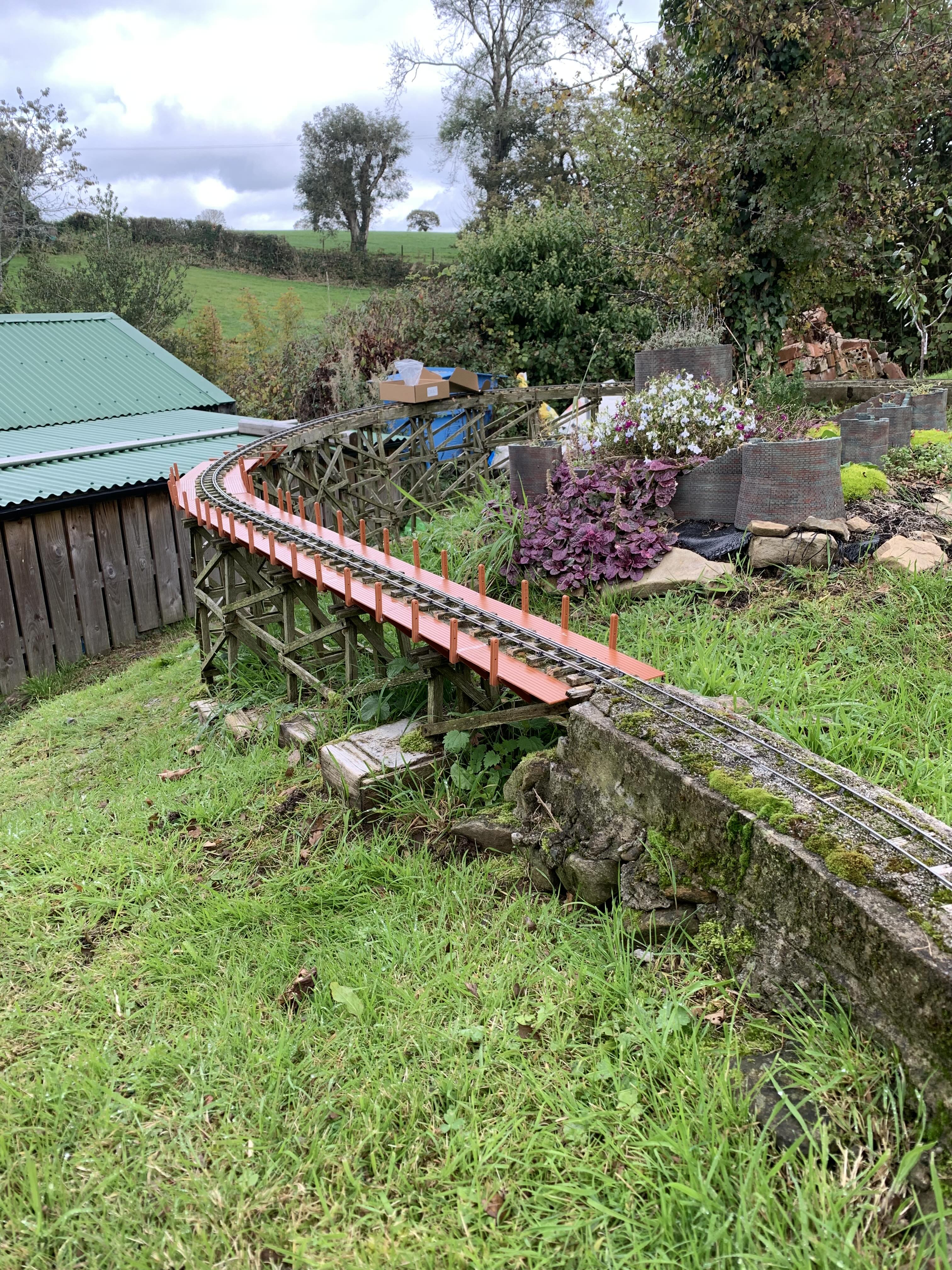

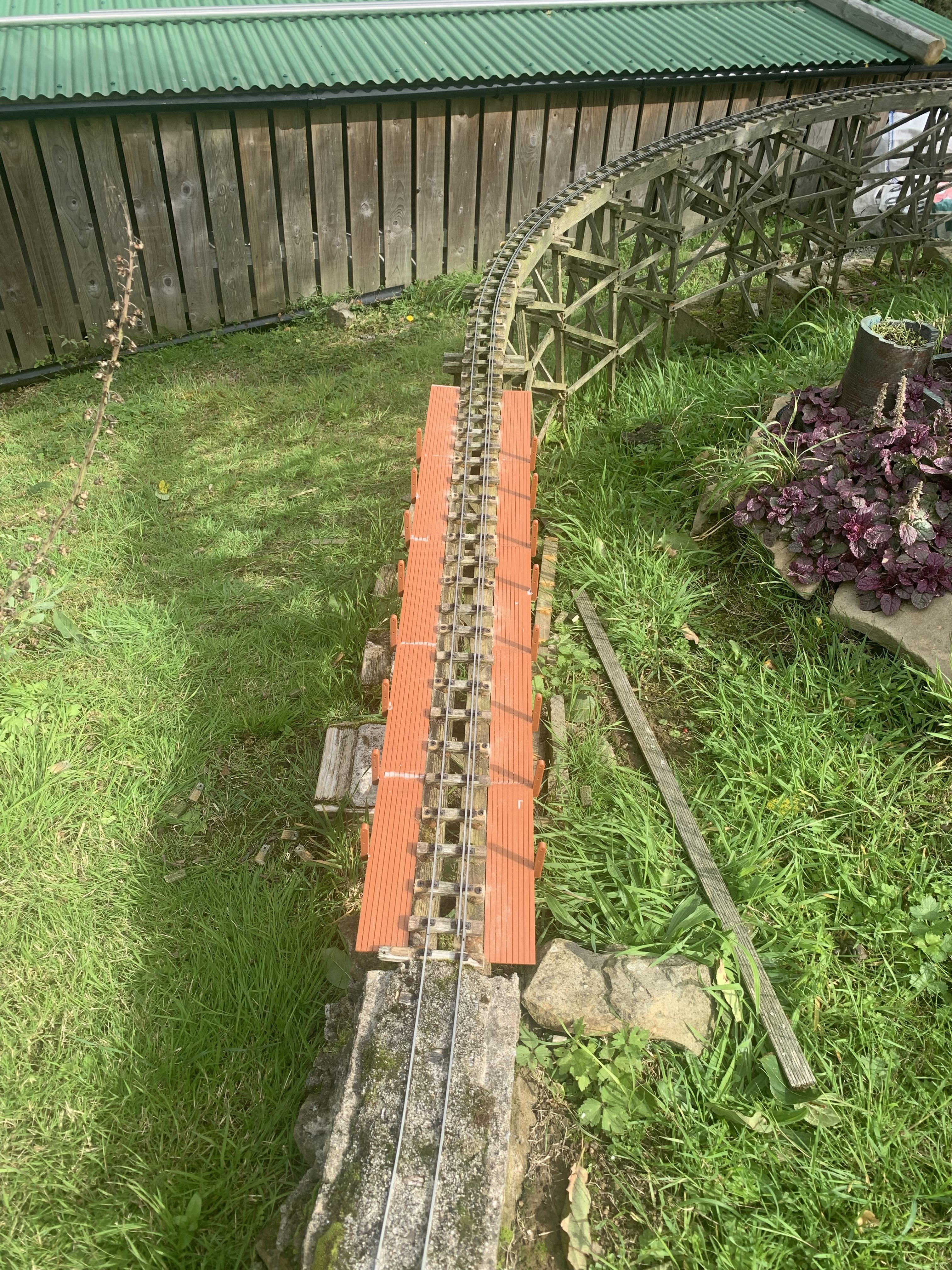

After a distracted summer I am now thinking about the railway again - pity the weather has turned prematurely!
One of the unfinished areas has always been the viaduct. The glue I used to build it (how many years ago? 4 years?) started giving up some time ago and I have been re-gluing bits back together as they fall apart. So to start with I replaced all of the glued joints with black stainless woodscrews.
More than one friend running here has felt the need for railings to protect valuable trains from the long drop. I had stopped fitting them when I realised the ends of my bogie coaches would have hit the railings. So since the walkways I had already fitted had almost all fallen off I thought it was time for a different solution.

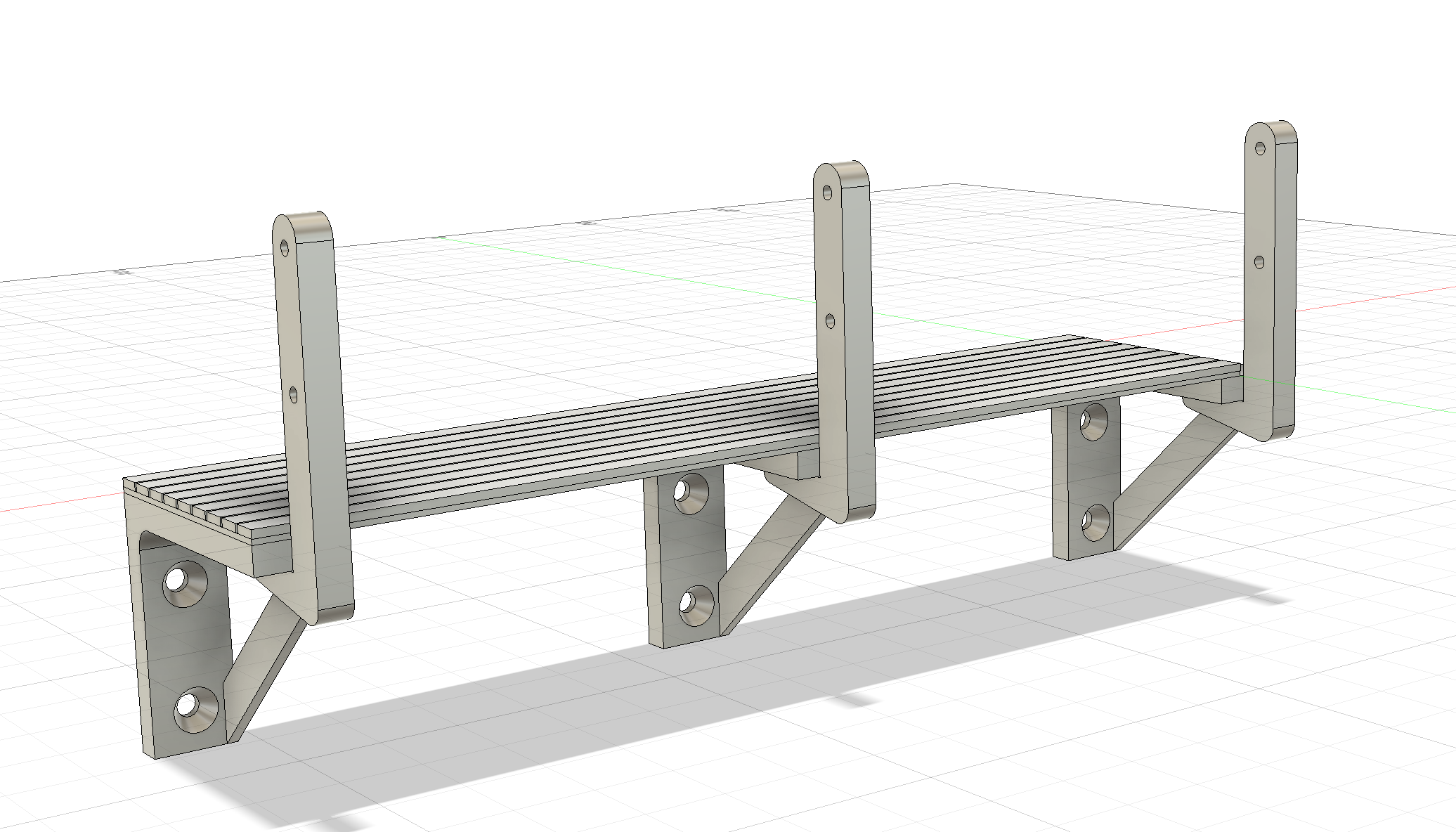

As you will know 3 D printing solves many of my problems, so I wondered if it could solve this one as well. The design for a printable railing( I really do like Fusion 360):
It is in three separate parts, brackets to support the walkway, the walkway, and handrail posts. The first sections are printed. The brackets - which are screwed into the sides of the main beams, and the walkway first. The walkway is twice as wide as the previous one (so I hope my coaches will clear it - but I can work that out as I go along). The first section of the viaduct is straight - and that seemed a good place to start. It will take a while to print and fit, and as I get to the curved sections I will have to make each section to fit each place, but it looks OK so far. The handrail posts are still printing. Photos shortly.

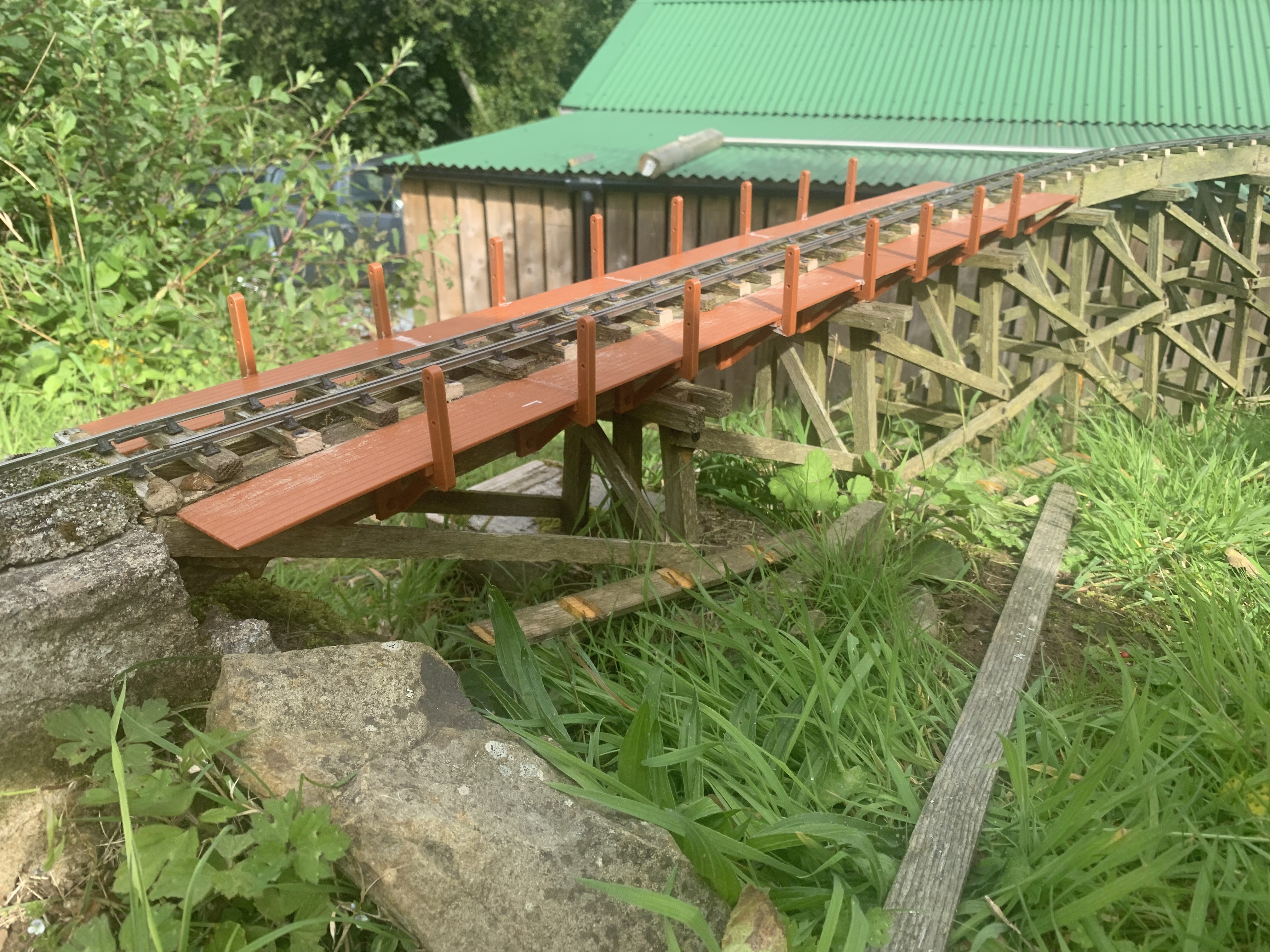

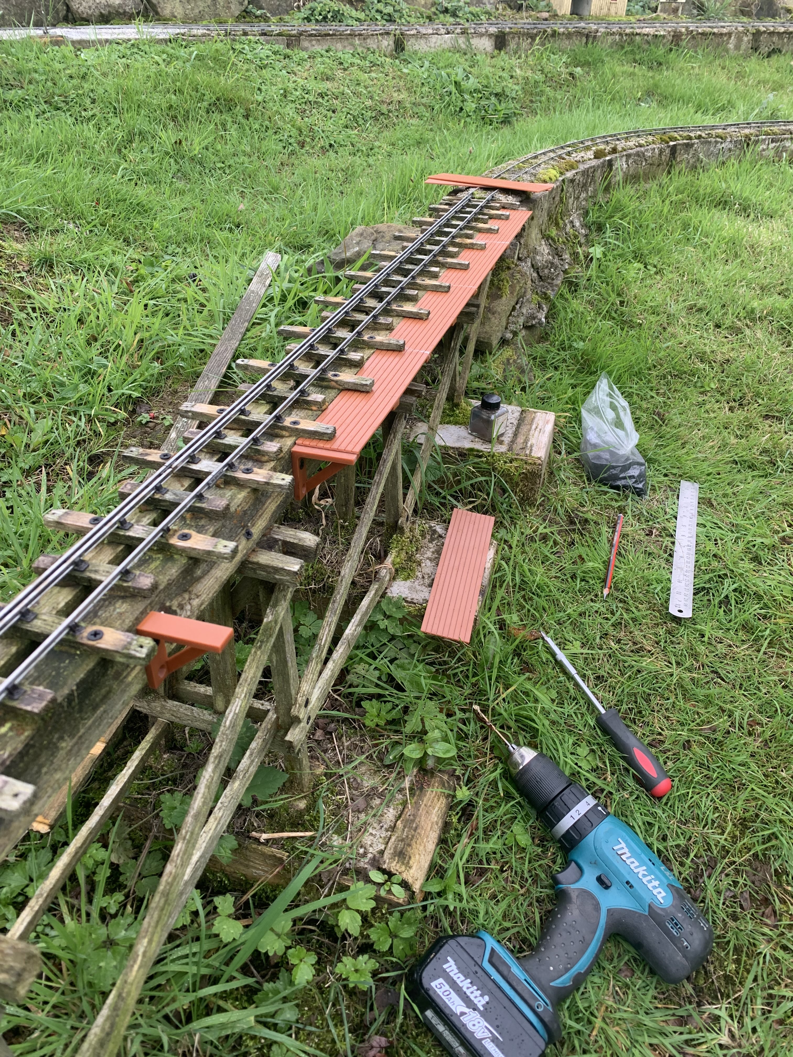

Another section in place:
and the first handrail posts are in place. From now on it's curved, so I will be measuring and making planks for each individual section.
The ends where it fixes to the concrete are yet to be tackled - but I think some printed triangular piece to clamp the ends of the wires to be secured to the concrete with a screw. I'm thinking of using 1.5mm brass wires, to string the handrails.

Its coming on nicely Trevor.Trevor Thompson wrote: Mon Sep 15, 2025 12:39 pm I'm thinking of using 1.5mm brass wires, to string the handrails.
Nothing wrong with using brass for the handrails of course, but for the amount you'd need it will be pricey.
When I did my lineside fencing I used braided 100lb breaking strain nylon fishing line.
viewtopic.php?p=146975&hilit=fence#p146975
It's nominally 0.55mm diameter In appearance it looks rather like galvanised fencing wire. Just under 10 quid on fleabay for 100M, which will last forever! (https://www.ebay.co.uk/itm/387733139709 ... 4968455890)
Just an alternative thought.
- Posts: 1208
- Location: South West Wales
That is a good idea!
I have looked at your fencing and I can see that it would look much better than brass. Of course I haven't yet priced the brass - but was intending to buy a coil from a jewellery manufacturing supplier (which is a cheaper way to buy it if you can straighten it from the coil).
So fishing line it is.

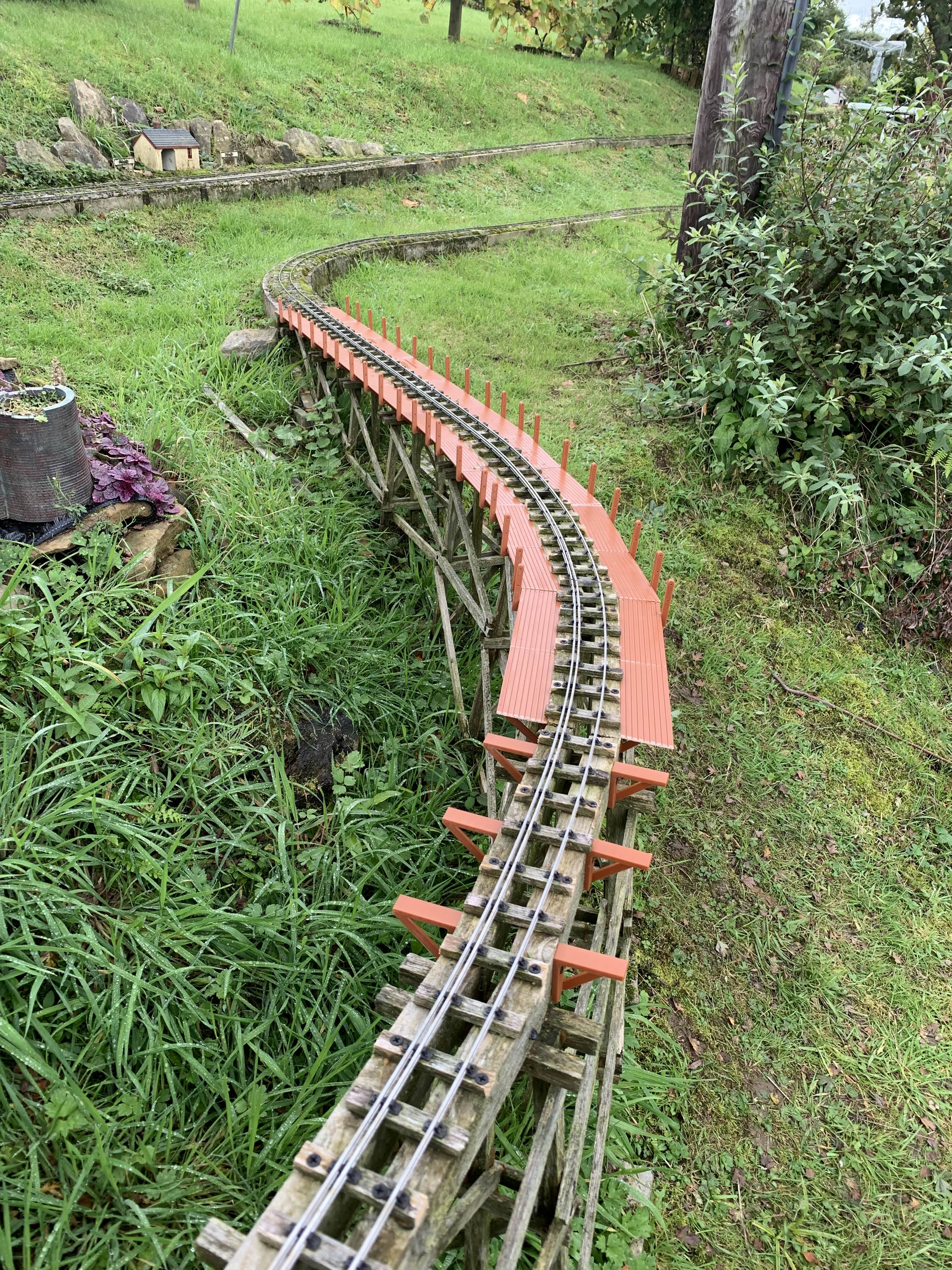

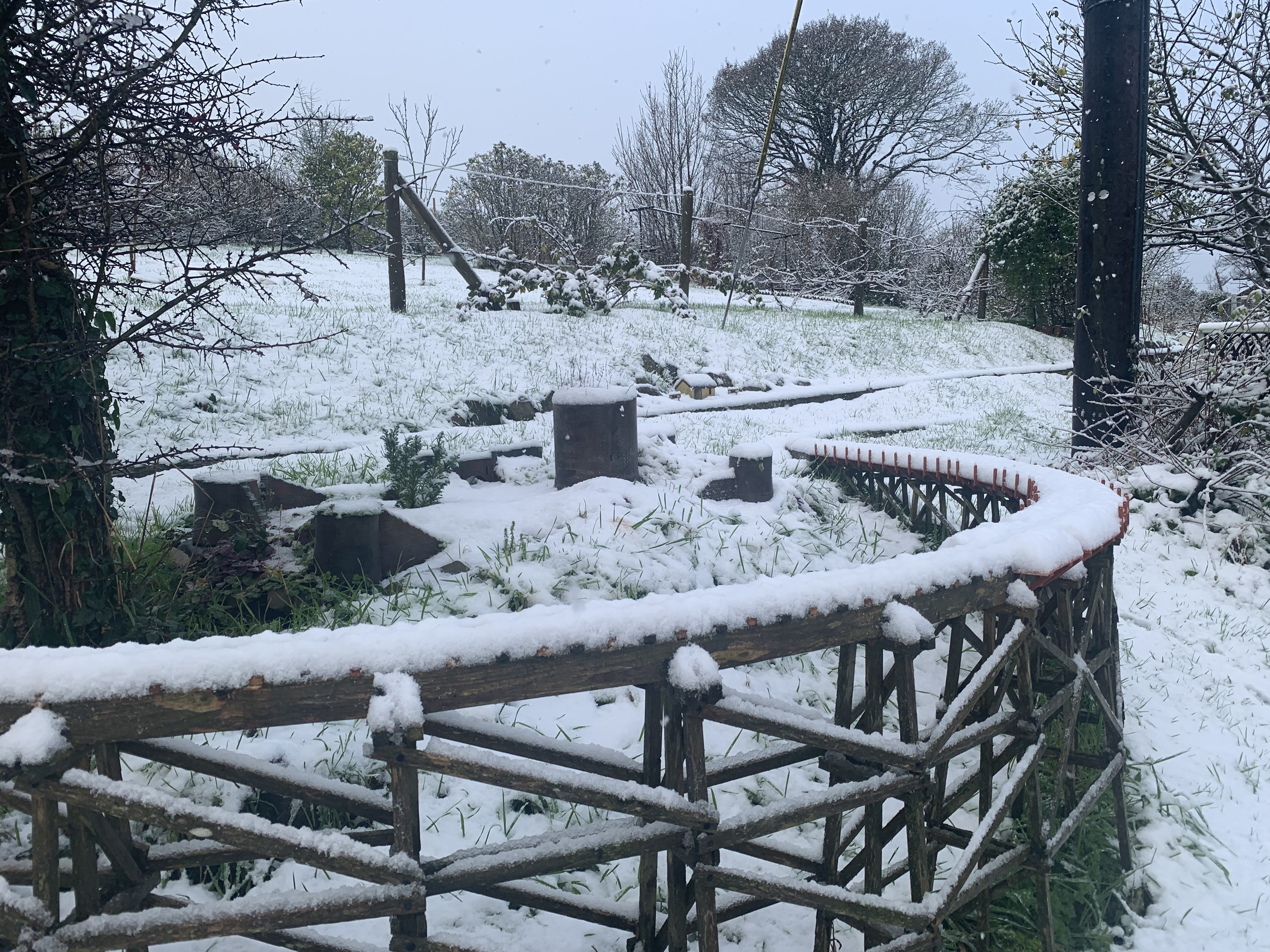

More progress on the viaduct handrails.
I am into the curved section now:
The brackets are going on OK - although I have found that they go on more accurately if I don't pre drill the holes. The sections of decking are all odd lengths and have angled edges. I was going to print each one accurately to size, but I am actually using the first ones I made (for the straight section) and just cutting them to size as I go. I am finding that the easy and accurate way to cut them is on my guillotine - but that does mean marking them and taking them to the other end of the garden for cutting.
Almost half way now.
I think I will paint the plastic when I have finished (before fitting the wires) - it looks a bit "plastic" and artificial as it is.

Yep, I'm with Phil, it does look good. I love the way the lines of posts march off into the distance.
I think you are absolutely right about painting them though. I've assumed from the start that you would.

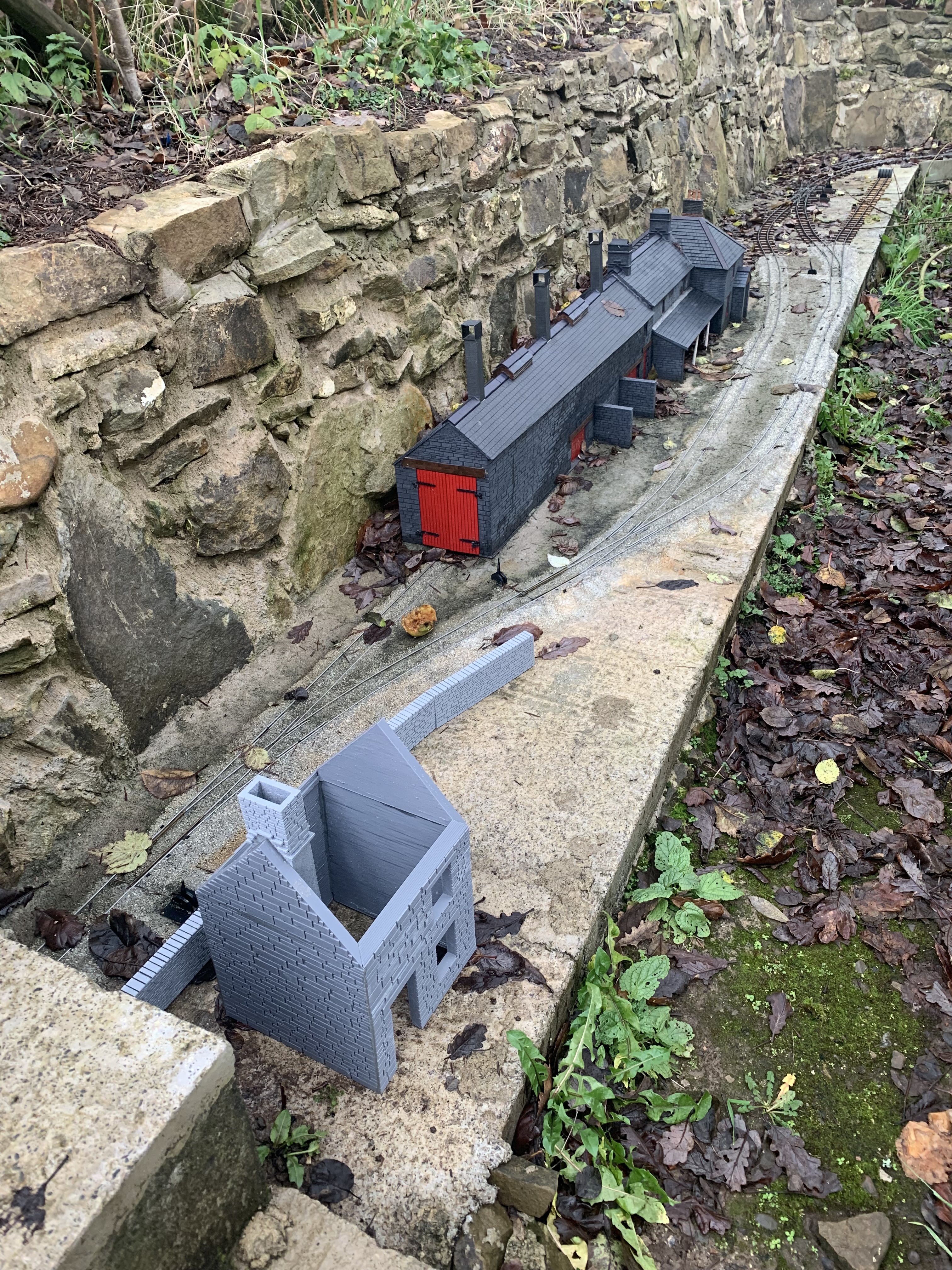

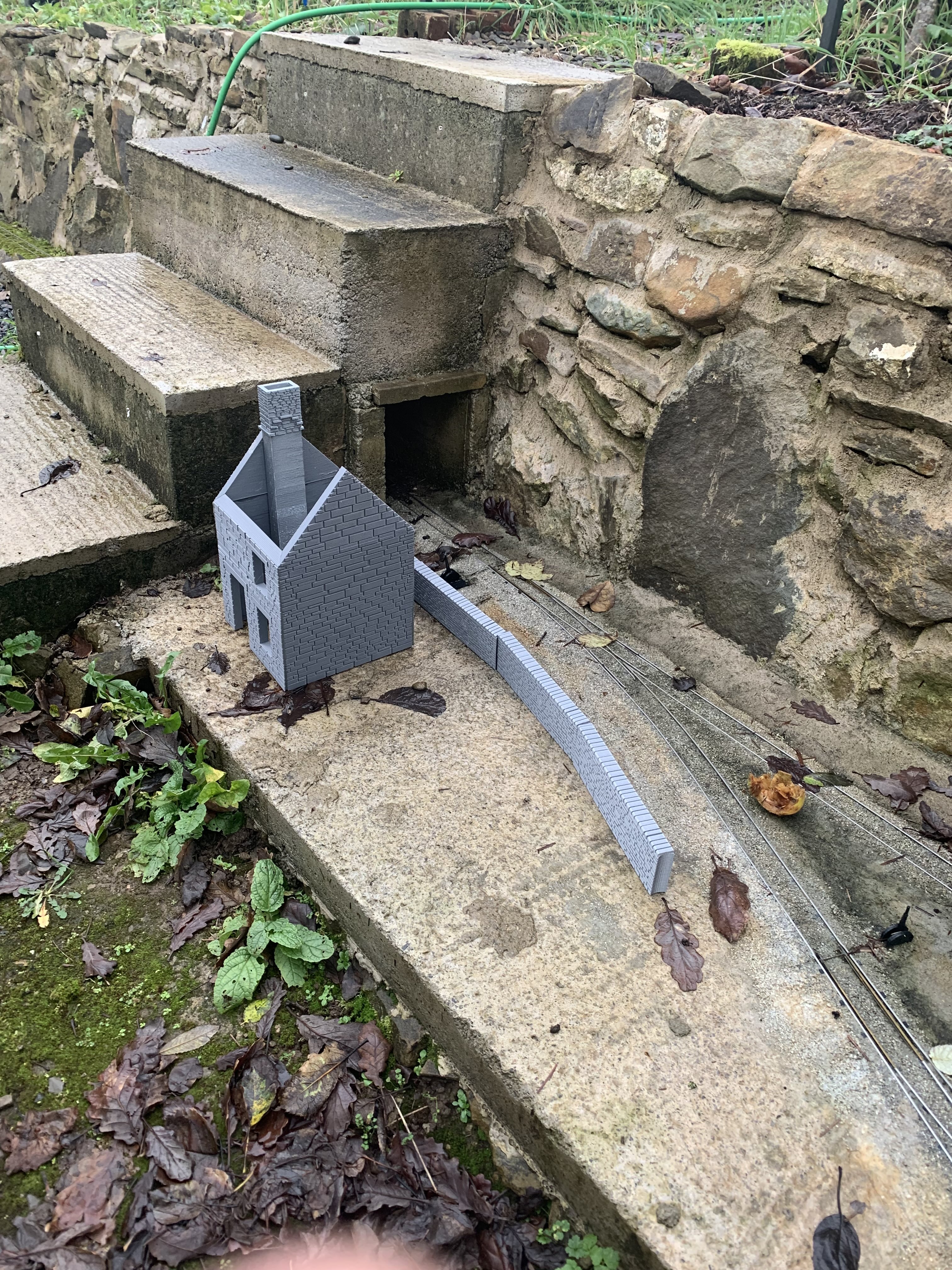

The first buildings to finish off the terminus at Dinas will be cottages under construction, along with the walls separating them from the railway:
The scaffolding and roof beams are being printed, along with another cottage where the walls are only a few feet tall.

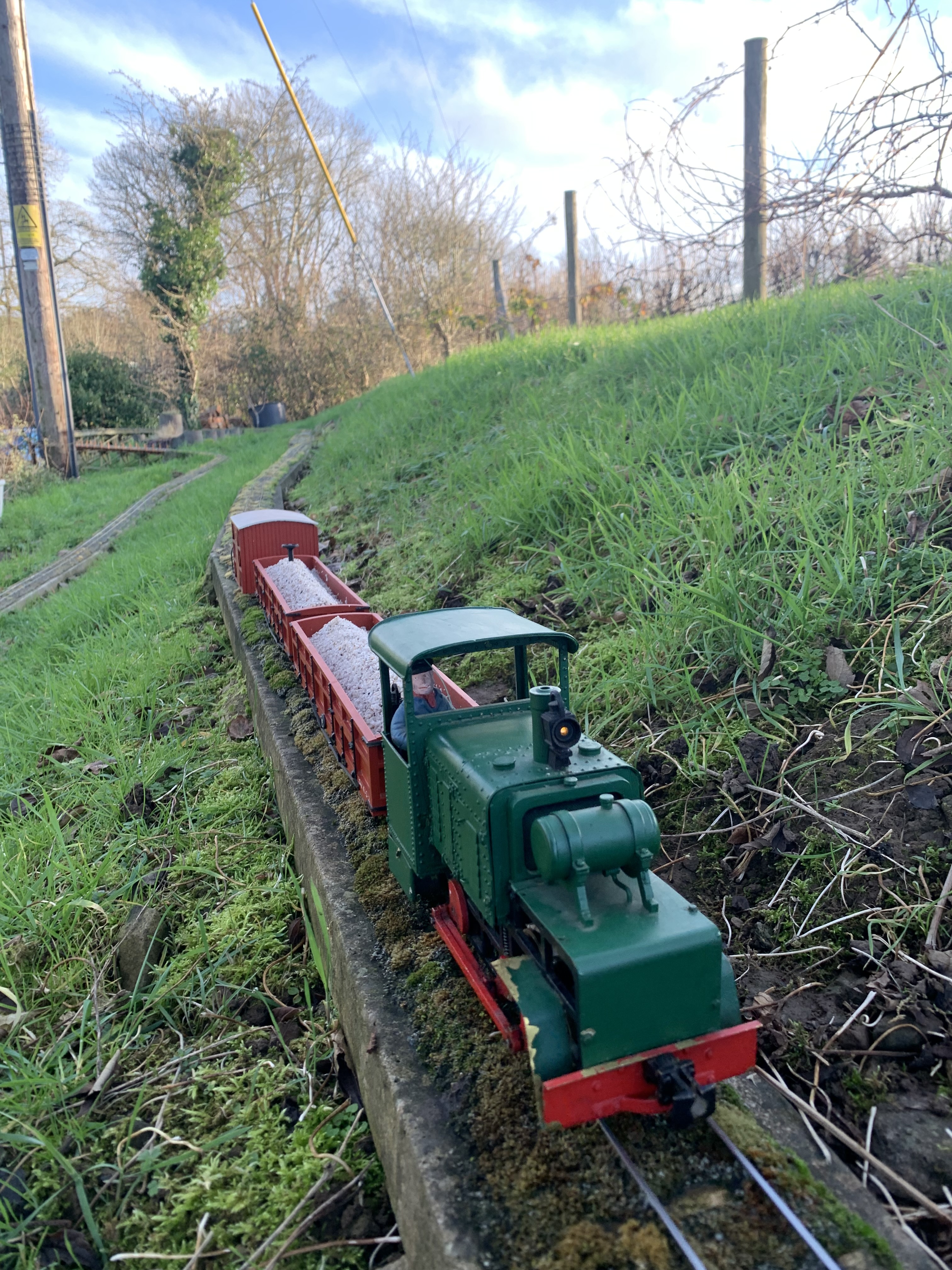

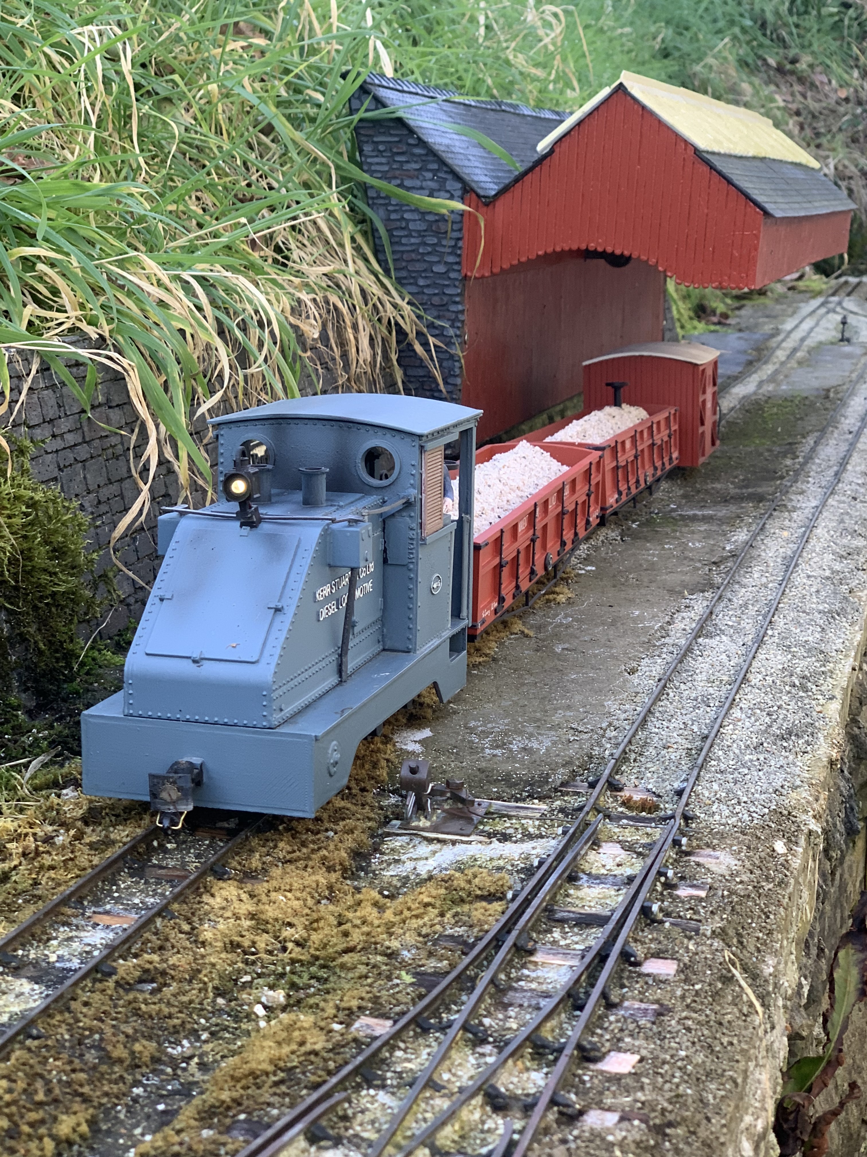

Boxing Day Steamup.
Phil and I started off with the Kerr Stewart sisters ( or should it be brothers) 4415 and 4420. We sent 4415 off up the line with a works train consisting of the bogie ballast trucks, and a brake van while 4420 got steam up.
We soon worked out that the batteries in 4415 were flat. So I went off to fetch Moelwyn - to see if she had enough charge. Moelwyn took the train and set off up the line.
Meanwhile we got 4420 going and sent her off to catch Moelwyn up, with a view of giving her the train to pull.

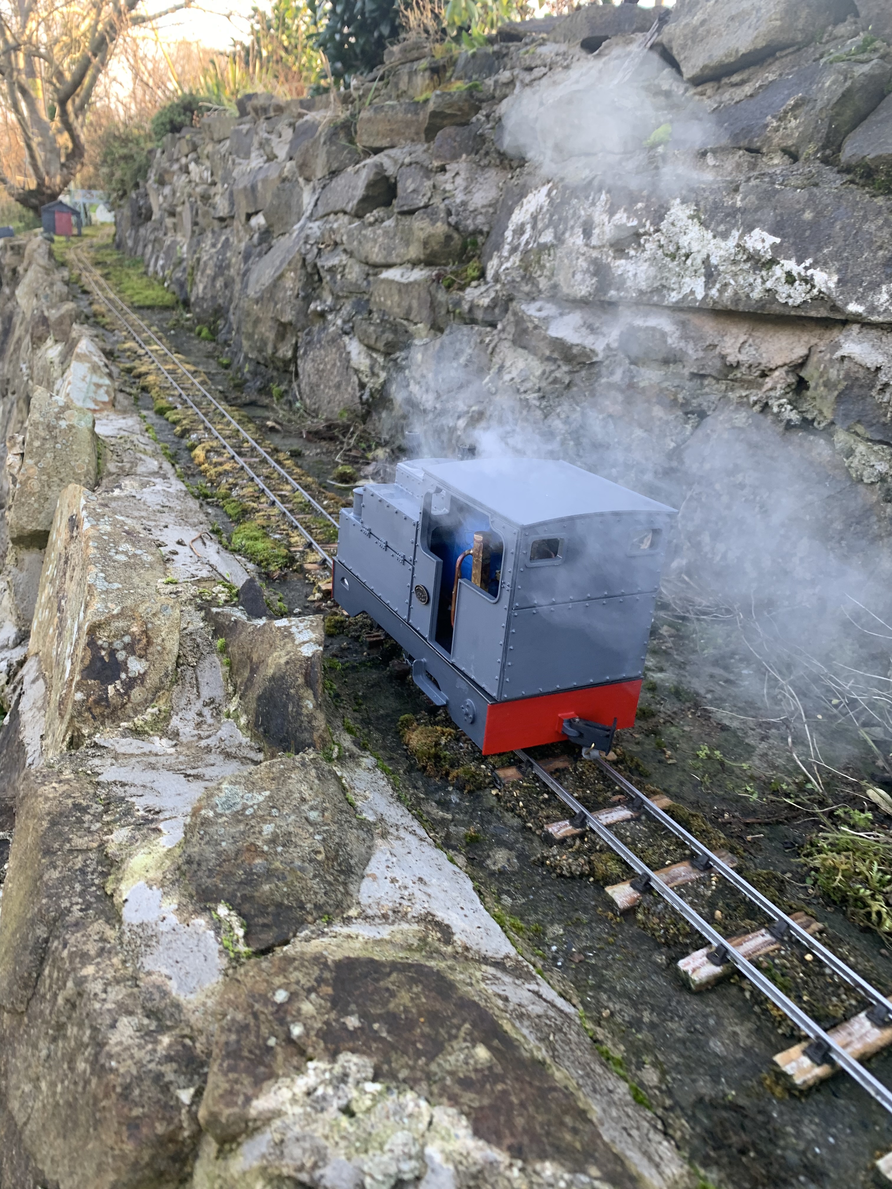

Unfortunately we had both forgotten that the temperature was only 1 degree celsius, and we were running on Butane. The inevitable happened and she ran out of steam at "Tan-y-Bwlch", when the gas stopped evaporating.
So Moelwyn took the train all the way to "Dinas" ran round and brought it back to the lower terminus.
By that time we were pretty chilled - and we went into the warmth of the kitchen and enjoyed Coffee and Christmas cake by the Rayburn.
