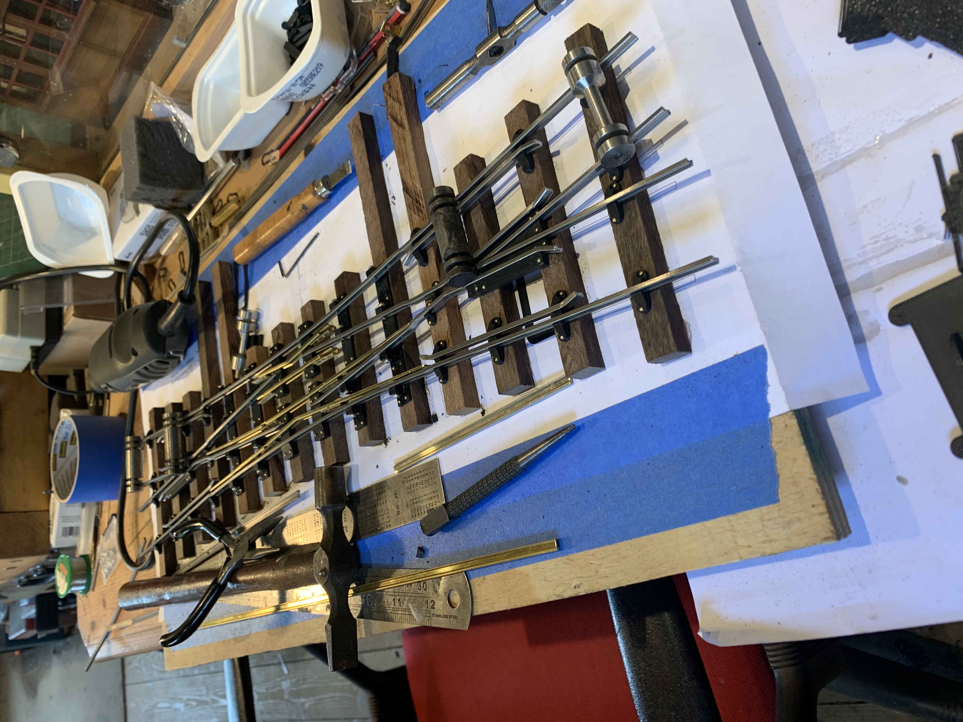

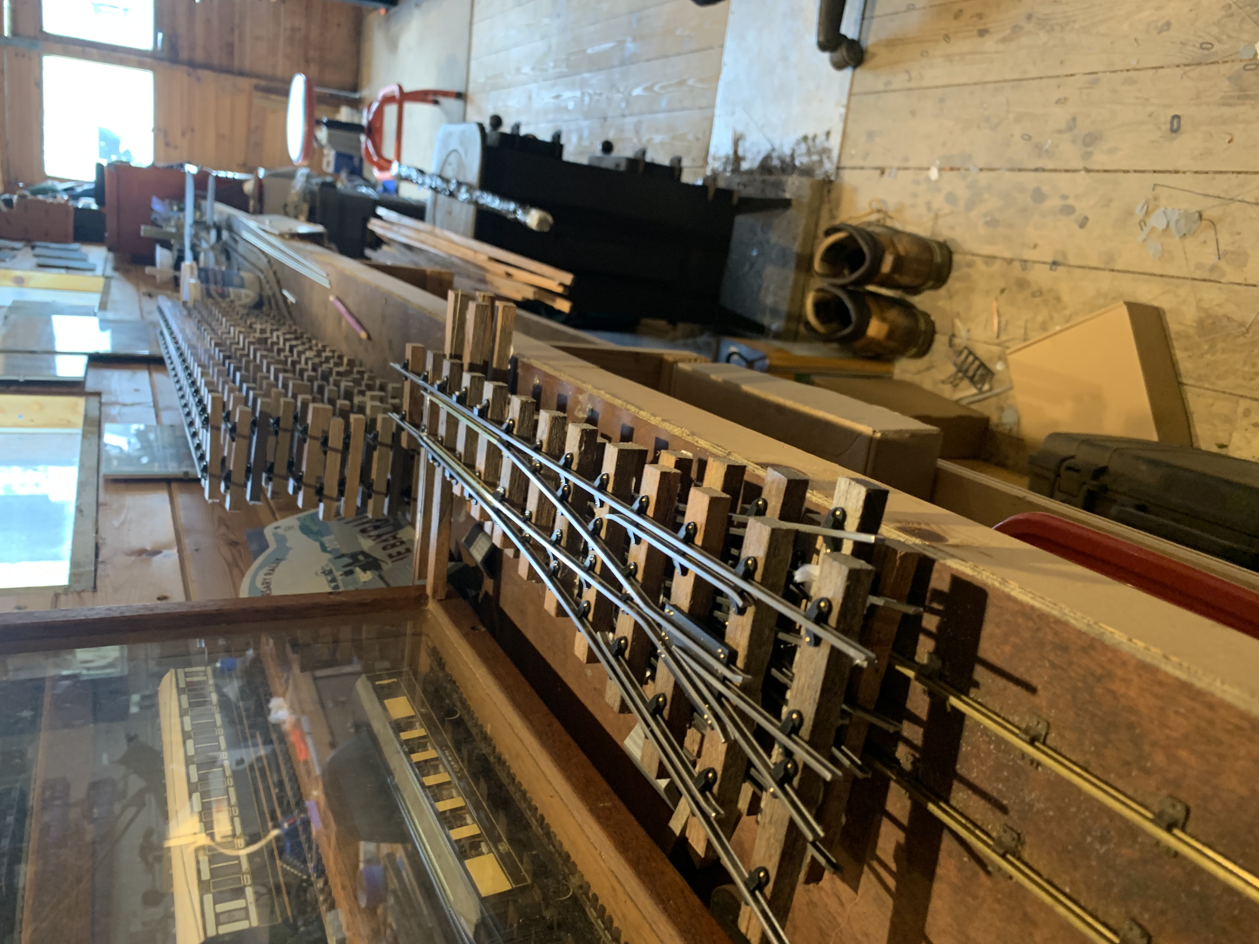

Post by Trevor Thompson » Tue Apr 22, 2025 8:57 am
Almost ready to lay track. There are 11 lengths of track made up and 3 points here:
and a double slip almost ready:
I am wondering about actuators for the points. Something printed in the short term I think.
Posts: 5971
Post by philipy » Tue Apr 22, 2025 9:31 am
That double slip looks very impressive, Trevor.
Posts: 1174
Location: South West Wales
Post by Trevor Thompson » Tue Apr 22, 2025 10:13 am
philipy wrote: Tue Apr 22, 2025 9:31 am That double slip looks very impressive, Trevor.
Took lots of effort to make it - three mornings in all. I just hope it works as well as it should.

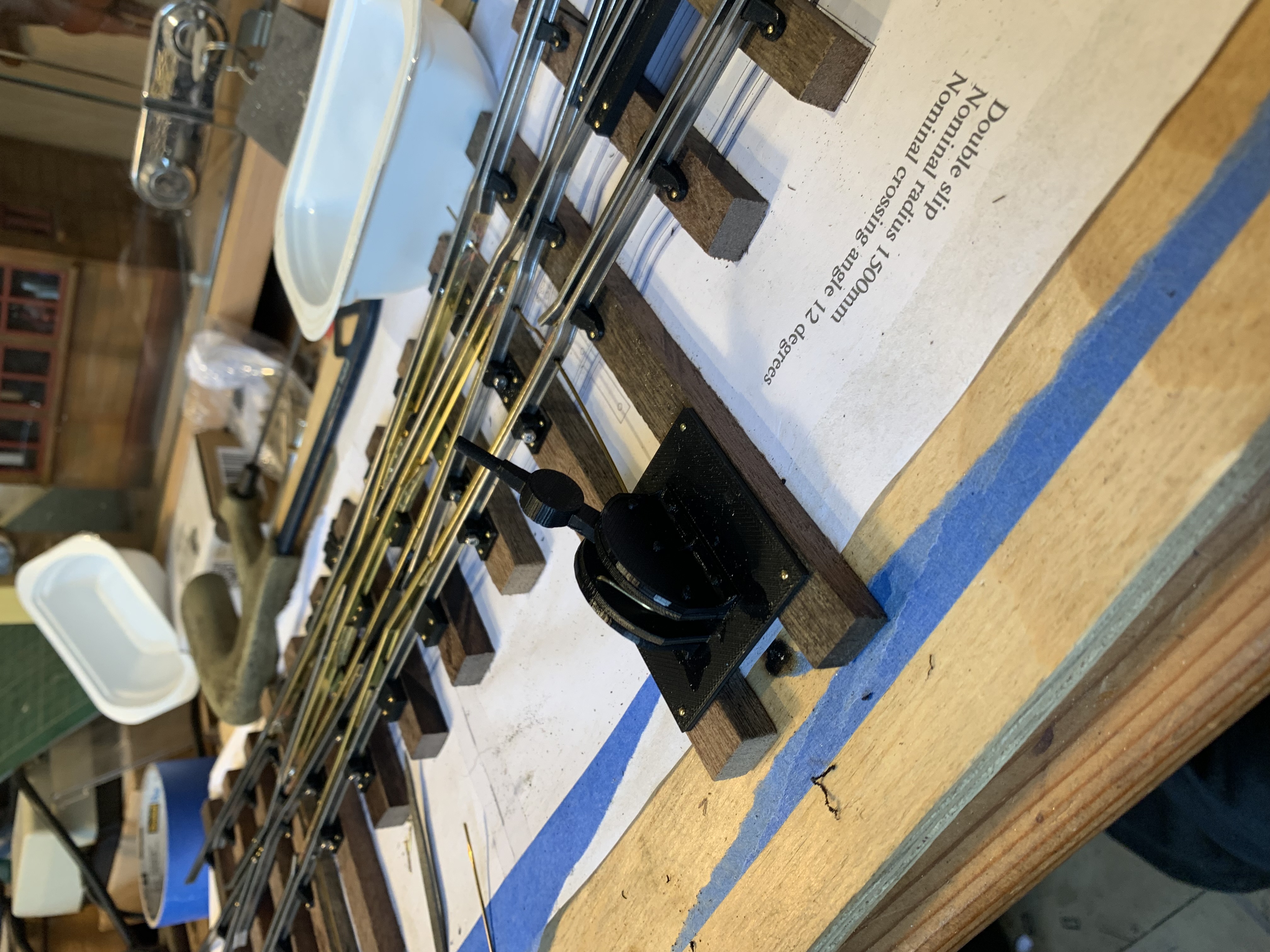

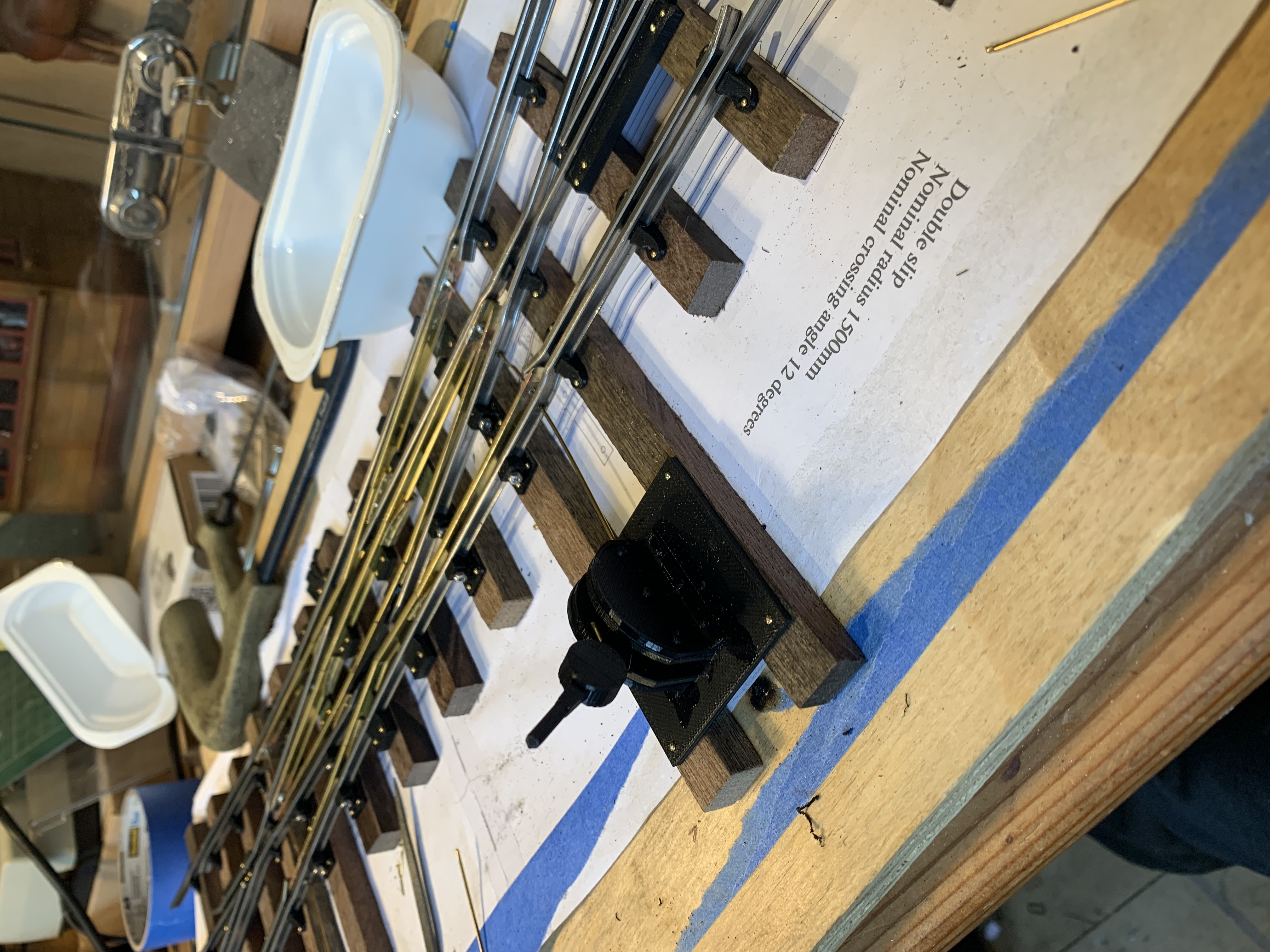

Post by Trevor Thompson » Tue Apr 22, 2025 1:57 pm
Rick thanks for posting the link to a point lever - but I have designed and printed one this morning. So this is based on something I found in one of my books on the Festiniog:
and:
There is an over centre spring just about hidden within the body You can see a glimmer of it in the photos) to give positive location. The bit of pressure is required because I like to drill a hole through the outer rails and the blades and solder the wire to the blades. So moving the blades slightly bends the wire hence the need for a bit of force. I find this technique holds the blades in position - they can't work their way out of the fishplates.
It works! So I am sending multiple copies to the printer.

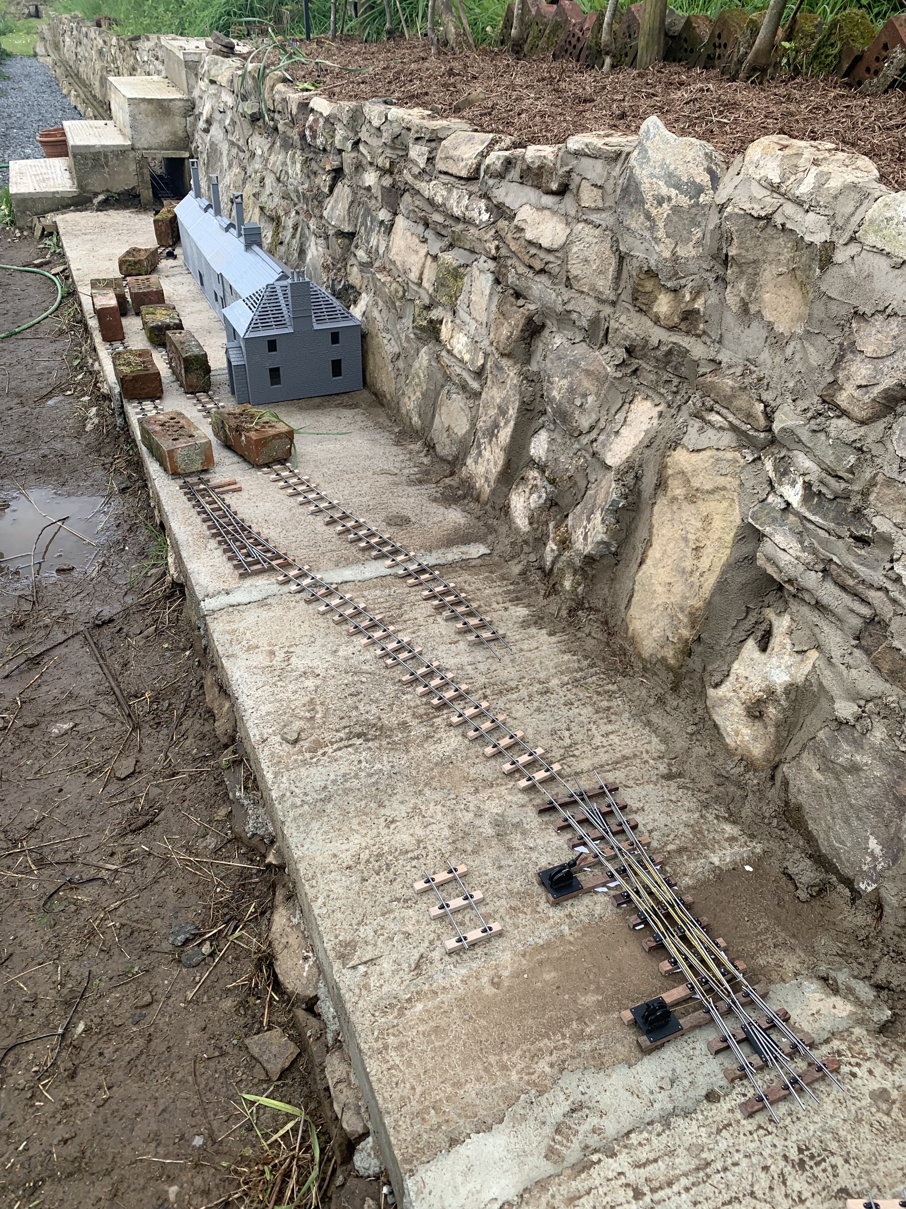

Post by Trevor Thompson » Wed Apr 23, 2025 8:45 pm
Today I started to lay the track work:
Only problem I can see at the moment is that I think the point levers are going to hit the sides of the rolling stock - so a modification might be required. Oh and I need to order more fishplates.
Posts: 5971
Post by philipy » Wed Apr 23, 2025 8:54 pm
Trevor Thompson wrote: Wed Apr 23, 2025 8:45 pm
I did wonder about that when you posted the initial picture yesterday. I had exactly the same problem when I printed my own point levers.

Posts: 7877
Post by ge_rik » Thu Apr 24, 2025 8:02 am
That slip looks even more impressive in situ
Posts: 1174
Post by Trevor Thompson » Thu Apr 24, 2025 9:45 am
ge_rik wrote: Thu Apr 24, 2025 8:02 am That slip looks even more impressive in situ
I will see if it works this afternoon when it is all connected up.
Having made it, I have worked out how it works! in that each point lever "points" to the road it is set for. So in the photo it is set for as a crossing connecting the far left road to the near right road. I think I can cope with that.
