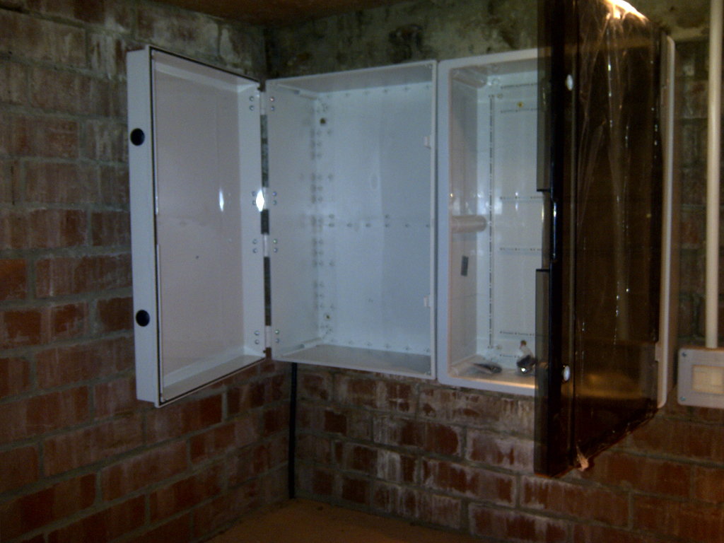

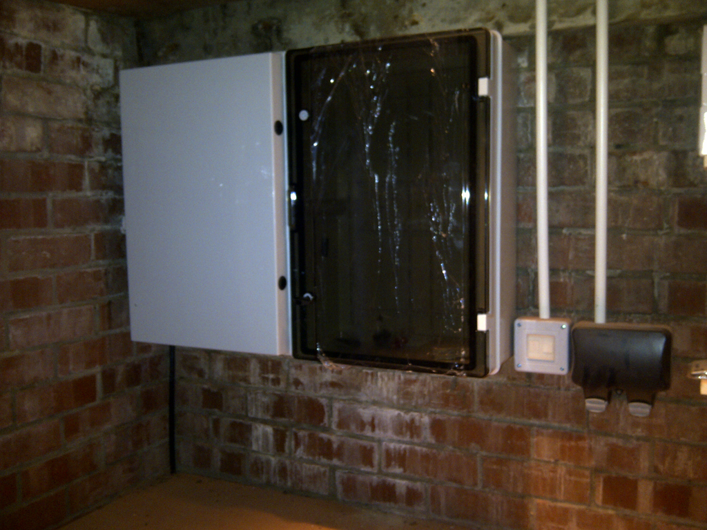

Work continues inside the garage, IP rated housings for the electronics of power and control system and the network connection to the main house has been completed.
Following advice from another (non-railway) forum re: electronics and computers in a workshop / garage environment there is to be an anti-condensation heater fitted in the bottom of both to keep the temperature inside at least 10 deg c.

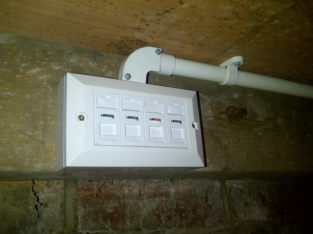

Post by tom_tom_go » Sun Apr 03, 2016 9:53 am
Did they tell you to fit CAT6 cabling plus wall sockets?
stevenfitch
Posts: 223
Location: Northumberland UK
Post by stevenfitch » Sun Apr 03, 2016 2:13 pm
tom_tom_go:117150 wrote:Did they tell you to fit CAT6 cabling plus wall sockets?
Data cabling is part of what my company does so i may have gone a bit OTT but as a channel was cut across the drive for the power cable to be run in anyway i thought 'why not' - didnt want to just rely on the WiFi

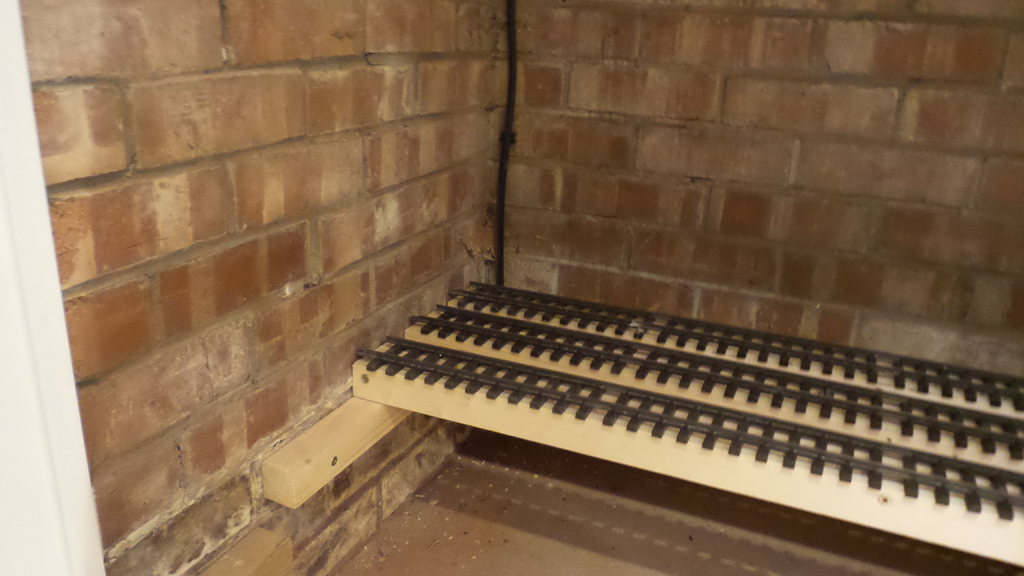

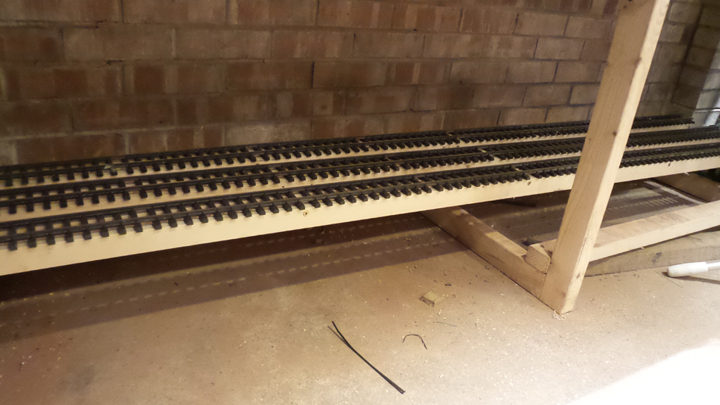

Finally some track
Post by stevenfitch » Sun Apr 10, 2016 9:12 pm
Ive finally got round to adding some track (in the garage)
Now just awaiting the arrival of some points and pneumatic stuff for the control.
2 sidings and the running line at the rear under the bench in the garage.
Hole in the wall will be at the rear most track here
