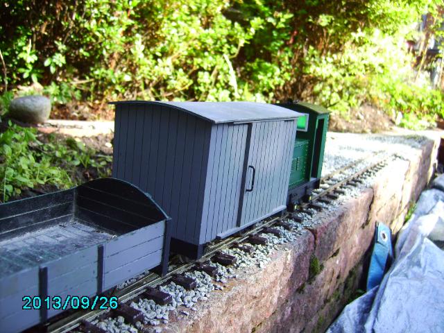

New foundations laid to create space for the Yard/Sation area.
Founddations laid for the sidings etc.
Track from Jenny over the road cleaned of old mortar and cr*p, points refurbished (one new pair ordered).
Once foundation was solid track laid and mortared and ballasted into place.
Half the loop was done yesterday the remainder today (alas finished in a bit of a rush due to it starting to rain. NOT my best work and e'er now tis bugging me from the garden as I sit in my office so I think the long siding will have to be relaid at some point).
Having been used to ballasting indoor model railways where the ballast was purely cosmetic.....16mm ballasting is proving rather differant - as it has to work as real ballast. Ive found some really fine c.3mm granite and slate chippings which are really angular and lock together nicely. I also made myself a little tamper to pack it all down tight and lock together to hold the track solid.

This is where I have the advantage being Canadian. My rolling stock is a mish-mash of Welsh, English, and even I.O.M, and no-one is around to correct me or get all funny about it.SapperAnt:89575 wrote:
I was casting about for ideas of English as opposed to Welsh NG lines and came accross a 13 year old Railway Modeller which had Blythburgh as "Model of the Month" and was hooked. Obviously, my line is 2 foot, not 3 foot. And will use largely ex-WD stock.....
Ballasting is a sticky wicket, because though it does have to function as real ballast, unfortunately any sort of rain at all in real life qualifies as a 16mm deluge, and you'll be forever repairing the roadbed if you don't fix it down somehow. I know this because on my little loop of track which I have just hidden in the woods near my house, I actually had quite a nice day of smooth running after I had "ballasted" the tracks as per full-size practice, but then the next week came back to find the ballast was all washed away and I was back to the same old jumping-off-the-tracks nonsense as before.

Ive tried two methods
the first mixing ballast and some sand with waterproof PVA and applying that
the second - and my favoured method - mixing the ballast with dry quick drying mortar, applying the mix and then watering it.
Time will tell as to which will last.
Mind you the ballast Im using is £2.50 for a 10kg bag so I'm not complaining!!!!

Also forgot to mention: ran the first Steam on the new Yard today.
Did some shunting.
I have learned several things from an afternoon of setting myself shunting puzzles and Pimms.
1. Fit chopper couplings to all stock (chain is too faffy)
2. Remove the blades from the loco to easy coupling and uncoupling.
3. An off-layout steam up area is a must.
Ive also discovered my scratch built long wheel based 4 wheel stock derails over the Peco 38" radius points. So I need to shorten the wheelbase or get rid. They run fine on the curves but derail on the points. This is....annoying.
The current curves are a bit tight. They're the 2' 6" radius ones. Im not sure how I can slacken them without a major rebuild so this means short wheel base stock...or bogeys.
I am also very tempted to extend the Yard/Station area forwards into the sunken garden via wooden shelf attached via battens and angle brackets as a means of creating more scenic space. Probably as a lift-on/off section with the station building,platform etc mounted on it to be taken out for running sessions. This would also increase the realism as I would have the train running through the scenery rather than as is now, on the edge of it! It would also provide greater peace of mind in case of any accident there'd be no drop!!!!

Curves, curves, curves!
I think it's official. I need to relay the curves with the new Peco 38" radius. The current 30" radius are just to goddam tight!
I'm going to have a furtle with track templates but I think they shouldnt be a problem and will have the added bonus (in my head) of taking the track away from the wall tops for most of the run which will prevent what happened earlier today - a derailment and a drop of 18 inches to the ground. OUCH.
