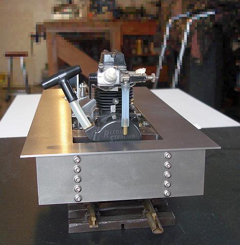

Mr. Bond of the DVLR:100826 wrote:With regards the protector/ oil bath - do you think a drain valve for changing the oil would be required or would you syringe it out?
I can't wait to see a video of the finished thing!
Well, at the moment I think we'll do without any drain and just apply oil to the gears before a run.
I can't wait to get it running too. Just need the on-board fuel tank and a new exhaust system. I could fill the gear case with excess castor oil from the exhaust system that doesn't go into the first gearbox, then it could finally overflow on to the track.

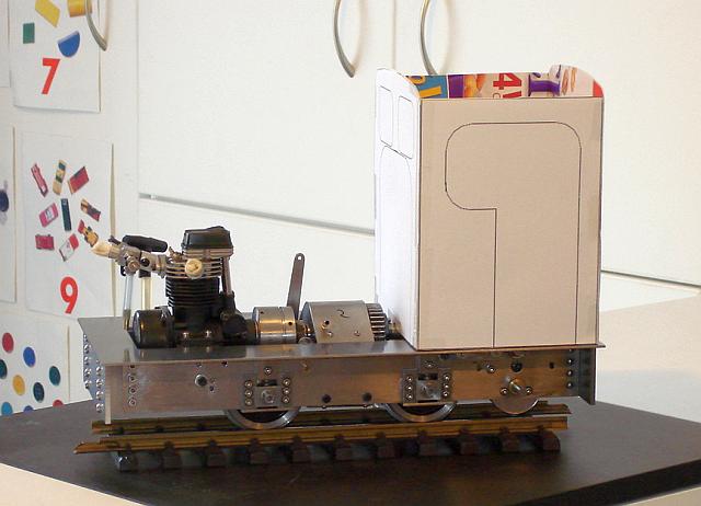

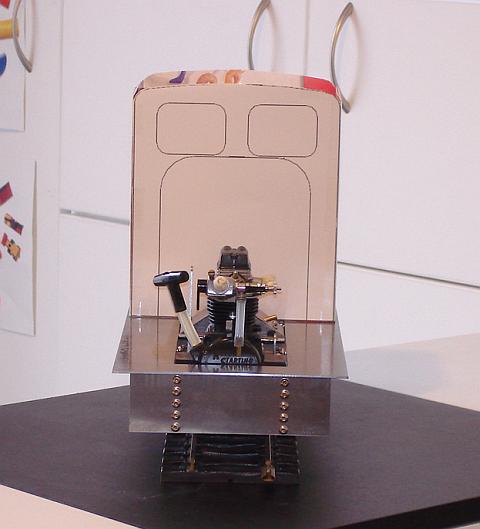

Post by dewintondave » Mon Jun 02, 2014 8:33 am

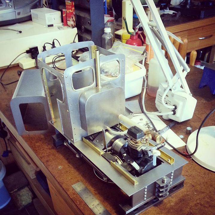

I had a big shock when the cab was mocked-up in card today, it's enormous!

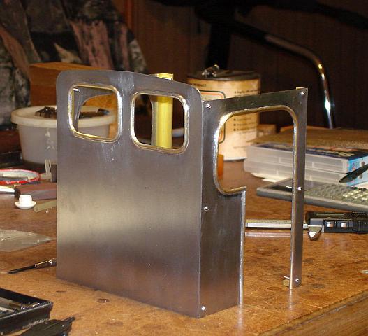

Post by dewintondave » Mon Jun 30, 2014 8:00 am
Slow progress recently. Ended up cutting out the cab pieces by hand after wasting time and money on a scroll saw. Then spent a week waiting for a metre of 1/8" brass half round beading to arrive; to edge the window openings and doorways. The metre length wasn't quite enough, but the front and both sides are done. I've got some more on order for the rear sheet. It's quite an enjoyable process soft-soldering the beading. The most important part is annealing it first, otherwise it is far too stiff.
I need to have the superstructure finalised so that I can progress the exhaust, fuel tank, and controls.

Post by dewintondave » Sat Jul 12, 2014 7:44 am
Well, the cab is nearing completion.  All the beading is on.  It is time to make a gentle start on the bonnet.

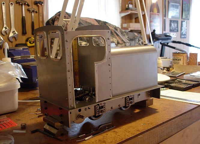

Post by dewintondave » Wed Jul 30, 2014 10:20 am
Here we are, I've bent up the bonnet in the wood vice. I like the end-on view, it's got that menacing look of the truck in "Duel" (I could put some battered old engine nameplates along the buffer beam of victims, lol).

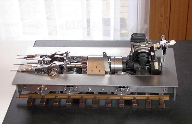

Here's the latest progress, the side rods fitted, a test run on the line - pushed by hand...
The motion is a bit tight, it needs a good run under power.

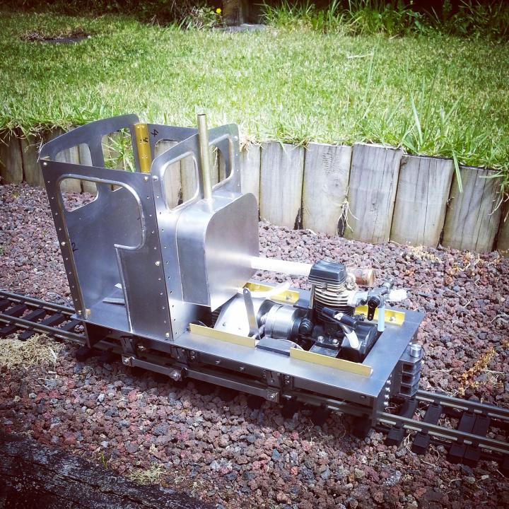

Post by dewintondave » Sun Sep 07, 2014 8:36 am

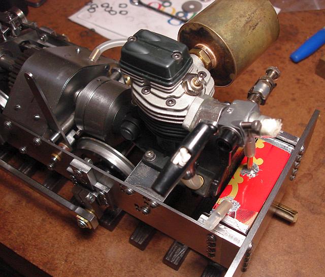

Finally, I got the loco running again. Last weekend I had lots of fun soldering up a small on-board fuel tank from a can. It only holds about 40 mL, but it lasts for 20 minutes and can be topped-up when running.
Just keep filling until fuel comes out the overflow.
Video of the run
