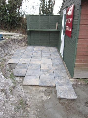

More progress on the groundworks.... since lunchtime I have managed to lay most of the slabs which will define the retaining wall and location of the running line. This might seem the wrong way round of building a garden railway but I want to be able to get at the track from a good working height. It seems better to me to have good access to the storage and operating areas first, and the track fitted in where it is most accessible.
Whatever happens, I'm enjoying the experience! However, due to the nature of the construction, it will have to be right first time because there will be no chance to alter the build once the track plan is established. This is where I fall down because of my limited experience with other garden railways. Also, my complete lack of knowledge of how real railways work..... I'm sure to contravene all sorts of safety aspects in running a line, but, who's looking?

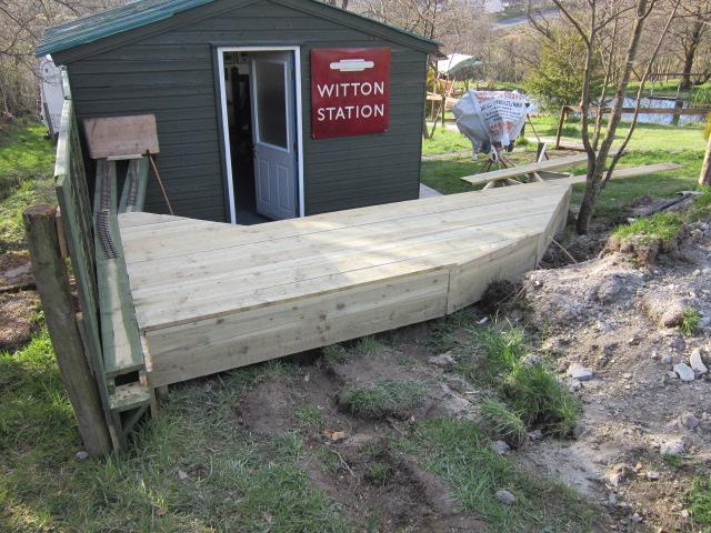

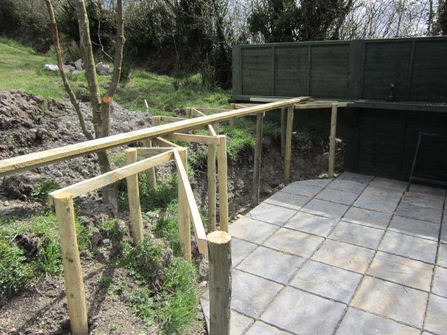

More progress to report.... I am building a waist height preparation area and station outside the shed with easy access to make up trains and hold others in sidings. This is about 4 feet wide and about 18 feet long when complete. I keep changing my mind about the track plan and the way the support structure will be when finished. However, I know what I am trying to achieve and will get there eventually.
The first picture shows the method of construction:
Next is the decking to put the station area on:
Finally, the boards which will hold back the mountain of soil on my sloping ground. I will fill up to track level but can then make hills and valleys to add interest.
When I make something I make it to last... All timber is pressure treated and every piece is screwed (not nailed) for extra strength.
'Never knowingly under-engineered' is my motto.

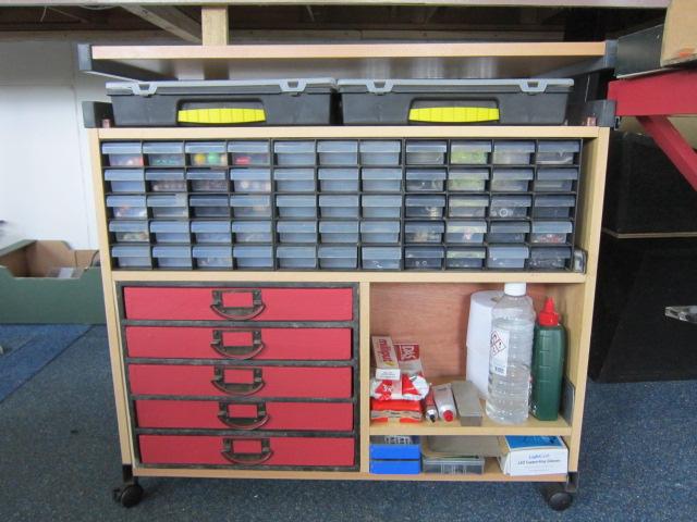

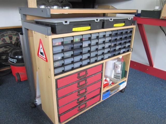

Slightly off the main subject, but connected to it..... I have had to make a move of my modelling table and all associated storage shelves etc. from the comfort of my kitchen/diner into the layout shed. This is not a problem as far as location goes as I can be next to the railway for tests and trials etc. However, I did have a nice set-up for all of my bits and pieces and needed to make a new storage unit to cater for them.
The answer came from an unusual source.....a redundant computer desk. This unit was missing its pull-out keyboard shelf but had all of its castors and was otherwise undamaged.
A few pieces of conti-board and several storage units later it now looks like this...
All of my spares and accessories are housed in this mobile unit. Plasticard sheet and metal rods etc are at the rear, paints and adhesives at the front. I have everything in reach without even leaving my chair.
Even room for a bottle of red on the top!
This is placed next to my modelling table, also a refugee from the kitchen...
[url=./myff/1558872/IMG_1048.JPG]
[/u

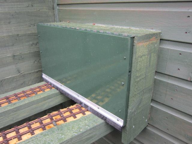

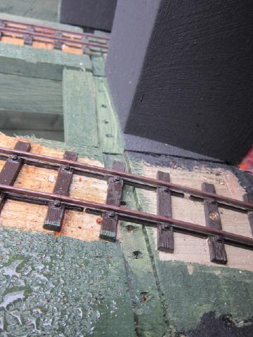

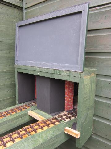

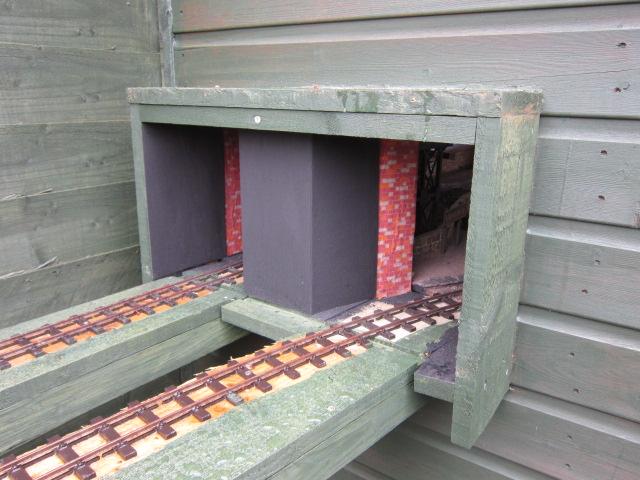

Little progress on the railway in this weather!
I don't mind working in the rain but the clay here is so slipperry it could be dangerous, so, I have turned my attention to the exit points where the tracks leave the shed. In previous photographs you can see a temporary board covering the openings. This was just to keep the rain out until I devised a permanent idea.
In the first picture below, the main structure has already been put in place. This is a 6inch frame pushing the opening away from the wall of the shed and keeping the scenery dry inside. Any damp would certainly destroy the plaster and other materials.
The groove, cut with my router, is to prevent any water from passing further than this point.
The new, permanent door, is made from a piece of sheet steel which I found in the 'useful one day' section of our storage shed.
It is hinged at the top with a piano hinge and brass screws. At the bottom is a strip of draught excluder which follows the contour of the track.
Door open..... Just have to make a clip to keep it from falling down on any stock passing below.
