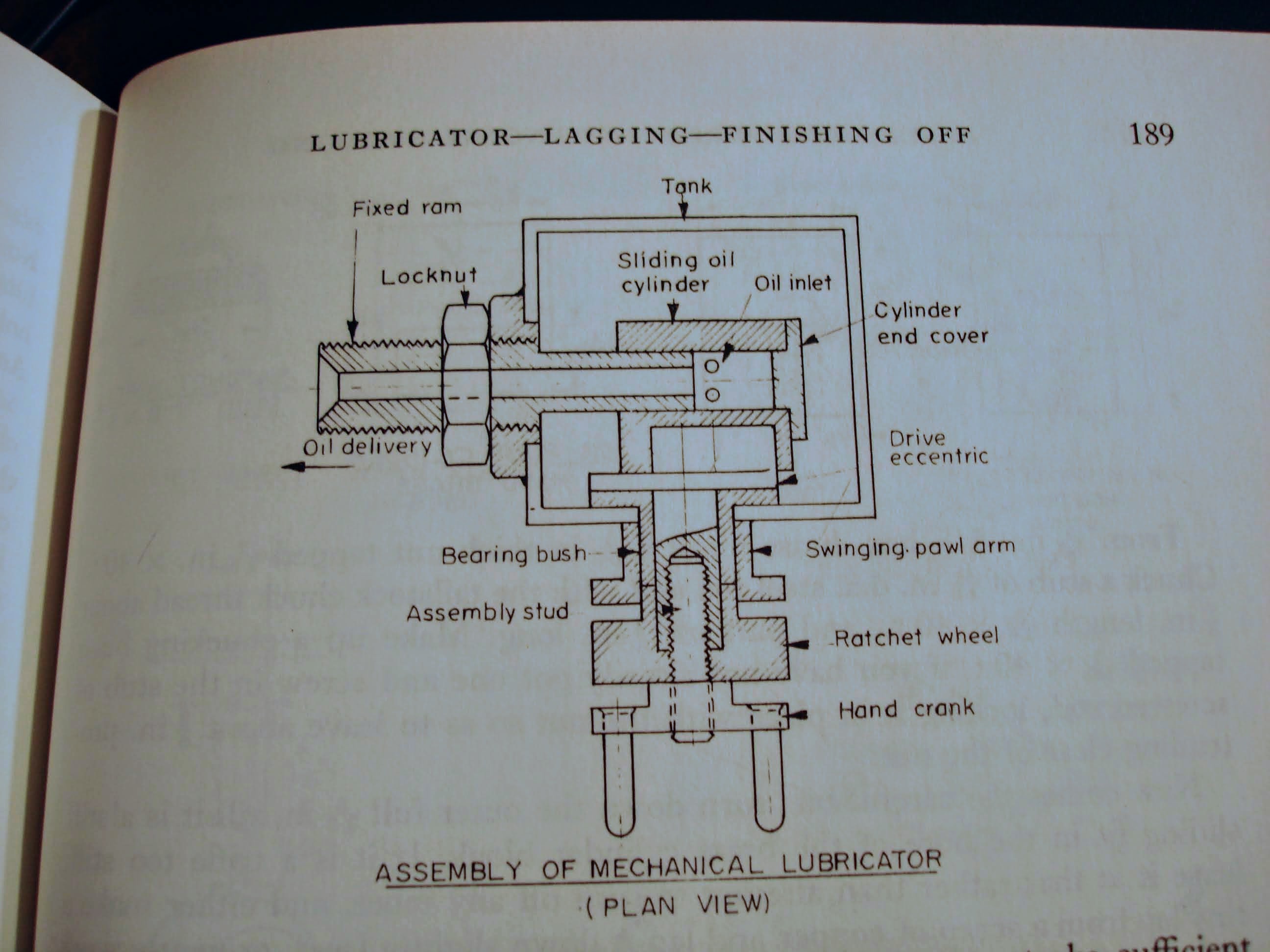

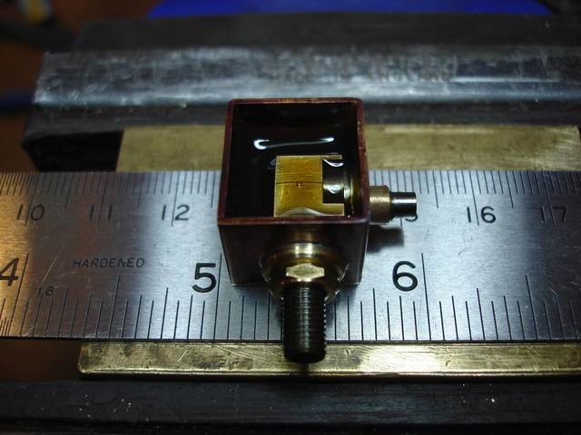

A month ago I decided to have another go at fixing the diesel. The lubricator was still unsatisfactory as was the boiler sight glass. So I took the L.C. Mason book - Scale Model Traction Engine Building "featuring minnie" off the shelf and started to build the mechanical lubricator. It is a delightful little mechanism, very little material, but lots of time. There's the lovely click click of the pawls skipping over the ratchet wheel
Here's the lubricator fitted to the chassis running on quiet compressed air

Can you please give us some more details?
for example - how big is the body of this lubricator?
Did you build it exactly as per Mason's book or have you used the book as an inspiration and adapted the design for your needs?
Mason's book (long out of print) is nowadays costing silly money :oops:

bambuko wrote: Sun Aug 23, 2020 11:23 am Can you please give us some more details?
Thank you
The tank is 9/16" x 5/8". I built it exactly to the plans. But the 30 tooth ratchet wheel didn't have enough teeth for my application, so I made a 36 and 42 tooth wheel next, the 42 tooth is the one being used, 36 wasn't enough either. So it's 3.5 turns of the wheels to 1 stroke of the pump. The pump delivery is adjustable, it's set to maximum at the moment

Drive shaft and eccentric
Test pumping
Milling the ratchet wheel with homemade cutter
30T 36T 42T Ratchet wheels - hardened
Ratchet wheel and fixed pawl
