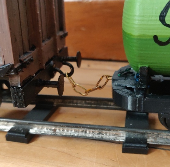

A quick question, I saw many of you are using small chains to connect loco and wagons. Could you give me more detail or amazon link for that kind of chains ?

I've used fishing swivels in the past.
https://tackleworld.com.au/collections/ ... ack-barrel
A couple of advantages over chain they are more rigid and work well in shunting, if a wagon tips over they do mot tend to take the others with it.
I have used these with a piece of split shot to simulate screw link couplers, to try to give a bit of realism.

I can't find it on Amazon, but I get brass plated steel chain by the foot from the local hardware store. The links on mine measure 10mm x 4.5mm with 1mm diameter wire. If I were to order something I'd go with a darker color like antique bronze, the gold sticks out like a sore thumb and paint doesn't stick to it very well.
I started with 3-link chains and as I built wider and longer stock I switched to 5 links to cope with tight curves. I'm going to have to steal that fishing swivel idea though!

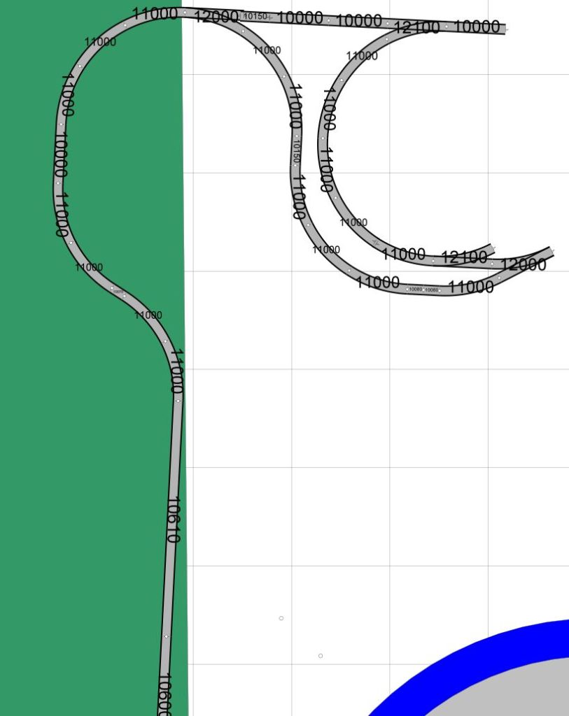

To start here is the general idea of it:
The layout as it is now (except the turntable) :
The left part of the layout will be modified to transform the simple loop into a return loop :
Then the rails will go under and between the cedars :
Finally a second return loop will take place under the trampoline
This will add about 12meters of rails.
I still have one obstacle : my wife :she wants to keep possibility to have plants in this area. So I have to convince here that we can add many plants around the rails !

- Posts: 8052
Re: Sam small layout
Oh yes, plants and trains go very well together. RikSam95 wrote: Thu Mar 20, 2025 8:58 pm I still have one obstacle : my wife :she wants to keep possibility to have plants in this area. So I have to convince here that we can add many plants around the rails !

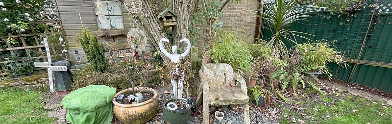

- Posts: 6075
Plants in pots is my suggestion. We have many (Many!!) plants in pots so that my wife can move them around as the fancy takes her.Sam95 wrote: Thu Mar 20, 2025 8:58 pm I still have one obstacle : my wife :she wants to keep possibility to have plants in this area. So I have to convince here that we can add many plants around the rails !
The garden not looking good at the end of winter, but this gives a flavour.
