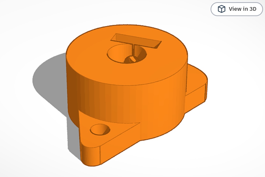

I used fly cranks on my latest motor block - primarily because there wasn't room for Delrin chain and sprockets. Like you I was a bit apprehensive at first, but they turned out to be a lot easier to model in 3D printing than I expected.
Firstly, I decided to use grub screws and square nuts to hold them in place. The smallest I could find on eBay were M2.5. You might be able to find smaller elsewhere
I then drew the fly cranks to accommodate them
fly crank.jpg (54.18 KiB) Viewed 7426 times

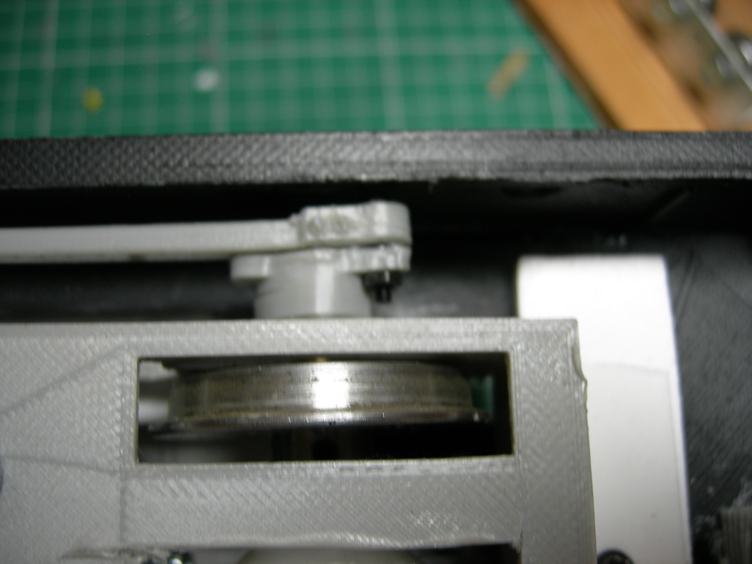

I'd hoped that 2mm holes would be sufficient to hold a 2mm crank pin (2mm bolts with Allen key heads - eBay once more) in place, but I found I needed to reinforce the back of the cranks with a locking nut to stop them unscrewing.
The concept of "quartering" is actually quite flexible. Whilst a precise 90 degree angle is probably more essential for a live steam loco, it seems as if there is a lot more leeway for our electrically powered models. As long as the opposite cranks are roughly at 90 degrees but more importantly are aligned with each other on each side, then it works.

I found that the forces exerted when trying to tighten the grub screws tended to make the necks of my FDM printed fly cranks delaminate, but I found that printing them with 100% infill discouraged this. I've not tried resin printing them as I figured they might be too brittle.
