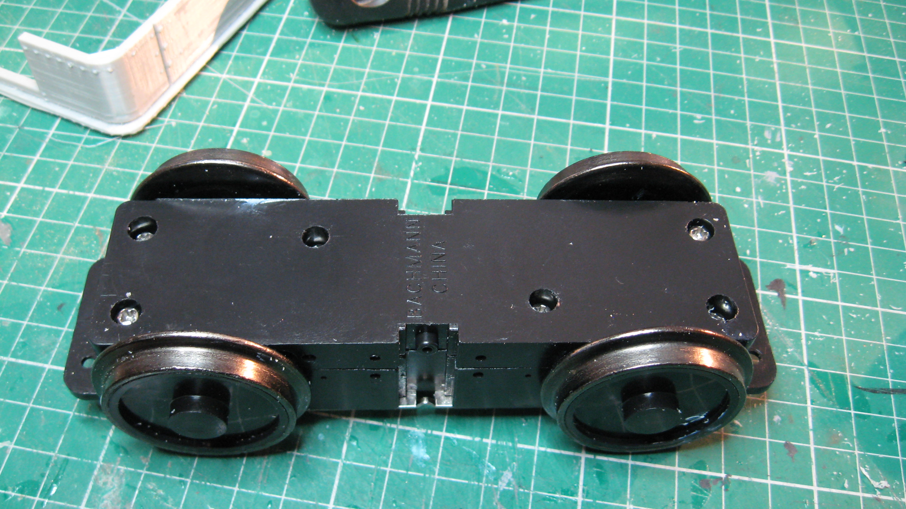

Great outcome Rik really looks the biz! very smooth running too, what exactly is powering this beastie? I dont think you showed us what was under the skirt so to speak

Tropic Blunder wrote: Sat Jul 23, 2022 2:08 am Great outcome Rik really looks the biz! very smooth running too, what exactly is powering this beastie? I dont think you showed us what was under the skirt so to speak
Hi Jake
Thanks. It's in the video but I'll also post the piccie here. It's the motor block from a Bachmann streetcar.
I bought a couple secondhand from someone on this or the GSC forum who was replacing them with something of higher quality. The skirts hide a multitude of sins so I could have put more or less anything under it. I have actually put a trailing bogie under there although it's not really essential.
