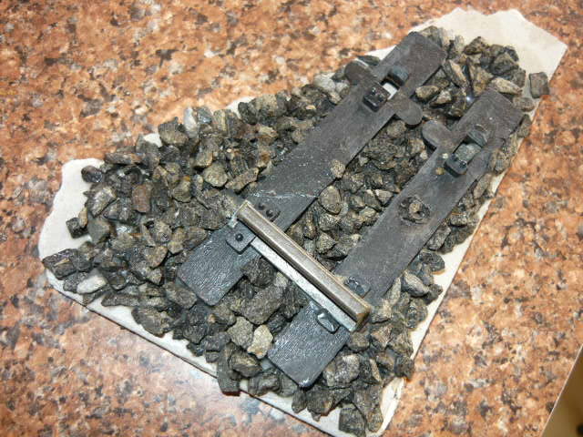

I have started ballasting and adding "grass" to the Cane Line.
I put the trial piece out in the weather in the middle of last year (2021) to see how it would standup after sun rain heat and cold it has not deteriorated at all.
The ballast is 7mm blue metal a type of rock used in concrete and by the fill size railways.
To hold it together I used 50/50 outdoor PVA and water with a few drops of washing up liquid as a wetting agent.
I sprayed the glue on which left holes between the ballast for water drainage, the ballast sits on shade cloth to stop it falling through the holes in the cable tray base.
Ballast Trial (2).JPG (91.42 KiB) Viewed 13751 times
Ballast Trial Piece
