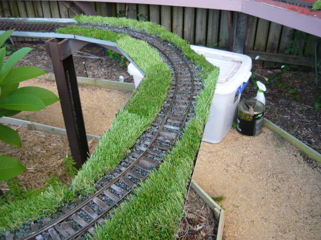

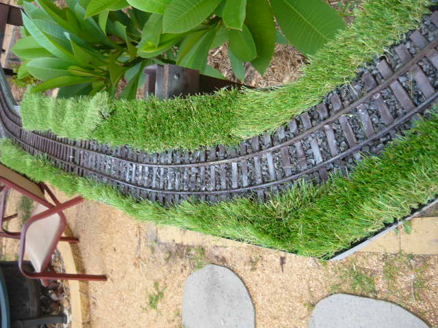

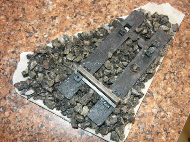

I have started ballasting and adding "grass" to the Cane Line.
I put the trial piece out in the weather in the middle of last year (2021) to see how it would standup after sun rain heat and cold it has not deteriorated at all.
The ballast is 7mm blue metal a type of rock used in concrete and by the fill size railways.
To hold it together I used 50/50 outdoor PVA and water with a few drops of washing up liquid as a wetting agent.
I sprayed the glue on which left holes between the ballast for water drainage, the ballast sits on shade cloth to stop it falling through the holes in the cable tray base.

Ballast Trial Piece

Completed section of track

That looks very good. I must admit that I've been a bit sceptical about the artificial grass in the past, but it does work extremely well in these shots.

Aye, the dearer stuff is a lot better than that dark green turf one usually sees for sale. I saw a pair of thongs in a shop yesterday - the soles were topped with that cheap turf. :roll:

Just what I was thinking. The artificial grass seems to work well in this situation

I have metres of it left over from when they turfed around my pool, I asked "what do you do with the offcuts?" and was told "we usually bin it" so I asked for any offcuts they could spare and they unloaded their offcut bin in the driveway.
They were more than glad to be rid of it as they have to pay to put it in the landfill, guess I could claim recycling credits.

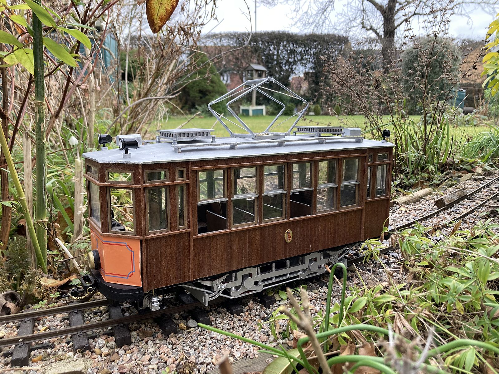

Whilst I'm on this thread, an update on the Occre Soller Tram kit I was building which is now finished, but as mentioned earlier in the thread, I still need to motorise it.

That looks superb. You must get the motorisation sorted, it would be criminal not to run that beauty!

That's a beauty!
I'm off on a family holiday to Majorca this summer but it looks like a trip to Soller from where we are would take all day, and I don't think that's what the family have in mind... Probably just as well, having seen yours, I can't see that I'd manage to ride the real thing without also buying an Occre kit...
