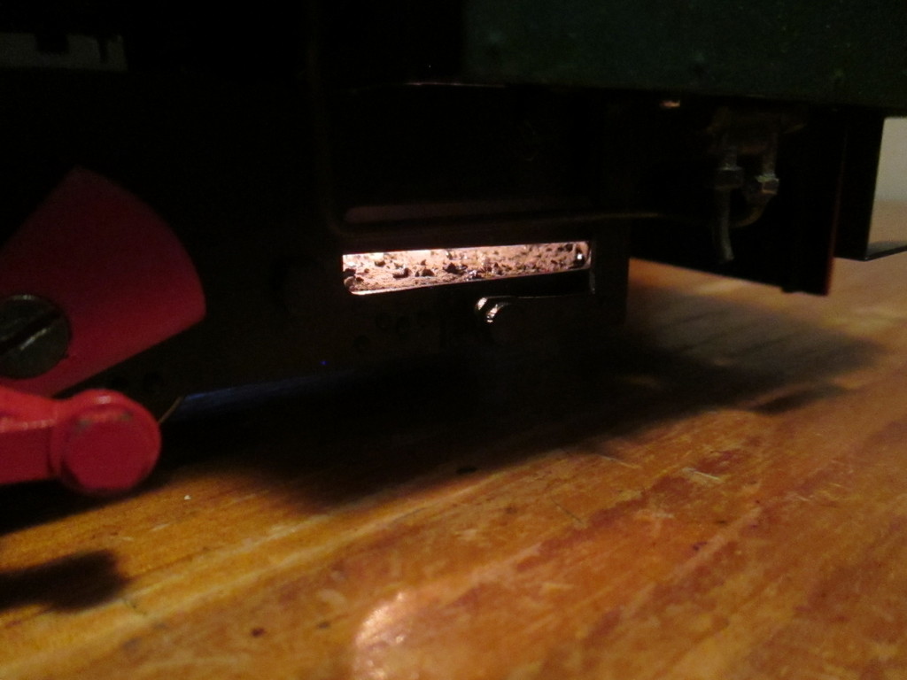

Ashpan painted, dummy doors fitted, and filled with crushed clinker from a 5" loco. Wiring finished, the positive ground system seems to work well, with all the grounds and plugs cleaned and greased. We'll see how it fares. I usually get problems with the lighting on live steamers after only a few runs, so I'm hoping that by grounding the circuit through the loco, and thus cutting the wiring runs in half, I might get some actual long-term reliability out of it. In case it's the 3V grain-of-wheat bulbs to blame, I've not glued them into the headlights this time. Wondering if it might be heat affecting the bulbs, I've never had this issue with any of the same bulbs in my battery locos..

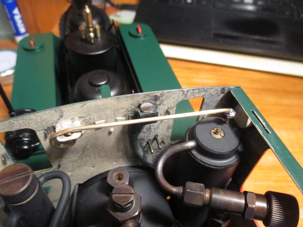

As expected, I had to replace the steel cab strut with brass; the steel one would constantly stick to the magnet connector for the rear headlight and short out. A steel nut was soldered to the end of the strut to hold it in place when the roof is lowered.

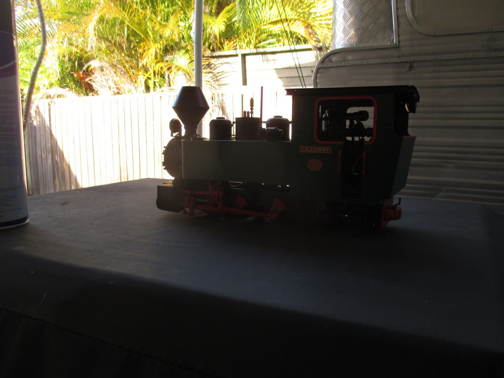

Difficult to make out in the gloom, but it looks lovely from what I can see.

The silhouette certainly looks like a Bundy Fowler and the added details tend to disguise it's Roundhouse origins.
One looks forward to seeing it in full sunlight with a rake of cane trucks behind it. You must be due for some sunshine up there soon, unless Hughie has decided to extend the Wet........

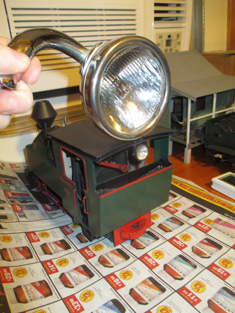

A last-minute headlight upgrade is an option. Never said it was a good one, but.

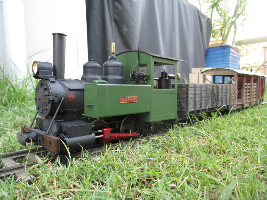

On the first loco I ever weathered, "Baron", I used Humbrol flat clear as a final clearcoat, with excellent results that held up well under steam - Unfortunately I binned the stuff along with the rest of my Humbrol, when I had frosting issues using the same tin on another project. That's when I switched to Tamiya's enamels. Impossible to know weather it was user error or quality issues, there.
The next and now most previous loco I weathered, "Victoria", received a final clearcoat of Tamiya gloss clear. (flattened with flat base)
This turned to a satin sheen on the hottest areas of the loco, upon first firing. Yes, I gave it weeks to cure beforehand, and sprayed it in a dehumidified room. No clue why it did that, but it really spoilt the appearance for me.

Being a tank engine and easily re-gaugeable, This will be the default travelling loco, effectively becoming the new "Scum Class Works" flagship/roving ambassador; replacing my old Ruby "Baron" of years past..
The sun wasn't playing too nicely so it's a bit over-exposed, but good enough. The clearcoat did have me re-touching the white powders and clearcoating again.
The headstock bottoms and couplings were grubbed up with enamels this morning. A batch of variously-sized roll-down canvas blinds were made a few years back, from tissue paper. I think it came from an armour modelling tutorial on youtube..
A whitemetal water bag from Ozark Miniatures was hung on a HO track nail epoxied into the cab - should've thought to solder that back when I had the chance..
The driver from "Baron" was kept when that loco was sold, and after having the bottom of his feet opened out with an end mill in the drill press, received some tiny magnets to keep him in place on the footplate.
Well, that's four down, (Baguley could do with minor reworking though) ten to go!
It's always a weird feeling when the end of a long project is reached. Putting away all the tools and slowly-emptied containers of small parts; Seeing all the possible avenues of new and old projects, opening up again. Steam testing "Calloway" on Saturday, but as I've kept the motion assembled through this thing, I expect little if any adjustments will be needed..
Thanks again for reading, I hope it encourages someone to have a go at weathering their loco. It's not nearly as involved as I feel I've made it look.
