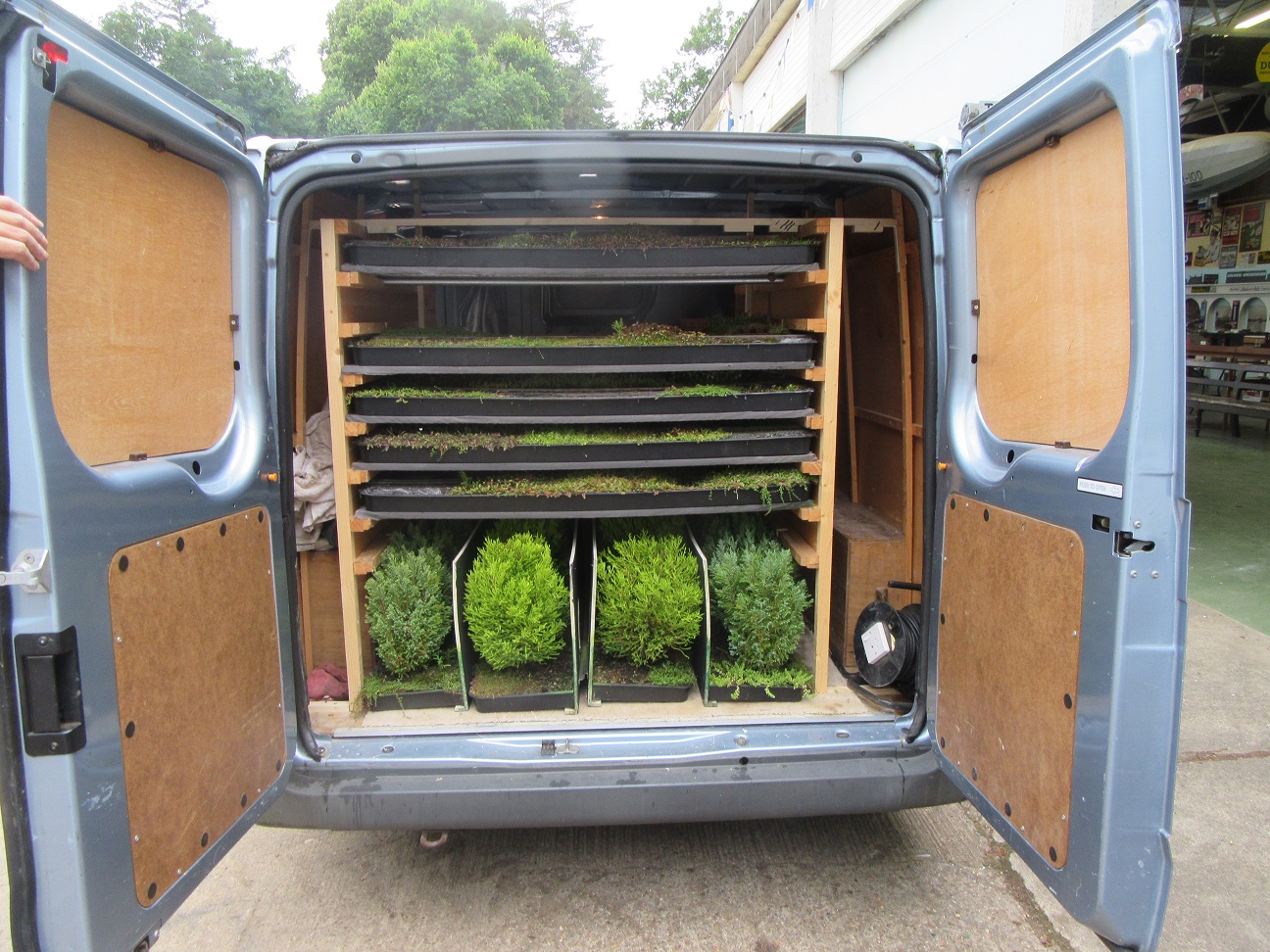

First time in months, I split the layout and loaded it in to my van for transporting to Fawley Hill where I set it up for a trial exhibition outing
It survived the ordeal, pot holes, speed bumps and roundabouts etc. I used my Hambleden rack, reconfigured for wider boards and used 20mm steel conduit pipe bracing to support the added weight of the baseboards.

Looks a well-thought-out transport system, nice work.

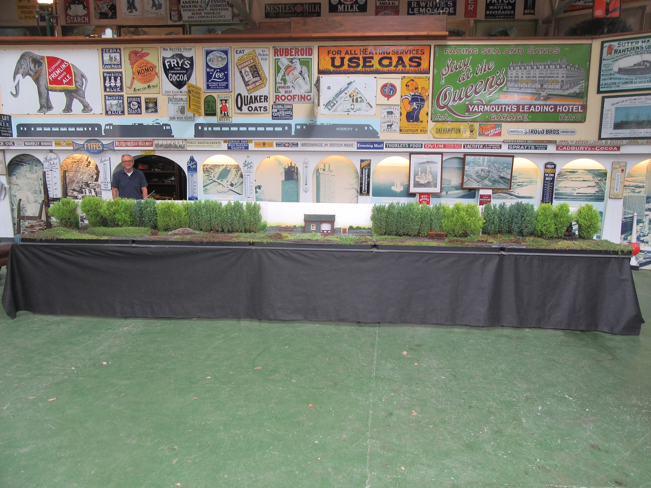

Well it all went back together again in one piece and with no damage. I had to tweak the return track to fix a slight mis-alignment and had to slightly enlarge the openings in the back scene to allow for the locos being on a curve as they go through
Setup in Fawley museum:
The return track loop is a single track on 12mm MDF boards with a central section of cassettes to hold train consists
Roundhouse Lilla with slate train pauses at Pen-Y-Bont halt

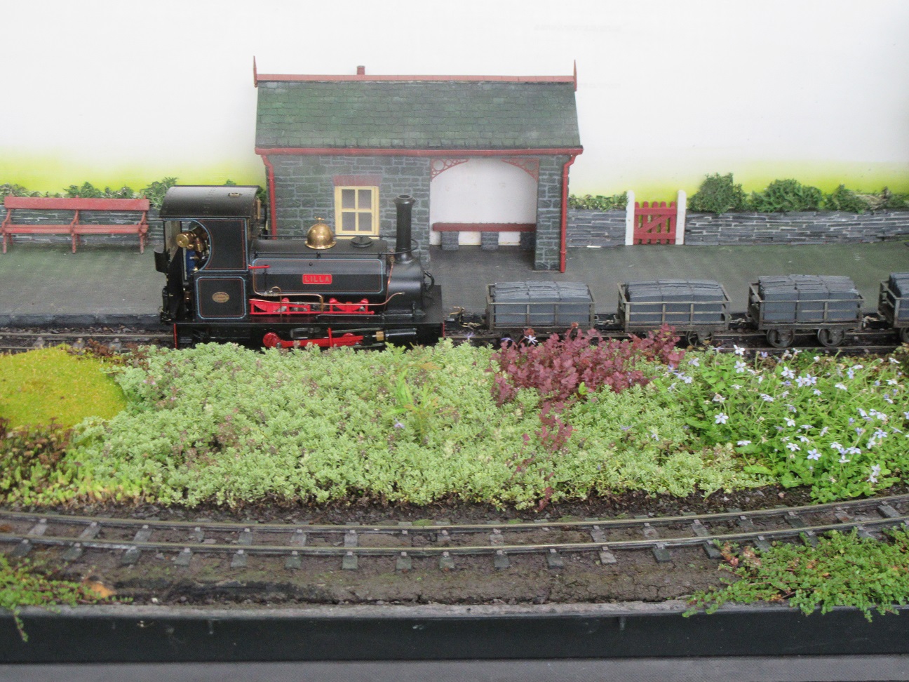

That looks amazing, I do hope it was well received.
- Posts: 8037
Re: Pen-Y-Bont A new portable garden layout
Now that does look good! Well worth all that effort!

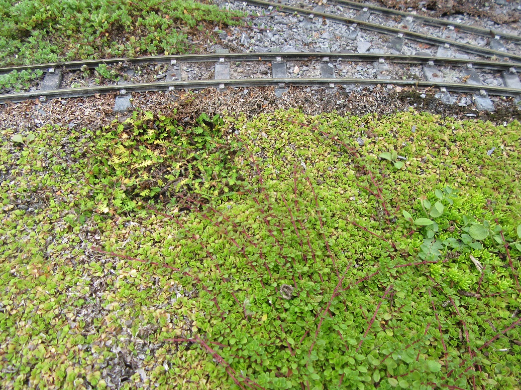

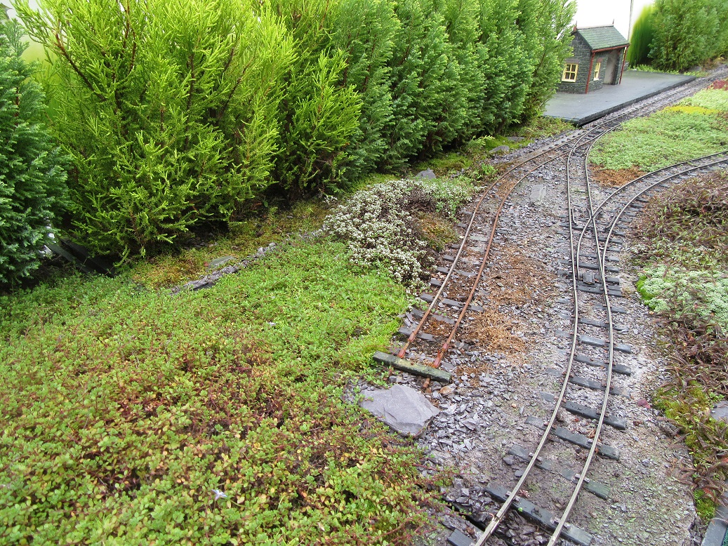

Thanks for all the compliments. The layout continues to evolve as the alpines grow and spread so I thought I would add a couple more photos of them as this layout is all about the plants.
