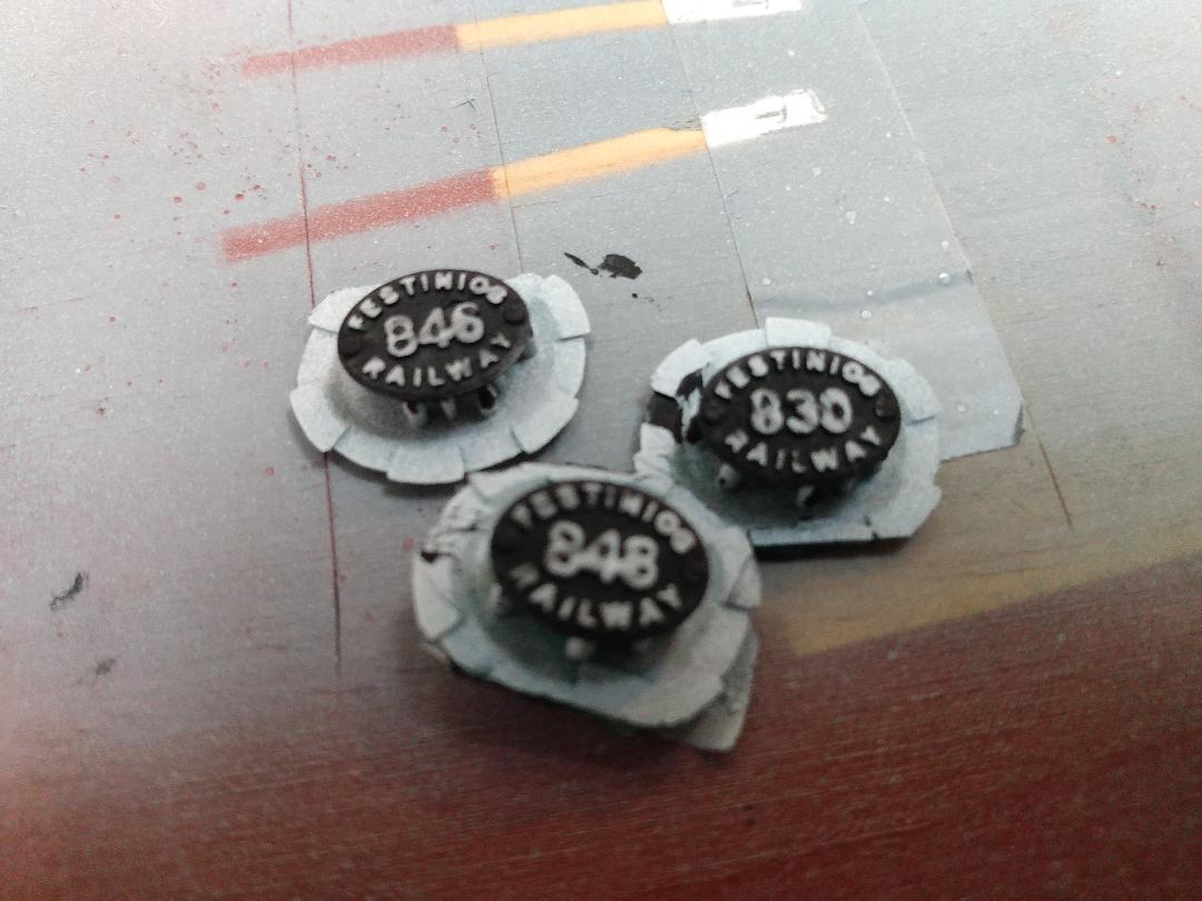

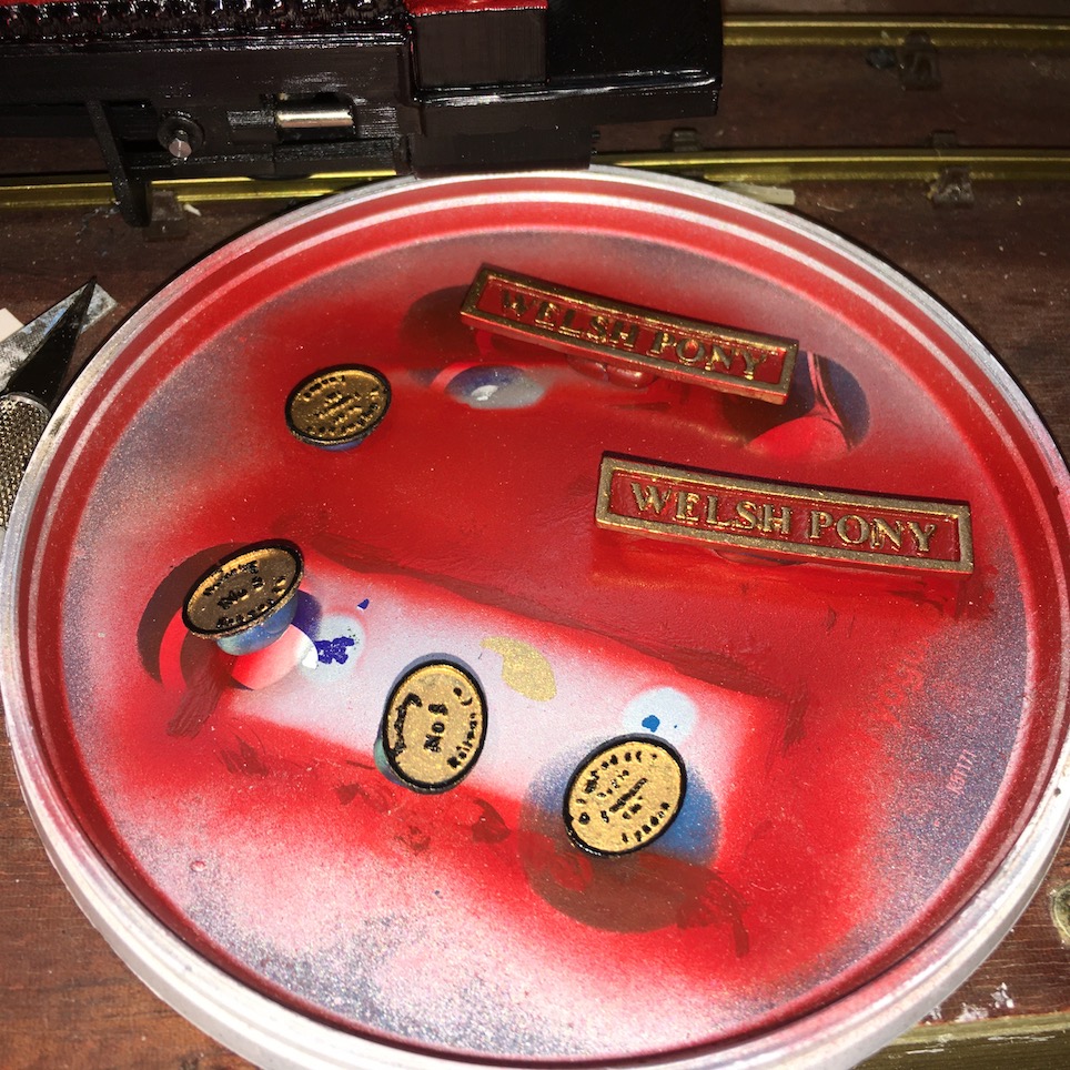

I have resin printed the name plates, makers plates and owners plates. They worked and you can just read the print. I will show you when I have finished painting them - I made a bit of a mess on the first attempt. Not easy to paint accurately as Philip has already indicated!

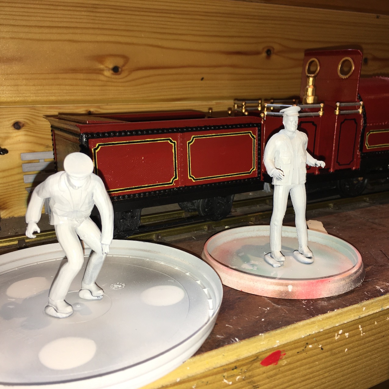

More progress. Driver and fireman resin printed:
The shovel is separate, and its still in the printer. They might work with other tender engines - so I will put the stl files in the printer file section. And of course you can see the beginnings of the lining on the loco in the background. More work to do on that.
And the resin printed plates:
I am fairly happy with the oval plates. The black lettering was added with a lining pen using a 0.25mm nib. Fairly easy and accurate that way. I should have done the names the same way - start again with painting them I think.

Andrew and I found that painting the oval plates works best by painting ( or printing) the whole thing in the colour of the raised lettering/border, then once REALLY dry, flooding it with the recessed colour and quickly wiping the top to remove any overpaint. Brush painting even with a 00000 brush isn't really accurate enough.

As far as name plates go, it looks like your plates are lifting at each end the same as mine do. I am going to thicken up the base to try and avoid this but I am not sure if it's getting them off the build plate that causes it or whether it's the curing process under a UV lamp, I might try an outside natural dry to see if it's that. Let me know if you manage to overcome this.

-steves- wrote: Tue Mar 02, 2021 8:16 am Trevor, that looks freaking amazing, I hope you are very proud of yourself. :thumbup:

The rivets are 1mm diameter and 1mm high. Just rods - not actually rivet shaped. I don't think its obvious when they are printed - and even less so when painted.
The name plates were flat when I took them off the build plate - but warped under UV. I was planning to just glue them into place and expect the glue to hold them flat.
I think I'd try to print them on supports with a plate on the build plate, and then trim the supports after curing. Doing it like that should hold it flat.

Yes I printed them with supports and a raft - but took them off the supports before exposing to UV. Will be interested to see it curing with supports in place has any effect

I think natural drying on sunlight (when we get it) might improve this vastly as I have had other things go a little funny under UV that didn't in the sun. UV lights also make the resin change colour, again, the sun generally doesn't have such an effect on the resin.

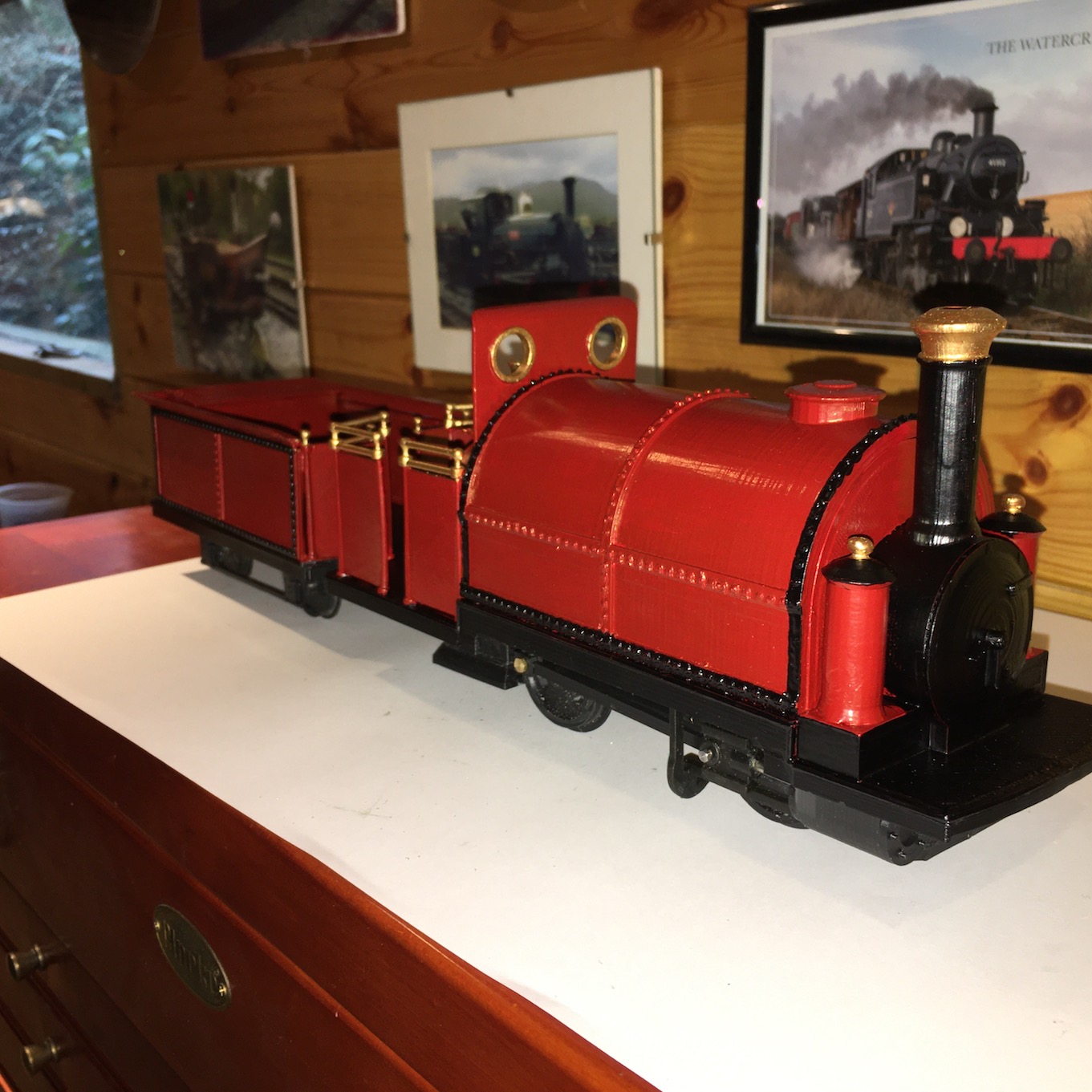

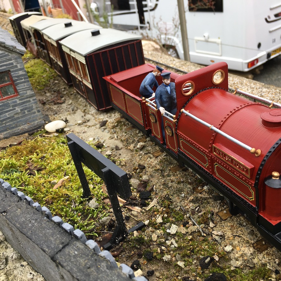

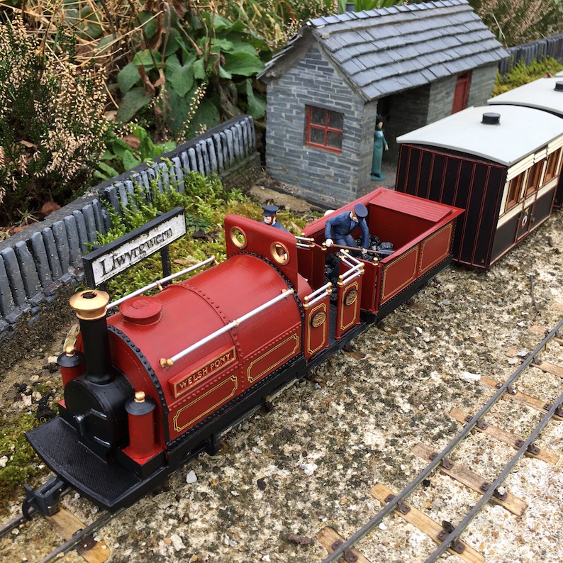

Just to finish off this thread here are some photographs of the finished locomotive:
Posts: 6039
Re: Festiniog Railway Welsh Pony - 3 D printed
Post by philipy » Thu Apr 08, 2021 6:14 am
You should be very proud of that. Well done indeed.
Posts: 7984
Post by ge_rik » Thu Apr 08, 2021 9:28 am
What a beauty!
SimonWood
Posts: 801
Post by SimonWood » Thu Apr 08, 2021 10:51 am
Absolutely stunning.

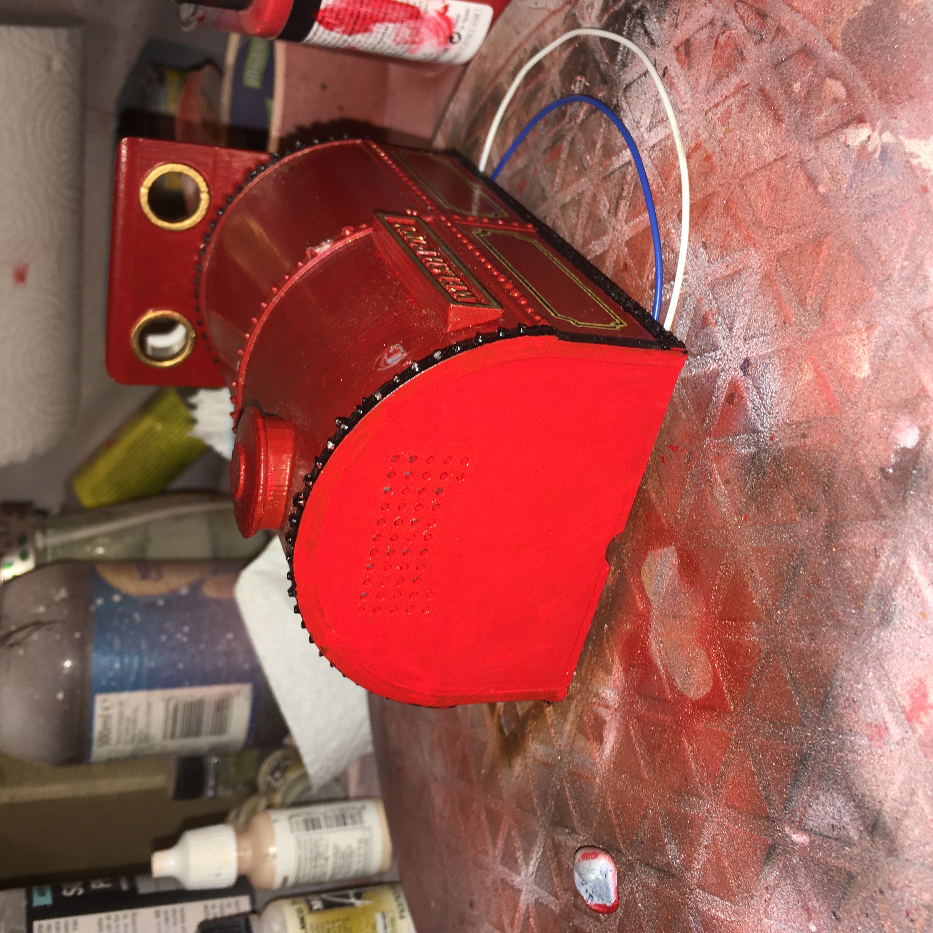

Also after a season running this loco I became dissatisfied with the lack of detail - and the limitations of some of what I had done. So I have taken the opportunity presented by Christmas to get a sound card!
It would have been easier to incorporate the sound card and the speaker in particular when building it. The simple solution to fitting the speaker retrospectively seemed to be to make a new front panel for the water tank. I just hope it won't be too obvious! The other option the front of the tool box in the tender seemed more difficult to actually achieve. So I modified the drawing for the front of the water tank by adding a rectangular matrix of 1.5mm diameter holes. I created a backing box for the speaker at the same time, and printed both. This is the modified water tank:

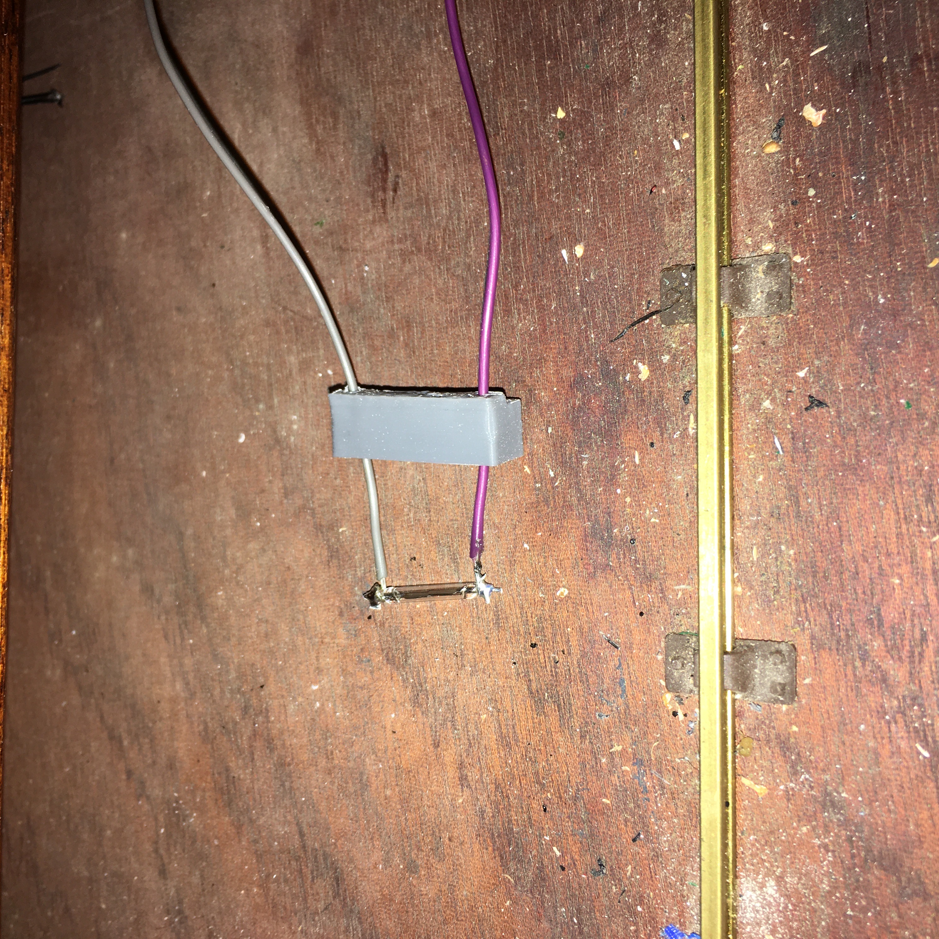

So to the magnets and reed switch.

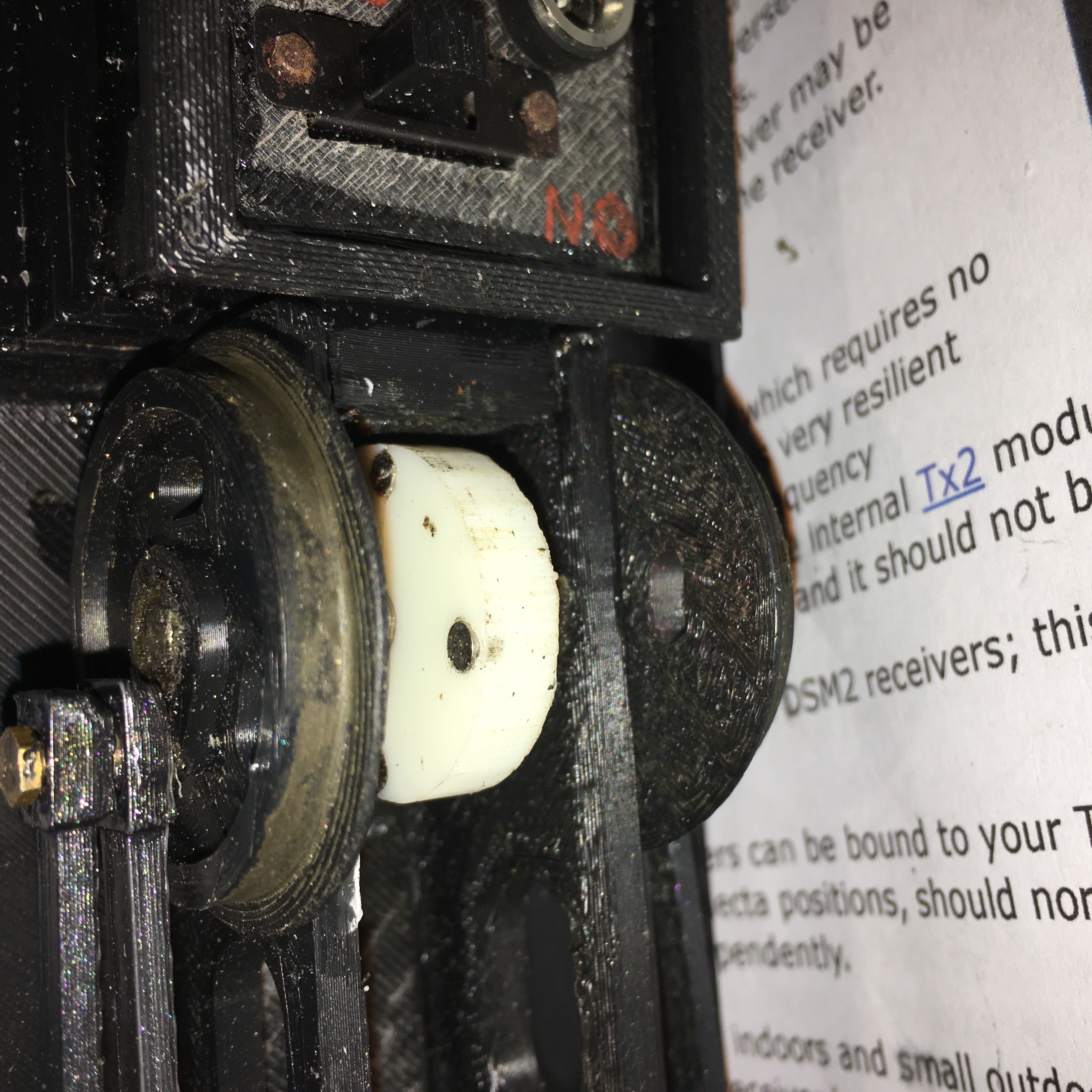

Firstly I created a solid disc with 4 holes in its side, and printed it in two halves - so I could add it without dismantling anything. It is glued to the axle using "super glue" - and magnets are glued into the 4 holes. Not my favourite glue but the easy solution to the problem again:

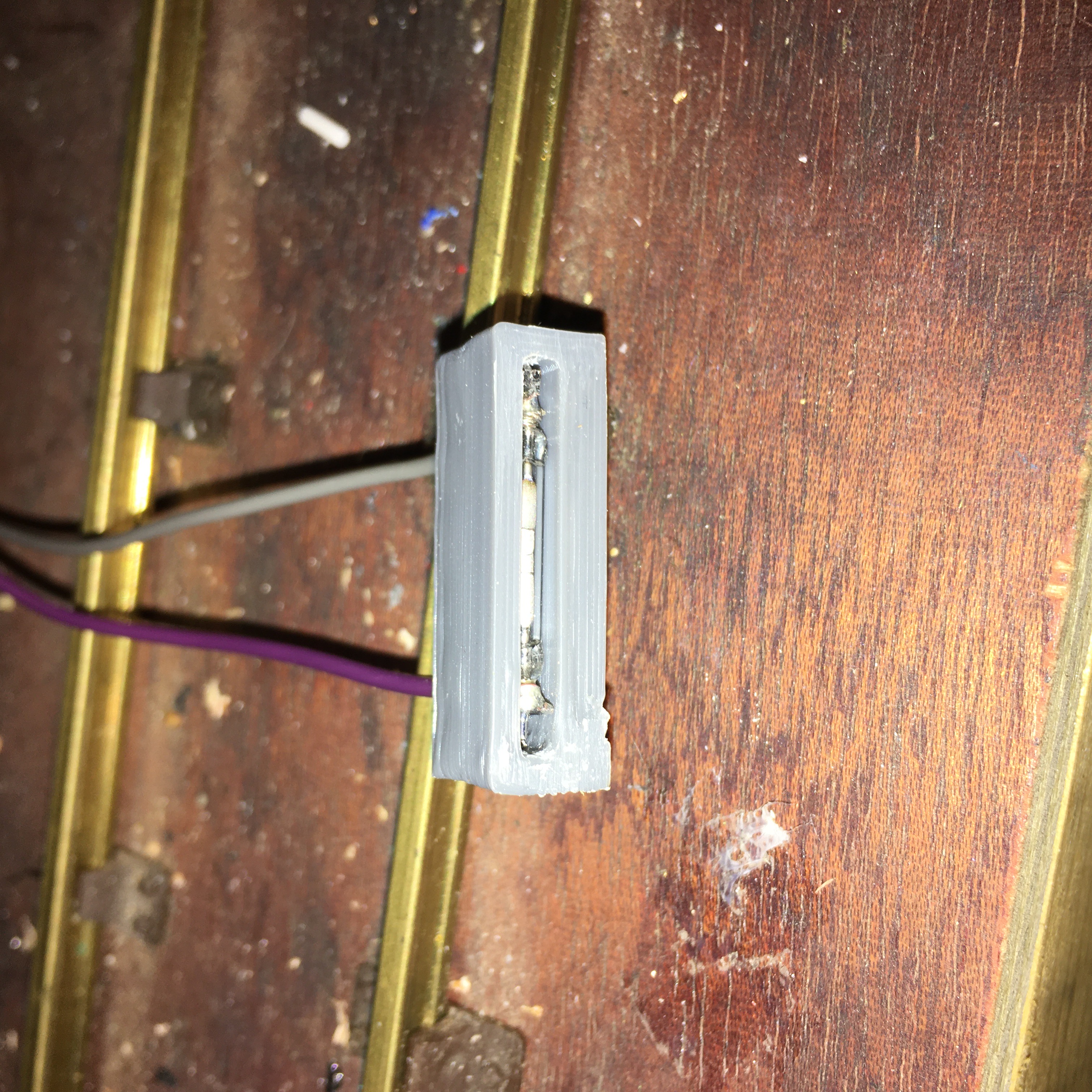

I admit I have had lots of problems with reed switches. I have made a printed container to hold the reed switch , with holes for the wires to protrude upwards into the loco. Wires were soldered to the switch - without bending the switches leads.The reed switches seem really delicate - this is my sixth attempt and involved minimising the forces applied to the switch and its leads:
I cut the leads short and gently pulled the leads to lift the switch into its housing:

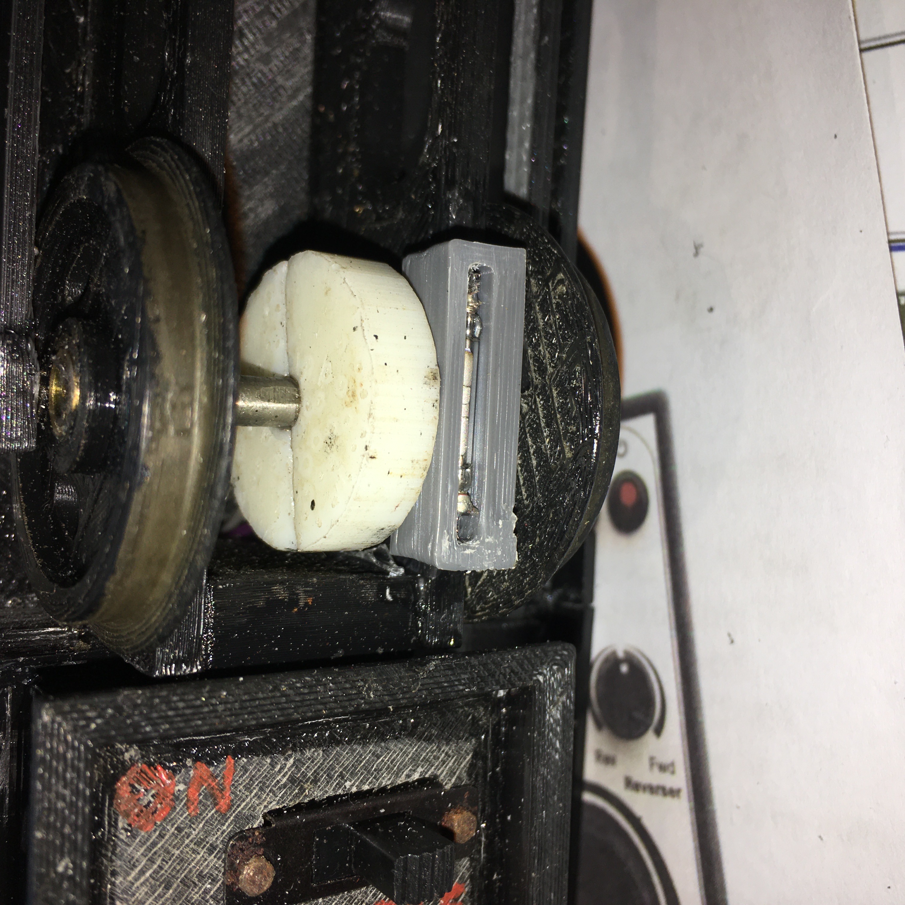

It is now glued to the bottom of the chassis, close to but clear of the magnet disk:
I have wired it to the sound card and the card programmed it to operate off the reed switch input.
So far that has survived the best part of a week of trials.

Looks like a masterly solution to a problem... so lets hear it then!
