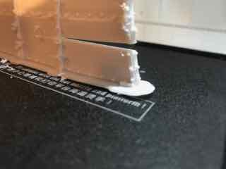

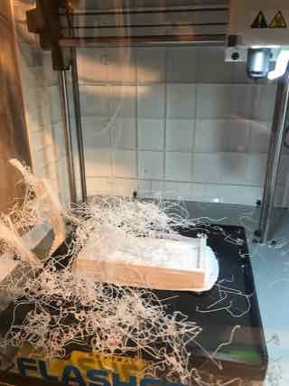

To give a balanced picture of the printer... I should probably post pics of the problems, not just the successes!
I've mentioned the 'curling' issue - that is, the edge(s) of the raft lift up, and so the print is not on a flat base...the print is uneven, with some parts getting compressed in the Z axis - in this case the sleeper printing too high, the rail not high enough, the sleeper won't sit flat and more importantly flanges will hit it: Then, I'm not quite sure what to call this, although it seems to be quite common - sometimes it looks like it would be easy enough to hide with filler, sometimes not so much: My guess is this is probably due to my printing ABS when the ambient temperature is too low and the side door of the printer is off to allow me to feed it from a 1kg spool...

Ahh...spaghetti..been there, done that, got Tee shirts galore!SimonWood wrote: Mon Dec 21, 2020 11:15 am
Probably the bed isn't hot enough and/or the initial layers are too cool and/or to fast. Final issue I've found is that sometimes a blob of filament has stuck to the nozzle and the filament then sticks to it and curls round as it extrudes, then it doesn't stick to the bed and just extrudes the spaghetti,
I think that is a function of printing temperature and probably drafts, plus possibly print speed. Basically one layer of filament has cooled down before it could fuse properly to the layer underneath, and then subsequent layers have stuck to each other and warp as they cool. If the print speed is slightly higher it might have time to fuse before it cools.SimonWood wrote: Mon Dec 21, 2020 11:15 am

I have a simple answer to warping and it work's. Pritt Stick (or Tesco equivalent which also works just as well but is loads cheaper). The first time you put it on it doesn't always work that well after it's been cleaned, but subsequent applications are hard to get off the magnetic base, only thing is you need to wash it and scrub it once in a while or it ends up too bumpy with all the glue. I use this ALL the time and I get no warping issues after the first application each time.

I have had these problems as well. They are more common (probably) with ABS than PLA.
Firstly when the raft fails to bond to the bed. Try cleaning with Acetone and if that isn't enough acetone with ABS in it. As I said before be careful it will really stick if you overdo the ABS. So much that you can damage the flexible bed plate.
The splits in the components printed on edge. Firstly the component may be too thin - in as much as it will improve the situation if the component is thicker. As Philip said it is a cooling issue. You could manually reduce the print speed a bit in the "more options menu". You can adjust the temperature of the extruder a bit - to 235 which is as high as it will go perhaps.

Just realised Philip said raise the print speed and I said lower the print speed. Obviously try both as an experiment but I think lower will give it longer to fuse to the lower layer.

True. I was thinking that increasing the speed would get the head back again before it had cooled too much! As you say, try both.Trevor Thompson wrote: Mon Dec 21, 2020 5:04 pm I think lower will give it longer to fuse to the lower layer.

So far I've got around the curling problem cleaning with nothing more than IPA but I think the ambient temperature has been warmer.
