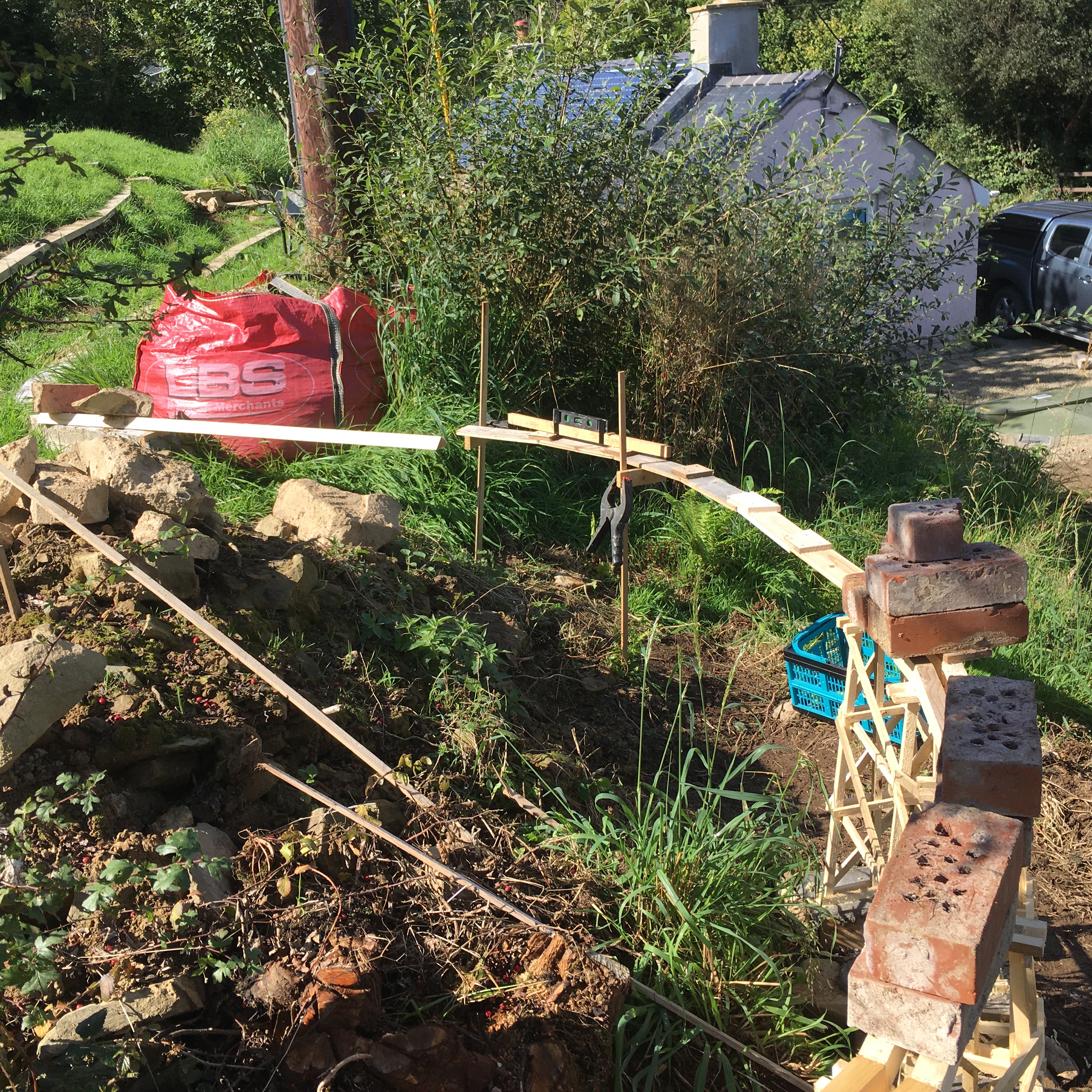

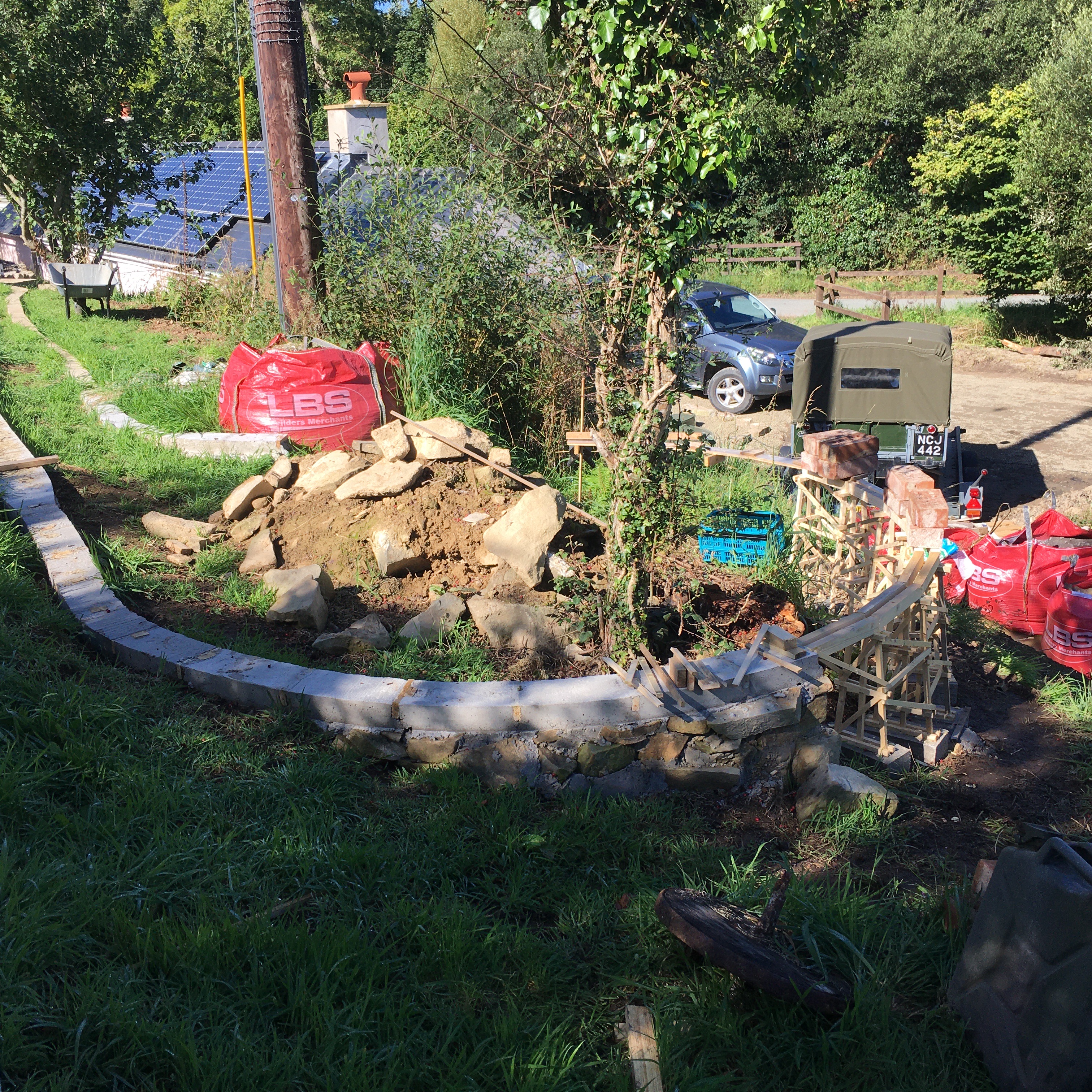

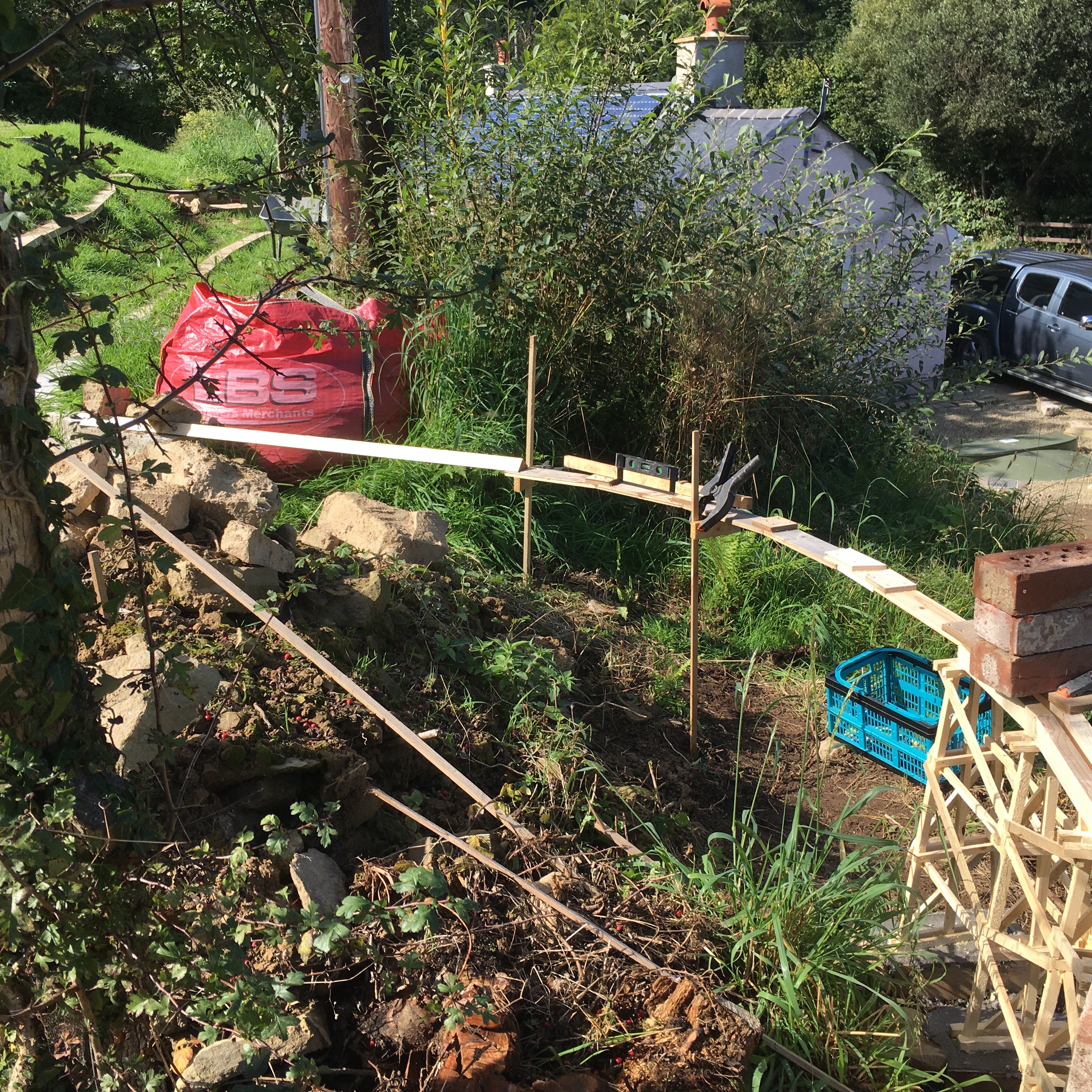

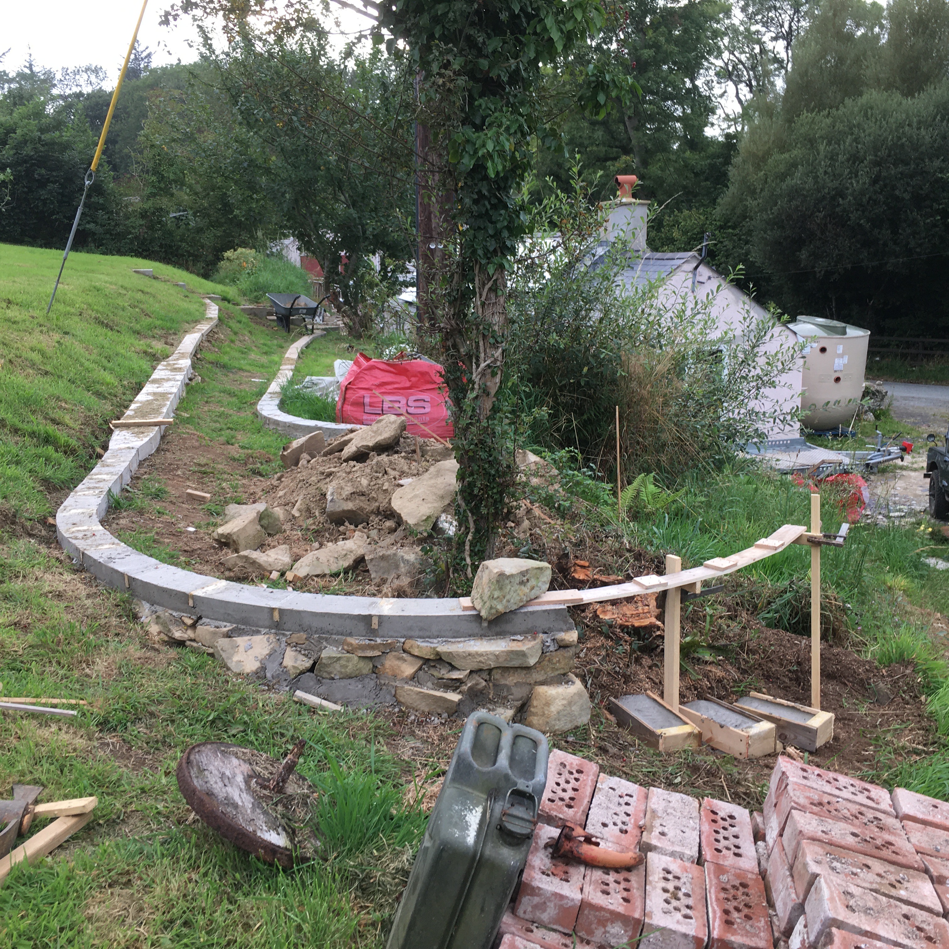

I have now laid the track bed all the way to the void. The last section involved a stone embankment which I plan to cover with soil and eventually grass. It is getting high enough, as the ground falls away to make me think about changing my technique for making the trackbed.
So here is the latest with both ends drawing up to the remaining half circle to be constructed over a fairly steep slope:
It looks like it is crying out to have an North American style wooden trestle viaduct. Not my first choice. The research I carried out looking at prototypes in the UK led me to Brunels Cornish viaducts, the Welsh river crossing viaducts at Barmouth and Loughor, and the slate mine one at Blaenau Ffestiniog.
The ones that are high and long are all wooden structures mounted on top of stone piers. The wooden supports radiate out from the stonework, to support the top deck.
I really don't want to have to cast concrete piers here. Providing a foundation which would stabilise a tall pier has put me off. Each pier would be different - some short and some tall - but no two the same. Making this accurately, on a curve, with a 1 in 80 slope, seems too difficult. I also want to have a result sooner than later, and I think casting piers would take a long time - and use a lot of wood for shuttering. I have worked out a way that I can set out the curve and slope and actually make fit if I do it this way:
So, much against my instincts it will be an North American style trestle viaduct.
How to set this out and make it accurately?
I am going to make it in stages, 3 trestles at a time, so I have made four sections of mock top deck and cut the ends at the correct angle to make them follow a 4ft 6inch curve when joined together. An extra length at the left allows it to be cantilevered of the last bit of concrete track bed. It can be seen in place in the photo. Two uprights clamped onto it allow me to set it at the correct slope and level it across the deck. So that lets me look down and see where the concrete foundations should be made. I made three sets of shuttering for the foundations and set then below the deck joints. The small concrete bases to support the bottom of each trestle can be seen in their shuttering on the right hand side of the photograph.

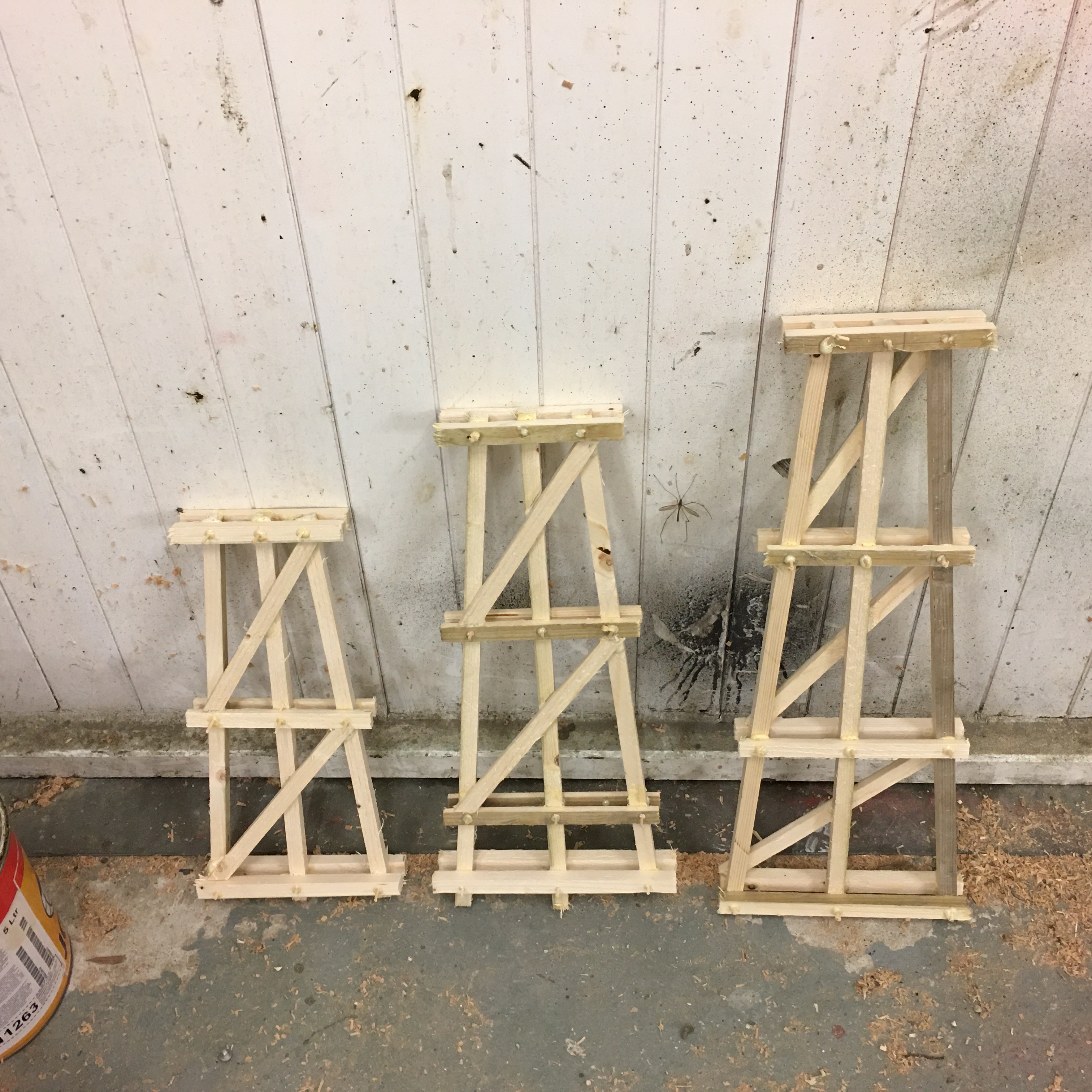

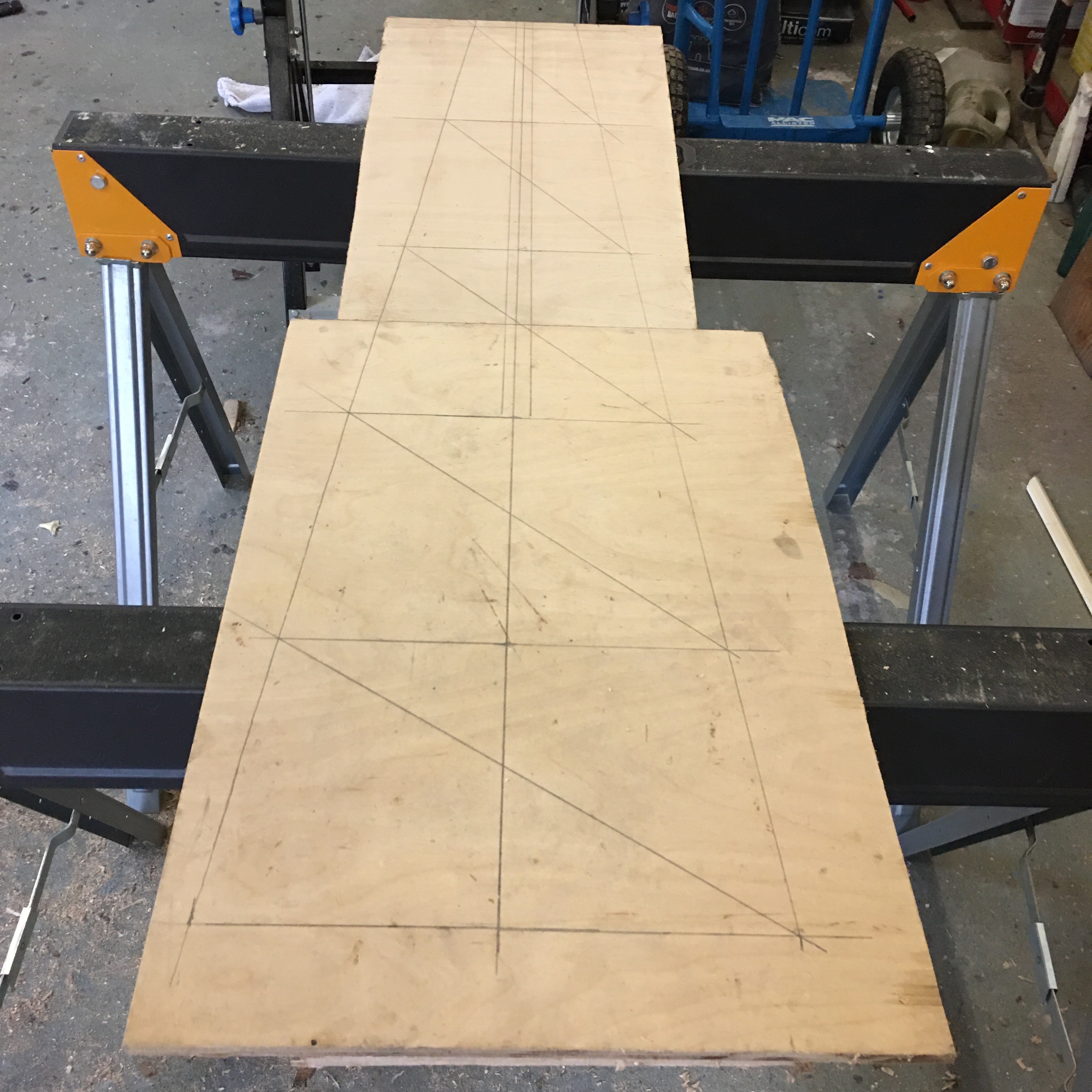

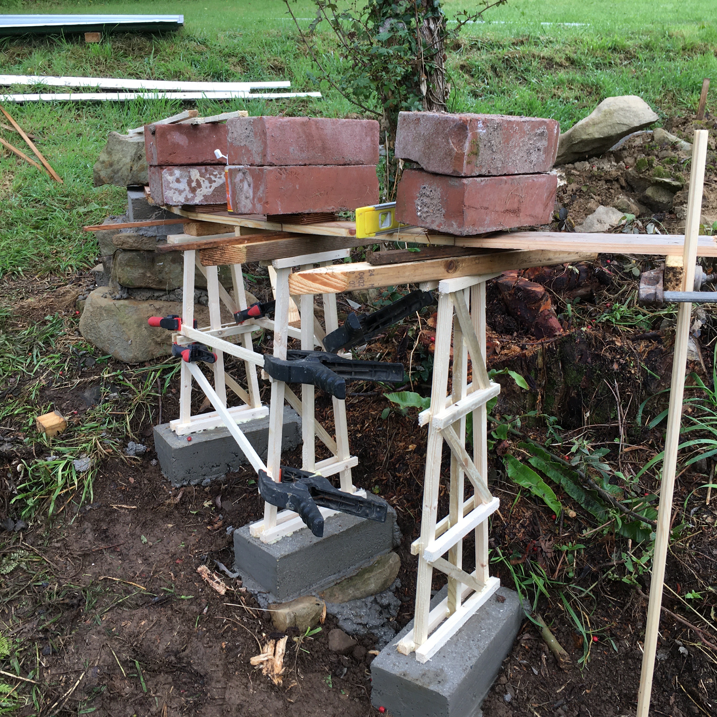

On the basis that each trestle will have the same profile, with the outer legs protruding at the same angle, and the longer it is the wider the base, I have made a template to create the trestles:
So while it is raining, and the concrete curing I can make three trestles. Since my temporary top deck is defining where the trestles will go I can measure their height from the concrete to the level of the trackbed. Just have to remember to take off the height of the real top deck and I know how long the trestle has to be.
The outline is in pencil. By marking the length of each trestle on the template I think I can then make each trestle to fit the specific place it is intended to fit into.
So off to make trestles!

The first three trestles have been made:
and this morning they have been fitted into position:
The template which defines the track bed is really useful. It allowed me to place the shuttering in roughly the right place, and when fitting the trestles allowed me to identify if they were the correct length, and in the correct position. One of them was too long - so I had to modify it but at least it was too long not too short.
I have the same amount of packing between the top of each trestle and the template so they must be the correct length. I am slowly adding the cross bracing between the trestles, limited by the number of small clamps that I have. Each trestle is glued onto the concrete using an expanding polyurethane glue. That should not only hold it in place but form a water proof layer between concrete and wood.

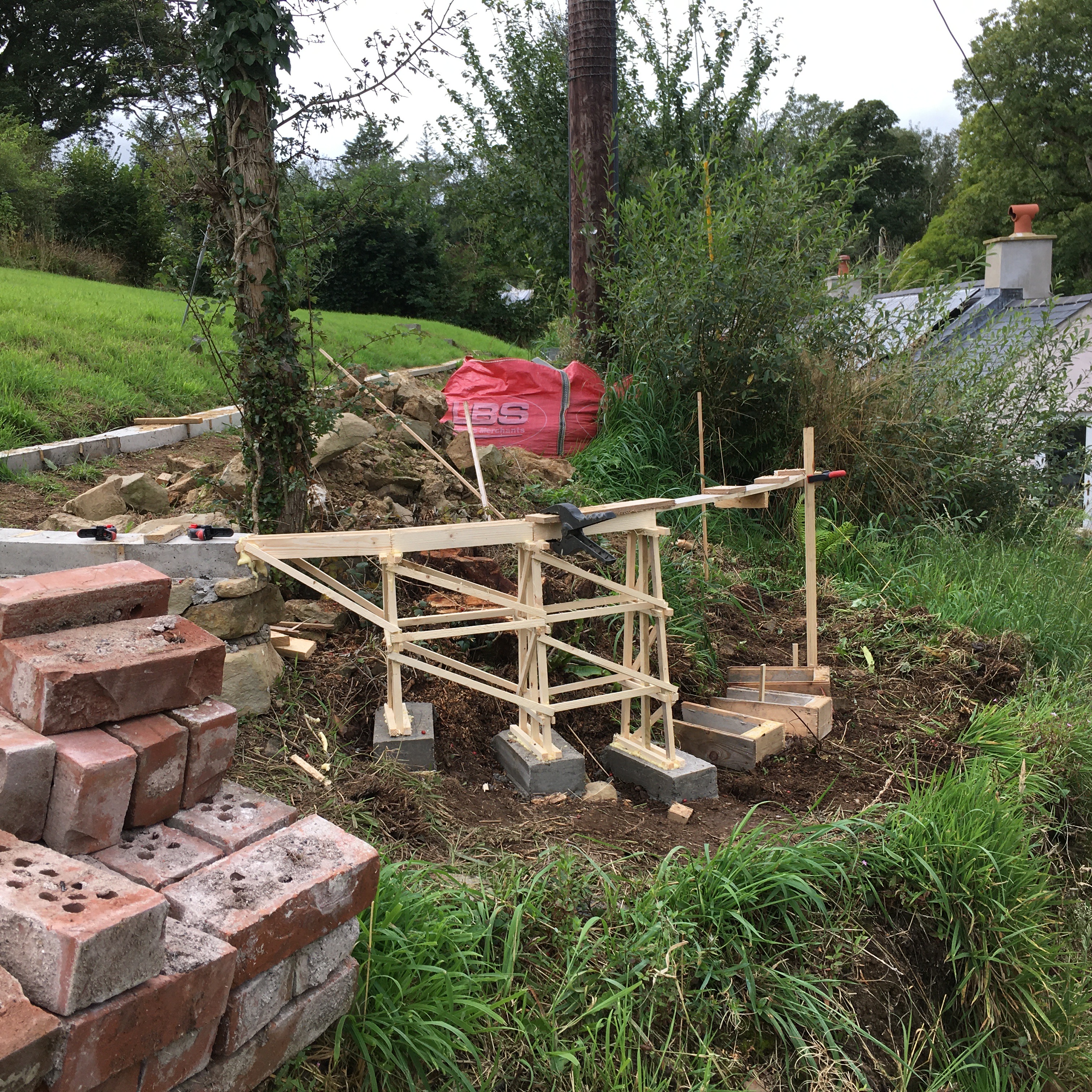

The second section of the viaduct is now complete:
So that is 7 trestles in place and all crossbraced, and the track "bed" glued on.
That has enabled me to look at how the two ends are going to join up. I have set up the template onto the last complete section and set up a straight plank from the other end - to see how near they are both in vertical height and in meeting horizontally:
You can see that as far as vertical height is concerned the two ends are at about the right height to actually meet. However as far as the two curved sections actually meeting it isn't quite right. I have set the straight plank so it is in line as straight track from the end of the curved bit. I have added 2 straight sections into the template as the sections nearest the last trestle, and where the two meet I have a 6 inch (150mm) gap - sideways.

Cutting the 6 inches of one of the straight lengths at the trestle end now makes them join!!!! :D
So just to think about the gradients, most of the concrete part of this area of the line rises at 1:60. When I got to the trestle viaduct I calculated the vertical height again and estimated the track length - which suggested the gradient should ease to 1:80. Having built the trestle viaduct to 1:80 it seems that the remaining straight section where the plank is should be 1:60. So it meets up, and is as good as I was ever going to get it.
Just another 8 trestles to go.

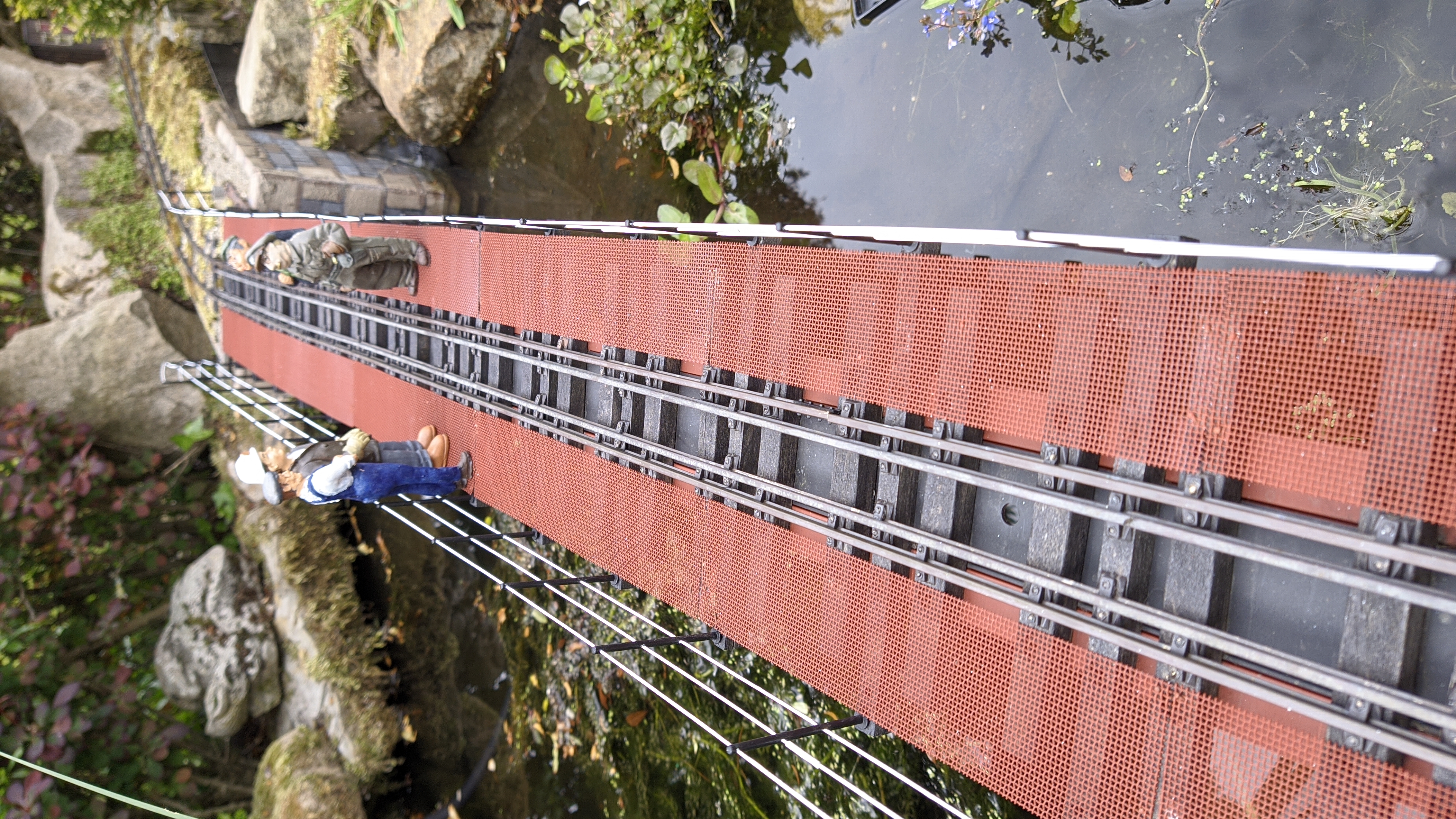

Not a viaduct, but this prevents trains taking a dip in my pond. Brass model boat stanchions on every 3rd extended sleeper, piano wire for the rails and stainless steel fine gauge mesh for the walkways. Lollipop sticks only lasted a couple of years. The check rails are largely cosmetic, but may be a good idea on a curved structure.

Thank you - that is really helpful. I like those ideas.
I’m going to look for the model boat stanchions - I was really not looking forward to turning up so many of them.
