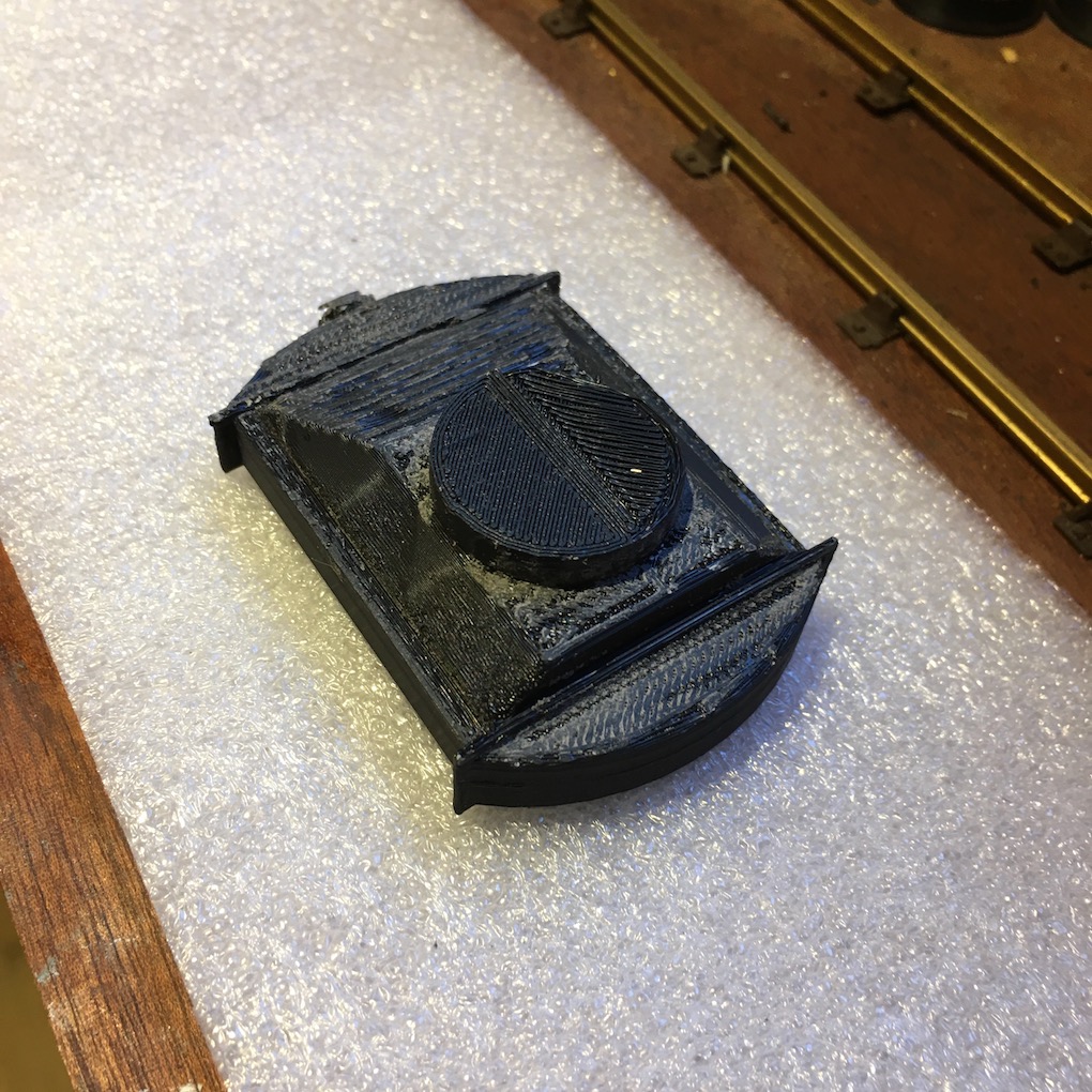

The latest components printed and assembled:
I have had issues printing the spectacle plate. Sketchup only identifies "nested object" issues in the inspector subroutine, so it should be OK. The slicing software loads it and it shows all the correct features. However when it slices it it fills the spectacles and the hole for battery access. I ended up chain drilling and filing them out.

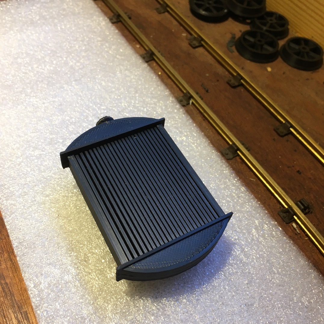

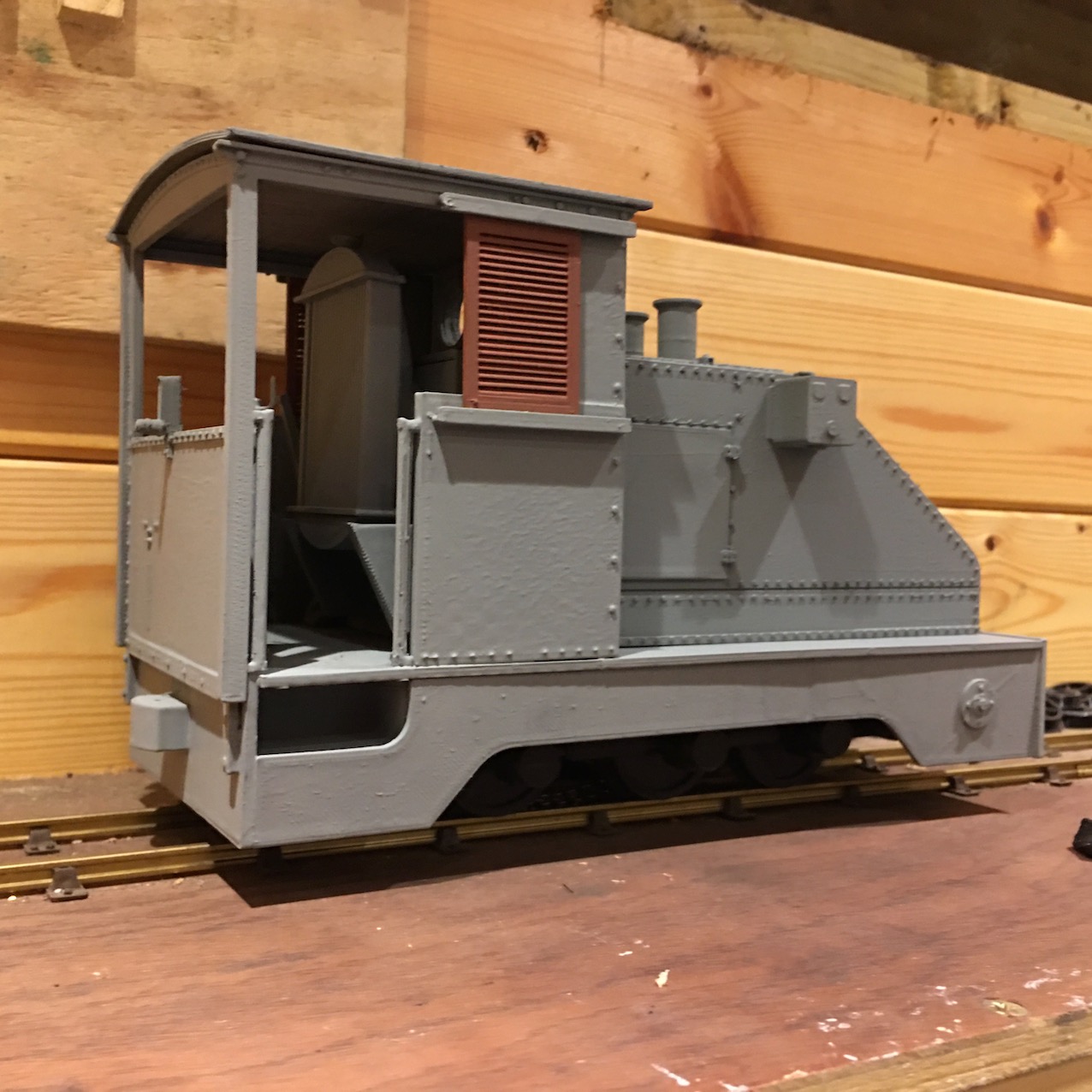

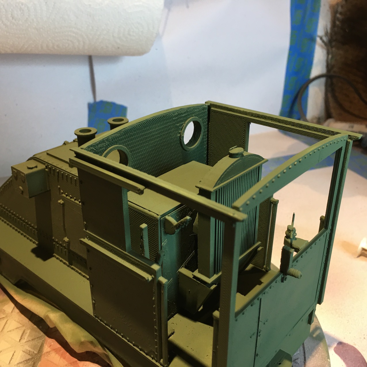

I am now printing the cab detail. The radiator, a prominent feature in the cab, is here:
and the reverse face:
The back is a bit rough. The result of having to remove the printing supports and rub a file ofer it. This reverse face will hardly be visible anyway so I am not concerned about that.

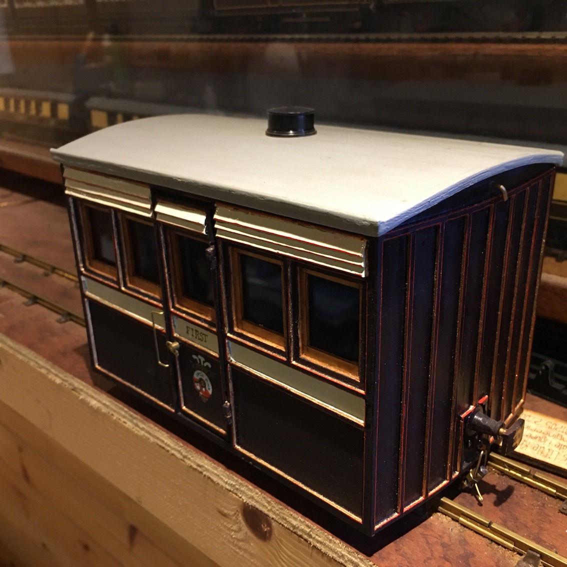

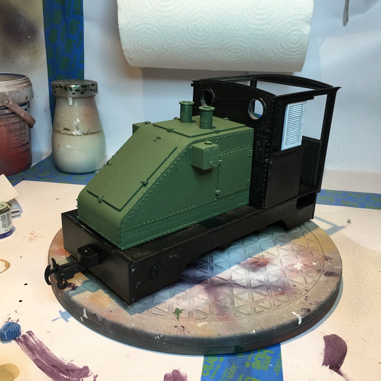

4415 is now finished as in all the parts are printed and assembled. I await the arrival of rechargeable batteries and a radio receiver. So in the meantime it is being painted. Much easier to see the result when it isn't black!
So it has had a primer coat, a "round" coat of duck egg blue matt enamel. After 24 hours I rubbed the surface lightly with a glass fibre pen, and gave it another generous coat of paint - this time matt green. I will rub it down again and then paint it with a final 2 coats of grey.
So the photos:
and finally with the roof in place. The roof is interesting as a printing problem. I have successfully printed it, but there are a couple of cracks in the edges where it is thin. Easily filled and not affecting the structural strength - in that it doesn't want to split down the crack. However not perfect. The filling is visible.

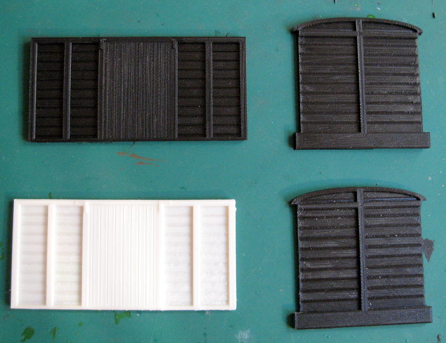

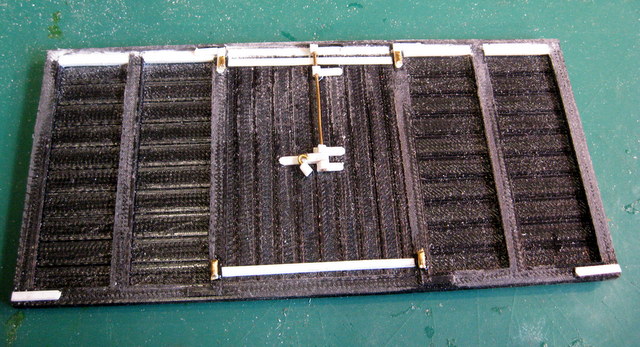

My efforts are nowhere up the the quality and standard of Trevor and Philip - maybe because my printer cost only £80 - or maybe because I'm not so skilled at setting up up properly. Prints which are mostly along the X and Y axis are acceptable

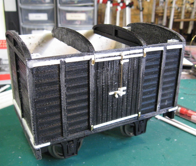

So these ends and sides of my luggage van have turned out quite well. I've added a bit of detail with plasticard .
And mounted everything on the ubiquitous HLW chassis .
Almost finished ... ,

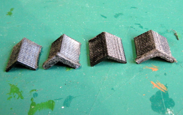

Whereas these ridge tiles which were printed upright and so mostly along the Z axis are heavily ribbed .
I think it's because the frame of my printer is made from 4mm ply and so, even though I've added extra framework to try and stabilise it, it flexes a bit.. However, once installed, the ridge tiles seem OK Rik
- Posts: 1205
- Location: South West Wales
Re: 3 D Printing 16mm models
I don't do any rubbing down normally. For example the coach has not been rubbed down at all - and won't need anything more than another coat of paint. I think I printed that on the high resolution setting. However the sides of the 4415 are not as smooth as I have been able to get other components. I suspect that I printed them using the standard resolution. If you look closely at the flat panels of 4415 you will see that they are not actually perfect. I will give them some attention to lower the raised marks.
I much prefer to cover any slight surface irregularities with paint - rather than removing plastic. It is amazing how a few fairly thick layers will improve the surface. I am spraying the paint using an airbrush so it is fairly thin, and I spray until the paint is just about to run. I need good light to do it though. So a few thick coats don't actually build up a very thick paint film

I have been thinking about this overnight!
I think that the wagon and the tiles are pretty brilliant considering that you have produced them on such a low cost printer. You would not know how the tiles were made.
I have 2 questions:
Firstly what do you use to glue the wagon components together - they are PLA I think?
Secondly how are you going to finish (paint) the wagon?

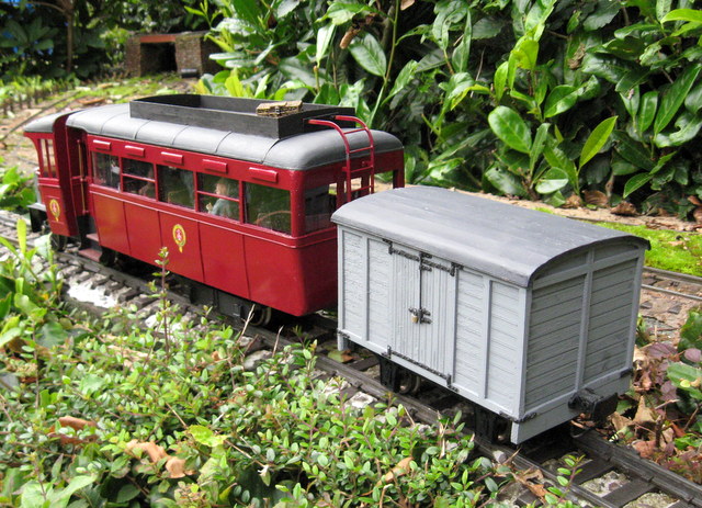

I've now finished titivating and painting the van.
As you can see, it's quite a small model - I don't think the CDR luggage vans were quite this small, but I wanted it to look right proportionally. .
The 3D prints were 'bare-bones' so I added the detailing later using plasticard (see above). .
I'm quite pleased with how it turned out.

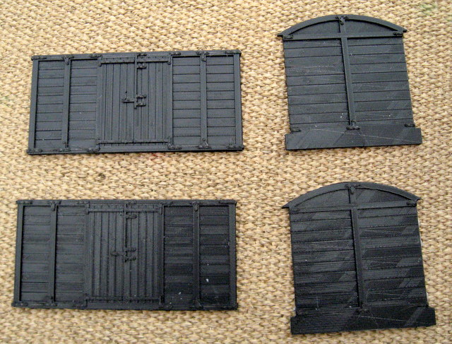

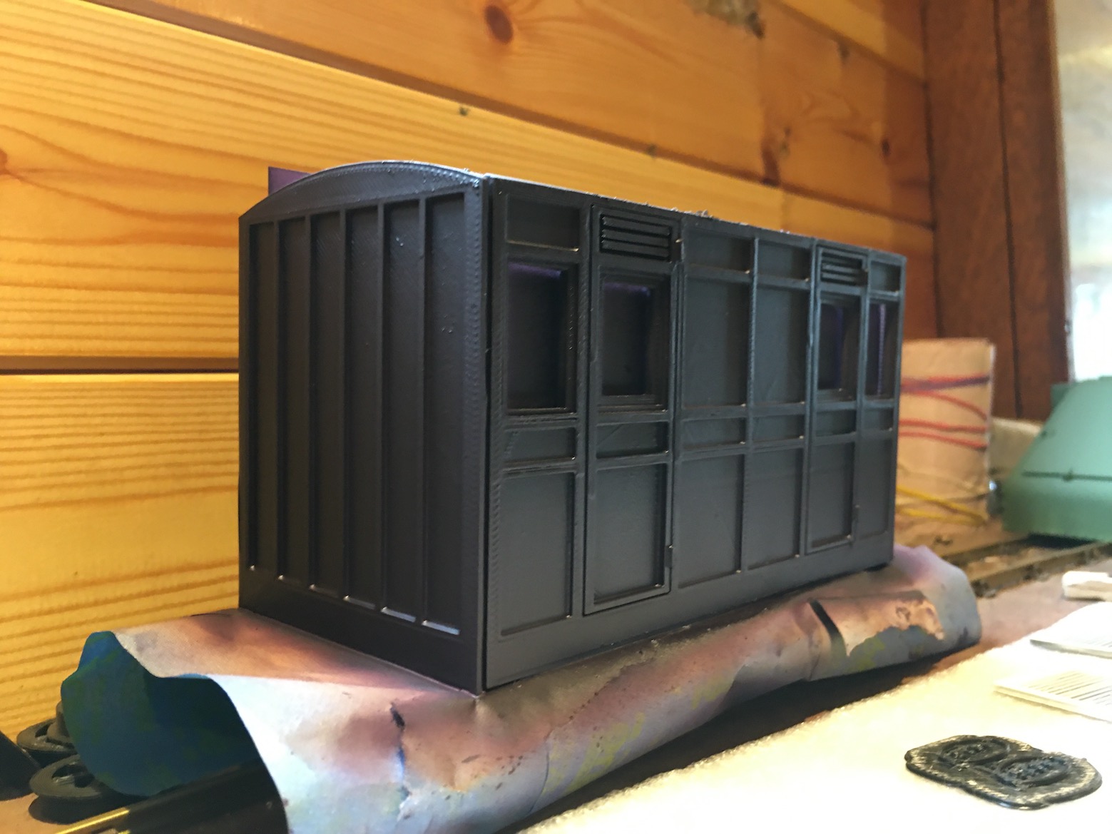

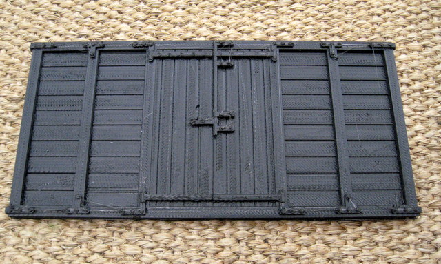

I decided to tinker with the drawings and have now added the extra detailing as part of the print.
I've not done any tidying - this is how it has come off the printer. .

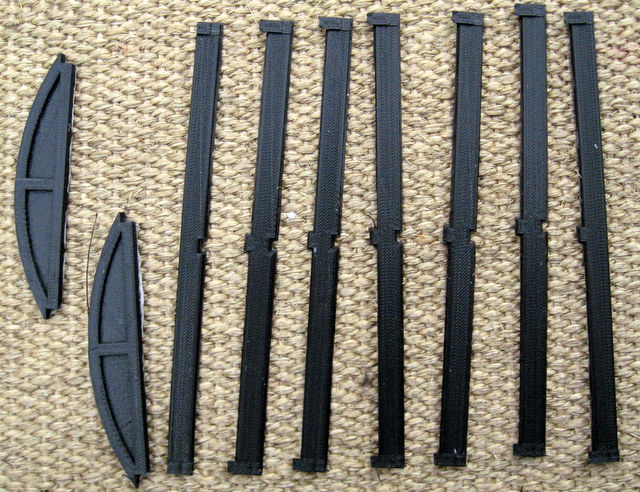

I've now printed sufficient parts to make another van. .
From my experience, curved roofs are a bit of a struggle for 3D printers. On the original model I used strips of 1.5mm plasticard as planks covered with a 0.5mm layer of plasticard. I opted for interlocking planks for version 2 of the van. .

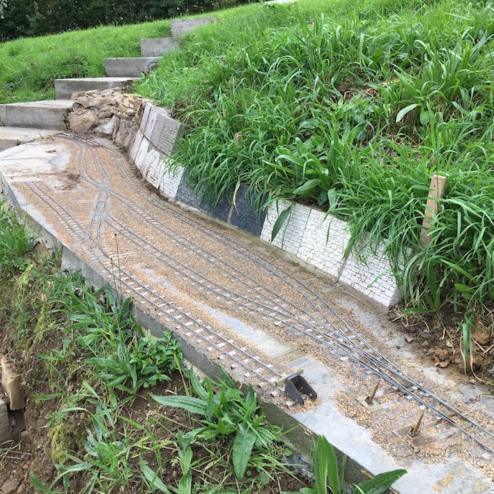

The site where it is to fit is here:
and the exact place is over the diamond crossing:
The only bit which doesn't work for this site is the back end because the bank beyond the bridge far end is much higher than the real site. So I have repeated the staircases at the far end rather than let the footpath disappear into a blank wall. So this is the plan:
I have started printing it in sections. However the first part has repeatedly come unstuck from the bed. So I have used something I got from Utube. Filled a bottle with acetone and bits of ABS. Then washed the bed with the mixture. It doesn't half improve the bond to the bed - but it is now difficult to get off the bed after its printed!
